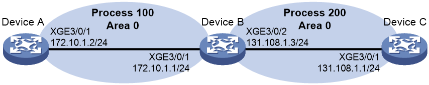

As shown in Figure 1, Device A and Device B establish a neighbor relationship in OSPF process 100, and Device B and Device C establish a neighbor relationship in OSPF process 200. Device A and Device C cannot learn routes from each other through OSPF.

# Execute the display ospf peer command on Device B to verify that Device A and Device C have already established a neighbor relationship.
[DeviceB] display ospf peer
OSPF Process 100 with Router ID 2.2.2.9
Neighbor Brief Information
Area: 0.0.0.0
Router ID Address Pri Dead-Time State Interface
1.1.1.9 172.10.1.1 1 30 Full/DR XGE3/0/1
OSPF Process 200 with Router ID 2.2.2.9
Area: 0.0.0.0
3.3.3.9 131.108.1.1 1 39 Full/BDR XGE3/0/2
