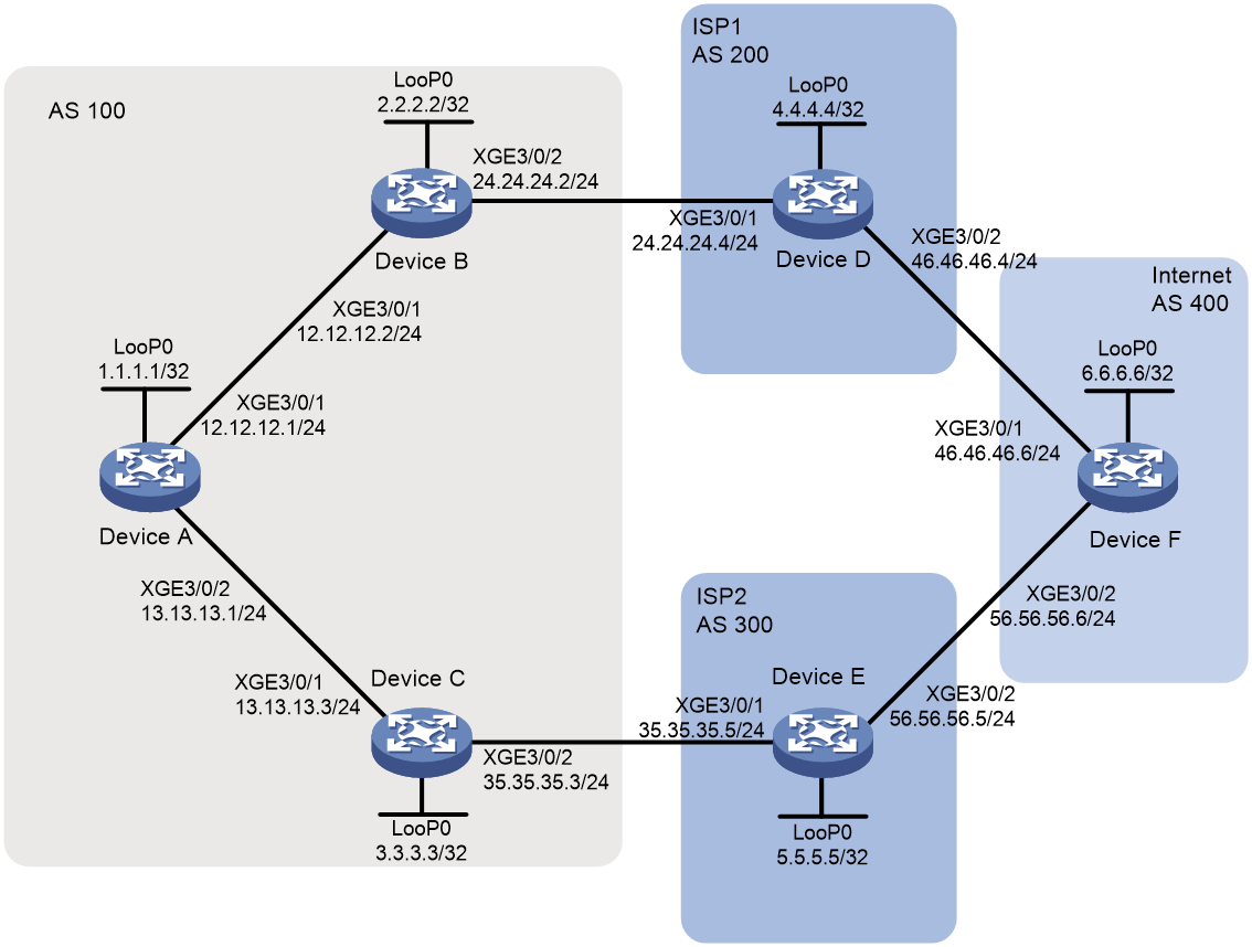

As shown in Figure 1, all devices run BGP. Configure a routing policy on Device B and Device C to ensure that traffic from AS 100 to AS 400 is preferentially forwarded by Device D.
Figure 1 Network diagram
Analysis
For devices in AS 100 to select the optimal route based on AS numbers, increase the local preference for routes whose AS_PATH attributes end with the specified AS number. Configure a routing policy on Device C to set the local preference to 300 for routes whose AS_PATH attributes end with AS number 400.
To filter routes based on AS numbers, use an AS path list.

Configuring IP addresses for interfaces
# Configure an IP address for the interface Ten-GigabitEthernet3/0/1 on Device A.
<DeviceA> system-view
[DeviceA] interface Ten-GigabitEthernet 3/0/1
[DeviceA-Ten-GigabitEthernet3/0/1] ip address 12.12.12.1 24
[DeviceA-Ten-GigabitEthernet3/0/1] quit
# Configure IP addresses for other interfaces as shown in Figure 1. (Details not shown.)
Configuring BGP connections
# On Device A, enable the default BGP instance, set the AS number to 100, and specify 12.12.12.2 and 13.13.13.3 as BGP peers.
[DeviceA] bgp 100
[DeviceA-bgp-default] router-id 1.1.1.1
[DeviceA-bgp-default] peer 12.12.12.2 as-number 100
[DeviceA-bgp-default] peer 13.13.13.3 as-number 100
[DeviceA-bgp-default] address-family ipv4 unicast
[DeviceA-bgp-default-ipv4] peer 12.12.12.2 enable
[DeviceA-bgp-default-ipv4] peer 13.13.13.3 enable
[DeviceA-bgp-default-ipv4] quit
[DeviceA-bgp-default] quit
# On Device B, enable the default BGP instance, set the AS number to 100, specify 12.12.12.1 and 24.24.24.4 as BGP peers, and redistribute direct routes.
[DeviceB] bgp 100
[DeviceB-bgp-default] router-id 2.2.2.2
[DeviceB-bgp-default] peer 12.12.12.1 as-number 100
[DeviceB-bgp-default] peer 24.24.24.4 as-number 200
[DeviceB-bgp-default] address-family ipv4 unicast
[DeviceB-bgp-default-ipv4] peer 12.12.12.1 enable
[DeviceB-bgp-default-ipv4] peer 24.24.24.4 enable
[DeviceB-bgp-default-ipv4] import-route direct
[DeviceB-bgp-default-ipv4] quit
[DeviceB-bgp-default] quit
# On Device C, enable the default BGP instance, set the AS number to 100, specify 13.13.13.1 and 35.35.35.5 as BGP peers, and redistribute direct routes.
[DeviceC] bgp 100
[DeviceC-bgp-default] router-id 3.3.3.3
[DeviceC-bgp-default] peer 13.13.13.1 as-number 100
[DeviceC-bgp-default] peer 35.35.35.5 as-number 300
[DeviceC-bgp-default] address-family ipv4 unicast
[DeviceC-bgp-default-ipv4] peer 13.13.13.1 enable
[DeviceC-bgp-default-ipv4] peer 35.35.35.5 enable
[DeviceC-bgp-default-ipv4] import-route direct
[DeviceC-bgp-default-ipv4] quit
[DeviceC-bgp-default] quit
# On Device D, enable the default BGP instance, set the AS number to 200, specify 24.24.24.2 and 46.46.46.6 as BGP peers, and advertise the route 4.4.4.4/32.
[DeviceD] bgp 200
[DeviceD-bgp-default] router-id 4.4.4.4
[DeviceD-bgp-default] peer 24.24.24.2 as-number 100
[DeviceD-bgp-default] peer 46.46.46.6 as-number 400
[DeviceD-bgp-default] address-family ipv4 unicast
[DeviceD-bgp-default-ipv4] peer 24.24.24.2 enable
[DeviceD-bgp-default-ipv4] peer 46.46.46.6 enable
[DeviceD-bgp-default-ipv4] network 4.4.4.4 32
[DeviceD-bgp-default-ipv4] quit
[DeviceD-bgp-default] quit
# On Device E, enable the default BGP instance, set the AS number to 300, specify 35.35.35.3 and 56.56.56.6 as BGP peers, and advertise the route 5.5.5.5/32.
[DeviceE] bgp 300
[DeviceE-bgp-default] router-id 5.5.5.5
[DeviceE-bgp-default] peer 35.35.35.3 as-number 100
[DeviceE-bgp-default] peer 56.56.56.6 as-number 400
[DeviceE-bgp-default] address-family ipv4 unicast
[DeviceE-bgp-default-ipv4] peer 35.35.35.3 enable
[DeviceE-bgp-default-ipv4] peer 56.56.56.6 enable
[DeviceE-bgp-default-ipv4] network 5.5.5.5 32
[DeviceE-bgp-default-ipv4] quit
[DeviceE-bgp-default] quit
# On Device F, enable the default BGP instance, set the AS number to 400, specify 46.46.46.4 and 56.56.56.5 as BGP peers, and advertise the route 6.6.6.6/32.
[DeviceF] bgp 400
[DeviceF-bgp-default] router-id 6.6.6.6
[DeviceF-bgp-default] peer 46.46.46.4 as-number 200
[DeviceF-bgp-default] peer 56.56.56.5 as-number 300
[DeviceF-bgp-default] address-family ipv4 unicast
[DeviceF-bgp-default-ipv4] peer 46.46.46.4  enable
[DeviceF-bgp-default-ipv4] peer 56.56.56.5 enable
[DeviceF-bgp-default-ipv4] network 6.6.6.6 32
[DeviceF-bgp-default-ipv4] quit
[DeviceF-bgp-default] quit

Configuring routing policies
# Create routing policy aspath on Device C, and set the local preference to 300 for routes whose AS_PATH attributes end with AS number 400.
[DeviceC] ip as-path 1 permit 400$
[DeviceC] route-policy aspath permit node 20
[DeviceC-route-policy-aspath-20] if-match as-path 1
[DeviceC-route-policy-aspath-20] apply local-preference 300
[DeviceC-route-policy-aspath-20] quit
[DeviceC] route-policy aspath permit node 25
# Apply routing policy aspath to routes from the peer 35.35.35.5.
[DeviceC] bgp 100
[DeviceC-bgp-default-ipv4] peer 35.35.35.5 route-policy aspath import
