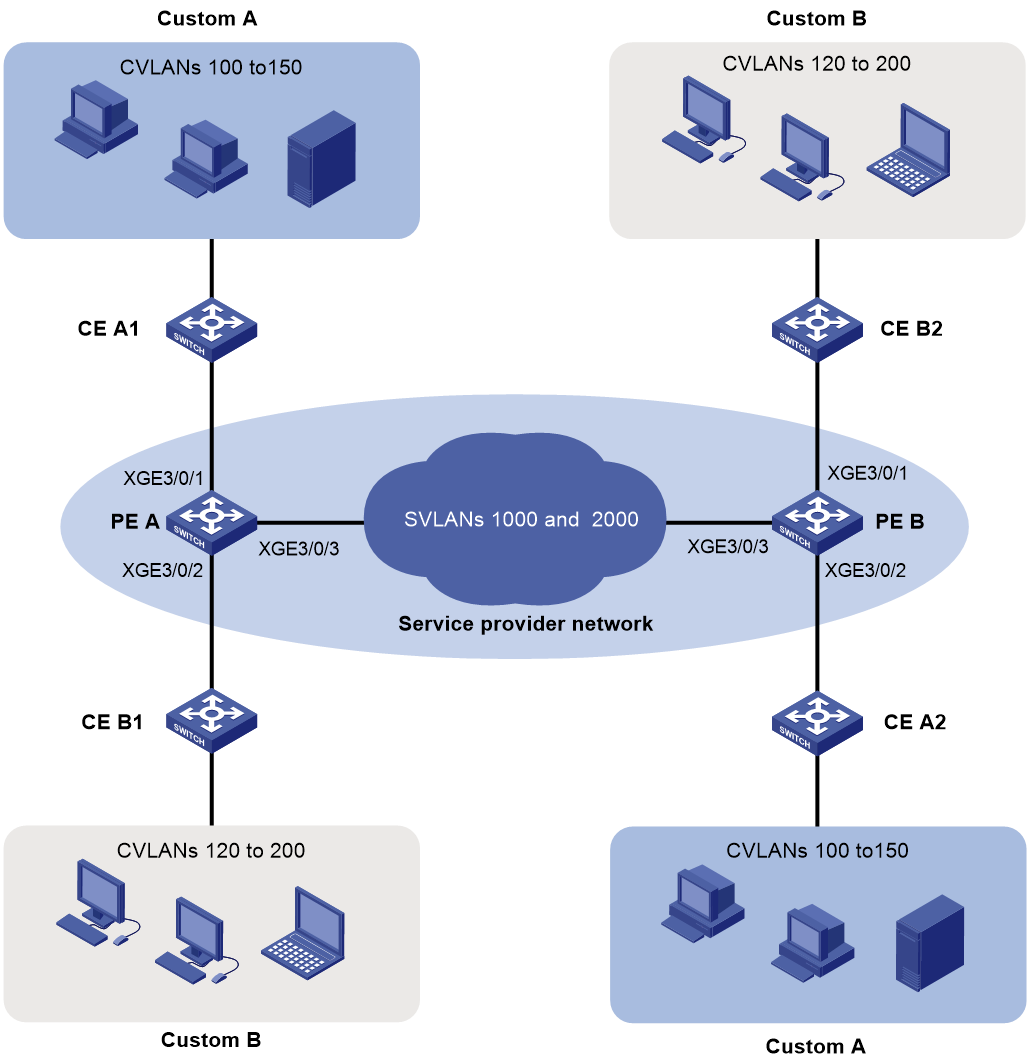

This document provides examples for using QinQ to transmit 802.1Q-tagged customer traffic in the service provider network.
A QinQ-enabled port tags all incoming frames (tagged or untagged) with the PVID tag.
The devices in the service provider network learn MAC addresses of CVLANs into the MAC address table of the SVLAN.
This document assumes that you have basic knowledge of H3C QinQ, .
Example: Configuring QinQ
As shown in Figure 1:
· The service provider assigns VLAN 1000 to Company A's VLANs 100 through 150.
· The service provider assigns VLAN 2000 to Company B's VLANs 120 through 200.
Configure QinQ on PE A and PE B to transmit traffic in VLANs 1000 and 2000 for Company A and Company B, respectively.

Procedures
Configuring PE A
1. Create VLANs 1000 and 2000.
<PE_A> system-view
[PE_A] vlan 1000
[PE_A-vlan1000] quit
[PE_A] vlan 2000
[PE_A-vlan2000] quit
2. Configure Ten-GigabitEthernet 3/0/1:
# Configure the port as an access port, and assign the port to VLAN 1000.
[PE_A] interface ten-gigabitethernet 3/0/1
[PE_A-Ten-GigabitEthernet3/0/1] port link-mode bridge
[PE_A-Ten-GigabitEthernet3/0/1] port access vlan 1000
# Enable QinQ on the port.
[PE_A-Ten-GigabitEthernet3/0/1] qinq enable
[PE_A-Ten-GigabitEthernet3/0/1] quit
3. Configure Ten-GigabitEthernet 3/0/2:
# Configure the port as an access port, and assign the port to VLAN 2000.
[PE_A] interface ten-gigabitethernet 3/0/2
[PE_A-Ten-GigabitEthernet3/0/2] port link-mode bridge
[PE_A-Ten-GigabitEthernet3/0/2] port access vlan 2000
[PE_A-Ten-GigabitEthernet3/0/2] qinq enable
[PE_A-Ten-GigabitEthernet3/0/2] quit
4. Configure Ten-GigabitEthernet 3/0/3:
# Configure the port as a trunk port.
[PE_A] interface ten-gigabitethernet 3/0/3
[PE_A-Ten-GigabitEthernet3/0/3] port link-mode bridge
[PE_A-Ten-GigabitEthernet3/0/3] port link-type trunk
# Assign the port to VLANs 1000 and 2000.
[PE_A-Ten-GigabitEthernet3/0/3] port trunk permit vlan 1000 2000
# Remove the port from VLAN 1.
[PE_A-Ten-GigabitEthernet3/0/3] undo port trunk permit vlan 1
Configuring PE B
# Configure PE B in the same way you configure PE A. (Details not shown.)
Configuring devices between PE A and PE B
# Set the MTU to a minimum of 1504 bytes for each port on the path of QinQ frames. (Details not shown.)
# Configure all ports on the forwarding path to allow frames from VLANs 1000 and 2000 to pass through without removing the VLAN tag. (Details not shown.)
# Verify that each company's PCs can ping each other in the same CVLAN across the service provider network. (Details not shown.)
# Verify that the two companies' PCs cannot communicate at Layer 2 even if their CVLAN IDs are the same. The ARP tables on one company's PCs do not contain entries for MAC addresses of the other company's PCs. (Details not shown.)
