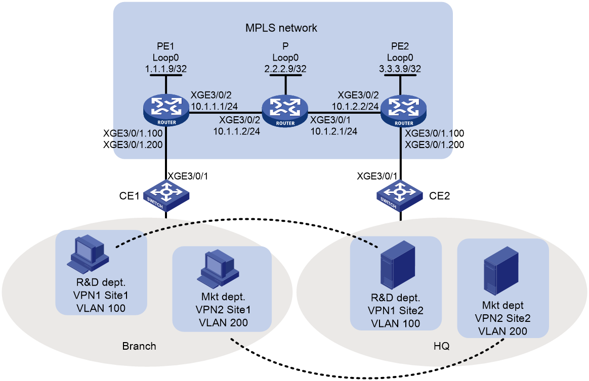

As shown in Figure 1, the MPLS network provides L2VPN services for a customer. Configure LDP PWs between PE 1 and PE 2 so the R&D and Marketing departments use different VPN connections to achieve data isolation.
Figure 1 Network diagram
Analysis
To use LDP PWs to implement MPLS L2VPN, configure two levels of labels:
·     Inner labels—PW labels dynamically generated by LDP.
·     Outer labels—Public tunnel labels dynamically generated by LDP in this example.
To identify packets to be transported by MPLS L2VPN, configure subinterfaces on the CE-facing ports of PEs.
Procedures

As shown in Figure 2, a customer has two VPN sites and will add eight sites in the future. Configure a BGP PW between PE 1 and PE 2 to allow VPN communication between the two sites and reserve enough VPN resources for future extension.
Figure 2 Network diagram
Analysis
To use BGP PWs to implement MPLS L2VPN, configure two levels of labels:
·     Inner labels—PW labels dynamically generated by BGP.
To use BGP to transmit inner labels between PEs, create a subinterface and an IBGP connection, and specify the peer PE as a BGP peer on each PE.
To simplify configuration required by future expansion of the customer network, set the maximum number of CEs in the VPN to 10.
