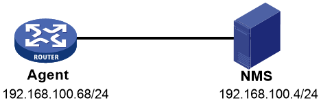

As shown in Figure 1, configure the server that acts as the NMS to back up the configuration file of the device over SNMPv2 and enable the device to automatically report events to the NMS.

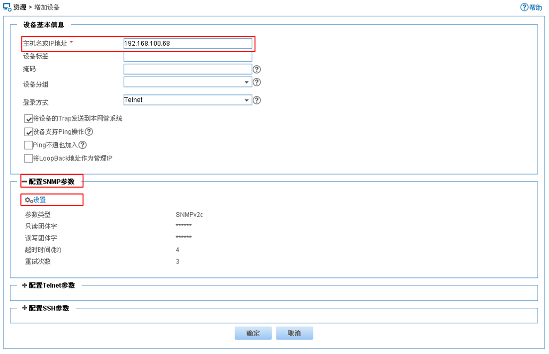

1. Add the device to IMC:
b. From the navigation tree, select Resource Management > Add Device.
c. On the Add Device page, configure the following parameters:
- Enter 192.168.100.68 in the Host Name/IP field.
- Use the default values for other parameters.
Figure 2 Adding a device

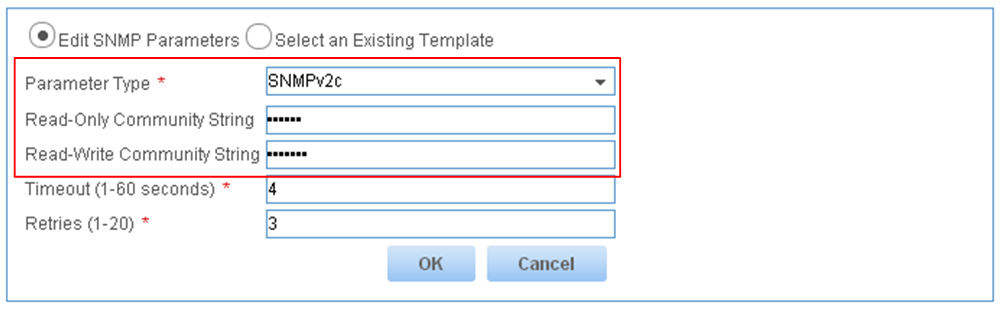

2. Configure SNMP parameters:
a. Expand the SNMP Settings area.
b. Click Configure.
c. On the page that opens, configure the following parameters:
- Select SNMPv2c from the Parameter Type list.
- Enter readtest in the Read-Only Community String field.
- Enter writetest in the Read-Write Community String field.
- Click OK.
Figure 3 Configuring SNMP parameters

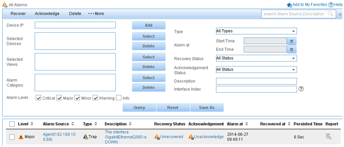

1. Verify that the agent sends notifications to the NMS when the link state of an interface changes:
a. Execute the shutdown or undo shutdown command on an idle interface to shut down or bring up the interface.
b. Click the Alarm tab.
c. From the navigation tree, select Alarm Browse > All Alarms.
You can see the alarms in Figure 5.

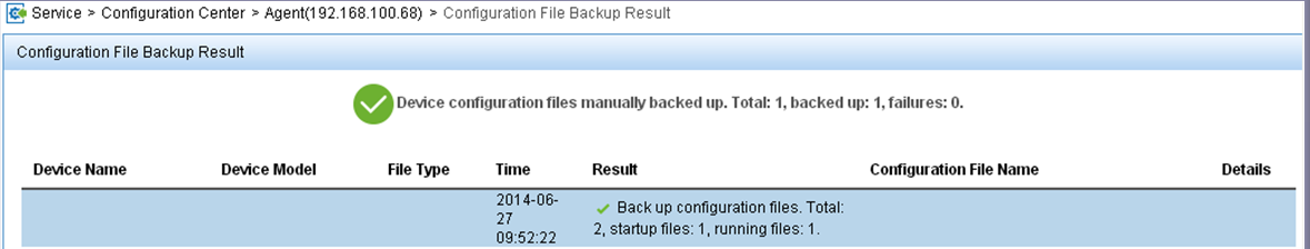

2. Back up the agent configuration file:
a. Click the Resource tab.
b. From the navigation tree, select Device View.
c. On the page that opens, click the device label link Agent(192.168.100.68).
d. On the Configuration Center menu, select Backup Configuration File.
The system displays the backup result as shown in Figure 6 if the operation succeeds.
Figure 6 Configuration file backup result
