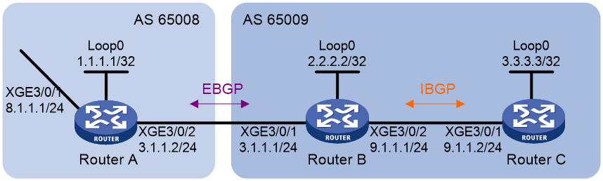

As shown in Figure 1, all routers run BGP. Run EBGP between Router A and Router B, and run IBGP between Router B and Router C so that Router C can access the network 8.1.1.0/24 connected to Router A.
Figure 1 Network diagram
Analysis
To enable Router B to communicate with Router C through loopback interfaces, enable OSPF in AS 65009.
By default, BGP does not advertise local networks. To enable Router C to access the network 8.1.1.0/24 connected directly to Router A, perform the following tasks:
·     Add network 8.1.1.0/24 to the BGP routing table of Router A.
·     Add networks 3.1.1.0/24 and 9.1.1.0/24 to the BGP routing table of Router B.
When you configure basic BGP, follow these restrictions and guidelines:
·     Use loopback interfaces to establish IBGP connections to prevent route flapping caused by port state changes.
·     Loopback interfaces are virtual interfaces. Use the peer connect-interface command to specify the loopback interface as the source interface for establishing BGP connections.
·     The EBGP peers, Router A and Router B, are located in different ASs. Typically, their loopback interfaces are not reachable to each other, so the routers use directly connected interfaces to establish EBGP sessions.

1.     Configure IP addresses for interfaces:
# Configure an IP address for Ten-GigabitEthernet3/0/1.
<RouterA> system-view
[RouterA] interface Ten-GigabitEthernet 3/0/1
[RouterA-Ten-GigabitEthernet3/0/1] ip address 8.1.1.1 24
# Configure IP addresses for other interfaces in the same way that GigabitEthernet 3/0/1 is configured. (Details not shown.)
2.     Configure IBGP:
# Configure Router B.
<RouterB> system-view
[RouterB] bgp 65009
[RouterB-bgp-default] router-id 2.2.2.2
[RouterB-bgp-default] peer 3.3.3.3 as-number 65009
[RouterB-bgp-default] peer 3.3.3.3 connect-interface Loopback 0
[RouterB-bgp-default] address-family ipv4 unicast
[RouterB-bgp-default-ipv4] peer 3.3.3.3 enable
[RouterB-bgp-default-ipv4] quit
[RouterB-bgp-default] quit
[RouterB] ospf 1
[RouterB-ospf-1] area 0
[RouterB-ospf-1-area-0.0.0.0] network 2.2.2.2 0.0.0.0
[RouterB-ospf-1-area-0.0.0.0] network 9.1.1.0 0.0.0.255
[RouterB-ospf-1-area-0.0.0.0] quit
[RouterB-ospf-1] quit
# Configure Router C.
<RouterC> system-view
[RouterC] bgp 65009
[RouterC-bgp-default] router-id 3.3.3.3
[RouterC-bgp-default] peer 2.2.2.2 as-number 65009
[RouterC-bgp-default] peer 2.2.2.2 connect-interface Loopback 0
[RouterC-bgp-default] address-family ipv4 unicast
[RouterC-bgp-default-ipv4] peer 2.2.2.2 enable
[RouterC-bgp-default-ipv4] quit
[RouterC-bgp-default] quit
[RouterC] ospf 1
[RouterC-ospf-1] area 0
[RouterC-ospf-1-area-0.0.0.0] network 3.3.3.3 0.0.0.0
[RouterC-ospf-1-area-0.0.0.0] network 9.1.1.0 0.0.0.255
[RouterC-ospf-1-area-0.0.0.0] quit
[RouterC-ospf-1] quit
# Display BGP peer information on Router C.
[RouterC] display bgp peer ipv4
 BGP local router ID : 3.3.3.3
 Local AS number : 65009
 Total number of peers : 1                 Peers in established state : 1
Peer                    AS  MsgRcvd  MsgSent OutQ PrefRcv Up/Down  State
  2.2.2.2              65009        2        2    0       0 00:00:13 Established
The output shows that Router C has established an IBGP peer relationship with Router B.
3.     Configure EBGP:
# Configure Router A.
[RouterA] bgp 65008
[RouterA-bgp-default] router-id 1.1.1.1
[RouterA-bgp-default] peer 3.1.1.1 as-number 65009
[RouterA-bgp-default] address-family ipv4 unicast
[RouterA-bgp-default-ipv4] peer 3.1.1.1 enable
[RouterA-bgp-default-ipv4] network 8.1.1.0 24
[RouterA-bgp-default-ipv4] quit
[RouterA-bgp-default] quit
[RouterB] bgp 65009
[RouterB-bgp-default] peer 3.1.1.2 as-number 65008
[RouterB-bgp-default-ipv4] peer 3.1.1.2 enable
# Display BGP peer information on Router B.
[RouterB] display bgp peer ipv4
 BGP local router ID : 2.2.2.2
 Total number of peers : 2                 Peers in established state : 2
  3.3.3.3              65009        4        4    0       0 00:02:49 Established
  3.1.1.2              65008        2        2    0       0 00:00:05 Established
The output shows that Router B has established an IBGP peer relationship with Router C and an EBGP peer relationship with Router A.
# Display the BGP routing table on Router A.
[RouterA] display bgp routing-table ipv4
 Total number of routes: 1
 BGP local router ID is 1.1.1.1
 Status codes: * - valid, > - best, d - dampened, h - history
               s - suppressed, S - stale, i - internal, e – external
               a - additional-path
       Origin: i - IGP, e - EGP, ? – incomplete
     Network            NextHop         MED        LocPrf     PrefVal Path/Ogn
* >  8.1.1.0/24         8.1.1.1         0                     32768   i
# Display the BGP routing table on Router B.
[RouterB] display bgp routing-table ipv4
 BGP local router ID is 2.2.2.2
               a - additional-path
       Origin: i - IGP, e - EGP, ? - incomplete
* >e 8.1.1.0/24         3.1.1.2         0                     0       65008i
# Display the BGP routing table on Router C.
[RouterC] display bgp routing-table ipv4
 BGP local router ID is 3.3.3.3
 Status codes: * - valid, > - best, d - dampened, h – history
               a - additional-path
   i 8.1.1.0/24         3.1.1.2         0          100        0       65008i
The outputs show that Router A has learned no route to AS 65009, and Router C has learned network 8.1.1.0, but the next hop 3.1.1.2 is unreachable. As a result, the route is invalid.
4.     Configure BGP to redistribute direct routes on Router B:
[RouterB] bgp 65009
[RouterB-bgp-default-ipv4] network 3.1.1.0 24
[RouterB-bgp-default-ipv4] network 9.1.1.0 24
 Total number of routes: 3
               a - additional-path
* >e 3.1.1.0/24         3.1.1.1         0                     0       65009?
* >e 9.1.1.0/24         3.1.1.1         0                     0       65009i
The output shows that route 9.1.1.0/24 has been added in Router A's routing table.
               a - additional-path
* >i 3.1.1.0/24         2.2.2.2         0          100        0       ?
* >i 8.1.1.0/24         3.1.1.2         0          100        0       65008i
* >i 9.1.1.0/24         2.2.2.2         0          100        0       i
The output shows that the route 8.1.1.0 becomes valid with the next hop as Router A.
# Verify that Router C can ping 8.1.1.1.
[RouterC] ping 8.1.1.1
Ping 8.1.1.1 (8.1.1.1): 56 data bytes, press CTRL_C to break
56 bytes from 8.1.1.1: icmp_seq=0 ttl=254 time=10.000 ms
56 bytes from 8.1.1.1: icmp_seq=1 ttl=254 time=4.000 ms
56 bytes from 8.1.1.1: icmp_seq=2 ttl=254 time=4.000 ms
56 bytes from 8.1.1.1: icmp_seq=3 ttl=254 time=3.000 ms
56 bytes from 8.1.1.1: icmp_seq=4 ttl=254 time=3.000 ms
--- Ping statistics for 8.1.1.1 ---
round-trip min/avg/max/std-dev = 3.000/4.800/10.000/2.638 ms

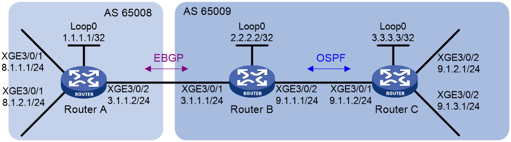

As shown in Figure 2, all devices of company A belong to AS 65008 and all devices of company B belong to AS 65009. Run EBGP between Router A and Router B, and run OSPF between Router B and Router C to allow communication only between networks 9.1.2.0/24 and 8.1.1.0/24.
Figure 2 Network diagram
Analysis
To enable Router A to obtain the route to 9.1.2.0/24, configure BGP to redistribute routes from OSPF on Router B. To enable Router C to obtain the route to 8.1.1.0/24, configure OSPF to redistribute routes from BGP on Router B.
Procedures
[RouterA-Ten-GigabitEthernet3/0/1] ip address 8.1.1.1 255.255.255.0
2.     Enable OSPF in AS 65009:
[RouterB] ospf 1
[RouterC] ospf 1
[RouterC-ospf-1-area-0.0.0.0] network 9.1.2.0 0.0.0.255
3.     Configure the EBGP connection and add network 8.1.1.0/24 to the BGP routing table of Router A:
[RouterA] bgp 65008
[RouterB] bgp 65009
4.     Configure BGP and IGP route redistribution:
# Configure route redistribution between BGP and OSPF on Router B.
[RouterB-bgp-default-ipv4] import-route ospf 1
[RouterB] ospf 1
[RouterB-ospf-1] import-route bgp
               a - additional-path
* >e 9.1.2.0/24         3.1.1.1         1                     0       65009?
The output shows that Router A has obtained the route to 9.1.2.0/24.
# Display the OSPF routing table on Router C.
[RouterC] display ospf routing
          OSPF Process 1 with Router ID 3.3.3.3
                   Routing Table
                Topology base (MTID 0)
 Routing for Network
 Destination        Cost     Type    NextHop         AdvRouter       Area
 9.1.1.0/24         1        Transit 9.1.1.2         3.3.3.3         0.0.0.0
9.1.2.0/24         1        Stub    9.1.2.1         192.168.0.63    0.0.0.0
 2.2.2.2/32         1        Stub    9.1.1.1         2.2.2.2         0.0.0.0
 Routing for ASEs
 Destination        Cost     Type    Tag         NextHop         AdvRouter
 8.1.1.0/24         1        Type2   1           9.1.1.1         2.2.2.2
 Total Nets: 3
 Intra Area: 2  Inter Area: 0  ASE: 1  NSSA: 0
The output shows that Router C has obtained the route to 8.1.1.0/24.
# Verify that 8.1.1.1 can ping 9.1.2.1.
[RouterA] ping -a 8.1.1.1 9.1.2.1
Ping 9.1.2.1 (9.1.2.1) from 8.1.1.1: 56 data bytes, press CTRL_C to break
56 bytes from 9.1.2.1: icmp_seq=0 ttl=254 time=10.000 ms
56 bytes from 9.1.2.1: icmp_seq=1 ttl=254 time=12.000 ms
56 bytes from 9.1.2.1: icmp_seq=2 ttl=254 time=2.000 ms
56 bytes from 9.1.2.1: icmp_seq=3 ttl=254 time=7.000 ms
56 bytes from 9.1.2.1: icmp_seq=4 ttl=254 time=9.000 ms
--- Ping statistics for 9.1.2.1 ---
round-trip min/avg/max/std-dev = 2.000/8.000/12.000/3.406 ms
# Verify that 9.1.2.1 can ping 8.1.1.1.
[RouterC] ping -a 9.1.2.1 8.1.1.1
Ping 8.1.1.1 (8.1.1.1) from 9.1.2.1: 56 data bytes, press CTRL_C to break
56 bytes from 8.1.1.1: icmp_seq=0 ttl=254 time=9.000 ms
56 bytes from 8.1.1.1: icmp_seq=2 ttl=254 time=3.000 ms
round-trip min/avg/max/std-dev = 3.000/4.400/9.000/2.332 ms
# Verify that 8.1.2.1 cannot ping 9.1.2.1 or 9.1.3.1.
[RouterA] ping –a 8.1.2.1 9.1.2.1
Ping 9.1.2.1 (9.1.2.1) from 8.1.2.1: 56 data bytes, press CTRL_C to break
Request time out
Request time out
Request time out
Request time out
Request time out
5 packet(s) transmitted, 0 packet(s) received, 100.0% packet loss
[RouterA] ping –a 8.1.2.1 9.1.3.1
Ping 9.1.3.1 (9.1.3.1) from 8.1.2.1: 56 data bytes, press CTRL_C to break
Request time out
Request time out
Request time out
Request time out
Request time out
--- Ping statistics for 9.1.3.1 ---
# Verify that 9.1.3.1 cannot ping 8.1.1.1 or 8.1.2.1.
[RouterC] ping –a 9.1.3.1 8.1.1.1
Ping 8.1.1.1 (8.1.1.1) from 9.1.3.1: 56 data bytes, press CTRL_C to break
Request time out
Request time out
Request time out
Request time out
Request time out
[RouterC] ping –a 9.1.3.1 8.1.2.1
Ping 8.1.2.1 (8.1.2.1) from 9.1.3.1: 56 data bytes, press CTRL_C to break
Request time out
Request time out
Request time out
Request time out
Request time out
--- Ping statistics for 8.1.2.1 ---
