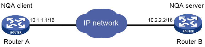

Example: Configuring an ICMP echo operation
As shown in Figure 1, configure an ICMP echo operation to test the roundtrip time between Router A and Router D through Router B.
Figure 1 Network diagram
When you configure an ICMP echo operation, follow these restrictions and guidelines:
·     Make sure the devices can reach each other before you start the ICMP echo operation.
·     You cannot modify the operation configuration for a running NQA operation.
Procedures
# Create an ICMP echo operation.
<RouterA> system-view
[RouterA] nqa entry admin test
[RouterA-nqa-admin-test] type icmp-echo
# Specify the destination IP address of ICMP echo requests as 60.1.1.1.
[RouterA-nqa-admin-test-icmp-echo] destination ip 60.1.1.1
# Specify the next hop of ICMP echo requests as 10.1.1.2.
[RouterA-nqa-admin-test-icmp-echo] next-hop ip 10.1.1.2
# Configure the ICMP echo operation to perform 10 probes.
[RouterA-nqa-admin-test-icmp-echo] probe count 10
# Specify the probe timeout time as 500 milliseconds for the ICMP echo operation.
[RouterA-nqa-admin-test-icmp-echo] probe timeout 500
# Configure the ICMP echo operation to repeat at an interval of 5000 milliseconds.
[RouterA-nqa-admin-test-icmp-echo] frequency 5000
# Enable saving history records.
[RouterA-nqa-admin-test-icmp-echo] history-record enable
# Configure the maximum number of history records that can be saved as 10.
[RouterA-nqa-admin-test-icmp-echo] history-record number 10
[RouterA-nqa-admin-test-icmp-echo] quit
# Start the ICMP echo operation.
[RouterA] nqa schedule admin test start-time now lifetime forever
# After the ICMP echo operation runs for a time period, stop the operation.
[RouterA] undo nqa schedule admin test
# Display the most recent result of the ICMP echo operation.
[RouterA] display nqa result admin test
NQA entry (admin admin, tag test) test results:
    Send operation times: 10             Receive response times: 10
    Min/Max/Average round trip time: 2/5/3
    Square-Sum of round trip time: 96
    Last succeeded probe time: 2021-03-23 15:00:01.2
  Extended results:
    Packet loss ratio: 0%
    Failures due to timeout: 0
    Failures due to internal error: 0
    Failures due to other errors: 0
# Display the history records of the ICMP echo operation.
[RouterA] display nqa history admin test
NQA entry (admin admin, tag test) history records:
Index      Response     Status           Time
370        3            Succeeded        2021-03-23 15:00:01.2
369        3            Succeeded        2021-03-23 15:00:01.2
368        3            Succeeded        2021-03-23 15:00:01.2
367        5            Succeeded        2021-03-23 15:00:01.2
366        3            Succeeded        2021-03-23 15:00:01.2
365        3            Succeeded        2021-03-23 15:00:01.2
364        3            Succeeded        2021-03-23 15:00:01.1
363        2            Succeeded        2021-03-23 15:00:01.1
362        3            Succeeded        2021-03-23 15:00:01.1
361        2            Succeeded        2021-03-23 15:00:01.1
The output shows that the packets sent by Router A can reach Router D through Router B. No packet loss occurs during the operation. The minimum, maximum, and average round-trip times are 2, 5, and 3 milliseconds, respectively.

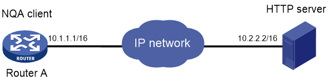

As shown in Figure 2, configure a DHCP operation to test the time required for Router A to obtain an IP address from the DHCP server (Router B).
Figure 2 Network diagram
When you configure a DHCP operation, follow these restrictions and guidelines:
·     Complete the DHCP server configuration before you start the DHCP operation.
·     Make sure the devices can reach each other before you start the DHCP operation.
Procedures
# Create a DHCP operation.
[RouterA-nqa-admin-test] type dhcp
# Specify the DHCP server IP address 10.1.1.2 as the destination address.
[RouterA-nqa-admin-test-dhcp] destination ip 10.1.1.2
# Enable the saving of history records.
[RouterA-nqa-admin-test-dhcp] history-record enable
[RouterA-nqa-admin-test-dhcp] quit
# Start the DHCP operation.
# After the operation runs for a time period, stop the operation.
# Display the most recent result of the DHCP operation.
  NQA entry(admin admin, tag test) test results:
      Send operation times: 1              Receive response times: 1
      Min/Max/Average round trip time: 624/624/624
      Square-Sum of round trip time: 389376
      Last succeeded probe time: 2021-03-24 09:56:03.2
    Extend results:
# Display the history records of the DHCP operation.
NQA entry(admin admin, tag test) history records:
    1          624          Succeeded        2021-03-24 09:56:03.2
The output shows that it took Router A 624 milliseconds to obtain an IP address from the DHCP server.

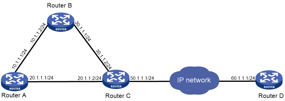

As shown in Figure 3, configure an FTP operation to test the file transmission time between Router A and the FTP server. The login username and password are admin and systemtest, respectively.
Figure 3 Network diagram
When you configure an FTP operation, follow these restrictions and guidelines:
·     Make sure the devices can reach each other before you start the FTP operation.
·     When you perform the put operation with the filename command configured, make sure the file exists on the NQA client.
·     Take the network bandwidth into consideration when you set the file size and the probe timeout.
Procedures
# Create an FTP operation.
[RouterA-nqa-admin-test] type ftp
# Specify the URL of the FTP server.
[RouterA-nqa-admin-test-ftp] url ftp://10.2.2.2
# Specify 10.1.1.1 as the source IP address.
[RouterA-nqa-admin-test-ftp] source ip 10.1.1.1
# Specify the FTP operation type as put.
[RouterA-nqa-admin-test-ftp] operation put
# Specify the file to be uploaded as config.txt.
[RouterA-nqa-admin-test-ftp] filename config.txt
# Specify the username for the FTP operation as admin.
[RouterA-nqa-admin-test-ftp] username admin
# Specify the password for the FTP operation as systemtest.
[RouterA-nqa-admin-test-ftp] password simple systemtest
[RouterA-nqa-admin-test-ftp] history-record enable
[RouterA-nqa-admin-test-ftp] quit
# Start the FTP operation.
# After the FTP operation runs for a time period, stop the operation.
# Display the most recent result of the FTP operation.
      Min/Max/Average round trip time: 173/173/173
      Square-Sum of round trip time: 29929
      Last succeeded probe time: 2021-03-25 10:07:28.6
    Extend results:
      Failures due to disconnect: 0
      Failures due to no connection: 0
# Display the history records of the FTP operation.
    1          173          Succeeded        2021-03-25 10:07:28.6
The output shows that it took Router A 173 milliseconds to upload a file to the FTP server.

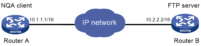

Example: Configuring a UDP jitter operation
As shown in Figure 5, configure a UDP jitter operation to test the jitter, delay, and round-trip time between Router A and Router B.
Figure 5 Network diagram
When you configure a UDP jitter operation, follow these restrictions and guidelines:
·     Make sure the devices can reach each other before you start the UDP jitter operation.
·     Configure Router B as the NQA server before you start the UDP jitter operation.
Procedures
Configuring Router B
# Enable the NQA server.
<RouterB> system-view
[RouterB] nqa server enable
# Configure a UDP listening service to listen on the IP address 10.2.2.2 and UDP port 9000.
[RouterB] nqa server udp-echo 10.2.2.2 9000
Configuring Router A
# Create a UDP jitter operation.
[RouterA-nqa-admin-test] type udp-jitter
# Configure 10.2.2.2 as the destination IP address and port 9000 as the destination port.
[RouterA-nqa-admin-test-udp-jitter] destination ip 10.2.2.2
[RouterA-nqa-admin-test-udp-jitter] destination port 9000
# Configure the operation to repeat at an interval of 1000 milliseconds.
[RouterA-nqa-admin-test-udp-jitter] frequency 1000
[RouterA-nqa-admin-test-udp-jitter] quit
# Start the UDP jitter operation.
# Stop the UDP jitter operation after the operation runs for a time period, for example, 30 seconds.

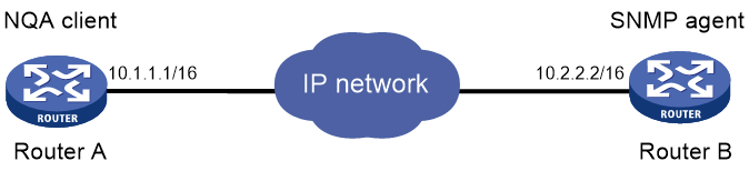

Example: Configuring an SNMP operation
As shown in Figure 6, configure an SNMP operation to test the time the NQA client uses to get a response from the SNMP agent.
Figure 6 Network diagram
When you configure an SNMP operation, follow these restrictions and guidelines:
·     Make sure the devices can reach each other before you start the SNMP operation.
·     Configure Router B as the SNMP agent before you start the SNMP operation.
Procedures
# Set the SNMP version to all.
[RouterB] snmp-agent
[RouterB] snmp-agent sys-info version all
# Set the read community to public.
[RouterB] snmp-agent community read public
# Set the write community to private.
[RouterB] snmp-agent community write private
# Create an SNMP operation.
[RouterA-nqa-admin-test] type snmp
# Configure 10.2.2.2 as the destination IP address of the SNMP operation.
[RouterA-nqa-admin-test-snmp] destination ip 10.2.2.2
[RouterA-nqa-admin-test-snmp] history-record enable
[RouterA-nqa-admin-test-snmp] quit
# Start the SNMP operation.
# Stop the SNMP operation after the operation runs for a time period, for example, 30 seconds.

[RouterA-nqa-admin-test-udp-echo] quit
# Start the UDP echo operation.
# Stop the UDP echo operation after the operation runs for a time period, for example, 30 seconds.
# Display the most recent result of the UDP echo operation.
    Min/Max/Average round trip time: 1/1/1
    Square-Sum of round trip time: 1
    Last succeeded probe time: 2021-07-30 11:10:35.2
  Extended results:
# Display the history records of the UDP echo operation.
1          1            Succeeded        2021-07-30 11:10:35.2
Configuration files
·     Router B:
 nqa server enable
 nqa server udp-echo 10.2.2.2 8000
·     Router A:
 type udp-echo
  destination port 8000
