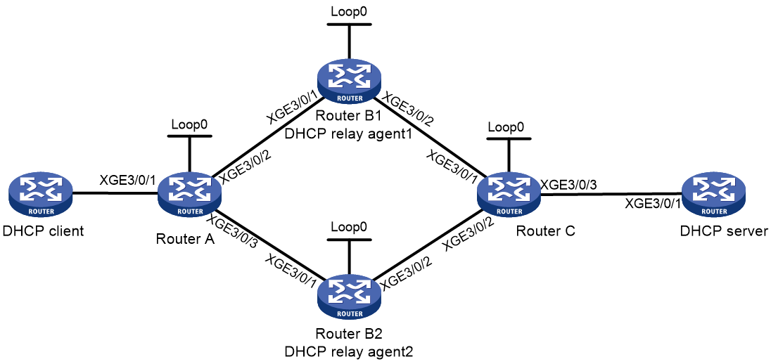

Router A and Router B communicate with each other through L2VPN. Router B1 and Router B2 act as DHCP relay agents and communicate with Router C through L3VPN. The DHCP server is deployed on the public network.
Figure 1 Network diagram
Device
Interface
IP address
Device
Interface
IP address
Router A
XGE3/0/1
2.1.1.1/24|10::1/64
Router C
XGE3/0/1
10.1.1.1/24|22::1/64
XGE3/0/2
2.1.1.2/24|11::1/64
XGE3/0/2
20.1.1.3/24|23::1/64
XGE3/0/3
3.1.1.3/24|12::1/64
XGE3/0/3
30.1.1.1/24|33::1/64
Loop0
1.1.1.1/32|1::1/128
Loop0
4.4.4.4/32|5::55/128
Router B1
XGE3/0/1
2.1.1.10/24|11::2/64
DHCP server
XGE3/0/1
30.1.1.2/24|33::2/64
XGE3/0/2
10.1.1.10/24|22::2/64
Loop0
2.2.2.2/32|44::1/128
Router B2
XGE3/0/1
3.1.1.20/24|12::2/64
XGE3/0/2
20.1.1.20/24|23::2/64
Loop0
3.3.3.3/32|66::1/128

[B1-isis-1-ipv4]quit
[B1-isis-1]address-family ipv6 unicast
[B1-isis-1-ipv6]quit
[B1-isis-1]quit
[B1]interface ten-gigabitethernet 3/0/2
[B1-Ten-GigabitEthernet3/0/2]isis enable 1
[B1-Ten-GigabitEthernet3/0/2]isis ipv6 enable 1
[B1-Ten-GigabitEthernet3/0/2]isis circuit-level level-2
[B1-Ten-GigabitEthernet3/0/2]quit
[B1]interface LoopBack 0
[B1-LoopBack0]isis enable 1
[B1-LoopBack0]isis ipv6 enable 1
[B1-LoopBack0]isis circuit-level level-2
[B1-LoopBack0]quit
# Configure Router B2.
[B2]isis 1
[B2-isis-1]network-entity 10.0000.0000.0012.00
[B2-isis-1]is-level level-2
[B2-isis-1]address-family ipv4 unicast
[B2-isis-1-ipv4]quit
[B2-isis-1]address-family ipv6 unicast
[B2-isis-1-ipv6]quit
[B2-isis-1]quit
[B2]interface ten-gigabitethernet 3/0/2
[B2-Ten-GigabitEthernet3/0/2]isis enable 1
[B2-Ten-GigabitEthernet3/0/2]isis ipv6 enable 1
[B2-Ten-GigabitEthernet3/0/2]isis circuit-level level-2
[B2-Ten-GigabitEthernet3/0/2]quit
[B2]interface LoopBack 0
[B2-LoopBack0]isis enable 1
[B2-LoopBack0]isis ipv6 enable 1
[B2-LoopBack0]isis circuit-level level-2
[B2-LoopBack0]quit
# Configure Router C.
[C]isis 1
[C-isis-1]network-entity 10.0000.0000.0004.00
[C-isis-1]is-level level-2
[C-isis-1]address-family ipv4 unicast
[C-isis-1-ipv4]quit
[C-isis-1]address-family ipv6 unicast
[C-isis-1-ipv6]quit
[C-isis-1]quit
[C]interface ten-gigabitethernet 3/0/1
[C-Ten-GigabitEthernet3/0/1]isis enable 1
[C-Ten-GigabitEthernet3/0/1]isis ipv6 enable 1
[C-Ten-GigabitEthernet3/0/1]isis circuit-level level-2
[C-Ten-GigabitEthernet3/0/1]quit
[C]interface ten-gigabitethernet 3/0/2
[C-Ten-GigabitEthernet3/0/2]isis enable 1
[C-Ten-GigabitEthernet3/0/2]isis ipv6 enable 1
[C-Ten-GigabitEthernet3/0/2]isis circuit-level level-2
[C-Ten-GigabitEthernet3/0/2]quit
[C]interface LoopBack 0
[C-LoopBack0]isis enable 1
[C-LoopBack0]isis ipv6 enable 1
[C-LoopBack0]isis circuit-level level-2
[C-LoopBack0]quit
After the configuration is completed, Router C establish an IS-IS neighbor relationship with Router B1 and Router B2 separately. Output of the display isis peer command shows that the two IS-IS neighbor relationships are in UP state. Output of the display ip routing-table command shows that Router C has learned the routes to Loopback interfaces of Router B1 and Router B2.
<C>display isis peer
                         Peer information for IS-IS(1)
 System ID: 0000.0000.0012
 Interface: XGE3/0/2                Circuit Id:  0000.0000.0012.01
 State: Up     HoldTime: 8s         Type: L2           PRI: 64
 System ID: 0000.0000.0002
 Interface: XGE3/0/1                Circuit Id:  0000.0000.0002.05
 State: Up     HoldTime: 6s         Type: L2           PRI: 64
<C>display ip routing-table
Destinations : 12        Routes : 12
Destination/Mask   Proto   Pre Cost        NextHop         Interface
0.0.0.0/32         Direct  0   0           127.0.0.1       InLoop0
4.4.4.4/32         Direct  0   0           127.0.0.1       InLoop0
3.3.3.3/32         IS_L2   15  10          20.1.1.20       XGE3/0/2
10.1.1.0/24        Direct  0   0           10.1.1.1        XGE3/0/1
10.1.1.0/32        Direct  0   0           10.1.1.1        XGE3/0/1
10.1.1.1/32        Direct  0   0           127.0.0.1       InLoop0
10.1.1.255/32      Direct  0   0           10.1.1.1        XGE3/0/1
20.1.1.0/24        Direct  0   0           20.1.1.3        XGE3/0/2
20.1.1.0/32        Direct  0   0           20.1.1.3        XGE3/0/2
20.1.1.1/32        Direct  0   0           127.0.0.1       InLoop0
20.1.1.255/32      Direct  0   0           20.1.1.3        XGE3/0/2
2.2.2.2/32         IS_L2   15  10          10.1.1.10       XGE3/0/1
2.     Configure basic MPLS and MPLS LDP.
# Configure Router B1.
[B1-Ten-GigabitEthernet3/0/2]mpls enable
[B1-Ten-GigabitEthernet3/0/2]mpls ldp enable
[B2-Ten-GigabitEthernet3/0/2]mpls enable
[B2-Ten-GigabitEthernet3/0/2]mpls ldp enable
# Configure Router C. Make sure the LSR ID is the same as the Loopback interface IP address.
[C]mpls lsr-id 4.4.4.4
[C]mpls ldp
[C-ldp]lsp-trigger all
[C-ldp]quit
[C-Ten-GigabitEthernet3/0/1]mpls enable
[C-Ten-GigabitEthernet3/0/1]mpls ldp enable
3.     Create a VPN instance.
[B1]ip vpn-instance ipran
[B1-vpn-instance-ipran]route-distinguisher 207:1
[B1-vpn-instance-ipran]vpn-target 117:1 both
[B1-vpn-instance-ipran]quit
[B1]interface VE-L3VPN 7
[B1-VE-L3VPN7]ip binding vpn-instance ipran
[B1-VE-L3VPN7]ip address 25.2.0.1 24
[B1-VE-L3VPN7]mac-address 586a-b100-0001
[B1-VE-L3VPN7]ipv6 address 6::1 64
[B1-VE-L3VPN7]quit
[B2]ip vpn-instance ipran
[B2-vpn-instance-ipran]route-distinguisher 207:1
[B2-vpn-instance-ipran]vpn-target 117:1 both
[B2-vpn-instance-ipran]quit
[B2]interface VE-L3VPN 7
[B2-VE-L3VPN7]ip binding vpn-instance ipran
[B2-VE-L3VPN7]ip address 25.2.0.1 24
[B2-VE-L3VPN7]mac-address 586a-b100-0001
[B2-VE-L3VPN7]ipv6 address 6::1 64
[B2-VE-L3VPN7]quit
[C]ip vpn-instance ipran
[C-vpn-instance-ipran]route-distinguisher 207:1
[C-vpn-instance-ipran]vpn-target 117:1 both
[C-vpn-instance-ipran]quit
[C]interface ten-gigabitethernet 3/0/3
[C-Ten-GigabitEthernet3/0/3]ip binding vpn-instance ipran
[C-Ten-GigabitEthernet3/0/3]ip address 30.1.1.1 255.255.255.0
[C-Ten-GigabitEthernet3/0/3]ipv6 address 3::1/64
[C-Ten-GigabitEthernet3/0/3]quit
4.     Configure IBGP peers.
a.     Configure Router B1.
# Configure IBGP peers.
[B1]bgp 100
[B1-bgp-default]peer 4.4.4.4 as-number 100
[B1-bgp-default]peer 4.4.4.4 connect-interface LoopBack0
[B1-bgp-default]address-family vpnv4
[B1-bgp-default-vpnv4]peer 4.4.4.4 enable
[B2-bgp-default-vpnv4]quit
[B2-bgp-default]address-family vpnv6
[B1-bgp-default-vpnv6]peer 4.4.4.4 enable
[B1-bgp-default-vpnv6]quit
# Redistribute direct routes to the related VPN instance.
[B1-bgp-default]ip vpn-instance ipran
[B1-bgp-default-ipran]address-family ipv4 unicast
[B1-bgp-default-ipv4-ipran]import-route direct
[B1-bgp-default-ipv4-ipran]quit
[B1-bgp-default-ipran]address-family ipv6 unicast
[B1-bgp-default-ipv6-ipran]import-route direct
[B1-bgp-default-ipv6-ipran]quit
[B1-bgp-default-ipran]quit
[B1-bgp-default]quit
b.     Configure Router B2.
[B2]bgp 100
[B2-bgp-default]peer 4.4.4.4 as-number 100
[B2-bgp-default]peer 4.4.4.4 connect-interface LoopBack 0
[B2-bgp-default]address-family vpnv4
[B2-bgp-default-vpnv4]peer 4.4.4.4 enable
[B2-bgp-default-vpnv6]peer 4.4.4.4 enable
[B2-bgp-default-vpnv6]quit
[B2-bgp-default]ip vpn-instance ipran
[B2-bgp-default-ipran]address-family ipv4 unicast
[B2-bgp-default-ipv4-ipran]import-route direct
[B2-bgp-default-ipv4-ipran]quit
[B2-bgp-default-ipran]address-family ipv6 unicast
[B2-bgp-default-ipv6-ipran]import-route direct
[B2-bgp-default-ipv6-ipran]quit
[B2-bgp-default-ipran]quit
[B2-bgp-default]quit
c.     Configure Router C.
[C]bgp 100
[C-bgp-default]peer 2.2.2.2 as-number 100
[C-bgp-default]peer 2.2.2.2 connect-interface LoopBack 0
[C-bgp-default]peer 3.3.3.3 as-number 100
[C-bgp-default]peer 3.3.3.3 connect-interface LoopBack 0
[C-bgp-default]address-family vpnv4
[C-bgp-default-vpnv4]peer 2.2.2.2 enable
[C-bgp-default-vpnv4]peer 3.3.3.3 enable
[C-bgp-default-vpnv4]quit
[C-bgp-default]address-family vpnv6
[C-bgp-default-vpnv6]peer 2.2.2.2 enable
[C-bgp-default-vpnv6]peer 3.3.3.3 enable
[C-bgp-default-vpnv6]quit
[C-bgp-default]ip vpn-instance ipran
[C-bgp-default-ipran]address-family ipv4 unicast
[C-bgp-default-ipv4-ipran]import-route direct
[C-bgp-default-ipv4-ipran]quit
[C-bgp-default-ipran]address-family ipv6 unicast
[C-bgp-default-ipv6-ipran]import-route direct
[C-bgp-default-ipv6-ipran]quit
[C-bgp-default-ipran]quit
[C-bgp-default]quit
After the configuration is completed, Router C establishes an IBGP peer relationship with Router B1 and Router B2 separately. Outputs of the display bgp peer vpnv4 and display bgp peer vpnv6 commands show that the IBGP peer relationships are all in Established state.
<C>display bgp peer vpnv4
 BGP local router ID: 4.4.4.4
 Local AS number: 100
 Total number of peers: 2                  Peers in established state: 2
 * - Dynamically created peer
 Peer                    AS  MsgRcvd  MsgSent OutQ  PrefRcv Up/Down  State
 3.3.3.3                100      105      120    0        0 01:32:51 Established
 2.2.2.2                100     1550     1241    0        1 19:33:46 Established
<C>display bgp peer vpnv6
 3.3.3.3                100      106      121    0        0 01:33:32 Established
 2.2.2.2                100     1551     1242    0        1 19:34:27 Established
Configuring DHCP
1.     Configure the DHCP relay agent.
# Configure the DHCPv4 relay settings.
<B1> system-view
[B1] dhcp enable
[B1] interface VE-L3VPN 7
[B1-VE-L3VPN7]dhcp select relay
[B1-VE-L3VPN7]dhcp relay information enable
[B1-VE-L3VPN7]dhcp relay server-address 30.1.1.2
[B1-VE-L3VPN7]dhcp relay source-address 44.4.0.1
[B1-VE-L3VPN7]ip address 44.4.0.1 24 sub
# Configure the DHCPv6 relay settings.
[B1-VE-L3VPN7]ipv6 nd autoconfig managed-address-flag
[B1-VE-L3VPN7]ipv6 nd autoconfig other-flag
[B1-VE-L3VPN7]undo ipv6 nd ra halt
[B1-VE-L3VPN7]ipv6 dhcp select relay
[B1-VE-L3VPN7]ipv6 dhcp relay server-address 33::2
[B1-VE-L3VPN7]ipv6 dhcp relay source-address 44::1
[B1-VE-L3VPN7]quit
# Configure an IPv6 address for the Loopback interface. This configuration ensures that the related DHCPv6 routes are reachable.
[B1]interface LoopBack 7
[B1-LoopBack7]ip binding vpn-instance ipran
[B1-LoopBack7]ipv6 address 44::1 128
[B1-LoopBack7]quit
<B2> system-view
[B1] dhcp enable
[B2] interface VE-L3VPN 7
[B2-VE-L3VPN7]dhcp select relay
[B2-VE-L3VPN7]dhcp relay information enable
[B2-VE-L3VPN7]dhcp relay server-address 30.1.1.2
[B2-VE-L3VPN7]dhcp relay source-address 45.4.0.1
[B2-VE-L3VPN7]ip address 45.4.0.1 24 sub
[B2-VE-L3VPN7]ipv6 nd autoconfig managed-address-flag
[B2-VE-L3VPN7]ipv6 nd autoconfig other-flag
[B2-VE-L3VPN7]undo ipv6 nd ra halt
[B2-VE-L3VPN7]ipv6 dhcp select relay
[B2-VE-L3VPN7]ipv6 dhcp relay server-address 33::2
[B2-VE-L3VPN7]ipv6 dhcp relay source-address 45::1
[B2-VE-L3VPN7]quit
[B2]interface LoopBack 7
[B2-LoopBack7]ip binding vpn-instance ipran
[B2-LoopBack7]ipv6 address 45::1 128
[B2-LoopBack7]quit
2.     Configure the DHCP server.
# Configure a DHCPv4 address pool.
[server]dhcp enable
[server]ip pool poolv4
[server-ip-pool-poolv4]gateway-list 25.2.0.1
[server-ip-pool-poolv4]network 25.2.0.1 24
[server-ip-pool-poolv4]forbidden-ip 25.2.0.1
[server-ip-pool-poolv4]quit
# Configure a DHCPv6 address pool.
[server]ipv6 pool poolv6
[server-ipv6-pool-poolv6]network 6::/64
[server-ipv6-pool-poolv6]gateway-list 6::1
[server-ipv6-pool-poolv6]quit
# Enable the DHCPv6 server.
[server]interface ten-gigabitEthernet3/0/1
[server-Ten-GigabitEthernet3/0/1]ipv6 dhcp select server
[server-Ten-GigabitEthernet3/0/1]quit
# Configure static routes.
[server]ip route-static 25.2.0.0 24 30.1.1.1
[server]ip route-static 44.4.0.0 24 30.1.1.1
[server]ip route-static 45.4.0.0 24 30.1.1.1
[server]ipv6 route-static 6:: 64 33::1
[server]ipv6 route-static 44::1 128 33::1
[server]ipv6 route-static 45::1 128 33::1
On the DHCP server, execute the display dhcp server ip-in-use command to view the assigned IPv4 addresses and the display ipv6 dhcp server ip-in-use command to view the assigned IPv6 addresses.
[server]display dhcp server ip-in-use
IP address       Client identifier/    Lease expiration      Type
                 Hardware address
25.2.0.2         0100-1094-1a7d-f5     Dec 19 10:14:27 2019  Auto(C)
[server]display ipv6 dhcp server ip-in-use
Pool: poolv6
 IPv6 address                Type      Lease expiration         DUID
 6::2                        Auto(C)   Jan 18 09:59:55 2020     0003000211df605b0300
