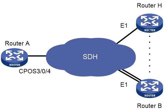

As shown in Figure 1, branch nodes Router B through Router H are uplinked to the central node Router A through E1 links. Router A aggregates these E1 links by using a CPOS interface.
Add one additional E1 link on Router B to expand its capacity, and use an MP-group interface to bind the two E1 links.
Figure 1 Network diagram
For correct network synchronization, make sure the master clock mode is configured on the SONET/SDH devices connected to the routers.
