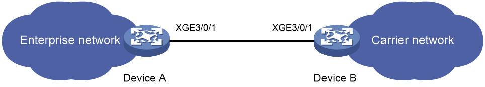

As shown in Figure 1, the edge devices Device A and Device B connect the enterprise network and the carrier network. Configure Ethernet OAM on Device A and Device B to meet the following Service Level Agreement (SLA) requirements:
· Device A and Device B automatically monitor the link between them.
· The administrator can view critical link events on the link between Device A and Device B.
· The administrator can obtain the link status by observing link error event statistics.

The output shows that no critical link event has occurred on the link between Device A and Device B.

The output shows the following information:
· 350 errors have occurred after Ethernet OAM is enabled on Device A.
· 17 errors are caused by error frames.
· The link is unstable.
NOTE: If the link is unstable, contact H3C Support. |
