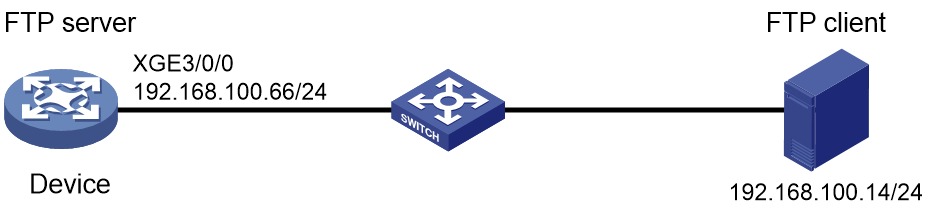

As shown in Figure 1, use TFTP to download a software upgrade file from a TFTP server to upgrade the device.
Figure 1 Network diagram

1.     Configure the TFTP server:
# Assign the IP address 192.168.100.14/24 to the TFTP server. (Details not shown.)
# Start the TFTP server and specify a working directory. (Details not shown.)
2.     Upgrade the device:
# Assign an IP address to Ten-GigabitEthernet 3/1/0. Make sure the device can reach the TFTP server.

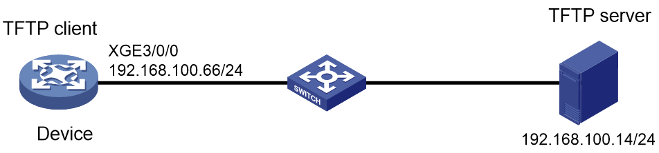

As shown in Figure 2, use FTP to download a software upgrade file from an FTP server to upgrade the device.
Figure 2 Network diagram

1.     Configure the FTP server:
# Assign the IP address 192.168.100.14/24 to the FTP server. (Details not shown.)
# Start the FTP server and specify a working directory. (Details not shown.)
# Add a local user account. (Details not shown.)
# Set the username to 123456 and the password to 123456 for the user account. (Details not shown.)
# Assign an IP address to Ten-GigabitEthernet 3/1/0. Make sure the device can reach the FTP server.

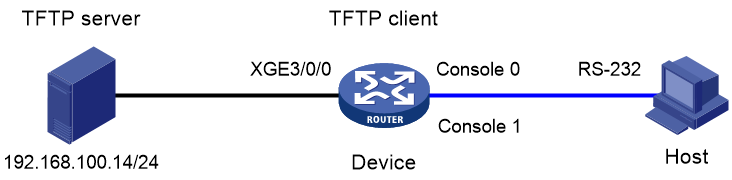

Example: Using the device as an FTP server to upgrade software
As shown in Figure 3, enable the FTP server and configure a local user account on the device to provide FTP service. Use FTP to upload a software upgrade file from an FTP client to upgrade the device.
Figure 3 Network diagram
When you upgrade software, follow these restrictions and guidelines:
·     Make sure the device has sufficient storage space for the upgrade file. If the device does not have sufficient storage space, delete unused files by using the delete /unreserved file-url command.
·     Save the running configuration before the upgrade for the configuration to survive a reboot.
·     If the device has two MPUs, you must upgrade both MPUs for the device to operate correctly.

Upgrading software from the BootWare menu
Example: Using the device as a TFTP client to upgrade software
As shown in Figure 4, the device cannot start up.
Use TFTP to upgrade the device from the BootWare menu.
Figure 4 Network diagram
When you upgrade software, make sure the device has sufficient storage space for the upgrade file. If the device does not have sufficient storage space, delete unused files by using the delete /unreserved file-url command.
Procedures
