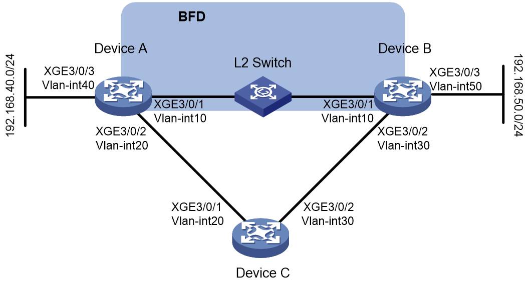

Example: Configuring BFD for static routing
As shown in Figure 2:
·     Device A has two paths to reach Device B: one over a Layer 2 switch, and the other over Device C.
·     A Layer 2 switch connects Device A and Device B.
Because Device B does not support BFD, enable BFD echo packet mode on Device A. When the link between Device B and the Layer 2 switch fails, Device A switches the path over Device C to reach Device B.
Figure 2 Network diagram
Device
Interface
IP address
Device A
XGE3/0/1
192.168.10.101/24
Device A
XGE3/0/2
192.168.20.101/24
Device A
XGE3/0/3
192.168.40.101/24
Device B
XGE3/0/1
192.168.10.102/24
Device B
XGE3/0/2
192.168.30.101/24
Device B
XGE3/0/3
192.168.50.101/24
Device C
XGE3/0/1
192.168.20.102/24
Device C
XGE3/0/2
192.168.30.102/24

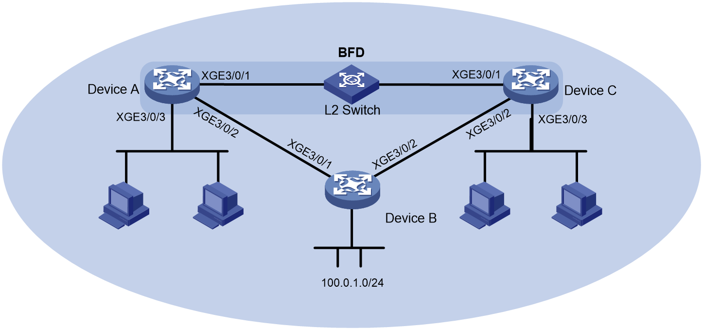

Example: Configuring BFD for RIP
As shown in Figure 3, Device A, Device B, and Device C run RIP. Device A and Device C are connected through a Layer 2 switch.
Enable BFD echo packet mode on Device A (Device C does not support BFD) to monitor the path over the Layer 2 switch. When BFD detects a link failure, it notifies RIP to switch to the path over Device B.
Figure 3 Network diagram
Device
Interface
IP address
Device A
XGE3/0/1
10.1.0.101/24
Device A
XGE3/0/2
192.168.0.101/24
Device A
XGE3/0/3
120.1.1.1/24
Device B
XGE3/0/1
192.168.0.102/24
Device B
XGE3/0/2
13.1.1.101/24
Device C
XGE3/0/1
10.1.0.102/24
Device C
XGE3/0/2
13.1.1.102/24
Device C
XGE3/0/3
121.1.1.1/24
Procedures
Configuring interface IP addresses
1.     Configure Device A:
<DeviceA> system-view
[DeviceA] interface ten-gigabitethernet 3/0/1
[DeviceA-Ten-GigabitEthernet3/0/1] ip address 10.1.0.101 24
[DeviceA-Ten-GigabitEthernet3/0/1] quit
2.     Configure other devices in the same way Device A is configured. (Details not shown.)
Configuring RIP
# Configure basic RIP functions, import direct routes, and enable BFD for RIP.
[DeviceA] rip 1
[DeviceA-rip-1] version 2
[DeviceA-rip-1] undo summary
[DeviceA-rip-1] network 10.1.0.0
[DeviceA-rip-1] network 192.168.0.0
[DeviceA-rip-1] import-route direct
[DeviceA-rip-1] quit
[DeviceA-Ten-GigabitEthernet3/0/1] rip bfd enable
2.     Configure Device B:
# Configure basic RIP functions, and import direct routes.
<DeviceB> system-view
[DeviceB] rip 1
[DeviceB-rip-1] version 2
[DeviceB-rip-1] undo summary
[DeviceB-rip-1] network 192.168.0.0
[DeviceB-rip-1] network 13.1.1.0
[DeviceB-rip-1] import-route direct
[DeviceB-rip-1] quit
3.     Configure Device C:
<DeviceC> system-view
[DeviceC] rip 1
[DeviceC-rip-1] version 2
[DeviceC-rip-1] undo summary
[DeviceC-rip-1] network 10.1.0.0
[DeviceC-rip-1] network 13.1.1.0
[DeviceC-rip-1] import-route direct
[DeviceC-rip-1] quit
Configuring BFD parameters on Device A
# Configure the source IP address for BFD echo packets.
[DeviceA] bfd echo-source-ip 11.11.11.11
# Configure the minimum interval for receiving BFD echo packets and the single-hop detection time multiplier.
[DeviceA-Ten-GigabitEthernet3/0/1] bfd min-echo-receive-interval 100
[DeviceA-Ten-GigabitEthernet3/0/1] bfd detect-multiplier 3
# Display BFD session information on Device A.
[DeviceA] display bfd session verbose
 Total Session Num: 1     Up Session Num: 1     Init Mode: Active
 IPv4 Session Working Under Echo Mode:
       Local Discr: 2049
         Source IP: 10.1.0.101         Destination IP: 10.1.0.102
     Session State: Up                      Interface: Ten-GigabitEthernet3/0/1
         Hold Time: 300ms                Act Tx Inter: 100ms
      Min Rx Inter: 100ms                Detect Inter: 300ms
          Rx Count: 464                      Tx Count: 465
      Connect Type: Direct             Running Up for: 00:00:46
       Detect Mode: Async                        Slot: 0
          Protocol: RIP
         Diag Info: No Diagnostic
The output shows that a BFD session has been established and is up.

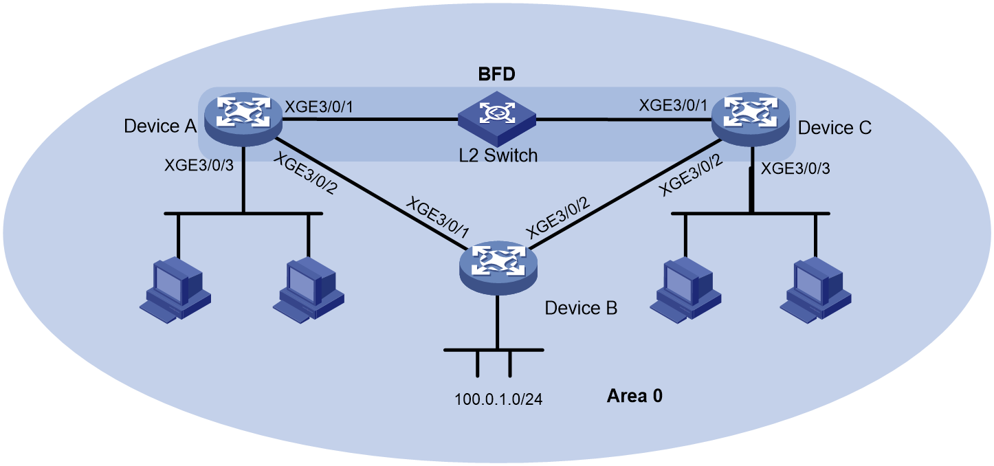

Example: Configuring BFD for OSPF
As shown in Figure 4, Device A, Device B, and Device C run OSPF. Device A and Device C are connected through a Layer 2 switch.
Enable BFD control packet mode on Device A and Device C to monitor the path over the Layer 2 switch. When BFD detects a link failure, it notifies OSPF to switch to the path over Device B.
Figure 4 Network diagram
Table 3 Interface and IP address assignment
Device
Interface
IP address
Device A
XGE3/0/1
10.1.0.101/24
Device A
XGE3/0/2
192.168.0.101/24
Device A
XGE3/0/3
120.1.1.1/24
Device B
XGE3/0/1
192.168.0.102/24
Device B
XGE3/0/2
13.1.1.101/24
Device C
XGE3/0/1
10.1.0.102/24
Device C
XGE3/0/2
13.1.1.102/24
Device C
XGE3/0/3
121.1.1.1/24

The output shows that Device A communicates with Device C through the Layer 2 switch.

The output shows that BFD can quickly detect the failure and notify OSPF.

The output shows that Device A communicates with Device C through Device B.

As shown in Figure 5, Device A, Device B, and Device C run IS-IS. Device A and Device C are connected through a Layer 2 switch.
Enable BFD control packet mode on Device A and Device C to monitor the path over the Layer 2 switch. When BFD detects a link failure, it notifies IS-IS to switch to the path over Device B.
Figure 5 Network diagram
Table 4 Interface and IP address assignment

The output shows that Device A has established IS-IS neighbor relationship with Device C.

The output shows that BFD sessions have been established and are up.

The output shows that BFD can quickly detect the failure and notify IS-IS.

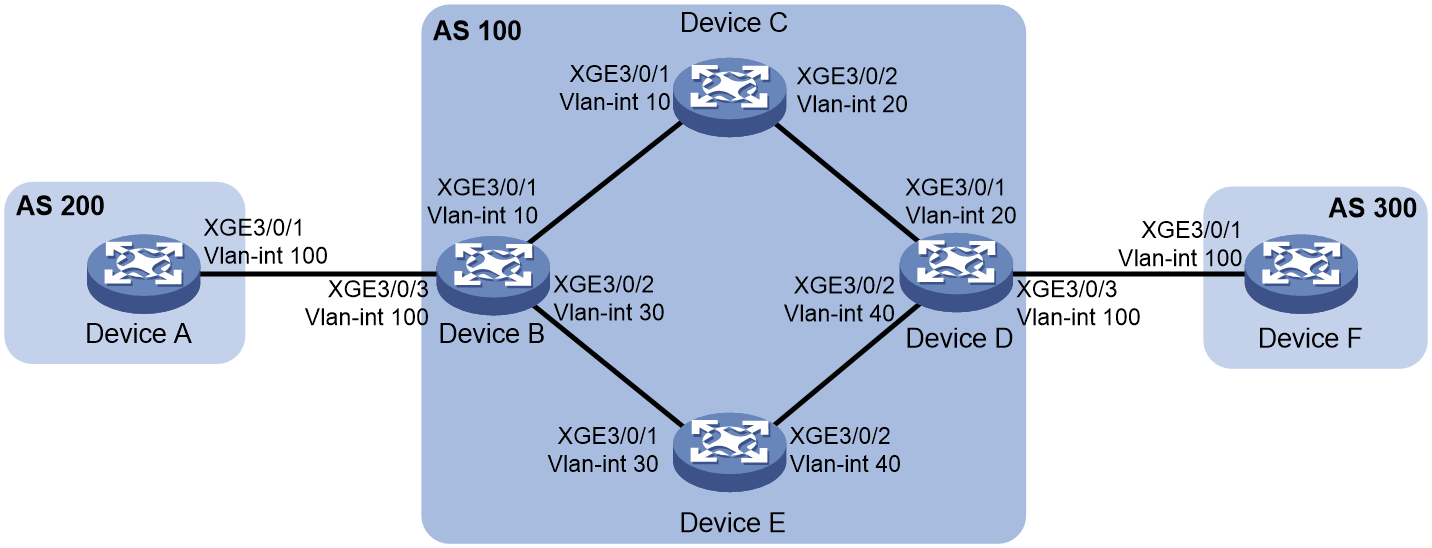

As shown in Figure 6, the devices in AS 100 run OSPF to reach each other. There are two paths between Device B and Device D:
·     Path A—Path over Device C.
·     Path B—Path over Device E.
When both paths are available, BGP uses the path over Device C to forward traffic between Device A and Device F.
Enable BFD control packet mode on Device B and Device D to monitor the path over Device C. When BFD detects a link failure, it notifies BGP to switch to the path over Device E.
Figure 6 Network diagram
Table 5 Interface and IP address assignment

Device D
XGE3/0/1
10.2.0.101/24
Device D
XGE3/0/2
13.1.1.101/24
Device D
XGE3/0/3
120.2.0.2/24
Device E
XGE3/0/1
192.168.0.102/24
Device E
XGE3/0/2
13.1.1.102/24
Device F
XGE3/0/1
120.2.0.1/24
Analysis
For Path A to become the primary path, use a routing policy to set a lower cost for Path A than Path B.
In BFD control packet mode, a minimum of one end must operate in active mode for a BFD session to be established.
Procedures
[DeviceA-Ten-GigabitEthernet3/0/1] ip address 120.1.0.1 24
Configuring OSPF in AS 100
1.     Configure Device B:
[DeviceB] ospf
[DeviceB-ospf-1] import-route direct
[DeviceB-ospf-1] area 0
[DeviceB-ospf-1-area-0.0.0.0] network 10.1.0.0 0.0.0.255
[DeviceB-ospf-1-area-0.0.0.0] network 192.168.0.0 0.0.0.255
[DeviceB-ospf-1-area-0.0.0.0] quit
[DeviceB-ospf-1] quit
2.     Configure Device C:
[DeviceC] ospf
[DeviceC-ospf-1] area 0
[DeviceC-ospf-1-area-0.0.0.0] network 10.1.0.0 0.0.0.255
[DeviceC-ospf-1-area-0.0.0.0] network 10.2.0.0 0.0.0.255
[DeviceC-ospf-1-area-0.0.0.0] quit
[DeviceC-ospf-1] quit
3.     Configure Device D:
[DeviceD] ospf
[DeviceD-ospf-1] import-route direct
[DeviceD-ospf-1] area 0
[DeviceD-ospf-1-area-0.0.0.0] network 10.2.0.0 0.0.0.255
[DeviceD-ospf-1-area-0.0.0.0] network 13.1.1.0 0.0.0.255
[DeviceD-ospf-1-area-0.0.0.0] quit
[DeviceD-ospf-1] quit
4.     Configure Device E:
[DeviceE] ospf
[DeviceE-ospf-1] area 0
[DeviceE-ospf-1-area-0.0.0.0] network 13.1.1.0 0.0.0.255
[DeviceE-ospf-1-area-0.0.0.0] network 192.168.0.0 0.0.0.255
[DeviceE-ospf-1-area-0.0.0.0] quit
[DeviceE-ospf-1] quit
Configuring BGP
# Enable BGP and set the local AS number to 200.
[DeviceA] bgp 200
[DeviceA-bgp-default] router-id 1.1.1.1
# Establish an EBGP connection with Device B.
[DeviceA-bgp-default] peer 120.1.0.2 as-number 100
# Create the BGP IPv4 unicast address family and enter its view.
[DeviceA-bgp-default] address-family ipv4 unicast
# In BGP IPv4 unicast address family view, inject local network 120.1.0.0/24 to the BGP routing table.
[DeviceA-bgp-default-ipv4] network 120.1.0.0 255.255.255.0
# Enable BGP to exchange IPv4 unicast routing information with peer 120.1.0.2.
[DeviceA-bgp-default-ipv4] peer 120.1.0.2 enable
[DeviceA-bgp-default-ipv4] quit
# Enable BGP and set the local AS number to 100.
[DeviceB] bgp 100
[DeviceB-bgp-default] router-id 2.2.2.2
# Establish an EBGP connection with Device A.
[DeviceB-bgp-default] peer 120.1.0.1 as-number 200
# Establish IBGP connections with Device D.
[DeviceB-bgp-default] peer 10.2.0.101 as-number 100
[DeviceB-bgp-default] peer 13.1.1.101 as-number 100
[DeviceB-bgp-default] address-family ipv4 unicast
# Enable BGP to exchange IPv4 unicast routing information with peer 10.2.0.101.
[DeviceB-bgp-default-ipv4] peer 10.2.0.101 enable
# In BGP IPv4 unicast address family view, specify the device as the next hop for routes sent to peer 10.2.0.101.
[DeviceB-bgp-default-ipv4] peer 10.2.0.101 next-hop-local
# Enable BGP to exchange IPv4 unicast routing information with peer 13.1.1.101.
[DeviceB-bgp-default-ipv4] peer 13.1.1.101 enable
# In BGP IPv4 unicast address family view, specify the device as the next hop for routes sent to peer 13.1.1.101.
[DeviceB-bgp-default-ipv4] peer 13.1.1.101 next-hop-local
# Enable BGP to exchange IPv4 unicast routing information with peer 120.1.0.1.
[DeviceB-bgp-default-ipv4] peer 120.1.0.1 enable
[DeviceB-bgp-default-ipv4] quit
[DeviceD] bgp 100
[DeviceD-bgp-default] router-id 4.4.4.4
# Establish IBGP connections with Device B.
[DeviceD-bgp-default] peer 10.1.0.101 as-number 100
[DeviceD-bgp-default] peer 192.168.0.101 as-number 100
# Establish an EBGP connection with Device F.
[DeviceD-bgp-default] peer 120.2.0.1 as-number 300
[DeviceD-bgp-default] address-family ipv4 unicast
# Enable BGP to exchange IPv4 unicast routing information with peer 10.1.0.101.
[DeviceD-bgp-default-ipv4] peer 10.1.0.101 enable
# In BGP IPv4 unicast address family view, specify the device as the next hop for routes sent to peer 10.1.0.101.
[DeviceD-bgp-default-ipv4] peer 10.1.0.101 next-hop-local
# Enable BGP to exchange IPv4 unicast routing information with peer 192.168.0.101.
[DeviceD-bgp-default-ipv4] peer 192.168.0.101 enable
# In BGP IPv4 unicast address family view, specify the device as the next hop for routes sent to peer 192.168.0.101.
[DeviceD-bgp-default-ipv4] peer 192.168.0.101 next-hop-local
# Enable BGP to exchange IPv4 unicast routing information with peer 120.2.0.1.
[DeviceD-bgp-default-ipv4] peer 120.2.0.1 enable
[DeviceD-bgp-default-ipv4] quit
4.     Configure Device F:
# Enable BGP and set the local AS number to 300.
[DeviceF] bgp 300
[DeviceF-bgp-default] router-id 6.6.6.6
# Establish an EBGP connection with Device D.
[DeviceF-bgp-default] peer 120.2.0.2 as-number 100
[DeviceF-bgp-default] address-family ipv4 unicast
# In BGP IPv4 unicast address family view, inject local network 120.2.0.0/24 to the BGP routing table.
[DeviceF-bgp-default-ipv4] network 120.2.0.0 255.255.255.0
# Enable BGP to exchange IPv4 unicast routing information with peer 120.2.0.2.
[DeviceF-bgp-default-ipv4] peer 120.2.0.2 enable
[DeviceF-bgp-default-ipv4] quit
Configuring routing policies
# Create ACL 2000 to permit packets sourced from 120.1.0.0/24.
[DeviceB] acl basic 2000
[DeviceB-acl-ipv4-basic-2000] rule permit source 120.1.0.0 0.0.0.255
[DeviceB-acl-ipv4-basic-2000] quit
# Set a local preference of 200 for routes advertised to peer 10.2.0.101, and set the preference for IBGP routes to 100.
[DeviceB] route-policy local-pre permit node 10
[DeviceB-route-policy-local-pre-10] if-match ip address acl 2000
[DeviceB-route-policy-local-pre-10] apply local-preference 200
[DeviceB-route-policy-local-pre-10] quit
[DeviceB] bgp 100
[DeviceB-bgp-default-ipv4] peer 10.2.0.101 route-policy local-pre export
[DeviceB-bgp-default-ipv4] preference 255 100 130
[DeviceB-bgp-default] quit
2.     Configure Device D:
# Create ACL 2000 to permit packets sourced from 120.2.0.0/24.
[DeviceD] acl basic 2000
[DeviceD-acl-ipv4-basic-2000] rule permit source 120.2.0.0 0.0.0.255
[DeviceD-acl-ipv4-basic-2000] quit
# Set a local preference of 200 for routes learned from peer 10.1.0.101, and configure the preference for IBGP routes as 100.
[DeviceD] route-policy local-pre permit node 10
[DeviceD-route-policy-local-pre-10] if-match ip address acl 2000
[DeviceD-route-policy-local-pre-10] apply local-preference 200
[DeviceD-route-policy-local-pre-10] quit
[DeviceD] bgp 100
[DeviceD-bgp-default-ipv4] peer 10.1.0.101 route-policy local-pre export
[DeviceD-bgp-default-ipv4] preference 255 100 130
[DeviceD-bgp-default] quit
Configuring BFD
# Enable BFD for the link to BGP peer 10.2.0.101.
[DeviceB] bgp 100
[DeviceB-bgp-default] peer 10.2.0.101 bfd
# Enable BFD for the link to BGP peer 10.1.0.101.
[DeviceD] bgp 100
[DeviceD-bgp-default] peer 10.1.0.101 bfd
# Ping Device F from Device A to verify the connectivity.
[DeviceA] ping 120.2.0.1
Ping 120.2.0.1 (120.2.0.1): 56 data bytes, press CTRL_C to break
56 bytes from 120.2.0.1: icmp_seq=0 ttl=252 time=1.189 ms
56 bytes from 120.2.0.1: icmp_seq=1 ttl=252 time=1.095 ms
56 bytes from 120.2.0.1: icmp_seq=2 ttl=252 time=1.086 ms
56 bytes from 120.2.0.1: icmp_seq=3 ttl=252 time=1.097 ms
56 bytes from 120.2.0.1: icmp_seq=4 ttl=252 time=1.089 ms
--- Ping statistics for 120.2.0.1 ---
round-trip min/avg/max/std-dev = 1.086/1.111/1.189/0.039 ms
The output shows that Device F can be pinged successfully.
# Display BGP peer information on Device B.
[DeviceB] display bgp peer ipv4
 BGP local router ID: 2.2.2.2
 Local AS number: 100
 Total number of peers: 3                  Peers in established state: 3
  Peer                    AS  MsgRcvd  MsgSent OutQ PrefRcv Up/Down  State
  10.2.0.101             100        6        4    0       1 00:00:56 Established
  13.1.1.101             100        6        5    0       1 00:00:56 Established
  120.1.0.1              200        6        5    0       1 00:00:56 Established
The output shows the following information:
·     Two IBGP connections have been established between Device B and Device D.
·     An EBGP connection has been established between Device B and Device A.
# Display detailed BFD session information on Device B.
[DeviceB] display bfd session verbose
 Total Session Num: 1     Up Session Num: 0     Init Mode: Active
 IPv4 Session Working Under Ctrl Mode:
       Local Discr: 2049                 Remote Discr: 0
         Source IP: 10.1.0.101         Destination IP: 10.2.0.101
     Session State: UP                      Interface: N/A
      Min Tx Inter: 1000400ms               Act Tx Inter: 1000400ms
      Min Rx Inter: 1000400ms               Detect Inter: 50002000ms
          Rx Count: 0                        Tx Count: 910
      Connect Type: Indirect           Running Up for: 00:00:00
         Hold Time: 0ms                     Auth mode: None
          Protocol: BGP
# Display information about the routes to network 120.2.0.0/24 on Device B.
[DeviceB] display ip routing-table 120.2.0.0 24 verbose
Summary Count : 3
Destination: 120.2.0.0/24
   Protocol: BGP             Process ID: 0
  SubProtID: 0x1                    Age: 00h24m48s
       Cost: 0               Preference: 100
        Tag: 0                    State: Active Adv
  OrigTblID: 0x0                OrigVrf: default-vrf
    TableID: 0x2                 OrigAs: 300
      NibID: 0x15000001          LastAs: 300
     AttrID: 0x1               Neighbor: 10.2.0.101
      Flags: 0x10060        OrigNextHop: 10.2.0.101
      Label: NULL           RealNextHop: 10.1.0.102
    BkLabel: NULL             BkNextHop: N/A
Tunnel ID: Invalid          Interface: Ten-GigabitEthernet3/0/1
BkTunnel ID: Invalid        BkInterface: N/A
   Protocol: OSPF            Process ID: 1
  SubProtID: 0x8                    Age: 00h26m19s
       Cost: 1               Preference: 150
        Tag: 1                    State: Inactive Adv
    TableID: 0x2                 OrigAs: 0
      NibID: 0x13000005          LastAs: 0
     AttrID: 0xffffffff        Neighbor: 0.0.0.0
      Flags: 0x41           OrigNextHop: 10.1.0.102
      NibID: 0x13000003          LastAs: 0
      Flags: 0x41           OrigNextHop: 192.168.0.102
      Label: NULL           RealNextHop: 192.168.0.102
Tunnel ID: Invalid          Interface: Ten-GigabitEthernet3/0/2
The output shows that Device B communicates with Device D through path over Device C.
# When the path over Device C fails, ping Device F from Device A.
<DeviceA> ping 120.2.0.1
Ping 120.1.0.1 (120.2.0.1): 56 data bytes, press CTRL_C to break
56 bytes from 120.2.0.1: icmp_seq=0 ttl=252 time=0.680 ms
56 bytes from 120.2.0.1: icmp_seq=1 ttl=252 time=0.295 ms
56 bytes from 120.2.0.1: icmp_seq=2 ttl=252 time=0.423 ms
56 bytes from 120.2.0.1: icmp_seq=3 ttl=252 time=0.464 ms
56 bytes from 120.2.0.1: icmp_seq=4 ttl=252 time=0.445 ms
5 packets transmitted, 5 packets received, 0.0% packet loss
round-trip min/avg/max/std-dev = 0.295/0.461/0.680/0.124 ms
<DeviceB> display ip routing-table 120.2.0.0 24 verbose
Summary Count : 2
  SubProtID: 0x1                    Age: 00h00m18s
  SubProtID: 0x8                    Age: 00h00m18s
      NibID: 0x13000001          LastAs: 0
The output shows that Device B communicates with Device D through path over Device E.
Configuration files
·     Device A:
interface Ten-GigabitEthernet3/0/1
 port link-mode route
 ip address 120.1.0.1 255.255.255.0
bgp 200
 router-id 1.1.1.1
 peer 120.1.0.2 as-number 200
·     Device B:
ospf 1
import-route direct
 area 0.0.0.0
 ip address 10.1.0.101 255.255.255.0
interface Ten-GigabitEthernet3/0/2
 ip address 192.168.0.101 255.255.255.0
interface Ten-GigabitEthernet3/0/3
 ip address 120.1.0.2 255.255.255.0
bgp 100
 router-id 2.2.2.2
 peer 10.2.0.101 bfd
acl basic 2000
 rule 0 permit source 120.1.0.0 0.0.0.255
·     Device C:
ospf 1
 area 0.0.0.0
 ip address 10.1.0.102 255.255.255.0
 ip address 10.2.0.102 255.255.255.0
·     Device D:
ospf 1
 import-route direct
 area 0.0.0.0
 ip address 10.2.0.101 255.255.255.0
 ip address 13.1.1.101 255.255.255.0
bgp 100
 router-id 4.4.4.4
 peer 10.1.0.101 bfd
acl basic 2000
 rule 0 permit source 120.2.0.0 0.0.0.255
·     Device E:
ospf 1
 area 0.0.0.0
 ip address 192.168.0.102 255.255.255.0
 ip address 13.1.1.102 255.255.255.0
·     Device F:
 ip address 120.2.0.1 255.255.255.0
bgp 300
 router-id 6.6.6.6
