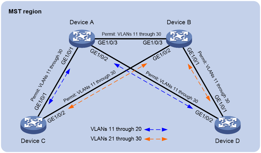

The following information uses an example to describe the basic procedure for configuring MSTP.
As shown in Figure 1, Device A and Device B operate at the core layer, and Device C and Device D operate at the distribution layer. The ports on the devices have the same path cost, and they all permit VLANs 11 through 30.
Configure MSTP to meet the following requirements:
·     Device A, Device B, Device C, and Device D belong to the same MST region.
·     MSTIs are used to share the traffic of VLANs 11 through 20 and of VLANs 21 through 30.
Figure 1 Network diagram

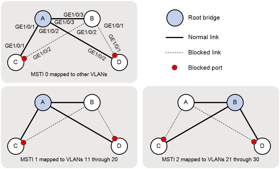

To use redundant links to share the traffic of different VLANs (as shown in Figure 2), perform the following tasks:
·     Configure Device A as the root bridge of MSTI 1.
·     Configure Device B as the root bridge of MIST 2.
·     Assign priorities to Device A, Device B, Device C, and Device D in MSTI 0 in descending order for Device A to be the regional root bridge.
Figure 2 MSTIs mapped to different VLANs

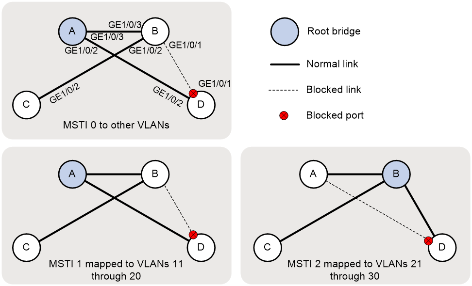

Based on the output, the topology for each MSTI is shown in Figure 3.

 0        GigabitEthernet1/0/2                ROOT  FORWARDING  NONE
 1        GigabitEthernet1/0/1                ALTE  DISCARDING  NONE
 1        GigabitEthernet1/0/2                ROOT  FORWARDING  NONE
 2        GigabitEthernet1/0/1                ROOT  FORWARDING  NONE
 2        GigabitEthernet1/0/2                ALTE  DISCARDING  NONE
Based on the output, the topology for each MSTI is shown in Figure 4.
Figure 4 MSTI topologies
