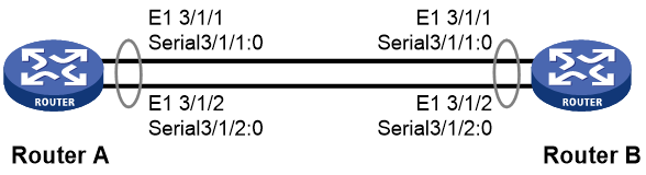

As shown in Figure 1, Router A and Router B are connected through CE1 interfaces, and the links run the PPP protocol. Bind the links into an MP link through binding the links to an MP-group interface.
Figure 1 Network diagram
Analysis
·     Configure the CE1 interfaces to operate in unchannelized E1 mode. Then, the system will automatically create synchronous serial interfaces.
·     Create an MP-group interface, and assign the synchronous serial interfaces to the MP-group interface for MP bundling.
