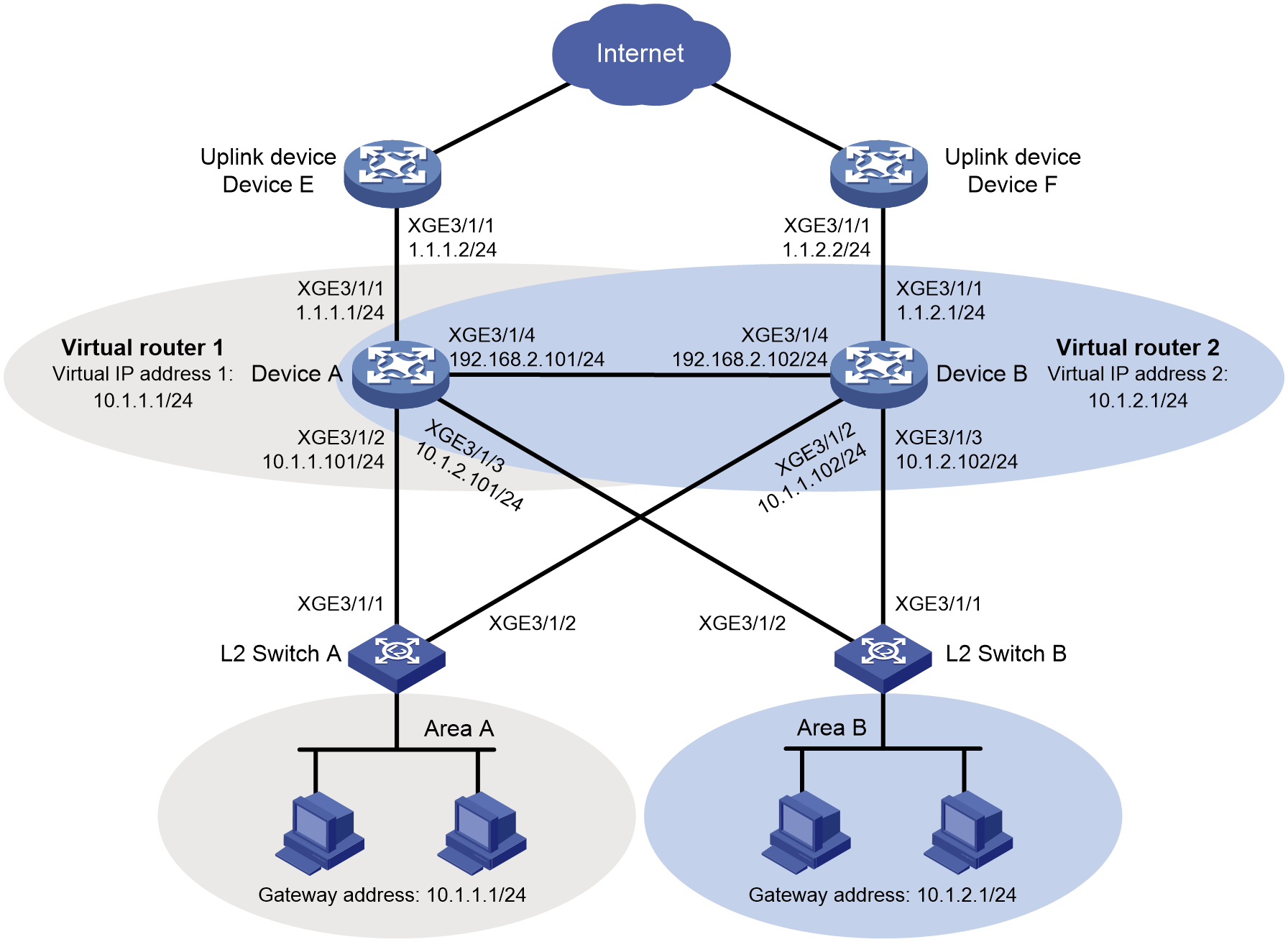

Example: Configuring VRRP-BFD-Track collaboration
As shown in Figure 1:
·     Two distribution layer devices, Device A and Device B, are deployed at the egress of area A and area B.
·     Device A and Device B belong to VRRP group 1 and VRRP group 2.
·     Device A is the master in VRRP group 1. Device B is the master in VRRP group 2.
·     The default gateway is VRRP group 1 for users in area A and VRRP group 2 for users in area B.
Configure VRRP-Track-BFD collaboration to meet the following requirements:
·     When Device A and Device B are operating correctly, they forward traffic for users in area A and area B, respectively.
·     When one gateway device or the uplink of the device fails, BFD can detect the failure and the other device takes over to implement link switchover.
·     When the downlink of a gateway device fails, L2 Switch A or L2 Switch B forwards user traffic to the gateway through interface Ten-GigabitEthernet 3/1/2. When the fault is cleared, L2 Switch A or L2 Switch B forwards user traffic to the gateway through interface Ten-GigabitEthernet 3/1/1.
Figure 1 Network diagram
Analysis
To meet the network requirements, you must perform the following tasks:
·     For Device A to become the master in VRRP group 1, configure a higher priority (110) for Device A in VRRP group 1 (Device B uses the default priority 100). For Device B to become the master in VRRP group 2, configure a higher priority (110) for Device B in VRRP group 2 (Device A uses the default priority 100).
·     To enable the failed master to forward traffic when it recovers, configure both VRRP groups to operate in preemptive mode.
·     To prevent MSTP from blocking uplink interface Ten-GigabitEthernet 3/1/1 of Device A and Device B, disable the spanning tree feature on the interfaces.
When you configure VRRP-BFD-Track collaboration, follow these restrictions and guidelines:
·     Make sure the VRRP versions on all devices of the VRRP group are the same.
·     The source IP address for BFD echo packets cannot be on the same network segment as any local interface's IP address. Otherwise, a large number of ICMP redirect packets might be sent from the peer, resulting in link congestion.
·     The virtual IP address of an IPv4 VRRP group and the downlink interface IP address of the VRRP group must be in the same subnet. Otherwise, the hosts in the subnet might fail to access external networks.

1.     Verify that the hosts in the LAN can access the external network when Device A and Device B are operating correctly:
# Ping 1.1.1.2 from host A in area A.
<host A> ping 1.1.1.2
PING 1.1.1.2 (1.1.1.2): 56 data bytes
56 bytes from 1.1.1.2: seq=0 ttl=128 time=22.43 ms
56 bytes from 1.1.1.2: seq=1 ttl=128 time=7.17 ms
56 bytes from 1.1.1.2: seq=2 ttl=128 time=8.91 ms
56 bytes from 1.1.1.2: seq=3 ttl=128 time=7.45 ms
56 bytes from 1.1.1.2: seq=4 ttl=128 time=9.11 ms
--- 1.1.1.2 ping statistics ---
5 packets transmitted, 5 packets received, 0% packet loss
round-trip min/avg/max = 7.17/11.01/22.43 ms
# Ping 1.1.2.2 from host C in area B.
<host C> ping 1.1.2.2
PING 1.1.2.2 (1.1.2.2): 56 data bytes
56 bytes from 1.1.2.2: seq=0 ttl=128 time=22.43 ms
56 bytes from 1.1.2.2: seq=1 ttl=128 time=7.17 ms
56 bytes from 1.1.2.2: seq=2 ttl=128 time=8.91 ms
56 bytes from 1.1.2.2: seq=3 ttl=128 time=7.45 ms
56 bytes from 1.1.2.2: seq=4 ttl=128 time=9.11 ms
--- 1.1.2.2 ping statistics ---
The output shows that the hosts in area A and area B can access the external network.
# Display BFD session information on Device A.
[DeviceA] display bfd session
 Total Session Num: 1     Up Session Num: 1     Init Mode: Active
 IPv4 Session Working Under Echo Mode:
 LD             SourceAddr      DestAddr        State    Holdtime    Interface
 65             1.1.1.1         1.1.1.2         Up       500ms       XGE3/1/1
The output shows that a BFD session has been established.
# Display detailed VRRP group information on Device A.
[DeviceA] display vrrp verbose
IPv4 Virtual Router Information:
 Running Mode      : Standard
 Total number of virtual routers : 2
   Interface Ten-GigabitEthernet3/1/2
     VRID           : 1                    Adver Timer  : 100
     Admin Status   : Up                   State        : Master
     Config Pri     : 110                  Running Pri  : 110
     Preempt Mode   : Yes                  Delay Time   : 500
     Auth Type      : None
     Virtual IP     : 10.1.1.1
     Virtual MAC    : 0000-5e00-0101
     Master IP      : 10.1.1.101
   VRRP Track Information:
     Track Object   : 1                    State : Positive   Pri Reduced : 20
   Interface Ten-GigabitEthernet3/1/3
     VRID           : 2                    Adver Timer  : 100
     Admin Status   : Up                   State        : Backup
     Config Pri     : 100                  Running Pri  : 100
     Become Master  : 3600ms left
     Auth Type      : None
     Virtual IP     : 10.1.2.1
     Master IP      : 10.1.2.102
# Display detailed VRRP group information on Device B.
[DeviceB] display vrrp verbose
     Become Master  : 3100ms left
     Auth Type      : None
     Auth Type      : None
     Virtual MAC    : 0000-5e00-0102
The output shows the following information:
¡     In VRRP group 1, Device A is the master, and Device B is the backup. Hosts that use default gateway 10.1.1.1/24 access the Internet through Device A.
¡     In VRRP group 2, Device B is the master, and Device A is the backup. Hosts that use default gateway 10.1.2.1/24 access the Internet through Device B.
2.     Verify that the hosts in the LAN can access the external network when the uplink monitored by Device A fails:
 Total Session Num: 1     Up Session Num: 0     Init Mode: Active
 65             1.1.1.1         1.1.1.2         Down     0ms         XGE3/1/1
The output shows that the BFD session has been terminated.
     Auth Type      : None
     Master IP      : 10.1.1.102
     Auth Type      : None
The output shows that Device B becomes the master in VRRP group 1. Hosts in area A access the external network through Device B.
# When the fault is cleared, display BFD session information on Device A.
 65             1.1.1.1         1.1.1.2         Up       1000ms      XGE3/1/1
The output shows that the BFD session is resumed.
     Auth Type      : None
     Become Master  : 3550ms left
     Auth Type      : None
The output shows that Device A resumes its priority and becomes the master in VRRP group 1 again. Hosts in area B access the external network through Device A.
Configuration files
·     Device A:
 bfd echo-source-ip 10.10.10.10
interface Ten-GigabitEthernet3/1/1
 port link-mode route
 ip address 1.1.1.1 255.255.255.0
interface Ten-GigabitEthernet3/1/2
 ip address 10.1.1.101 255.255.255.0
vrrp vrid 1 virtual-ip 10.1.1.1
 vrrp vrid 1 priority 110
 vrrp vrid 1 preempt-mode delay 500
 vrrp vrid 1 track 1 priority reduced 20
interface Ten-GigabitEthernet3/1/3
 ip address 10.1.2.101 255.255.255.0
 vrrp vrid 2 virtual-ip 10.1.2.1
 vrrp vrid 2 preempt-mode delay 500
interface Ten-GigabitEthernet3/1/4
 ip address 192.168.2.101 255.255.255.0
 track 1 bfd echo interface Ten-GigabitEthernet3/1/1 remote ip 1.1.1.2 local ip 1.1.1.1
·     Device B:
 bfd echo-source-ip 11.11.11.11
 ip address 1.1.2.1 255.255.255.0
 ip address 10.1.1.102 255.255.255.0
 ip address 10.1.2.102 255.255.255.0
 vrrp vrid 2 priority 110
 vrrp vrid 2 track 1 priority reduced 20
 ip address 192.168.2.102 255.255.255.0
 track 1 bfd echo interface Ten-GigabitEthernet3/1/1 remote ip 1.1.2.2 local ip 1.1.2.1

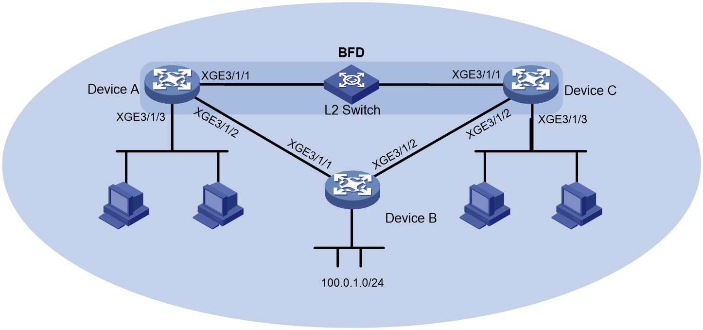

Example: Configuring BFD for OSPF
As shown in Figure 4, Device A, Device B, and Device C run OSPF. Device A and Device C are connected through a Layer 2 switch.
Enable BFD control packet mode on Device A and Device C to monitor the path over the Layer 2 switch. When BFD detects a link failure, it notifies OSPF to switch to the path over Device B.
Figure 4 Network diagram

When you configure BFD for OSPF, follow these restrictions and guidelines:
·     In BFD control packet mode, a minimum of one end must operate in active mode for a BFD session to be established.
·     For an SR8802-X-S router: If the router is not installed with a CSPEX-1404S or CSPEX-1504S card, the minimum interval for receiving echo packets cannot be smaller than 1000 milliseconds. If the router is installed with a CSPEX-1404S or CSPEX-1504S card, the minimum interval for receiving echo packets cannot be smaller than 100 milliseconds.
·     For an SR8803-X-S router: If the router is not installed with the SR07SRPUC1 MPU, the minimum interval for receiving echo packets cannot be smaller than 100 milliseconds. If the router is installed with the SR07SRPUC1 MPU, the minimum interval for receiving echo packets cannot be smaller than 1000 milliseconds.
·     For an SR8806-X-S or SR8810-X-S router: The minimum interval for receiving echo packets cannot be smaller than 100 milliseconds.
Procedures
Configuring interface IP addresses
1.     Configure Device A:
<DeviceA> system-view
[DeviceA] interface ten-gigabitethernet 3/1/1
[DeviceA-Ten-GigabitEthernet3/1/1] ip address 10.1.0.101 24
[DeviceA-Ten-GigabitEthernet3/1/1] quit
2.     Configure other devices in the same way Device A is configured. (Details not shown.)
Configuring OSPF
# Configure basic OSPF functions, and enable BFD for OSPF.
[DeviceA] ospf
[DeviceA-ospf-1] area 0
[DeviceA-ospf-1-area-0.0.0.0] network 10.1.0.0 0.0.0.255
[DeviceA-ospf-1-area-0.0.0.0] network 192.168.0.0 0.0.0.255
[DeviceA-ospf-1-area-0.0.0.0] network 120.1.1.0 0.0.0.255
[DeviceA-ospf-1-area-0.0.0.0] quit
[DeviceA-ospf-1] quit
[DeviceA-Ten-GigabitEthernet3/1/1] ospf bfd enable
2.     Configure Device B:
# Configure basic OSPF functions.
[DeviceB] ospf
[DeviceB-ospf-1] area 0
[DeviceB-ospf-1-area-0.0.0.0] network 192.168.0.0 0.0.0.255
[DeviceB-ospf-1-area-0.0.0.0] network 13.1.1.0 0.0.0.255
[DeviceB-ospf-1-area-0.0.0.0] quit
[DeviceB-ospf-1] quit
3.     Configure Device C:
[DeviceC] ospf
[DeviceC-ospf-1] area 0
[DeviceC-ospf-1-area-0.0.0.0] network 10.1.0.0 0.0.0.255
[DeviceC-ospf-1-area-0.0.0.0] network 13.1.1.0 0.0.0.255
[DeviceC-ospf-1-area-0.0.0.0] network 121.1.1.0 0.0.0.255
[DeviceC-ospf-1-area-0.0.0.0] quit
[DeviceC-ospf-1] quit
[DeviceC] interface ten-gigabitethernet 3/1/1
[DeviceC-Ten-GigabitEthernet3/1/1] ospf bfd enable
[DeviceC-Ten-GigabitEthernet3/1/1] quit
Configuring BFD parameters
# Configure the session establishment mode as active (this is the default mode).
[DeviceA] bfd session init-mode active
# Configure the minimum interval for sending and receiving single-hop BFD control packets and the single-hop detection time multiplier.
[DeviceA-Ten-GigabitEthernet3/1/1] bfd min-transmit-interval 100
[DeviceA-Ten-GigabitEthernet3/1/1] bfd min-receive-interval 100
[DeviceA-Ten-GigabitEthernet3/1/1] bfd detect-multiplier 3
2.     Configure Device C:
[DeviceC] bfd session init-mode active
[DeviceC-Ten-GigabitEthernet3/1/1] bfd min-transmit-interval 100
[DeviceC-Ten-GigabitEthernet3/1/1] bfd min-receive-interval 100
[DeviceC-Ten-GigabitEthernet3/1/1] bfd detect-multiplier 3
# Ping host C (connected to Device C) from host A (connected to Device A) to verify the connectivity.
<host A> ping 121.1.1.2
PING 121.1.1.2 (121.1.1.2): 56 data bytes
56 bytes from 121.1.1.2: seq=0 ttl=128 time=22.43 ms
56 bytes from 121.1.1.2: seq=1 ttl=128 time=7.17 ms
56 bytes from 121.1.1.2: seq=2 ttl=128 time=8.91 ms
56 bytes from 121.1.1.2: seq=3 ttl=128 time=7.45 ms
56 bytes from 121.1.1.2: seq=4 ttl=128 time=9.11 ms
--- 121.1.1.2 ping statistics ---
The output shows that host C can be pinged successfully.
# Display detailed OSPF neighbor information on Device A.
[DeviceA] display ospf peer verbose
          OSPF Process 1 with Router ID 2.2.2.2
                  Neighbors
 Area 0.0.0.0 interface 10.1.0.101(Ten-GigabitEthernet3/1/1)'s neighbors
 Router ID: 1.1.1.1          Address: 10.1.0.102       GR State: Normal
   State: Full  Mode: Nbr is Slave  Priority: 1
   DR: 10.1.0.101  BDR: 10.1.0.102  MTU: 0
   Options is 0x42 (-|O|-|-|-|-|E|-)
   Dead timer due in 39  sec
   Neighbor is up for 00:09:01
   Authentication Sequence: [ 0 ]
   Neighbor state change count: 5
   BFD status: Enabled(Control mode)
The output shows that Device A has established OSPF neighbor relationship with Device C.
# Display BFD session information on Device A and Device C.
[DeviceA] display bfd session verbose
 Total session number: 1   Up session number: 1   Init mode: Active
 IPv4 session working under Ctrl mode:
     Local Discr: 10                  Remote Discr: 1
       Source IP: 10.1.0.101        Destination IP: 10.1.0.102
   Session State: Up                     Interface: Ten-GigabitEthernet3/1/1
 Min Trans Inter: 100ms            Act Trans Inter: 100ms
  Min Recv Inter: 100ms           Act Detect Inter: 300ms
          Rx Count: 3971                     Tx Count: 3776
      Connect Type: Direct             Running Up for: 00:06:52
         Hold Time: 300ms                   Auth mode: None
       Detect Mode: Async                        Slot: 0
        Protocol: OSPF
       Diag Info: No Diagnostic
[DeviceC] display bfd session verbose

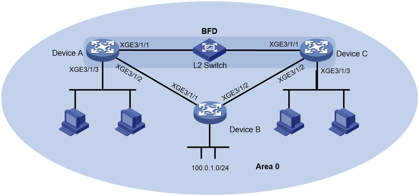

     Local Discr: 1                   Remote Discr: 10
       Source IP: 10.1.0.102        Destination IP: 10.1.0.101
  Min Recv Inter: 100ms           Act Detect Inter: 100ms
          Rx Count: 3                     Tx Count: 3
        Protocol: OSPF
The output shows that BFD sessions have been established and are up.
# Display information about the routes to network 121.1.1.0/24 on Device A.
<DeviceA> display ip routing-table 121.1.1.0 verbose
Summary Count : 1
Destination: 120.1.1.0/24
   Protocol: OSPF            Process ID: 1
  SubProtID: 0x1                    Age: 04h20m37s
       Cost: 1               Preference: 10
        Tag: 0                    State: Active Adv
  OrigTblID: 0x0                OrigVrf: default-vrf
    TableID: 0x2                 OrigAs: 0
      NBRID: 0x26000002          LastAs: 0
     AttrID: 0xffffffff        Neighbor: 0.0.0.0
      Flags: 0x1008c        OrigNextHop: 10.1.0.102
      Label: NULL           RealNextHop: 10.1.0.102
    BkLabel: NULL             BkNextHop: N/A
  Tunnel ID: Invalid          Interface: Ten-GigabitEthernet3/1/1
BkTunnel ID: Invalid        BkInterface: N/A
The output shows that Device A communicates with Device C through the Layer 2 switch.
# When the link between Device C and the Layer 2 switch fails, view BFD log information.
%Apr  2 11:34:26:880 2014 DeviceA BFD/5/BFD_CHANGE_FSM: Sess[10.1.0.101/10.1.0.102,1026/1026, Ten-GigabitEthernet3/1/1,Ctrl] , Sta: UP-> DOWN, Diag: 5
%Apr  2 11:34:27:011 2014 DeviceA OSPF/5/OSPF_NBR_CHG: OSPF 1 Neighbor 10.1.0.102 Ten-GigabitEthernet3/1/1) from Full to Down.
The output shows that BFD can quickly detect the failure and notify OSPF.
Summary Count : 1
Destination: 121.1.1.0/24
       Cost: 2               Preference: 10
      Flags: 0x1008c        OrigNextHop: 192.168.0.102
      Label: NULL           RealNextHop: 192.168.0.102
  Tunnel ID: Invalid          Interface: Ten-GigabitEthernet3/1/2
The output shows that Device A communicates with Device C through Device B.

Example: Configuring BFD for IS-IS
As shown in Figure 5, Device A, Device B, and Device C run IS-IS. Device A and Device C are connected through a Layer 2 switch.
Enable BFD control packet mode on Device A and Device C to monitor the path over the Layer 2 switch. When BFD detects a link failure, it notifies IS-IS to switch to the path over Device B.
Figure 5 Network diagram
Table 4 Interface and IP address assignment
Device
Interface
IP address
Device A
XGE3/1/1
10.1.0.101/24
Device A
XGE3/1/2
192.168.0.101/24
Device A
XGE3/1/3
120.1.1.1/24
Device B
XGE3/1/1
192.168.0.102/24
Device B
XGE3/1/2
13.1.1.101/24
Device C
XGE3/1/1
10.1.0.102/24
Device C
XGE3/1/2
13.1.1.102/24
Device C
XGE3/1/3
121.1.1.1/24
When you configure BFD for IS-IS, follow these restrictions and guidelines:
Procedures
Configuring IS-IS
# Configure basic IS-IS functions, and enable BFD for IS-IS.
[DeviceA] isis
[DeviceA-isis-1] network-entity 10.0000.0000.0001.00
[DeviceA-isis-1] quit
[DeviceA] interface ten-gigabitethernet 3/1/2
[DeviceA-Ten-GigabitEthernet3/1/2] isis enable
[DeviceA-Ten-GigabitEthernet3/1/2] quit
[DeviceA-Ten-GigabitEthernet3/1/1] isis enable
[DeviceA-Ten-GigabitEthernet3/1/1] isis bfd enable
# Configure basic IS-IS functions.
[DeviceB] isis
[DeviceB-isis-1] network-entity 10.0000.0000.0003.00
[DeviceB-isis-1] quit
[DeviceB] interface ten-gigabitethernet 3/1/1
[DeviceB-Ten-GigabitEthernet3/1/1] isis enable
[DeviceB-Ten-GigabitEthernet3/1/1] quit
[DeviceB] interface ten-gigabitethernet 3/1/2
[DeviceB-Ten-GigabitEthernet3/1/2] isis enable
[DeviceB-Ten-GigabitEthernet3/1/2] quit
[DeviceC] isis
[DeviceC-isis-1] network-entity 10.0000.0000.0002.00
[DeviceC-isis-1] quit
[DeviceC-Ten-GigabitEthernet3/1/1] isis enable
[DeviceC-Ten-GigabitEthernet3/1/1] isis bfd enable
[DeviceC] interface ten-gigabitethernet 3/1/2
[DeviceC-Ten-GigabitEthernet3/1/2] isis enable
[DeviceC-Ten-GigabitEthernet3/1/2] quit
# Display detailed IS-IS neighbor information on Device A.
[DeviceA] display isis peer verbose
                         Peer information for IS-IS(1)
 System ID: 0000.0000.0002
 Interface: Ten-GigabitEthernet3/1/1      Circuit Id:  0000.0000.0002.01
 State: Up     HoldTime: 6s         Type: L1(L1L2)     PRI: 64
 Area address(es): 00
 Peer IP address(es): 10.1.0.102
 Peer local circuit ID: 1
 Peer circuit SNPA address: ce9d-d91d-d100
 Uptime: 00:01:19
 Adj protocol:  IPv4
 Graceful Restart capable
   Restarting signal: No
   Suppress adjacency advertisement: No
 Local topology:
   0
 Remote topology:
   0
The output shows that Device A has established IS-IS neighbor relationship with Device C.
 IPv4 Session Working Under Ctrl Mode:
       Local Discr: 2049                 Remote Discr: 2049
      Min Tx Inter: 100ms                Act Tx Inter: 100ms
      Min Rx Inter: 100ms                Detect Inter: 300ms
      Connect Type: Direct             Running Up for: 00:06:09
          Protocol: ISIS_BR_L1/ISIS_BR_L2
      Connect Type: Direct             Running Up for: 00:07:10
Summary Count : 1
   Protocol: isis            Process ID: 1
       Cost: 20              Preference: 15
  OrigTblID: 0x2                OrigVrf: default-vrf
%Oct  9 16:11:24:163 2013 DeviceC BFD/5/BFD_CHANGE_FSM: -MDC=1; Sess[10.1.0.102/10.1.0.101, LD/RD:2049/2049, Interface: Ten-GigabitEthernet3/1/1, SessType:Ctrl, LinkType:INET] , S
ta: UP-> DOWN, Diag: 1
%Oct  9 16:11:24:164 2013 DeviceC ISIS/5/ISIS_NBR_CHG: -MDC=1; IS-IS 1, Level-1 adj
acency 0000.0000.0001 (Ten-GigabitEthernet3/1/1), state change to: DOWN.
%Oct  9 16:11:24:164 2013 DeviceC ISIS/5/ISIS_NBR_CHG: -MDC=1; IS-IS 1, Level-2 adj
The output shows that BFD can quickly detect the failure and notify IS-IS.
Summary Count : 1
       Cost: 21              Preference: 10

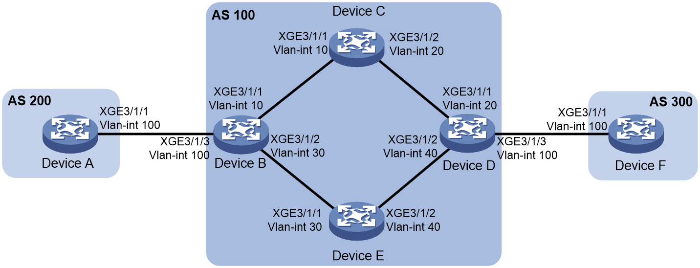

Example: Configuring BFD for BGP
As shown in Figure 6, the devices in AS 100 run OSPF to reach each other. There are two paths between Device B and Device D:
·     Path A—Path over Device C.
·     Path B—Path over Device E.
When both paths are available, BGP uses the path over Device C to forward traffic between Device A and Device F.
Enable BFD control packet mode on Device B and Device D to monitor the path over Device C. When BFD detects a link failure, it notifies BGP to switch to the path over Device E.
Figure 6 Network diagram
Table 5 Interface and IP address assignment
Device
Interface
IP address
Device A
XGE3/1/1
120.1.0.1/24
Device B
XGE3/1/1
10.1.0.101/24
Device B
XGE3/1/2
192.168.0.101/24
Device B
XGE3/1/3
120.1.0.2/24
Device C
XGE3/1/1
10.1.0.102/24
Device C
XGE3/1/2
10.2.0.102/24
Device D
XGE3/1/1
10.2.0.101/24
Device D
XGE3/1/2
13.1.1.101/24
Device D
XGE3/1/3
120.2.0.2/24
Device E
XGE3/1/1
192.168.0.102/24
Device E
XGE3/1/2
13.1.1.102/24
Device F
XGE3/1/1
120.2.0.1/24
Analysis
For Path A to become the primary path, use a routing policy to set a lower cost for Path A than Path B.
Procedures
Destination: 120.2.0.0/24
  SubProtID: 0x8                    Age: 00h26m19s
       Cost: 1               Preference: 150
        Tag: 1                    State: Inactive Adv
      NibID: 0x13000003          LastAs: 0
      Flags: 0x41           OrigNextHop: 192.168.0.102
The output shows that Device B communicates with Device D through path over Device C.
# When the path over Device C fails, ping Device F from Device A.
<DeviceA> ping 120.2.0.1
Ping 120.1.0.1 (120.2.0.1): 56 data bytes, press CTRL_C to break
56 bytes from 120.2.0.1: icmp_seq=0 ttl=252 time=0.680 ms
56 bytes from 120.2.0.1: icmp_seq=1 ttl=252 time=0.295 ms
56 bytes from 120.2.0.1: icmp_seq=2 ttl=252 time=0.423 ms
56 bytes from 120.2.0.1: icmp_seq=3 ttl=252 time=0.464 ms
56 bytes from 120.2.0.1: icmp_seq=4 ttl=252 time=0.445 ms
--- Ping statistics for 120.2.0.1 ---
5 packets transmitted, 5 packets received, 0.0% packet loss
round-trip min/avg/max/std-dev = 0.295/0.461/0.680/0.124 ms
The output shows that Device F can be pinged successfully.
# Display information about the routes to network 120.2.0.0/24 on Device B.
<DeviceB> display ip routing-table 120.2.0.0 24 verbose
Summary Count : 2
   Protocol: BGP             Process ID: 0
  SubProtID: 0x1                    Age: 00h00m18s
       Cost: 0               Preference: 100
    TableID: 0x2                 OrigAs: 300
      NibID: 0x15000001          LastAs: 300
     AttrID: 0x1               Neighbor: 10.2.0.101
      Flags: 0x10060        OrigNextHop: 10.2.0.101
  SubProtID: 0x8                    Age: 00h00m18s
      NibID: 0x13000001          LastAs: 0
The output shows that Device B communicates with Device D through path over Device E.

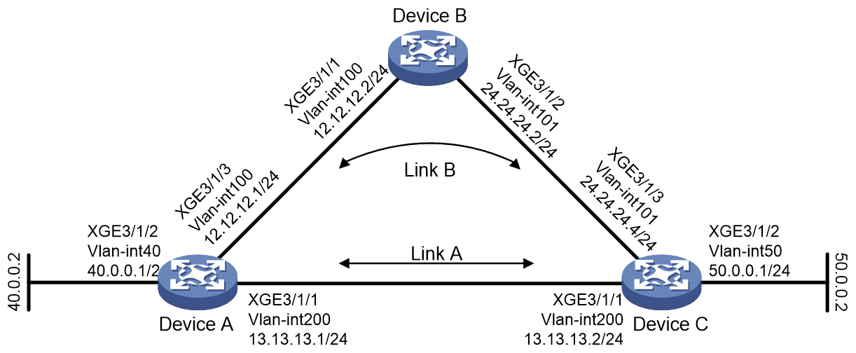

Example: Configuring BFD for PBR
As shown in Figure 7, Device A has two paths to reach Device C:
·     Link A.
·     Link B.
Configure PBR to enable Device A to forward traffic with source IP address 40.0.0.2 over Link B.
Enable BFD echo packet mode on Device A (Device C does not support BFD) to monitor Link B. When BFD detects a link failure, Device A switches the path to Link A.
Figure 7 Network diagram
When you configure BFD for PBR, follow these restrictions and guidelines:
Procedures
[DeviceA] interface Ten-GigabitEthernet 3/1/2
[DeviceA-Ten-GigabitEthernet3/1/2] ip address 40.0.0.1 24
Configuring static routes
# Configure a static route to reach network 50.0.0.0.
[DeviceA] ip route-static 50.0.0.0 24 ten-gigabitethernet 3/1/1 13.13.13.2
[DeviceB] ip route-static 50.0.0.0 24 ten-gigabitethernet 3/1/2 24.24.24.4
Configuring routing policies on Device A
# Create ACL 3010 to permit packets sourced from 40.0.0.2.
[DeviceA] acl advanced 3010
[DeviceA-acl-ipv4-adv-3010] rule 0 permit ip source 40.0.0.2 0
[DeviceA-acl-ipv4-adv-3010] quit
# Create routing policy aaa to set next hop 12.12.12.2 for packets matching ACL 3010, and associate the next hop with track entry 11.
[DeviceA] policy-based-route aaa permit node 5
[DeviceA-pbr-aaa-5] if-match acl 3010
[DeviceA-pbr-aaa-5] apply next-hop 12.12.12.2 track 11
[DeviceA-pbr-aaa-5] quit
# Apply routing policy aaa to Ten-GigabitEthernet 3/1/2.
[DeviceA] interface ten-gigabitEthernet 3/1/2
[DeviceA-Ten-GigabitEthernet3/1/2] ip policy-based-route aaa
Configuring BFD parameters on Device A
# Configure the source IP address for BFD echo packets.
[DeviceA] bfd echo-source-ip 3.3.3.3
# Configure the minimum interval for receiving BFD echo packets and the single-hop detection time multiplier, and associate track entry 11 with BFD.
[DeviceA] interface ten-gigabitethernet 3/1/3
[DeviceA-Ten-GigabitEthernet3/1/3] bfd min-echo-receive-interval 100
[DeviceA-Ten-GigabitEthernet3/1/3] bfd detect-multiplier 3
[DeviceA-Ten-GigabitEthernet3/1/3] quit
[DeviceA] track 11 bfd echo interface ten-gigabitethernet 3/1/3 remote ip 12.12.12.2 local ip 12.12.12.1
# Display outbound traffic statistics for all interfaces on Device A.
<DeviceA> reset counters interface
<DeviceA> display counters outbound interface
Interface         Total (pkts)   Broadcast (pkts)   Multicast (pkts)  Err (pkts)
XGE3/1/1                     0                  0                  0           0
XGE3/1/2                     0                  0                  0           0
XGE3/1/3                     585414             0                  0           0
XGE3/1/4                     0                  0                  0           0
XGE3/1/5                     0                  0                  0           0
XGE3/1/6                     0                  0                  0           0
The output shows that the traffic sourced from 40.0.0.0 is forwarded through Ten-GigabitEthernet 3/1/3 (Link B).
       Local Discr: 2049
         Source IP: 12.12.12.1         Destination IP: 12.12.12.2
     Session State: Up                      Interface: Ten-GigabitEthernet3/1/3
          Rx Count: 128234                   Tx Count: 371950
      Connect Type: Direct             Running Up for: 00:01:04
       Detect Mode: Async                Chassis/Slot: 1/0
          Protocol: TRACK
The output shows that a BFD session has been established and is up.
# When the link between Device A and Device B fails, view BFD log information.
%Dec 10 16:39:46:210 2013 DeviceA BFD/5/BFD_CHANGE_FSM: -MDC=1; Sess[12.12.12.1/
12.12.12.2, LD/RD:2049/2049, Interface: Ten-GigabitEthernet3/1/3, SessType:Echo, LinkType:INET] , S
%Dec 10 16:39:47:342 2013 DeviceA IFNET/3/PHY_UPDOWN: -MDC=1; Ten-GigabitEthernet3/1/3 link status is down.
%Dec 10 16:39:47:343 2013 DeviceA IFNET/5/LINK_UPDOWN: -MDC=1; Line protocol on
the interface Ten-GigabitEthernet3/1/3 is down.
%Dec 10 16:39:47:343 2013 DeviceA IFNET/3/PHY_UPDOWN: -MDC=1; Ten-GigabitEthernet3/1/3
The output shows that the BFD session is down.
# Clear the interface statistics, and display outbound traffic statistics for all interfaces on Device A again.
XGE3/1/1                863764                  0                  0           0
XGE3/1/2                     0                  0                  0           0
XGE3/1/3                     0                  0                  0           0
XGE3/1/4                     0                  0                  0           0
XGE3/1/5                     0                  0                  0           0
XGE3/1/6                     0                  0                  0           0
The output shows that the traffic sourced from 40.0.0.0 is forwarded through Ten-GigabitEthernet 3/1/1 (Link A).
