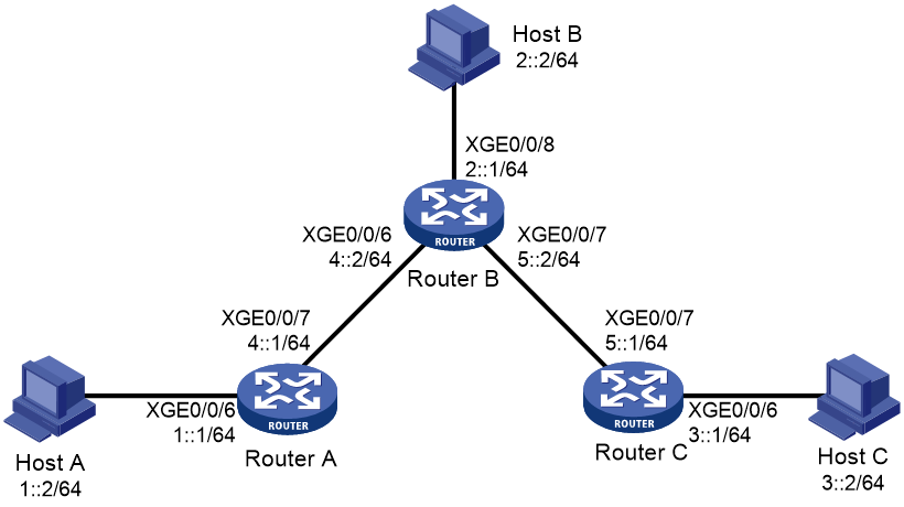

Example: Configuring basic IPv6 static route
As shown in Figure 1, configure IPv6 static routes so that hosts can reach each other.
Figure 1 Network diagram
Configure IPv6 addresses for the interfaces as shown in Figure 1.
1.     Configure IPv6 static routes:
# Configure the default IPv6 route on Router A.
<RouterA> system-view
[RouterA] ipv6 route-static :: 0 4::2
# Configure two IPv6 static routes on Router B.
<RouterB> system-view
[RouterB] ipv6 route-static 1:: 64 4::1
[RouterB] ipv6 route-static 3:: 64 5::1
# Configure the default IPv6 route on Router C.
<RouterC> system-view
[RouterC] ipv6 route-static :: 0 5::2
2.     Configure the IPv6 addresses for all hosts and configure the default gateway of Host A, Host B, and Host C as 1::1, 2::1, and 3::1.
# Display the IPv6 static route information on Router A.
[RouterA] display ipv6 routing-table protocol static
Summary Count : 1
Static Routing table Status : <Active>
Summary Count : 1
Destination: ::                                          Protocol  : Static
NextHop    : 4::2                                        Preference: 60
Interface  : XGE0/0/7                                    Cost      : 0
Static Routing table Status : <Inactive>
Summary Count : 0
# Display the IPv6 static route information on Router B.
[RouterB] display ipv6 routing-table protocol static
Summary Count : 2
Summary Count : 2
Destination: 1::/64                                      Protocol  : Static
NextHop    : 4::1                                        Preference: 60
Interface  : XGE0/0/6                                    Cost      : 0
Destination: 3::/64                                      Protocol  : Static
NextHop    : 5::1                                        Preference: 60
Summary Count : 0
# Use the ping command to test reachability.
[RouterA] ping ipv6 3::1
Ping6(56 data bytes) 4::1 --> 3::1, press CTRL_C to break
56 bytes from 3::1, icmp_seq=0 hlim=62 time=0.700 ms
56 bytes from 3::1, icmp_seq=1 hlim=62 time=0.351 ms
56 bytes from 3::1, icmp_seq=2 hlim=62 time=0.338 ms
56 bytes from 3::1, icmp_seq=3 hlim=62 time=0.373 ms
56 bytes from 3::1, icmp_seq=4 hlim=62 time=0.316 ms
--- Ping6 statistics for 3::1 ---
round-trip min/avg/max/std-dev = 0.316/0.416/0.700/0.143 ms

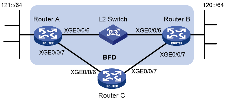

Example: Configuring BFD for IPv6 static routes (direct next hop)
As shown in Figure 2:
·     Configure an IPv6 static route to subnet 120::/64 on Router A.
·     Configure an IPv6 static route to subnet 121::/64 on Router B.
·     Enable BFD for both routes.
·     Configure an IPv6 static route to subnet 120::/64 and an IPv6 static route to subnet 121::/64 on Router C.
When the link between Router A and Router B through the Layer 2 switch fails, BFD can detect the failure immediately and inform Router A and Router B to communicate through Router C.
Figure 2 Network diagram

Configure IPv6 addresses for the interfaces as shown in Figure 2.
# Configure IPv6 static routes on Router A, and enable BFD control packet mode for the IPv6 static route that traverses Ten-GigabitEthernet 0/0/6.
[RouterA] interface ten-gigabitethernet 0/0/6
[RouterA-Ten-GigabitEthernet0/0/6] bfd min-transmit-interval 500
[RouterA-Ten-GigabitEthernet0/0/6] bfd min-receive-interval 500
[RouterA-Ten-GigabitEthernet0/0/6] bfd detect-multiplier 9
[RouterA-Ten-GigabitEthernet0/0/6] quit
[RouterA] ipv6 route-static 120:: 64 ten-gigabitethernet 0/0/6 12::2 bfd control-packet
[RouterA] ipv6 route-static 120:: 64 10::100 preference 65
[RouterA] quit
# Configure IPv6 static routes on Router B, and enable BFD control packet mode for the IPv6 static route that traverses the Layer 2 switch.
[RouterB] interface ten-gigabitethernet 0/0/6
[RouterB-Ten-GigabitEthernet0/0/6] bfd min-transmit-interval 500
[RouterB-Ten-GigabitEthernet0/0/6] bfd min-receive-interval 500
[RouterB-Ten-GigabitEthernet0/0/6] bfd detect-multiplier 9
[RouterB-Ten-GigabitEthernet0/0/6] quit
[RouterB] ipv6 route-static 121:: 64 ten-gigabitethernet 0/0/6 12::1 bfd control-packet
[RouterB] ipv6 route-static 121:: 64 13::2 preference 65
[RouterB] quit
# Configure IPv6 static routes on Router C.
[RouterC] ipv6 route-static 120:: 64 13::1
[RouterC] ipv6 route-static 121:: 64 10::102
# Display BFD sessions on Router A.
<RouterA> display bfd session
 Total Session Num: 1     Up Session Num: 1     Init Mode: Active
 IPv6 session working in control packet mode:
       Local Discr: 513                 Remote Discr: 33
         Source IP: 12::1
    Destination IP: 12::2
     Session State: Up                      Interface: XGE0/0/6
         Hold Time: 2012ms
The output shows that the BFD session has been created.
# Display IPv6 static routes on Router A.
<RouterA> display ipv6 routing-table protocol static
Summary Count : 1
Summary Count : 1
Destination: 120::/64                                    Protocol  : Static
NextHop    : 12::2                                       Preference: 60
Summary Count : 0
The output shows that Router A communicates with Router B through Ten-GigabitEthernet 0/0/6. The link over Ten-GigabitEthernet 0/0/6 fails.
Summary Count : 1
Summary Count : 1
NextHop    : 10::100                                     Preference: 65
Summary Count : 0
The output shows that Router A communicates with Router B through Ten-GigabitEthernet 0/0/7.

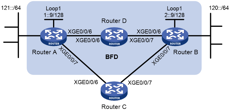

As shown in Figure 3:
·     Router A has a route to interface Loopback 1 (2::9/128) on Router B, and the output interface is Ten-GigabitEthernet 0/0/6.
·     Router B has a route to interface Loopback 1 (1::9/128) on Router A, and the output interface is Ten-GigabitEthernet 0/0/6.
·     Router D has a route to 1::9/128, and the output interface is Ten-GigabitEthernet 0/0/6. It also has a route to 2::9/128, and the output interface is Ten-GigabitEthernet 0/0/7.
Configure the following:
·     Configure an IPv6 static route to subnet 120::/64 and an IPv6 static route to subnet 121::/64 on both Router C and Router D.
When the link between Router A and Router B through Router D fails, BFD can detect the failure immediately and Router A and Router B can communicate through Router C.
Figure 3 Network diagram
Device
Interface
IPv6 address
Router A
XGE0/0/6
12::1/64
Router A
XGE0/0/7
10::102/64
Router A
Loop1
1::9/128
Router B
XGE0/0/6
11::2/64
Router B
XGE0/0/7
13::1/64
Router B
Loop1
2::9/128
Router C
XGE0/0/6
10::100/64
Router C
XGE0/0/7
13::2/64
Router D
XGE0/0/6
12::2/64
Router D
XGE0/0/7
11::1/64
Configure IPv6 addresses for the interfaces as shown in Figure 3.
# Configure IPv6 static routes on Router A and enable BFD control packet mode for the IPv6 static route that traverses Router D.
[RouterA] bfd multi-hop min-transmit-interval 500
[RouterA] bfd multi-hop min-receive-interval 500
[RouterA] bfd multi-hop detect-multiplier 9
[RouterA] ipv6 route-static 120:: 64 2::9 bfd control-packet bfd-source 1::9
[RouterA] ipv6 route-static 2::9 128 12::2
[RouterA] quit
# Configure IPv6 static routes on Router B and enable BFD control packet mode for the IPv6 static route that traverses Router D.
[RouterB] bfd multi-hop min-transmit-interval 500
[RouterB] bfd multi-hop min-receive-interval 500
[RouterB] bfd multi-hop detect-multiplier 9
[RouterB] ipv6 route-static 121:: 64 1::9 bfd control-packet bfd-source 2::9
[RouterB] ipv6 route-static 1::9 128 11::1
[RouterB] quit
# Configure IPv6 static routes on Router D.
<RouterD> system-view
[RouterD] ipv6 route-static 120:: 64 11::2
[RouterD] ipv6 route-static 121:: 64 12::1
[RouterD] ipv6 route-static 2::9 128 11::2
[RouterD] ipv6 route-static 1::9 128 12::1
         Source IP: 1::9
    Destination IP: 2::9
     Session State: Up                      Interface: N/A
         Hold Time: 2012ms
Summary Count : 1
Summary Count : 1
NextHop    : 2::9                                        Preference: 60
Summary Count : 0
Summary Count : 1
Summary Count : 1
Summary Count : 0
