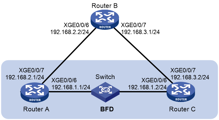

Configuring single-hop echo detection (for a specific destination)
This feature applies only to RIP neighbors that are directly connected.
You need to perform this task only on the local device.
2.     Configure the source IP address of BFD echo packets.
bfd echo-source-ip ip-address
By default, no source IP address is configured for BFD echo packets.
3.     Enter interface view.
4.     Enable BFD for RIP.
rip bfd enable destination ip-address
By default, BFD for RIP is disabled.

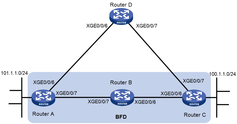

Configuring bidirectional control detection for an indirectly connected neighbor
You need to perform this task on both the local and peer devices.
2.     Enter RIP view.
rip [ process-id ] [ vpn-instance vpn-instance-name ]
3.     Specify a RIP neighbor.
peer ip-address
By default, RIP does not unicast updates to any peer.
Because the undo peer command does not remove the neighbor relationship immediately, executing the command cannot bring down the BFD session immediately.
4.     Disable source IP address check on inbound RIP updates.
undo validate-source-address
By default, source IP address check is enabled on inbound RIP updates.
If the specified neighbor is not directly connected, disable source address check on incoming updates.
5.     Enable BFD for RIP.
¡     Enable BFD on all interfaces of a RIP process.
bfd all-interfaces enable
¡     Execute the following commands in sequence to enable BFD on an interface.
rip bfd enable
The configuration in interface view takes precedence over the configuration in RIP view.

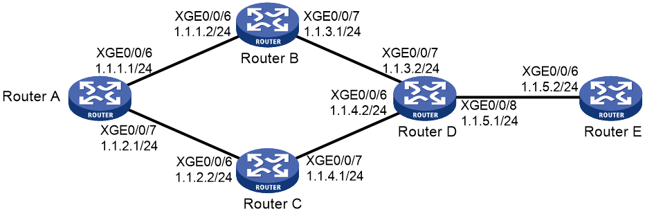

Configuring RIP FRR
About RIP FRR
A link or router failure on a path can cause packet loss and even routing loop until RIP completes routing convergence based on the new network topology. FRR enables fast rerouting to minimize the impact of link or node failures.
Figure 1 Network diagram for RIP FRR
As shown in Figure 1, configure FRR on Router B by using a routing policy to specify a backup next hop. When the primary link fails, RIP directs packets to the backup next hop. At the same time, RIP calculates the shortest path based on the new network topology, and forwards packets over that path after network convergence.
Restrictions and guidelines for RIP FRR
RIP FRR takes effect only for RIP routes learned from directly connected neighbors.
RIP FRR is available only when the state of primary link (with Layer 3 interfaces staying up) changes from bidirectional to unidirectional or down.
Equal-cost routes do not support RIP FRR.
Enabling RIP FRR
2.     Configure a routing policy for FRR.
You must specify a next hop by using the apply fast-reroute backup-interface command in the routing policy.
For more information about routing policy configuration, see "Configuring routing policies."

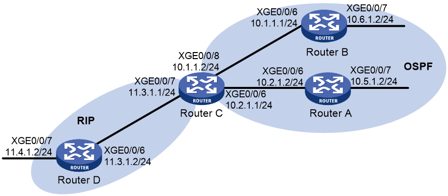

Example: Configuring RIP route redistribution
As shown in Figure 3, Router B communicates with Router A through RIP 100 and with Router C through RIP 200.
Configure RIP 200 to redistribute direct routes and routes from RIP 100 on Router B so Router C can learn routes destined for 10.2.1.0/24 and 11.1.1.0/24. Router A cannot learn routes destined for 12.3.1.0/24 and 16.4.1.0/24.
Figure 3 Network diagram
1.     Configure IP addresses for the interfaces. (Details not shown.)
2.     Configure basic RIP settings:
# Enable RIP 100, and configure RIPv2 on Router A.
<RouterA> system-view
[RouterA] rip 100
[RouterA-rip-100] network 10.0.0.0
[RouterA-rip-100] network 11.0.0.0
[RouterA-rip-100] version 2
[RouterA-rip-100] undo summary
[RouterA-rip-100] quit
# Enable RIP 100 and RIP 200, and configure RIPv2 on Router B.
<RouterB> system-view
[RouterB] rip 100
[RouterB-rip-100] network 11.0.0.0

Example: Configuring an additional metric for a RIP interface
As shown in Figure 4, run RIPv2 on all the interfaces of Router A, Router B, Router C, Router D, and Router E.
Router A has two links to Router D. The link from Router B to Router D is more stable than that from Router C to Router D. Configure an additional metric for RIP routes received from Ten-GigabitEthernet 0/0/7 on Router A so Router A prefers route 1.1.5.0/24 learned from Router B.
Figure 4 Network diagram
1.     Configure IP addresses for the the interfaces. (Details not shown.)
# Configure Router A.
[RouterA] rip
[RouterA-rip-1] network 1.0.0.0
[RouterA-rip-1] version 2
[RouterA-rip-1] undo summary
[RouterA-rip-1] quit
# Configure Router B.
[RouterB] rip
[RouterB-rip-1] network 1.0.0.0
[RouterB-rip-1] version 2
[RouterB-rip-1] undo summary
# Configure Router C.
<RouterC> system-view
[RouterC] rip
[RouterC-rip-1] network 1.0.0.0
[RouterC-rip-1] version 2
[RouterC-rip-1] undo summary
# Configure Router D.
<RouterD> system-view
[RouterD] rip
[RouterD-rip-1] network 1.0.0.0
[RouterD-rip-1] version 2
[RouterD-rip-1] undo summary
# Configure Router E.
<RouterE> system-view
[RouterE] rip
[RouterE-rip-1] network 1.0.0.0
[RouterE-rip-1] version 2
[RouterE-rip-1] undo summary
# Display all active routes in the RIP database on Router A.
[RouterA] display rip 1 database
   1.0.0.0/8, auto-summary
       1.1.1.0/24, cost 0, nexthop 1.1.1.1, RIP-interface
       1.1.2.0/24, cost 0, nexthop 1.1.2.1, RIP-interface
       1.1.3.0/24, cost 1, nexthop 1.1.1.2
       1.1.4.0/24, cost 1, nexthop 1.1.2.2
       1.1.5.0/24, cost 2, nexthop 1.1.1.2
       1.1.5.0/24, cost 2, nexthop 1.1.2.2
The output shows two RIP routes destined for network 1.1.5.0/24. The next hops of the routes are Router B (1.1.1.2) and Router C (1.1.2.2). The cost of the routes is 2.
3.     Configure an additional metric for a RIP interface:
# Configure an inbound additional metric of 3 for RIP-enabled interface Ten-GigabitEthernet 0/0/7.
[RouterA] interface ten-gigabitethernet 0/0/7
[RouterA-Ten-GigabitEthernet0/0/7] rip metricin 3
[RouterA-Ten-GigabitEthernet0/0/7] display rip 1 database
       1.1.4.0/24, cost 2, nexthop 1.1.1.2
The output shows that only one RIP route reaches network 1.1.5.0/24, with the next hop as Router B (1.1.1.2) and a cost of 2.
Example: Configuring RIP to advertise a summary route
As shown in Figure 5, Router A and Router B run OSPF, Router D runs RIP, and Router C runs OSPF and RIP.
·     Configure RIP to redistribute OSPF routes on Router C so Router D can learn routes destined for networks 10.1.1.0/24, 10.2.1.0/24, 10.5.1.0/24, and 10.6.1.0/24.
·     To reduce the routing table size of Router D, configure route summarization on Router C to advertise only the summary route 10.0.0.0/8 to Router D.
Figure 5 Network diagram
2.     Configure basic OSPF settings:
[RouterA] ospf
[RouterA-ospf-1] area 0
[RouterA-ospf-1-area-0.0.0.0] network 10.5.1.0 0.0.0.255
[RouterA-ospf-1-area-0.0.0.0] network 10.2.1.0 0.0.0.255
[RouterA-ospf-1-area-0.0.0.0] quit
[RouterB] ospf
[RouterB-ospf-1] area 0
[RouterB-ospf-1-area-0.0.0.0] network 10.1.1.0 0.0.0.255
[RouterB-ospf-1-area-0.0.0.0] network 10.6.1.0 0.0.0.255
[RouterB-ospf-1-area-0.0.0.0] quit
[RouterC] ospf
[RouterC-ospf-1] area 0
[RouterC-ospf-1-area-0.0.0.0] network 10.1.1.0 0.0.0.255
[RouterC-ospf-1-area-0.0.0.0] network 10.2.1.0 0.0.0.255
[RouterC-ospf-1-area-0.0.0.0] quit
[RouterC-ospf-1] quit
3.     Configure basic RIP settings:
[RouterC] rip 1
[RouterC-rip-1] network 11.3.1.0
[RouterD] rip 1
[RouterD-rip-1] network 11.0.0.0
[RouterD-rip-1] quit
# Configure RIP to redistribute routes from OSPF process 1 and direct routes on Router C.
[RouterC-rip-1] import-route direct
[RouterC-rip-1] import-route ospf 1
[RouterC-rip-1] quit
# Display the IP routing table on Router D.
[RouterD] display ip routing-table
         Destinations : 15       Routes : 15
0.0.0.0/32          Direct 0    0            127.0.0.1       InLoop0
10.1.1.0/24         RIP    100  1            11.3.1.1        XGE0/0/6
10.2.1.0/24         RIP    100  1            11.3.1.1        XGE0/0/6
10.5.1.0/24         RIP    100  1            11.3.1.1        XGE0/0/6
10.6.1.0/24         RIP    100  1            11.3.1.1        XGE0/0/6
11.3.1.0/24         Direct 0    0            11.3.1.2        XGE0/0/6
11.3.1.0/32         Direct 0    0            11.3.1.2        XGE0/0/6
11.3.1.2/32         Direct 0    0            127.0.0.1       InLoop0
11.4.1.0/24         Direct 0    0            11.4.1.2        XGE0/0/7
11.4.1.0/32         Direct 0    0            11.4.1.2        XGE0/0/7
11.4.1.2/32         Direct 0    0            127.0.0.1       InLoop0
127.0.0.0/8         Direct 0    0            127.0.0.1       InLoop0
127.0.0.0/32        Direct 0    0            127.0.0.1       InLoop0
127.0.0.1/32        Direct 0    0            127.0.0.1       InLoop0
127.255.255.255/32  Direct 0    0            127.0.0.1       InLoop0
4.     Configure route summarization:
# Configure route summarization on Router C to advertise only the summary route 10.0.0.0/8.
[RouterC] interface ten-gigabitethernet 0/0/7
[RouterC-Ten-GigabitEthernet0/0/7] rip summary-address 10.0.0.0 8
Destinations : 12        Routes : 12
10.0.0.0/8          RIP    100  1            11.3.1.1        XGE0/0/6

Example: Configuring BFD for RIP (single-hop echo detection for a directly connected neighbor)
As shown in Figure 8, Ten-GigabitEthernet 0/0/6 of Router A and Router C runs RIP process 1. Ten-GigabitEthernet 0/0/7 of Router A runs RIP process 2. Ten-GigabitEthernet 0/0/7 of Router C and Ten-GigabitEthernet 0/0/6 and Ten-GigabitEthernet 0/0/7 of Router B run RIP process 1.
·     Configure a static route destined for 100.1.1.1/24 and enable static route redistribution into RIP on Router C. This allows Router A to learn two routes destined for 100.1.1.1/24 through Ten-GigabitEthernet 0/0/6 and Ten-GigabitEthernet 0/0/7 respectively, and uses the one through Ten-GigabitEthernet 0/0/6.
·     Enable BFD for RIP on Ten-GigabitEthernet 0/0/6 of Router A. When the link over Ten-GigabitEthernet 0/0/6 fails, BFD can quickly detect the failure and notify RIP. RIP deletes the neighbor relationship and route information learned on Ten-GigabitEthernet 0/0/6, and uses the route destined for 100.1.1.1 24 through Ten-GigabitEthernet 0/0/7.
Figure 8 Network diagram
1.     Configure IP addresses for interfaces. (Details not shown.)
[RouterA] rip 1
[RouterA-rip-1] network 192.168.1.0
[RouterA] rip 2
[RouterA-rip-2] network 192.168.2.0
[RouterA-rip-2] quit
[RouterB] rip 1
[RouterB-rip-1] network 192.168.2.0
[RouterB-rip-1] network 192.168.3.0
[RouterB-rip-1] quit
[RouterC] rip 1
[RouterC-rip-1] network 192.168.1.0
[RouterC-rip-1] network 192.168.3.0
[RouterC-rip-1] import-route static
3.     Enable BFD and configure BFD parameters on Router A.
[RouterA] bfd echo-source-ip 11.11.11.11
[RouterA] interface ten-gigabitethernet 0/0/6
[RouterA-Ten-GigabitEthernet0/0/6] rip bfd enable
[RouterA-Ten-GigabitEthernet0/0/6] bfd min-echo-receive-interval 500
[RouterA-Ten-GigabitEthernet0/0/6] bfd detect-multiplier 7
[RouterA-Ten-GigabitEthernet0/0/6] quit
4.     Configure a static route on Router C.
[RouterC] ip route-static 120.1.1.1 24 null 0
# Display the BFD session information on Router A.
<RouterA> display bfd session
 Total Session Num: 1     Up Session Num: 1     Init Mode: Active
 IPv4 session working in echo mode:
 LD          SourceAddr      DestAddr        State    Holdtime    Interface
 4            192.168.1.1     192.168.1.2     Up       2000ms      XGE0/0/6
# Display RIP routes destined for 120.1.1.0/24 on Router A.
<RouterA> display ip routing-table 120.1.1.0 24
Summary count : 1
Destination/Mask   Proto   Pre Cost        NextHop         Interface
120.1.1.0/24       RIP     100 1           192.168.1.2     XGE0/0/6
The output shows that Router A communicates with Router C through Ten-GigabitEthernet 0/0/6. Then the link over Ten-GigabitEthernet 0/0/6 fails.
Summary count : 1
120.1.1.0/24       RIP     100 2           192.168.2.2     XGE0/0/7
The output shows that Router A communicates with Router C through Ten-GigabitEthernet 0/0/7.
Example: Configuring BFD for RIP (single-hop echo detection for a specific destination)
As shown in Figure 9, Ten-GigabitEthernet 0/0/7 of Router A and Ten-GigabitEthernet 0/0/6 of Router B run RIP process 1. Ten-GigabitEthernet 0/0/7 of Router B and Router C runs RIP process 1.
·     Configure a static route destined for 100.1.1.0/24 and enable static route redistribution into RIP on both Router A and Router C. This allows Router B to learn two routes destined for 100.1.1.0/24 through Ten-GigabitEthernet 0/0/6 and Ten-GigabitEthernet 0/0/7. The route redistributed from Router A has a smaller cost than that redistributed from Router C, so Router B uses the route through Ten-GigabitEthernet 0/0/6.
·     Enable BFD for RIP on Ten-GigabitEthernet 0/0/7 of Router A, and specify Ten-GigabitEthernet 0/0/6 of Router B as the destination. When a unidirectional link occurs between Router A and Router B, BFD can quickly detect the link failure and notify RIP. RIP then deletes the neighbor relationship and the route information learned on Ten-GigabitEthernet 0/0/7. It does not receive or send any packets on Ten-GigabitEthernet 0/0/7. When the route learned from Router A ages out, Router B uses the route destined for 100.1.1.1/24 through Ten-GigabitEthernet 0/0/7.
Figure 9 Network diagram
[RouterA] rip 1
[RouterA-rip-1] network 192.168.2.0
[RouterA-rip-1] import-route static
[RouterB] rip 1
[RouterC] rip 1
[RouterC-rip-1] import-route static cost 3
[RouterA-Ten-GigabitEthernet0/0/7] rip bfd enable destination 192.168.2.2
[RouterA-Ten-GigabitEthernet0/0/7] bfd min-echo-receive-interval 500
[RouterA-Ten-GigabitEthernet0/0/7] quit
4.     Configure static routes:
# Configure a static route on Router A.
[RouterA] ip route-static 100.1.1.0 24 null 0
# Configure a static route on Router C.
[RouterC] ip route-static 100.1.1.0 24 null 0
 3              192.168.2.1     192.168.2.2     Up       2000ms      XGE0/0/7
# Display routes destined for 100.1.1.0/24 on Router B.
<RouterB> display ip routing-table 100.1.1.0 24 verbose
Summary count : 1
Destination: 100.1.1.0/24
   Protocol: RIP
 Process ID: 1
  SubProtID: 0x1                    Age: 00h02m47s
       Cost: 1               Preference: 100
      IpPre: N/A             QosLocalID: N/A
        Tag: 0                    State: Active Adv
  OrigTblID: 0x0                OrigVrf: default-vrf
    TableID: 0x2                 OrigAs: 0
      NibID: 0x12000002          LastAs: 0
     AttrID: 0xffffffff        Neighbor: 192.168.2.1
      Flags: 0x1008c        OrigNextHop: 192.168.2.1
      Label: NULL           RealNextHop: 192.168.2.1
    BkLabel: NULL             BkNextHop: N/A
    SRLabel: NULL             BkSRLabel: NULL
   SIDIndex: NULL               InLabel: NULL
  Tunnel ID: Invalid          Interface: Ten-GigabitEthernet0/0/6
BkTunnel ID: Invalid        BkInterface: N/A
   FtnIndex: 0x0           TrafficIndex: N/A
  Connector: N/A                 PathID: 0x0
 SRTunnelID: Invalid
   SID Type: N/A                    Exp: N/A
  VpnPeerId: N/A                   Dscp: N/A
# Display routes destined for 100.1.1.0/24 on Router B when the link between Router A and Router B fails.
Summary count : 1
   Protocol: RIP
 Process ID: 1
  SubProtID: 0x1                    Age: 00h21m23s
       Cost: 4               Preference: 100
      NibID: 0x12000003          LastAs: 0
     AttrID: 0xffffffff        Neighbor: 192.168.3.2
      Flags: 0x1008c        OrigNextHop: 192.168.3.2
      Label: NULL           RealNextHop: 192.168.3.2
  Tunnel ID: Invalid          Interface: Ten-GigabitEthernet0/0/7
 SRTunnelID: Invalid

When link Router A—L2 Switch—Router C fails, BFD can quickly detect the link failure and notify RIP. RIP immediately switches to the Router A—Router B—Router C.
Figure 11 Network diagram
[RouterA] rip 1
[RouterA-rip-1] network 101.1.1.0
[RouterA] rip 2
[RouterA-rip-2] version 2
[RouterA-rip-2] undo summary
[RouterA-rip-2] network 192.168.3.0
[RouterB] rip 1
[RouterB-rip-1] network 192.168.4.0
[RouterC] rip 1
[RouterC-rip-1] network 192.168.4.0
[RouterC-rip-1] network 100.1.1.0
3.     Configure BFD settings:
# Enable BFD and configure BFD parameters on Router A.
[RouterA] bfd session init-mode active
[RouterA-Ten-GigabitEthernet0/0/7] rip bfd enable ctrl
[RouterA-Ten-GigabitEthernet0/0/7] bfd min-transmit-interval 500
[RouterA-Ten-GigabitEthernet0/0/7] bfd min-receive-interval 500
[RouterA-Ten-GigabitEthernet0/0/7] bfd detect-multiplier 7
# Enable BFD and configure BFD parameters on Router C.
[RouterC] bfd session init-mode active
[RouterC] interface ten-gigabitethernet 0/0/6
[RouterC-Ten-GigabitEthernet0/0/6] rip bfd enable ctrl
[RouterC-Ten-GigabitEthernet0/0/6] bfd min-transmit-interval 500
[RouterC-Ten-GigabitEthernet0/0/6] bfd min-receive-interval 500
[RouterC-Ten-GigabitEthernet0/0/6] bfd detect-multiplier 6
[RouterC-Ten-GigabitEthernet0/0/6] quit
[RouterA] display bfd session
 IPv4 session working in control packet mode:
 LD/RD           SourceAddr      DestAddr        State    Holdtime    Interface
 513/513         192.168.1.1     192.168.1.2     Up       1700ms      XGE0/0/7
# Display RIP routes destined for 100.1.1.0/24 learned on Router A.
[RouterA] display ip routing-table 100.1.1.0 24
Summary count : 1
100.1.1.0/24       RIP     100 1           192.168.1.2     XGE0/0/7
The output shows that Router A communicates with Router C through L2 Switch.
# When Router A—L2 Switch—Router C fails, display RIP routes destined for 100.1.1.0/24 on Router A.
Summary count : 1
100.1.1.0/24       RIP     100 2           192.168.3.2     XGE0/0/6
The output shows that Router A communicates with Router C through Router B.
