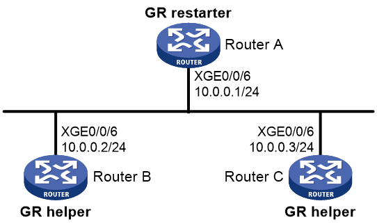

Figure 2 shows one IS-IS network topology. Area 1 is the backbone that comprises a set of Level-2 routers. The other four areas are non-backbone areas connected to the backbone through Level-1-2 routers.
Figure 2 IS-IS topology 1

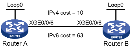

Figure 3 shows another IS-IS topology. No area is defined as the backbone in this topology. The backbone comprises all contiguous Level-2 and Level-1-2 routers in different areas. The IS-IS backbone does not need to be a specific area.
Figure 3 IS-IS topology 2

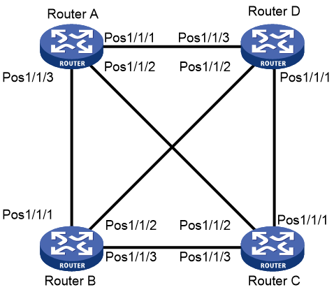

As shown in Figure 4, the same level routers on a network, including non-DIS routers, establish adjacency with each other.
Figure 4 DIS in the IS-IS broadcast network
The DIS creates and updates pseudonodes, and generates LSPs for the pseudonodes, to describe all routers on the network.
A pseudonode represents a virtual node on the broadcast network. It is not a real router. In IS-IS, it is identified by the system ID of the DIS and a 1-byte Circuit ID (a non-zero value).
Using pseudonodes simplifies network topology and can reduce the amount of resources consumed by SPF.

Configuring IPv6 IS-IS MTR
On a network, IPv4 and IPv6 topologies must be consistent so that both IPv6 IS-IS and IPv4 IS-IS can use the SPF algorithm to perform route calculation. If they are different, routers supporting both IPv4 and IPv6 might send IPv6 packets to routers that do not support IPv6, resulting in packet loss.
To resolve this issue, configure IPv6 IS-IS MTR to perform route calculation separately in IPv4 and IPv6 topologies.
Figure 7 Network diagram
As shown in Figure 7, the numbers refer to the link costs. Router A, Router B, and Router D support both IPv4 and IPv6. Router C supports only IPv4 and cannot forward IPv6 packets.
Enable IPv6 IS-IS MTR on Router A, Router B, Router C, and Router D to make them perform route calculation separately in IPv4 and IPv6 topologies. With this configuration, Router A does not forward IPv6 packets destined to Router D through Router B, avoiding packet loss.
As a best practice to avoid route calculation failures, configure this feature when both IPv4 and IPv6 topologies exist in the network.
2.     Enter IS-IS view.

In NBMA networks, many P2P links exist. As shown in Figure 8, Routers A, B, C and D run IS-IS. When Router A generates an LSP, it floods the LSP out of Pos1/1/1, Pos1/1/2, and Pos1/1/3. After Router D receives the LSP from Pos1/1/3, it floods it out of Pos1/1/1 and Pos1/1/2 to Router B and Router C. However, Router B and Router C have already received the LSP from Router A. Repeated LSP flooding consumes extra bandwidth.
Figure 8 Network diagram of a fully meshed network
To avoid this problem, you can add interfaces to a mesh group or block some interfaces.
·     An interface in a mesh group floods a received LSP only to interfaces not in the mesh group.
·     A blocked interface sends LSPs only after receiving LSP requests.
Before you configure this task, you must consider redundancy for interfaces in case LSP packets cannot be flooded because of link failures.

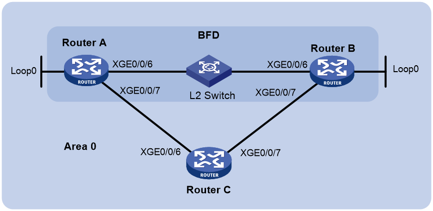

Configuring BFD for IS-IS
BFD provides a single mechanism to quickly detect and monitor the connectivity of links between IS-IS neighbors, reducing network convergence time. For more information about BFD, see High Availability Configuration Guide.
2.     Enter interface view.
3.     Enable BFD on the interface.
IPv4:
isis bfd enable
IPv6:
isis ipv6 bfd enable
By default, an IS-IS interface is not enabled with BFD.
Controlling adjacency establishment and maintenance based on BFD session state
When BFD detects a Layer 3 forwarding failure between two routers, the BFD session goes down, which causes the IS-IS adjacency to go down. If Layer 2 forwarding is still available, the routers can exchange IS-IS packets and re-establish the adjacency, which might cause traffic loss.
To avoid the issue, enable this feature on the BFD-enabled interfaces of the local and remote routers, enabling the interfaces to carry BFD-enabled TLVs in hello packets. After the BFD session goes down, the routers do not establish an adjacency if the exchanged BFD-enabled TLVs are identical.
If two IS-IS routers establish both IPv4 and IPv6 adjacency relationships, the following rules apply:
·     If route calculation is not performed separately for the IPv4 and IPv6 topologies, the IPv4 or IPv6 adjacency relationship is up only when both the IPv4 and IPv6 BFD sessions are up.
·     If route calculation is performed separately for the IPv4 and IPv6 topologies, the IPv4 or IPv6 adjacency relationship is up when the corresponding IPv4 or IPv6 BFD session is up.
If two IS-IS routers establish only an IPv4 or IPv6 adjacency relationship, the adjacency relationship is up when the corresponding IPv4 or IPv6 BFD session is up.
For more information about BFD, see BFD configuration in High Availability Configuration Guide.

Figure 9 Network diagram for IS-IS LFA FRR
In Figure 9, after you enable LFA FRR on Router B, IS-IS automatically calculates or designates a backup next hop when a link failure is detected. In this way, packets are directed to the backup next hop to reduce traffic recovery time. Meanwhile, IS-IS calculates the shortest path based on the new network topology, and forwards packets over the path after network convergence.
You can assign a backup next hop for IS-IS FRR through the following ways:
·     Enable IS-IS LFA FRR to calculate a backup next hop through LFA calculation.
·     Designate a backup next hop with a routing policy for routes matching specific criteria.
The LFA calculation of FRR and that of TE are mutually exclusive.

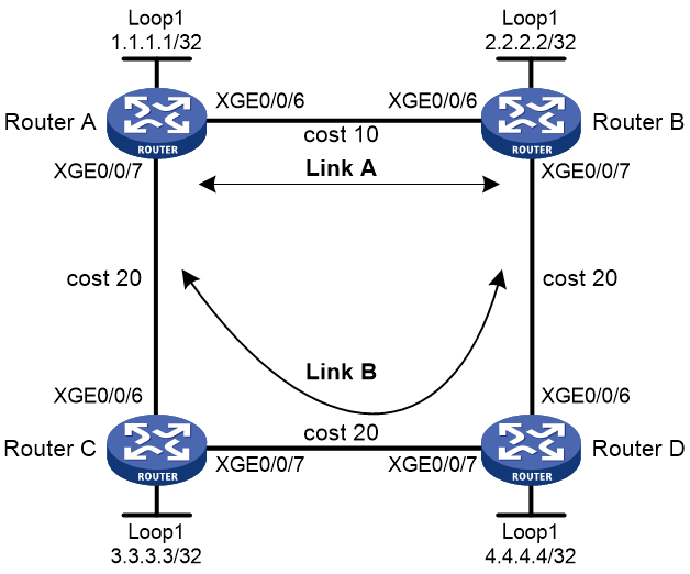

Figure 11 IS-IS FRR backup path selection
If the node-protection policy has a higher priority but the backup path calculation fails, IS-IS uses the lowest-cost policy for further calculation. Once the backup path calculation still fails, IS-IS does not perform further backup path calculation.
If the lowest-cost policy has a higher priority but the backup path calculation fails, IS-IS does not perform further backup path calculation.

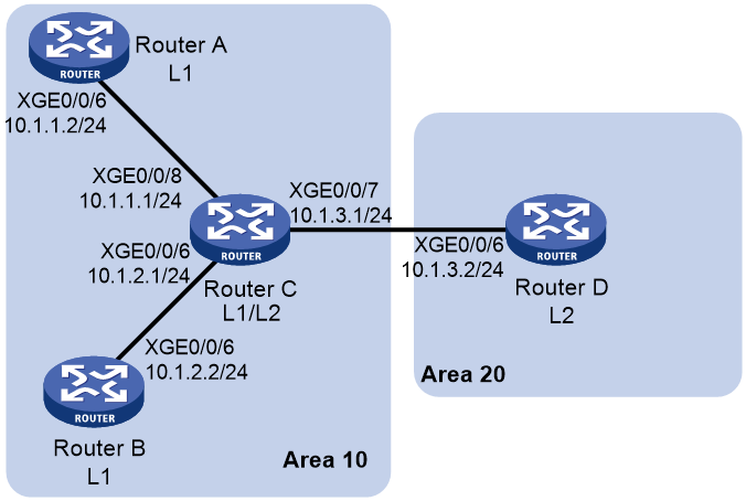

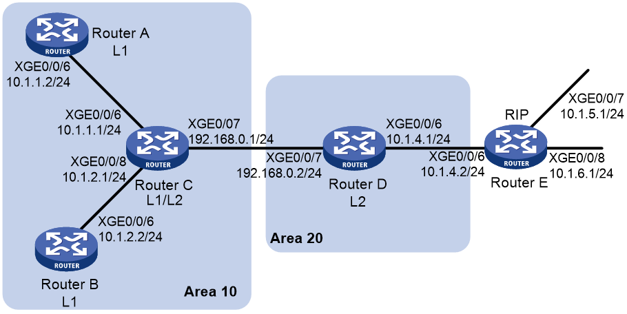

Example: Configuring basic IS-IS
As shown in Figure 12, Router A, Router B, Router C, and Router D reside in an AS.
Router A and Router B are Level-1 routers, Router D is a Level-2 router, and Router C is a Level-1-2 router connecting two areas. Router A, Router B, and Router C are in area 10, and Router D is in area 20.
Figure 12 Network diagram
1.     Configure IP addresses for interfaces. (Details not shown.)
2.     Configure IS-IS:
# Configure Router A
<RouterA> system-view
[RouterA] isis 1
[RouterA-isis-1] is-level level-1
[RouterA-isis-1] network-entity 10.0000.0000.0001.00
[RouterA-isis-1] quit
[RouterA] interface ten-gigabitethernet 0/0/6
[RouterA-Ten-GigabitEthernet0/0/6] isis enable 1
[RouterA-Ten-GigabitEthernet0/0/6] quit
# Configure Router B.
<RouterB> system-view
[RouterB] isis 1
[RouterB-isis-1] is-level level-1
[RouterB-isis-1] network-entity 10.0000.0000.0002.00
[RouterB-isis-1] quit
[RouterB] interface ten-gigabitethernet 0/0/6
[RouterB-Ten-GigabitEthernet0/0/6] isis enable 1
[RouterB-Ten-GigabitEthernet0/0/6] quit
# Configure Router C.
<RouterC> system-view
[RouterC] isis 1
[RouterC-isis-1] network-entity 10.0000.0000.0003.00
[RouterC-isis-1] quit
[RouterC] interface ten-gigabitethernet 0/0/8
[RouterC-Ten-GigabitEthernet0/0/8] isis enable 1
[RouterC-Ten-GigabitEthernet0/0/8] quit
[RouterC] interface ten-gigabitethernet 0/0/6
[RouterC-Ten-GigabitEthernet0/0/6] isis enable 1
[RouterC-Ten-GigabitEthernet0/0/6] quit
[RouterC] interface ten-gigabitethernet 0/0/7
[RouterC-Ten-GigabitEthernet0/0/7] isis enable 1
[RouterC-Ten-GigabitEthernet0/0/7] quit
# Configure Router D
<RouterD> system-view
[RouterD] isis 1
[RouterD-isis-1] is-level level-2
[RouterD-isis-1] network-entity 20.0000.0000.0004.00
[RouterD-isis-1] quit
[RouterD] interface ten-gigabitethernet 0/0/6
[RouterD-Ten-GigabitEthernet0/0/6] isis enable 1
[RouterD-Ten-GigabitEthernet0/0/6] quit
[RouterD] interface ten-gigabitethernet 0/0/7
[RouterD-Ten-GigabitEthernet0/0/7] isis enable 1
[RouterD-Ten-GigabitEthernet0/0/7] quit
# Display the IS-IS LSDB information.
[RouterA] display isis lsdb
                        Database information for ISIS(1)
                          Level-1 Link State Database
LSPID                 Seq Num      Checksum      Holdtime      Length  ATT/P/OL
0000.0000.0001.00-00* 0x00000004   0xdf5e        1096          68      0/0/0
0000.0000.0002.00-00  0x00000004   0xee4d        1102          68      0/0/0
0000.0000.0002.01-00  0x00000001   0xdaaf        1102          55      0/0/0
0000.0000.0003.00-00  0x00000009   0xcaa3        1161          111     1/0/0
0000.0000.0003.01-00  0x00000001   0xadda        1112          55      0/0/0
    *-Self LSP, +-Self LSP(Extended), ATT-Attached, P-Partition, OL-Overload
[RouterB] display isis lsdb
0000.0000.0001.00-00  0x00000006   0xdb60        988           68      0/0/0
0000.0000.0002.00-00* 0x00000008   0xe651        1189          68      0/0/0
0000.0000.0002.01-00* 0x00000005   0xd2b3        1188          55      0/0/0
0000.0000.0003.00-00  0x00000014   0x194a        1190          111     1/0/0
0000.0000.0003.01-00  0x00000002   0xabdb        995           55      0/0/0
[RouterC] display isis lsdb
0000.0000.0001.00-00  0x00000006   0xdb60        847           68      0/0/0
0000.0000.0002.00-00  0x00000008   0xe651        1053          68      0/0/0
0000.0000.0002.01-00  0x00000005   0xd2b3        1052          55      0/0/0
0000.0000.0003.00-00* 0x00000014   0x194a        1051          111     1/0/0
0000.0000.0003.01-00* 0x00000002   0xabdb        854           55      0/0/0

Example: Configuring DIS election
As shown in Figure 13, on a broadcast network (Ethernet), Router A, Router B, Router C, and Router D reside in IS-IS Area 10. Router A and Router B are Level-1-2 routers, Router C is a Level-1 router, and Router D is a Level-2 router.
Change the DIS priority of Router A to make it elected as the Level-1-2 DIS router.
Figure 13 Network diagram
2.     Enable IS-IS:
# Configure Router A.
[RouterA] isis 1
[RouterB] isis 1
[RouterC] isis 1
[RouterC-isis-1] is-level level-1
# Configure Router D.
[RouterD] isis 1
[RouterD-isis-1] network-entity 10.0000.0000.0004.00
# Display information about IS-IS neighbors of Router A.
[RouterA] display isis peer
                          Peer information for IS-IS(1)
 System ID: 0000.0000.0002
 Interface: XGE0/0/6                Circuit Id:  0000.0000.0003.01
 State: Up     HoldTime: 21s        Type: L1(L1L2)     PRI: 64
 System ID: 0000.0000.0003
 State: Up     HoldTime: 6s         Type: L1           PRI: 64
 Interface: XGE0/0/6                Circuit Id:  0000.0000.0004.01
 State: Up     HoldTime: 23s        Type: L2(L1L2)     PRI: 64
 System ID: 0000.0000.0004
 State: Up     HoldTime: 23s        Type: L2           PRI: 64
# Display information about IS-IS interfaces of Router A.
[RouterA] display isis interface
                       Interface information for IS-IS(1)
  Interface:  Ten-GigabitEthernet0/0/6
  Index     IPv4 state      IPv6 state     Circuit ID   MTU   Type   DIS
  00001     Up              Down           1            1497  L1/L2  No/No
# Display IS-IS interfaces of Router C.
[RouterC] display isis interface
  00001     Up              Down           1            1497  L1/L2  Yes/No
# Display information about IS-IS interfaces of Router D.
[RouterD] display isis interface
  00001     Up              Down           1            1497  L1/L2  No/Yes
The output shows that when the default DIS priority is used, Router C is the DIS for Level-1, and Router D is the DIS for Level-2. The pseudonodes of Level-1 and Level-2 are 0000.0000.0003.01 and 0000.0000.0004.01.
# Configure the DIS priority of Router A.
[RouterA-Ten-GigabitEthernet0/0/6] isis dis-priority 100
 Interface: XGE1/0/1                Circuit Id:  0000.0000.0001.01
 State: Up     HoldTime: 29s        Type: L1(L1L2)     PRI: 64
 State: Up     HoldTime: 22s        Type: L1           PRI: 64
 State: Up     HoldTime: 22s        Type: L2(L1L2)     PRI: 64
 State: Up     HoldTime: 22s        Type: L2           PRI: 64
  00001     Up              Down           1            1497  L1/L2  Yes/Yes
The output shows that after the DIS priority configuration, Router A becomes the DIS for Level-1-2, and the pseudonode is 0000.0000.0001.01.
# Display information about IS-IS neighbors and interfaces of Router C.
[RouterC] display isis peer
 System ID: 0000.0000.0001
 Interface: XGE0/0/6                Circuit Id:  0000.0000.0001.01
 State: Up     HoldTime: 7s         Type: L1           PRI: 100
 State: Up     HoldTime: 23s        Type: L1           PRI: 64
  00  1     Up              Down           1            1497  L1/L2  No/No
# Display information about IS-IS neighbors and interfaces of Router D.
[RouterD] display isis peer
 State: Up     HoldTime: 7s         Type: L2           PRI: 100
 State: Up     HoldTime: 26s        Type: L2           PRI: 64
Example: Configuring IS-IS route redistribution
As shown in Figure 14, Router A, Router B, Router C, and Router D reside in the same AS. They use IS-IS to interconnect. Router A and Router B are Level-1 routers, Router D is a Level-2 router, and Router C is a Level-1-2 router.
Redistribute RIP routes into IS-IS on Router D.

# Display IS-IS routing information on each router.
[RouterA] display isis route
                         Route information for IS-IS(1)
                         Level-1 IPv4 Forwarding Table
 IPv4 Destination     IntCost    ExtCost ExitInterface   NextHop         Flags
 10.1.1.0/24          10         NULL    XGE0/0/6        Direct          D/L/-
 10.1.2.0/24          20         NULL    XGE0/0/6        10.1.1.1        R/-/-
 192.168.0.0/24       20         NULL    XGE0/0/6        10.1.1.1        R/-/-
 0.0.0.0/0            10         NULL    XGE0/0/6        10.1.1.1        R/-/-
      Flags: D-Direct, R-Added to Rib, L-Advertised in LSPs, U-Up/Down Bit Set
[RouterC] display isis route
 10.1.2.0/24          10         NULL    XGE0/0/8        Direct          D/L/-
 192.168.0.0/24       10         NULL    XGE0/0/7        Direct          D/L/-
                         Level-2 IPv4 Forwarding Table
 10.1.1.0/24          10         NULL                                    D/L/-
 10.1.2.0/24          10         NULL                                    D/L/-
 10.1.4.0/24          10         NULL                                    D/L/-
 192.168.0.0/24       10         NULL                                    D/L/-
[RouterD] display isis route
 10.1.1.0/24          20         NULL    XGE0/0/7        192.168.0.1     R/-/-
 10.1.2.0/24          20         NULL    XGE0/0/7        192.168.0.1     R/-/-
 10.1.4.0/24          10         NULL    XGE0/0/6        Direct          D/L/-

3.     Configure RIPv2 on Router D and Router E, and configure IS-IS to redistribute RIP routes on Router D:
# Configure RIPv2 on Router D.
[RouterD] rip 1
[RouterD-rip-1] network 10.0.0.0
[RouterD-rip-1] version 2
[RouterD-rip-1] undo summary
# Configure RIPv2 on Router E.
[RouterE] rip 1
[RouterE-rip-1] network 10.0.0.0
[RouterE-rip-1] version 2
[RouterE-rip-1] undo summary
# On Router D, configure IS-IS to redistribute routes from RIP.
[RouterD-rip-1] quit
[RouterD] isis 1
[RouterD–isis-1] address-family ipv4
[RouterD–isis-1-ipv4] import-route rip level-2
# Display IS-IS routing information on Router C.
 10.1.4.0/24          20         NULL    XGE0/0/7        192.168.0.2     R/L/-
 10.1.5.0/24          10         0       XGE0/0/7        192.168.0.2     R/L/-
 10.1.6.0/24          10         0       XGE0/0/7        192.168.0.2     R/L/-
Example: Configuring IS-IS authentication
As shown in Figure 15, Router A, Router B, Router C, and Router D reside in the same IS-IS routing domain.
Router A, Router B, and Router C belong to Area 10, and Router D belongs to Area 20.
·     Configure neighbor relationship authentication between neighbors.
·     Configure area authentication in Area 10 to prevent untrusted routes from entering into the area.
·     Configure routing domain authentication on Router C and Router D to prevent untrusted routes from entering the routing domain.
Figure 15 Network diagram
2.     Configure basic IS-IS:
[RouterA] isis 1
[RouterB] isis 1
[RouterC] isis 1
[RouterD] isis 1
[RouterD-isis-1] network-entity 20.0000.0000.0001.00
3.     Configure neighbor relationship authentication between neighbors:
# Set the authentication mode to MD5 and set the plaintext key to eRq on Ten-GigabitEthernet 0/0/6 of Router A and on Ten-GigabitEthernet 0/0/8 of Router C.
[RouterA-Ten-GigabitEthernet0/0/6] isis authentication-mode md5 plain eRg
[RouterC-Ten-GigabitEthernet0/0/8] isis authentication-mode md5 plain eRg
# Set the authentication mode to MD5 and set the plaintext key to t5Hr on Ten-GigabitEthernet 0/0/6 of Router B and on Ten-GigabitEthernet 0/0/6 of Router C.
[RouterB-Ten-GigabitEthernet0/0/6] isis authentication-mode md5 plain t5Hr
[RouterC-Ten-GigabitEthernet0/0/6] isis authentication-mode md5 plain t5Hr
# Set the authentication mode to MD5 and set the plaintext key to hSec on Ten-GigabitEthernet 0/0/6 of Router D and on Ten-GigabitEthernet 0/0/7 of Router C.
[RouterC-Ten-GigabitEthernet0/0/7] isis authentication-mode md5 plain hSec
[RouterD-Ten-GigabitEthernet0/0/6] isis authentication-mode md5 plain hSec
4.     Set the area authentication mode to MD5 and set the plaintext key to 10Sec on Router A, Router B, and Router C.
[RouterA] isis 1
[RouterA-isis-1] area-authentication-mode md5 plain 10Sec
[RouterB] isis 1
[RouterB-isis-1] area-authentication-mode md5 plain 10Sec
[RouterC] isis 1
[RouterC-isis-1] area-authentication-mode md5 plain 10Sec
5.     Set routing domain authentication mode to MD5 and set the plaintext key to 1020Sec on Router C and Router D.
[RouterC] isis 1
[RouterC-isis-1] domain-authentication-mode md5 plain 1020Sec
[RouterD] isis 1
[RouterD-isis-1] domain-authentication-mode md5 plain 1020Sec
Example: Configuring IS-IS GR
As shown in Figure 16, Router A, Router B, and Router C belong to the same IS-IS routing domain. Run IS-IS on all the routers to interconnect them with each other.
Figure 16 Network diagram
1.     Configure the IP addresses and subnet masks for interfaces on the routers. (Details not shown.)
2.     Configure IS-IS on the routers to make sure Router A, Router B, and Router C can communicate with each other at Layer 3 and dynamic route update can be implemented among them with IS-IS. (Details not shown.)
3.     Enable IS-IS GR on Router A.
[RouterA] isis 1
[RouterA-isis-1] graceful-restart
[RouterA-isis-1] return
# Restart the IS-IS process on Router A.
<RouterA> reset isis all 1 graceful-restart
Reset IS-IS process? [Y/N]:y
# Check the GR state of the IS-IS process on Router A.
<RouterA> display isis graceful-restart status
                        Restart information for IS-IS(1)
Restart status: COMPLETE
Restart phase: Finish
Restart t1: 3, count 10; Restart t2: 60; Restart t3: 300
SA Bit: supported
                          Level-1 restart information
Total number of interfaces: 1
Number of waiting LSPs: 0
                          Level-2 restart information

Example: Configuring BFD for IS-IS
·     As shown in Figure 18, run IS-IS on Router A, Router B and Router C so that they can reach each other at the network layer.
·     After the link over which Router A and Router B communicate through the Layer 2 switch fails, BFD can quickly detect the failure and notify IS-IS of the failure. Router A and Router B then communicate through Router C.
Figure 18 Network diagram
Table 4 Interface and IP address assignment
Device
Interface
IP address
Device
Interface
IP address
Router A
XGE0/0/6
192.168.0.102/24
Router B
XGE0/0/6
192.168.0.100/24
XGE0/0/7
10.1.1.102/24
XGE0/0/7
13.1.1.1/24
Loop0
121.1.1.1/32
Loop0
120.1.1.1/32
Router C
XGE0/0/6
10.1.1.100/24
XGE0/0/7
13.1.1.2/24
[RouterA] isis
[RouterA] interface loopback 0
[RouterA-LoopBack0] isis enable
[RouterA-LoopBack0] quit
[RouterA] interface ten-gigabitethernet 0/0/7
[RouterA-Ten-GigabitEthernet0/0/7] isis enable
[RouterA-Ten-GigabitEthernet0/0/7] quit
[RouterB] isis
[RouterB] interface loopback 0

3.     Configure BFD functions:
# Enable BFD and configure BFD parameters on Router A.
[RouterA] bfd session init-mode active
[RouterA-Ten-GigabitEthernet0/0/6] isis bfd enable
[RouterA-Ten-GigabitEthernet0/0/6] bfd min-receive-interval 500
[RouterA-Ten-GigabitEthernet0/0/6] bfd min-transmit-interval 500
[RouterA-Ten-GigabitEthernet0/0/6] bfd detect-multiplier 7
# Enable BFD and configure BFD parameters on Router B.
[RouterB] bfd session init-mode active
[RouterB-Ten-GigabitEthernet0/0/6] isis bfd enable
[RouterB-Ten-GigabitEthernet0/0/6] bfd min-receive-interval 500
[RouterB-Ten-GigabitEthernet0/0/6] bfd min-transmit-interval 500
[RouterB-Ten-GigabitEthernet0/0/6] bfd detect-multiplier 8
# Display the BFD session information on Router A.
<RouterA> display bfd session
 Total sessions: 1        Up sessions: 1        Init mode: Active
 IPv4 session working in control packet mode:
 LD/RD          SourceAddr      DestAddr        State    Holdtime    Interface
 3/1            192.168.0.102   192.168.0.100   Up       1700ms      XGE0/0/6
# Display routes destined for 120.1.1.1/32 on Router A.
<RouterA> display ip routing-table 120.1.1.1 verbose
Summary count : 1
Destination: 120.1.1.1/32
   Protocol: IS_L1
 Process ID: 1
  SubProtID: 0x1                    Age: 04h20m37s
       Cost: 10              Preference: 10
      IpPre: N/A             QosLocalID: N/A
        Tag: 0                    State: Active Adv
  OrigTblID: 0x0                OrigVrf: default-vrf
    TableID: 0x2                 OrigAs: 0
      NibID: 0x26000002          LastAs: 0
     AttrID: 0xffffffff        Neighbor: 0.0.0.0
      Flags: 0x1008c        OrigNextHop: 192.168.0.100
      Label: NULL           RealNextHop: 192.168.0.100
    BkLabel: NULL             BkNextHop: N/A
    SRLabel: NULL             BkSRLabel: NULL
   SIDIndex: NULL               InLabel: NULL
  Tunnel ID: Invalid          Interface: Ten-GigabitEthernet0/0/6
BkTunnel ID: Invalid        BkInterface: N/A
   FtnIndex: 0x0           TrafficIndex: N/A
  Connector: N/A                 PathID: 0x0
 SRTunnelID: Invalid
   SID Type: N/A                    Exp: N/A
  VpnPeerId: N/A                   Dscp: N/A
The output shows that Router A and Router B communicate through Ethernet 1/1. Then the link over Ethernet 1/1 fails.
Summary count : 1
   Protocol: IS_L1
 Process ID: 1
       Cost: 20              Preference: 10
      Flags: 0x1008c        OrigNextHop: 10.1.1.100
      Label: NULL           RealNextHop: 10.1.1.100
  Tunnel ID: Invalid          Interface: Ten-GigabitEthernet0/0/7
 SRTunnelID: Invalid
The output shows that Router A and Router B communicate through Ethernet 1/2.
Example: Configuring IS-IS FRR
As shown in Figure 19, Router A, Router B, and Router C reside in the same IS-IS routing domain.
·     Run IS-IS on all the routers to interconnect them with each other.
·     Configure IS-IS FRR so that when Link A fails, traffic can be switched to Link B immediately.
Figure 19 Network diagram
Table 5 Interface and IP address assignment
Device
Interface
IP address
Device
Interface
IP address
Router A
XGE0/0/6
12.12.12.1/24
Router B
XGE0/0/6
24.24.24.4/24
XGE0/0/7
13.13.13.1/24
XGE0/0/7
13.13.13.2/24
Loop0
1.1.1.1/32
Loop0
4.4.4.4/32
Router C
XGE0/0/6
12.12.12.2/24
XGE0/0/7
24.24.24.2/24
1.     Configure IP addresses and subnet masks for interfaces on the routers. (Details not shown.)
2.     Configure IS-IS on the routers to make sure Router A, Router B, and Router C can communicate with each other at the network layer. (Details not shown.)
3.     Configure IS-IS FRR:
Enable IS-IS FRR to calculate a backup next hop through LFA calculation, or designate a backup next hop by using a routing policy.
¡     (Method 1.) Enable IS-IS FRR to calculate a backup next hop through LFA calculation:
[RouterA] isis 1
[RouterA-isis-1] address-family ipv4
[RouterA-isis-1-ipv4] fast-reroute lfa
[RouterA-isis-1-ipv4] quit
[RouterB] isis 1
[RouterB-isis-1] address-family ipv4
[RouterB-isis-1-ipv4] fast-reroute lfa
[RouterB-isis-1-ipv4] quit
¡     (Method 2.) Enable IS-IS FRR to designate a backup next hop by using a routing policy:
[RouterA] ip prefix-list abc index 10 permit 4.4.4.4 32
[RouterA] route-policy frr permit node 10
[RouterA-route-policy-frr-10] if-match ip address prefix-list abc
[RouterA-route-policy-frr-10] apply fast-reroute backup-interface ten-gigabitethernet 0/0/6 backup-nexthop 12.12.12.2
[RouterA-route-policy-frr-10] quit
[RouterA] isis 1
[RouterA-isis-1-ipv4] fast-reroute route-policy frr
[RouterB] ip prefix-list abc index 10 permit 1.1.1.1 32
[RouterB] route-policy frr permit node 10
[RouterB-route-policy-frr-10] if-match ip address prefix-list abc
[RouterB-route-policy-frr-10] apply fast-reroute backup-interface ten-gigabitethernet 0/0/6 backup-nexthop 24.24.24.2
[RouterB-route-policy-frr-10] quit
[RouterB] isis 1
[RouterB-isis-1-ipv4] fast-reroute route-policy frr

Example: Configuring IS-IS remote LFA FRR
As shown in Figure 19, Router A, Router B, Router C, and Router D reside in the same IS-IS routing domain.
·     Configure MPLS LDP on all the routers.
·     Configure IS-IS remote LFA FRR so that when Link A fails, traffic can be switched to Link B immediately.
Figure 20 Network diagram
Table 6 Interface and IP address assignment
Device
Interface
IP address
Device
Interface
IP address
Router A
XGE0/0/6
12.12.12.1/24
Router B
XGE0/0/6
12.12.12.2/24
XGE0/0/7
13.13.13.1/24
XGE0/0/7
15.15.15.1/24
Loop1
1.1.1.1/32
Loop1
2.2.2.2/32
Router C
XGE0/0/6
13.13.13.2/24
Router D
XGE0/0/6
15.15.15.2/24
XGE0/0/7
14.14.14.1/24
XGE0/0/7
14.14.14.2/24
Loop1
3.3.3.3/32
Loop1
4.4.4.4/32
2.     Configure IS-IS and MPLS LDP on all the routers:
[RouterA] mpls lsr-id 1.1.1.1
[RouterA] mpls ldp
[RouterA-ldp] accept target-hello all
[RouterA-ldp] quit
[RouterA] isis 1
[RouterA-isis-1] network-entity 00.0000.0000.0001.00
[RouterA] interface gigabitethernet 1/0/1
[RouterA-GigabitEthernet1/0/1] isis enable 1
[RouterA-GigabitEthernet1/0/1] isis cost 10
[RouterA-GigabitEthernet1/0/1] mpls enable
[RouterA-GigabitEthernet1/0/1] mpls ldp enable
[RouterA-GigabitEthernet1/0/1] quit
[RouterA] interface gigabitethernet 1/0/2
[RouterA-GigabitEthernet1/0/2] isis enable 1
[RouterA-GigabitEthernet1/0/2] isis cost 20
[RouterA-GigabitEthernet1/0/2] mpls enable
[RouterA-GigabitEthernet1/0/2] mpls ldp enable
[RouterA-GigabitEthernet1/0/2] quit
[RouterA] interface loopback 1
[RouterA-LoopBack1] isis enable 1
[RouterA-LoopBack1] quit
[RouterB] mpls lsr-id 2.2.2.2
[RouterB] mpls ldp
[RouterB-ldp] accept target-hello all
[RouterB-ldp] quit
[RouterB] isis 1
[RouterB-isis-1] network-entity 00.0000.0000.0002.00
[RouterB-GigabitEthernet1/0/1] isis enable 1
[RouterB-GigabitEthernet1/0/1] isis cost 10
[RouterB-GigabitEthernet1/0/1] mpls enable
[RouterB-GigabitEthernet1/0/1] mpls ldp enable
[RouterB-GigabitEthernet1/0/1] quit
[RouterB] interface gigabitethernet 1/0/2
[RouterB-GigabitEthernet1/0/2] isis enable 1
[RouterB-GigabitEthernet1/0/2] isis cost 20
[RouterB-GigabitEthernet1/0/2] mpls enable
[RouterB-GigabitEthernet1/0/2] mpls ldp enable
[RouterB-GigabitEthernet1/0/2] quit
[RouterB] interface loopback 1
[RouterB-LoopBack1] isis enable 1
[RouterB-LoopBack1] quit
[RouterC] mpls lsr-id 3.3.3.3
[RouterC] mpls ldp
[RouterC-ldp] accept target-hello all
[RouterC-ldp] quit
[RouterC] isis 1
[RouterC-isis-1] network-entity 00.0000.0000.0003.00
[RouterC] interface gigabitethernet 1/0/1
[RouterC-GigabitEthernet1/0/1] isis enable 1
[RouterC-GigabitEthernet1/0/1] isis cost 20
[RouterC-GigabitEthernet1/0/1] mpls enable
[RouterC-GigabitEthernet1/0/1] mpls ldp enable
[RouterC-GigabitEthernet1/0/1] quit
[RouterC] interface gigabitethernet 1/0/2
[RouterC-GigabitEthernet1/0/2] isis enable 1
[RouterC-GigabitEthernet1/0/2] isis cost 20
[RouterC-GigabitEthernet1/0/2] mpls enable
[RouterC-GigabitEthernet1/0/2] mpls ldp enable
[RouterC-GigabitEthernet1/0/2] quit
[RouterC] interface loopback 1
[RouterC-LoopBack1] isis enable 1
[RouterC-LoopBack1] quit
[RouterD] mpls lsr-id 4.4.4.4
[RouterD] mpls ldp
[RouterD-ldp] accept target-hello all
[RouterD-ldp] quit
[RouterD] isis 1

3.     Configure IS-IS remote LFA FRR.
[RouterA] isis 1
[RouterA-isis-1-ipv4] fast-reroute remote-lfa tunnel ldp
# Display route 2.2.2.2/32 on Router A to view the backup next hop information.
[RouterA] display isis route ipv4 2.2.2.2 32 verbose
 IPv4 Dest : 2.2.2.2/32          Int. Cost  : 10               Ext. Cost  : NULL
 Admin Tag : -                   Src Count  : 1                Flag       : R/L/-
 InLabel   : 4294967295          InLabel Flag: -/-/-/-/-/-
 NextHop   :                     Interface  :                  ExitIndex  :
    12.12.12.2                         GE1/0/1                    0x00000002
 Nib ID    : 0x14000008          OutLabel   : 4294967295       OutLabelFlag: -
 LabelSrc  : N/A                 Delay Flag : N/A
 Remote-LFA:
  Interface : GE1/0/2
  BkNextHop : 13.13.13.2         LsIndex    : 0x01000002
  Tunnel destination address: 4.4.4.4
  Backup label: {1149}
      InLabel flags: R-Readvertisement, N-Node SID, P-no PHP
                     E-Explicit null, V-Value, L-Local
      OutLabelFlags: E-Explicit null, I-Implicit null, N-Nomal, P-SR label prefer
 Admin Tag : -                   Src Count  : 3                Flag       : -/-/-

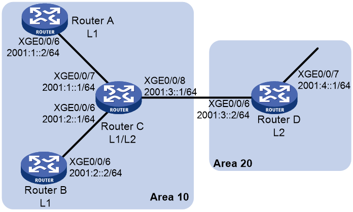

IPv6 IS-IS configuration examples
Example: Configuring IPv6 IS-IS basics
As shown in Figure 22, Router A, Router B, Router C, and Router D, all enabled with IPv6, reside in the same AS. Configure IPv6 IS-IS on the routers so that they can reach each other.
Figure 22 Network diagram
1.     Configure IPv6 addresses for interfaces. (Details not shown.)
2.     Configure IPv6 IS-IS:
[RouterA] isis 1
[RouterA-isis-1] address-family ipv6
[RouterA-isis-1-ipv6] quit
[RouterA-Ten-GigabitEthernet0/0/6] isis ipv6 enable 1
[RouterB] isis 1
[RouterB-isis-1] address-family ipv6
[RouterB-isis-1-ipv6] quit
[RouterB-Ten-GigabitEthernet0/0/6] isis ipv6 enable 1
[RouterC] isis 1
[RouterC-isis-1] address-family ipv6
[RouterC-isis-1-ipv6] quit
[RouterC-Ten-GigabitEthernet0/0/6] isis ipv6 enable 1
[RouterC-Ten-GigabitEthernet0/0/7] isis ipv6 enable 1
[RouterC-Ten-GigabitEthernet0/0/8] isis ipv6 enable 1
[RouterD] isis 1
[RouterD-isis-1] address-family ipv6
[RouterD-isis-1-ipv6] quit
[RouterD-Ten-GigabitEthernet0/0/6] isis ipv6 enable 1
[RouterD-Ten-GigabitEthernet0/0/7] isis ipv6 enable 1
# Display the IPv6 IS-IS routing table on Router A.
[RouterA] display isis route ipv6
                         Level-1 IPv6 forwarding table
 Destination : ::                                      PrefixLen: 0
 Flag        : R/-/-                                   Cost     : 10
 Next hop    : FE80::200:FF:FE0F:4                     Interface: XGE0/0/6
 Destination : 2001:1::                                PrefixLen: 64
 Flag        : D/L/-                                   Cost     : 10
 Next hop    : Direct                                  Interface: XGE0/0/6
 Destination : 2001:2::                                PrefixLen: 64
 Flag        : R/-/-                                   Cost     : 20
 Destination : 2001:3::                                PrefixLen: 64
# Display the IPv6 IS-IS routing table on Router B.
[RouterB] display isis route ipv6
# Display the IPv6 IS-IS routing table on Router C.
[RouterC] display isis route ipv6
 Next hop    : Direct                                  Interface: XGE0/0/7
 Next hop    : Direct                                  Interface: XGE0/0/8
                         Level-2 IPv6 forwarding table
 Destination : 2001:4::                               PrefixLen: 64
# Display the IPv6 IS-IS routing table on Router D.
[RouterD] display isis route ipv6
 Flag        : D/L/-                                   Cost     : 0

Example: Configuring IPv6 IS-IS FRR
As shown in Figure 24, Router A, Router B, and Router C reside in the same IS-IS routing domain.
·     Run IPv6 IS-IS on all the routers to interconnect them with each other.
·     Configure IPv6 IS-IS FRR so that when Link A fails, traffic can be switched to Link B immediately.
Figure 24 Network diagram
Table 9 Interface and IP address assignment
Device
Interface
IPv6 address
Device
Interface
IP address
Router A
XGE0/0/6
1::1/64
Router B
XGE0/0/6
3::1/64
XGE0/0/7
2::1/64
XGE0/0/7
2::2/64
Loop0
10::1/128
Loop0
20::1/128
Router C
XGE0/0/6
1::2/64
XGE0/0/7
3::2/64
1.     Configure IPv6 addresses for interfaces on the routers and enable IPv6 IS-IS. (Details not shown.)
2.     Configure IPv6 IS-IS FRR:
Enable IPv6 IS-IS FRR to calculate a backup next hop through LFA calculation, or designate a backup next hop by using a routing policy.
¡     (Method 1.) Enable IPv6 IS-IS FRR to calculate a backup next hop through LFA calculation:
<RouterA>system-view
[RouterA] isis 1
[RouterA-isis-1-ipv6] fast-reroute lfa
[RouterB] isis 1
[RouterB-isis-1-ipv6] fast-reroute lfa
¡     (Method 2.) Enable IPv6 IS-IS FRR to designate a backup next hop by using a routing policy:
[RouterA] ipv6 prefix-list abc index 10 permit 20::1 128
[RouterA-route-policy-frr-10] if-match ipv6 address prefix-list abc
[RouterA-route-policy-frr-10] apply ipv6 fast-reroute backup-interface ten-gigabitethernet 0/0/6 backup-nexthop 1::2
[RouterA] isis 1
[RouterA-isis-1-ipv6] fast-reroute route-policy frr
[RouterB] ipv6 prefix-list abc index 10 permit 10::1 128
[RouterB-route-policy-frr-10] if-match ipv6 address prefix-list abc
[RouterB-route-policy-frr-10] apply ipv6 fast-reroute backup-interface ten-gigabitethernet 0/0/6 backup-nexthop 3::2
[RouterB] isis 1
[RouterB-isis-1-ipv6] fast-reroute route-policy frr
# Display route 20::1/128 on Router A to view the backup next hop information.
[RouterA] display ipv6 routing-table 20::1 128 verbose
Summary count : 1
Destination: 20::1/128
   Protocol: IS_L1
 Process ID: 1
  SubProtID: 0x1                    Age: 00h27m45s
       Cost: 10              Preference: 15
  OrigTblID: 0xa                OrigVrf: default-vrf
    TableID: 0xa                 OrigAs: 0
      NibID: 0x24000005          LastAs: 0
     AttrID: 0xffffffff        Neighbor: ::
      Flags: 0x10041        OrigNextHop: FE80::34CD:9FF:FE2F:D02
      Label: NULL           RealNextHop: FE80::34CD:9FF:FE2F:D02
    BkLabel: NULL             BkNextHop: FE80::7685:45FF:FEAD:102
BkTunnel ID: Invalid        BkInterface: Ten-GigabitEthernet0/0/6
 SRTunnelID: Invalid
# Display route 10::1/128 on Router B to view the backup next hop information.
[RouterB] display ipv6 routing-table 10::1 128 verbose
Summary count : 1
Destination: 10::1/128
   Protocol: IS_L1
 Process ID: 1
  SubProtID: 0x1                    Age: 00h33m23s
      NibID: 0x24000006          LastAs: 0
