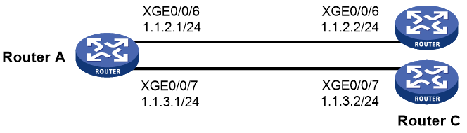

Example: Configuring packet type-based local PBR
As shown in Figure 1, Router B and Router C do not have a route to reach each other.
Configure PBR on Router A to forward all TCP packets to the next hop 1.1.2.2 (Router B).
Figure 1 Network diagram
1.     Configure Router A:

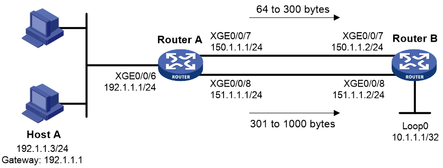

Example: Configuring packet type-based interface PBR
As shown in Figure 2, Router B and Router C do not have a route to reach each other.
Configure PBR on Router A to forward all TCP packets received on Ten-GigabitEthernet 0/0/6 to the next hop 1.1.2.2 (Router B).
Figure 2 Network diagram
1.     Configure IP addresses and unicast routing protocol settings to make sure Router B and Router C can reach Host A. (Details not shown.)
2.     Configure Router A:
