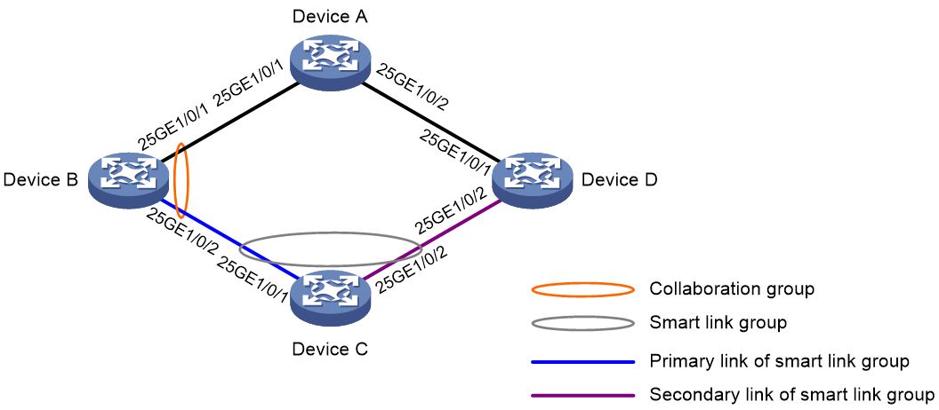

As shown in Figure 1, Device C accesses the core network through Device B. When Interface B1 goes down, the switchover of traffic from Device C to Device D is slow because Interface B2 is still up.
If Interface B1 and Interface B2 belong to one collaboration group, Device B brings down Interface B2 when Interface B1 goes down to achieve fast traffic switchover. Similarly, the device brings down Interface B1 when Interface B2 goes down.
Figure 1 Interface collaboration application scenario

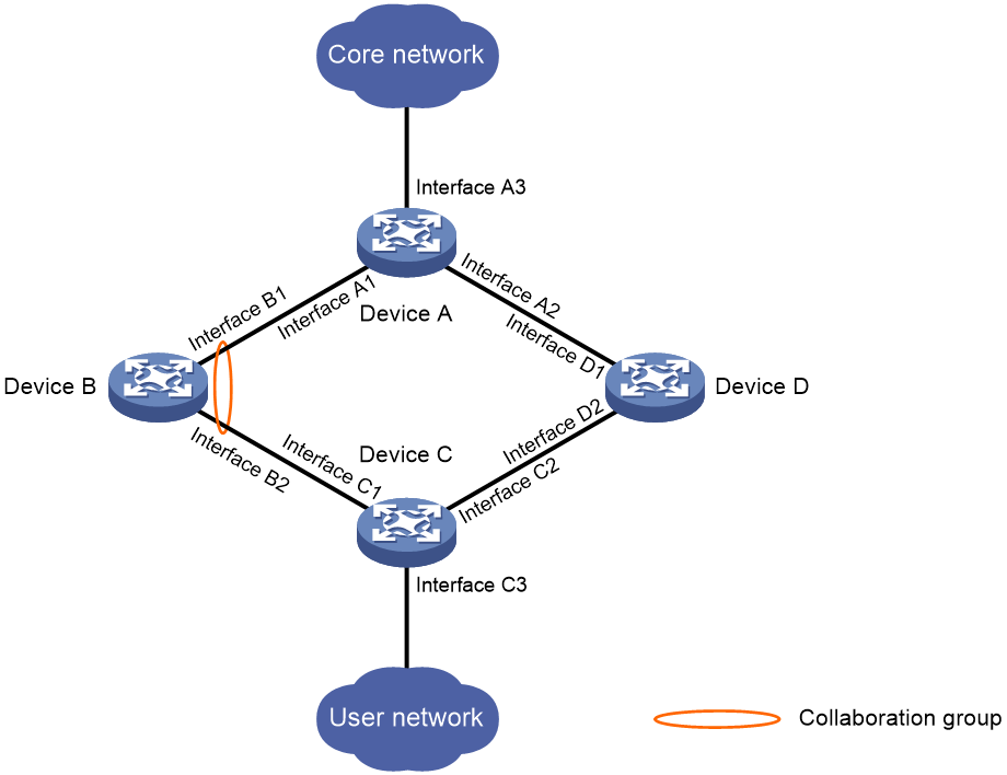

As shown in Figure 2, configure interface collaboration on Device B. When Twenty-FiveGigE 1/0/1 on Device B goes down, Device B brings down Twenty-FiveGigE 1/0/2. When Twenty-FiveGigE 1/0/2 on Device B goes down, Device B brings down Twenty-FiveGigE 1/0/1.
1. Configure routes to enable Device A and Device C to prefer the route through Device B for forwarding traffic to each other. (This example uses static routes):

1. Configure Smart Link on Device C:
# Create a smart link group, and configure Twenty-FiveGigE 1/0/1 as the primary port and Twenty-FiveGigE 1/0/2 as the secondary port for the smart link group. (Details not shown.)
For more information about configuring Smart Link, see "Configuring Smart Link."
2. Configure Device B:
# Enable Monitor Link globally. By default, Monitor Link is enabled globally.
<DeviceB> system-view
[DeviceB] undo monitor-link disable
# Create collaboration group 1.
[DeviceB] collaboration-group 1
# Assign Twenty-FiveGigE 1/0/1 and Twenty-FiveGigE 1/0/2 to collaboration group 1.
[DeviceB-collaboration-group1] port twenty-fivegige 1/0/1
[DeviceB-collaboration-group1] port twenty-fivegige 1/0/2
1. Verify that the state of the uplink interface affects the state of the downlink interface.
# Display information about smart link group 1 on Device C.
[DeviceC] display smart-link group 1
Smart link group 1 information:
Device ID : 2007-6f03-0700
Preemption mode : None
Preemption delay: 1(s)
Control VLAN : 1
Protected VLAN : Reference Instance 1
Member Role State Flush-count Last-flush-time
GE1/0/1 PRIMARY ACTIVE 2 20:19:28 2017/04/05
GE1/0/2 SECONDARY STANDBY 0 NA
The output shows that the primary port of smart link group 1 is Twenty-FiveGigE 1/0/1, and the traffic is sent out of Twenty-FiveGigE 1/0/1.
# Shut down Twenty-FiveGigE 1/0/1 on Device B, and display information about collaboration group 1.
[DeviceB] display collaboration-group 1 verbose
Collaboration group protocol status: Enabled
Collaboration group 1 information:
Group status : DOWN
Member up delay : 0 seconds
Last up time : 20:19:58 2017/04/05
Last down time : 20:27:02 2017/04/05
Member Status
GE1/0/1 DOWN
GE1/0/2 Collaboration-down
The output shows that collaboration group 1 is in DOWN state, Twenty-FiveGigE 1/0/1 is in DOWN state, and Twenty-FiveGigE 1/0/2 is in Collaboration-down state.
Control VLAN : 1
GE1/0/1 PRIMARY DOWN 2 20:19:28 2017/04/05
GE1/0/2 SECONDARY ACTIVE 1 20:26:35 2017/04/05
The output shows that Twenty-FiveGigE 1/0/2 becomes the primary port of smart link group 1, and the traffic is sent out of Twenty-FiveGigE 1/0/2.
2. Verify that the state of the downlink interface affects the state of the uplink interface.
# Display information about Twenty-FiveGigE 1/0/1 on Device A.
[DeviceA] display interface twenty-fivegige 1/0/1 brief
Brief information on interfaces in bridge mode:
Link: ADM - administratively down; Stby - standby
Speed: (a) - auto
Duplex: (a)/A - auto; H - half; F - full
Type: A - access; T - trunk; H - hybrid
Interface Link Speed Duplex Type PVID Description
GE1/0/1 UP 1G(a) F(a) A 1
The output shows that Twenty-FiveGigE 1/0/1 is in UP state.
# Shut down Twenty-FiveGigE 1/0/2 on Device B, and display information about collaboration group 1.
Group status : DOWN
Member Status
GE1/0/1 Collaboration-down
GE1/0/2 DOWN
The output shows that collaboration group 1 is in DOWN state, Twenty-FiveGigE 1/0/1 is in Collaboration-down state, and Twenty-FiveGigE 1/0/2 is in DOWN state.
Speed: (a) - auto
GE1/0/1 DOWN auto A A 1
The output shows that Twenty-FiveGigE 1/0/1 is in DOWN state.
