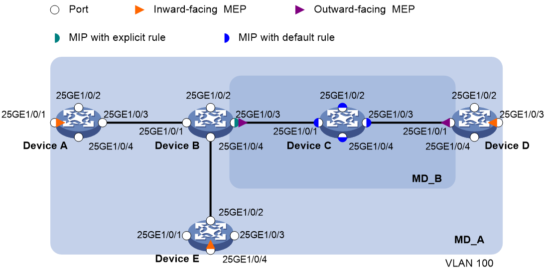

To accurately locate faults, CFD introduces eight levels (from 0 to 7) to MDs. The bigger the number, the higher the level and the larger the area covered. Domains can touch or nest (if the outer domain has a higher level than the nested one) but cannot intersect or overlap.
MD levels facilitate fault location and make fault location more accurate. As shown in Figure 1, MD_A in light blue nests MD_B in dark blue. If a connectivity fault is detected at the boundary of MD_A, any of the devices in MD_A, including Device A through Device E, might fail. If a connectivity fault is also detected at the boundary of MD_B, the failure points can be any of Device B through Device D. If the devices in MD_B can operate correctly, at least Device C is operational.
This section assumes that physical links between devices are in good condition.
Figure 1 Two nested MDs
CFD exchanges messages and performs operations on a per-domain basis. By planning MDs correctly in a network, you can use CFD to rapidly locate failure points.

·     Assign a name for each MA. Make sure that the devices in the same MA in the same MD use the same MA name.
·     Determine the MEP list of each MA in each MD. Make sure devices in the same MA maintain the same MEP list.
·     At the edges of MD and MA, MEPs must be designed at the device port. MIPs can be designed on devices or ports that are not at the edges of an Ethernet network.

Before configuring the MEPs and MIPs, you must first configure service instances. A service instance is a set of service access points (SAPs), and belongs to an MA in an MD.
In an Ethernet network, the MD and MA define the level attribute and VLAN attribute of the messages handled by the MPs in a service instance. The MPs of the MA that carries no VLAN attribute do not belong to any VLAN.
In an MPLS Layer 2 VPN, the MD and MA define the level attribute and cross-connect or VSI attribute of the messages handled by the MEPs in a service instance.

CFD is implemented through various operations on MEPs. As a MEP is configured on a service instance, the MD level and VLAN attribute or cross-connect or VSI attribute of the service instance become the attributes of the MEP.
In an Ethernet network, you can specify an interface as the MEP for only one of the non-VLAN-specific MAs at the same level. In addition, the MEP must be outward facing.
Before you configure MEPs, you must configure service instances.

Example: Configuring CFD in an Ethernet network
As shown in Figure 4:
·     The network comprises five devices and is divided into two MDs: MD_A (level 5) and MD_B (level 3). All ports belong to VLAN 100, and the MAs in the two MDs all serve VLAN 100. Assume that the MAC addresses of Device A through Device E are 0010-FC01-6511, 0010-FC02-6512, 0010-FC03-6513, 0010-FC04-6514, and 0010-FC05-6515, respectively.
·     MD_A has three edge ports: Twenty-FiveGigE 1/0/1 on Device A, Twenty-FiveGigE 1/0/3 on Device D, and Twenty-FiveGigE 1/0/4 on Device E. They are all inward-facing MEPs. MD_B has two edge ports: Twenty-FiveGigE 1/0/3 on Device B and Twenty-FiveGigE 1/0/1 on Device D. They are both outward-facing MEPs.
·     In MD_A, Device B is designed to have MIPs when its port is configured with low level MEPs. Port Twenty-FiveGigE 1/0/3 is configured with MEPs of MD_B, and the MIPs of MD_A can be configured on this port. You must configure the MIP generation rule of MD_A as explicit.
·     The MIPs of MD_B are designed on Device C, and are configured on all ports. You must configure the MIP generation rule as default.
·     Configure CC to monitor the connectivity among all the MEPs in MD_A and MD_B. Configure LB to locate link faults, and use the AIS and EAIS functions to suppress the error alarms that are reported.
·     Configure port collaboration on Twenty-FiveGigE 1/0/3 of Device B. After the outward-facing MEP on the interface detects a link fault, the interface is shut down or blocked.
·     After the status information of the entire network is obtained, use LT, LM, one-way DM, two-way DM, and TST to detect link faults.
Figure 4 Network diagram
On each device shown in Figure 4, create VLAN 100 and assign ports Twenty-FiveGigE 1/0/1 through Twenty-FiveGigE 1/0/4 to VLAN 100.
