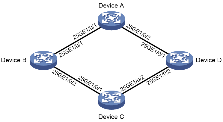

Application scenario
Smart Link is an H3C-proprietary protocol that provides link redundancy and subsecond convergence time in a dual uplink network. As shown in Figure 1, Smart Link is configured on Device C and Device D. The secondary link takes over quickly when the primary link fails.
Figure 1 Dual uplink network diagram
A Smart Link network has the following devices:
·     Smart Link devices—A Smart Link device has two uplinks. A Smart Link device must be configured with a smart link group and a transmit control VLAN to transmit flush messages. Device C and Device D in Figure 1 are Smart Link devices.
·     Associated devices—An associated device is an uplink device to which Smart Link devices are connected. An associated device supports Smart Link, and receives flush messages sent from the specified control VLAN. When a primary/secondary link switchover occurs, the associated device updates the MAC address entries and ARP/ND entries according to received flush messages. Device A, Device B, and Device E in Figure 1 are associated devices.

Smart link group
A smart link group consists of only two member ports: the primary and the secondary ports. Only one port is active for forwarding at a time, and the other port is blocked and in standby state. When link failure occurs on the active port due to port shutdown, the standby port becomes active and takes over. The original active port transits to the blocked state.
As shown in Figure 1, Port C1 and Port C2 of Device C form a smart link group. Port C1 is active, and Port C2 is standby. Port D1 and Port D2 of Device D form another smart link group. Port D1 is active, and Port D2 is standby.
Primary/secondary port
Primary port and secondary port are two port types in a smart link group. When both ports in a smart link group are up, the primary port preferentially transits to the forwarding state. The secondary port stays in standby state. When the primary port fails, the secondary port takes over to forward traffic.
As shown in Figure 1, Port C1 of Device C and Port D1 of Device D are primary ports. Port C2 of Device C and Port D2 of Device D are secondary ports.
Primary/secondary link
The link that connects the primary port in a smart link group is the primary link. The link that connects the secondary port is the secondary link.

How Smart Link works
Link backup
As shown in Figure 1, the link on Port C1 of Device C is the primary link. The link on Port C2 of Device C is the secondary link. Port C1 is in forwarding state, and Port C2 is in standby state. When the primary link fails, Port C2 takes over to forward traffic and Port C1 is blocked and placed in standby state.
When a port switches to the forwarding state, the system outputs log information to notify the user of the port state change.

Preemption mode
As shown in Figure 1, the link on Port C1 of Device C is the primary link. The link on Port C2 of Device C is the secondary link. When the primary link fails, Port C1 is automatically blocked and placed in standby state, and Port C2 takes over to forward traffic. When the primary link recovers, one of the following actions occurs:
·     If the smart link group is not configured with a preemption mode, Port C1 stays blocked to keep traffic forwarding stable. Port C1 does not take over to forward traffic until the next link switchover.
·     If the smart link group is configured with a preemption mode and the preemption conditions are met, Port C1 takes over to forward traffic as soon as its link recovers. Port C2 is automatically blocked and placed in standby state.

Example: Configuring multiple smart link groups load sharing
As shown in Figure 3:
·     Device C is a Smart Link device. Device A, Device B, and Device D are associated devices. Traffic of VLANs 1 through 200 on Device C is dually uplinked to Device A by Device B and Device D.
·     Implement dual uplink backup and load sharing on Device C. Traffic of VLANs 1 through 100 is uplinked to Device A by Device B. Traffic of VLANs 101 through 200 is uplinked to Device A by Device D.
Figure 3 Network diagram
1.     Configure Device C:
# Create VLAN 1 through VLAN 200.
<DeviceC> system-view
[DeviceC] vlan 1 to 200
# Map VLANs 1 through 100 to MSTI 1, and VLANs 101 through 200 to MSTI 2.
[DeviceC] stp region-configuration
[DeviceC-mst-region] instance 1 vlan 1 to 100
[DeviceC-mst-region] instance 2 vlan 101 to 200
# Activate the MST region configuration.
[DeviceC-mst-region] active region-configuration
[DeviceC-mst-region] quit
# Shut down Twenty-FiveGigE 1/0/1.
[DeviceC] interface twenty-fivegige 1/0/1
[DeviceC-Twenty-FiveGigE1/0/1] shutdown
# Disable the spanning tree feature on the port.
[DeviceC-Twenty-FiveGigE1/0/1] undo stp enable
# Configure the port as a trunk port.
[DeviceC-Twenty-FiveGigE1/0/1] port link-type trunk
# Assign the port to VLAN 1 through VLAN 200.
[DeviceC-Twenty-FiveGigE1/0/1] port trunk permit vlan 1 to 200
[DeviceC-Twenty-FiveGigE1/0/1] quit
# Configure Twenty-FiveGigE 1/0/2 in the same way Twenty-FiveGigE 1/0/1 is configured.
[DeviceC] interface twenty-fivegige 1/0/2
[DeviceC-Twenty-FiveGigE1/0/2] shutdown
[DeviceC-Twenty-FiveGigE1/0/2] undo stp enable
[DeviceC-Twenty-FiveGigE1/0/2] port link-type trunk
[DeviceC-Twenty-FiveGigE1/0/2] port trunk permit vlan 1 to 200
[DeviceC-Twenty-FiveGigE1/0/2] quit
# Create smart link group 1, and configure all VLANs mapped to MSTI 1 as the protected VLANs for smart link group 1.
[DeviceC] smart-link group 1
[DeviceC-smlk-group1] protected-vlan reference-instance 1
# Configure Twenty-FiveGigE 1/0/1 as the primary port and Twenty-FiveGigE 1/0/2 as the secondary port for smart link group 1.
[DeviceC-smlk-group1] port twenty-fivegige 1/0/1 primary
[DeviceC-smlk-group1] port twenty-fivegige 1/0/2 secondary
# Enable role preemption in smart link group 1, enable flush message sending, and configure VLAN 10 as the transmit control VLAN.
[DeviceC-smlk-group1] preemption mode role
[DeviceC-smlk-group1] flush enable control-vlan 10
[DeviceC-smlk-group1] quit
# Create smart link group 2, and configure all VLANs mapped to MSTI 2 as the protected VLANs for smart link group 2.
[DeviceC] smart-link group 2
[DeviceC-smlk-group2] protected-vlan reference-instance 2
# Configure Twenty-FiveGigE 1/0/1 as the secondary port and Twenty-FiveGigE 1/0/2 as the primary port for smart link group 2.
[DeviceC-smlk-group2] port twenty-fivegige 1/0/2 primary
[DeviceC-smlk-group2] port twenty-fivegige 1/0/1 secondary
# Enable role preemption in smart link group 2, enable flush message sending, and configure VLAN 110 as the transmit control VLAN.
[DeviceC-smlk-group2] preemption mode role
[DeviceC-smlk-group2] flush enable control-vlan 110
[DeviceC-smlk-group2] quit
# Bring up Twenty-FiveGigE 1/0/1 and Twenty-FiveGigE 1/0/2.
[DeviceC-Twenty-FiveGigE1/0/1] undo shutdown
[DeviceC-Twenty-FiveGigE1/0/2] undo shutdown
2.     Configure Device B:
<DeviceB> system-view
[DeviceB] vlan 1 to 200
# Configure Twenty-FiveGigE 1/0/1 as a trunk port.
[DeviceB] interface twenty-fivegige 1/0/1
[DeviceB-Twenty-FiveGigE1/0/1] port link-type trunk
# Assign the port to VLANs 1 through 200.
[DeviceB-Twenty-FiveGigE1/0/1] port trunk permit vlan 1 to 200
# Enable flush message receiving and configure VLAN 10 and VLAN 110 as the receive control VLANs on the port.
[DeviceB-Twenty-FiveGigE1/0/1] smart-link flush enable control-vlan 10 110
[DeviceB-Twenty-FiveGigE1/0/1] quit
# Configure Twenty-FiveGigE 1/0/2 as a trunk port.
[DeviceB] interface twenty-fivegige 1/0/2
[DeviceB-Twenty-FiveGigE1/0/2] port link-type trunk
[DeviceB-Twenty-FiveGigE1/0/2] port trunk permit vlan 1 to 200
[DeviceB-Twenty-FiveGigE1/0/2] undo stp enable
[DeviceB-Twenty-FiveGigE1/0/2] smart-link flush enable control-vlan 10 110
[DeviceB-Twenty-FiveGigE1/0/2] quit
3.     Configure Device D:
<DeviceD> system-view
[DeviceD] vlan 1 to 200
[DeviceD] interface twenty-fivegige 1/0/1
[DeviceD-Twenty-FiveGigE1/0/1] port link-type trunk
[DeviceD-Twenty-FiveGigE1/0/1] port trunk permit vlan 1 to 200
[DeviceD-Twenty-FiveGigE1/0/1] smart-link flush enable control-vlan 10 110
[DeviceD-Twenty-FiveGigE1/0/1] quit
[DeviceD] interface twenty-fivegige 1/0/2
[DeviceD-Twenty-FiveGigE1/0/2] port link-type trunk
[DeviceD-Twenty-FiveGigE1/0/2] port trunk permit vlan 1 to 200
[DeviceD-Twenty-FiveGigE1/0/2] undo stp enable
[DeviceD-Twenty-FiveGigE1/0/2] smart-link flush enable control-vlan 10 110
[DeviceD-Twenty-FiveGigE1/0/2] quit
4.     Configure Device A:
<DeviceA> system-view
[DeviceA] vlan 1 to 200
[DeviceA] interface twenty-fivegige 1/0/1
[DeviceA-Twenty-FiveGigE1/0/1] port link-type trunk
[DeviceA-Twenty-FiveGigE1/0/1] port trunk permit vlan 1 to 200
[DeviceA-Twenty-FiveGigE1/0/1] smart-link flush enable control-vlan 10 110
[DeviceA-Twenty-FiveGigE1/0/1] quit
[DeviceA] interface twenty-fivegige 1/0/2
[DeviceA-Twenty-FiveGigE1/0/2] port link-type trunk
[DeviceA-Twenty-FiveGigE1/0/2] port trunk permit vlan 1 to 200
[DeviceA-Twenty-FiveGigE1/0/2] smart-link flush enable control-vlan 10 110
[DeviceA-Twenty-FiveGigE1/0/2] quit
# Display the smart link group configuration on Device C.
[DeviceC] display smart-link group all
