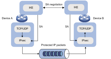

IPsec implementation
To implement IPsec protection for packets between two peers, complete the following tasks on each peer:
·     Configure an IPsec policy, which defines the range of packets to be protected by IPsec and the security parameters used for the protection.
·     Apply the IPsec policy to an interface or an application.
When you apply an IPsec policy to an interface, you implement IPsec based on the interface. Packets received and sent by the interface are protected according to the IPsec policy. When you apply an IPsec policy to an application, you implement IPsec based on the application. Packets of the application are protected according to the IPsec policy, regardless of the receiving and sending interface of the packets.
IPsec protects packets as follows:
·     When an IPsec peer identifies the packets to be protected according to the IPsec policy, it sets up an IPsec tunnel and sends the packet to the remote peer through the tunnel. The IPsec tunnel can be manually configured beforehand, or it can be set up through IKE negotiation triggered by the packet. The IPsec tunnels are actually the IPsec SAs. The inbound packets are protected by the inbound SA, and the outbound packets are protected by the outbound SA.
·     When the remote IPsec peer receives the packet, it drops, de-encapsulates, or directly forwards the packet according to the configured IPsec policy.
Interface-based IPsec supports setting up IPsec tunnels based on ACLs.

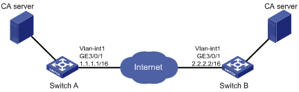

Configuring a manual mode IPsec tunnel for IPv4 packets
Network requirements
As shown in Figure 4, establish an IPsec tunnel between Switch A and Switch B to protect data flows in between. Configure the tunnel as follows:
·     Specify the encapsulation mode as tunnel, the security protocol as ESP, the encryption algorithm as AES-CBC-128, and the authentication algorithm as HMAC-SHA1.
·     Manually set up IPsec SAs.
Figure 4 Network diagram

Configuring an IKE-based IPsec tunnel for IPv4 packets
As shown in Figure 5, establish an IPsec tunnel between Switch A and Switch B to protect data flows in between. Configure the IPsec tunnel as follows:
·     Set up SAs through IKE negotiation.
Figure 5 Network diagram
Configuration procedure

Configuring an IKE-based IPsec tunnel for IPv6 packets
As shown in Figure 6, establish an IPsec tunnel between Switch A and Switch B to protect data flows in between. Configure the IPsec tunnel as follows:
Figure 6 Network diagram

As shown in Figure 8, IKE negotiates SAs for IPsec and transfers the SAs to IPsec, and IPsec uses the SAs to protect IP packets.
Figure 8 Relationship between IKE and IPsec

Main mode IKE with pre-shared key authentication configuration example
As shown in Figure 10, configure an IPsec tunnel that uses IKE negotiation between Switch A and Switch B to protect the communication in between.
Configure Switch A and Switch B to use the default IKE proposal for IKE negotiation to set up IPsec SAs. Configure the two switches to use the pre-shared key authentication method for the phase-1 IKE negotiation.
Figure 10 Network diagram
Before the configuration, make sure Switch A and Switch B can reach each other.

Aggressive mode with RSA signature authentication configuration example
This configuration example is not available when the device is operating in FIPS mode.
As shown in Figure 11, configure an IPsec tunnel that uses IKE negotiation between Switch A and Switch B to protect the communication in between.
Configure Switch A and Switch B to use aggressive mode for the phase-1 IKE negotiation and use RSA signature for authentication.
Figure 11 Network diagram
1.     Configure Switch A:
# Configure an IP address for VLAN-interface 1.
<SwitchA> system-view
[SwitchA] interface vlan-interface 1
[SwitchA-vlan-interface1] ip address 1.1.1.1 255.255.255.0
[SwitchA-vlan-interface1] quit
# Configure ACL 3101 to identify data flows between Switch A and Switch B.

# Create an IKE-based IPsec policy entry with the name map1 and the sequence number 10.
[SwitchA] ipsec policy map1 10 isakmp
# Specify the remote IP address as 2.2.2.2 for the IPsec tunnel.
[SwitchA-ipsec-policy-isakmp-map1-10] remote-address 2.2.2.2
# Reference IPsec transform set tran1.
[SwitchA-ipsec-policy-isakmp-map1-10] transform-set tran1
# Reference ACL 3101.
[SwitchA-ipsec-policy-isakmp-map1-10] security acl 3101
# Reference IKE profile profile1.
[SwitchA-ipsec-policy-isakmp-map1-10] ike-profile profile1
[SwitchA-ipsec-policy-isakmp-map1-10] quit
# Apply the IPsec policy map1 to VLAN-interface 1.
[SwitchA-Vlan-interface1] ipsec apply policy map1
# Specify an Ethernet interface card for forwarding traffic on VLAN-interface 1.
[SwitchA-Vlan-interface1] service slot 3
[SwitchA-Vlan-interface1] quit
