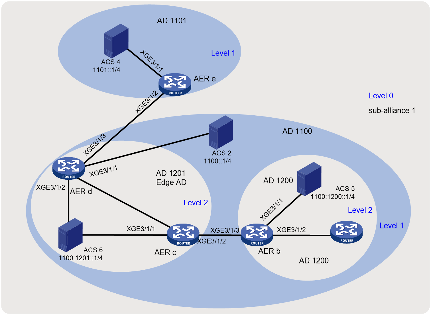

State Machine Based Anti-Spoofing (SMA) prevents IPv6 spoofing attacks between autonomous systems by verifying source IPv6 addresses.
SMA network
As shown in Figure 1, an SMA network mainly contains the following components: AS Control Server (ACS) and AS Edge Router (AER).
Figure 1 SMA network diagram
· Sub-trust alliance (hereinafter referred to as sub-alliance)—A group of ADs that trust each other. It is identified by a sub-alliance ID.
· Trust alliance (hereinafter referred to as alliance)—Collection of all ADs in the SMA system.
· Address domain (AD)—A group of IP address ranges managed by the same organization. It is the management object of a sub-alliance and is identified by an AD ID (AD 11.1, AD 1200, and AD 1201 for example). You can divide ADs in the same sub-alliance into a maximum of four levels to form a hierarchy structure. Smaller the level number, higher the level. For example, create level 0 for a city, create level 1 for an institution in the city, and create level 2 for a building or department of the institution. ADs contain the following types:
¡ Edge AD—An AD that connects the local level to another level, for example, AD 1201 in the figure.
¡ Non-edge AD.
If you create ADs of a lower level in an AD, for example, a level-1 AD in the level-0 AD, all devices (except for ACSs) in the original AD must be added to an AD of the lower level. As shown in Figure 1, all devices in the level-0 AD are in a level-1 AD.
· AS Control Server (ACS)—Required in each AD at every level. An ACS performs the following tasks:
¡ Exchanges IPv6 prefix and state machine information with ACSs of other sub-alliances in the same alliance.
¡ Sends alliance mapping, IPv6 prefix, and tag information to AERs of the local AD.
· AS Edge Router (AER)—Receives IPv6 prefix and tag information notified by ACSs and forwards packets between ADs. An AER can provide services for multiple ACSs at different levels. An AER has the following types of interfaces:
¡ Ingress interface—Connected to an SMA-disabled router in the local AD.
¡ Egress interface—Connected to an AER in another AD.
NOTE: · For security purposes, you can configure the ACSs to establish SSL links with each other and AERs. · The device can operate only as an AER. |

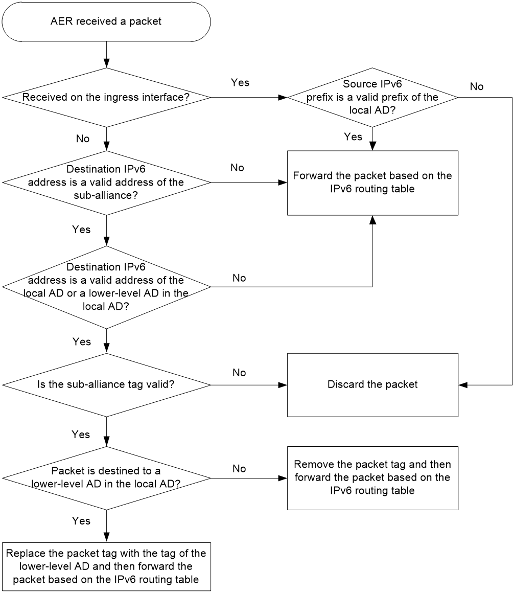

For incoming packets from other ADs to the local AD
An AER processes a received packet as follows:
1. Examine the interface type.
¡ If the interface is the ingress interface, the AER proceeds to step 2.
¡ If the interface is the egress interface, the AER proceeds to step 3.
2. Examine whether the source IPv6 prefix is a valid IPv6 prefix of the local AD.
¡ If yes, the AER forwards the packet based on the IPv6 routing table.
¡ If no, the AER discards the packet.
3. Examine whether the destination IPv6 prefix is a valid IPv6 prefix of the sub-alliance.
¡ If yes, the AER proceeds to the next step.
¡ If no, the AER forwards the packet based on the IPv6 routing table.
4. Examine whether the destination IPv6 address is a valid address of the local AD or an AD at a lower level in the local AD.
5. Examine the validity of the sub-alliance tag.
¡ If the tag is valid, the AER proceeds to the next step.
¡ If the tag is invalid, the AER discards the packet.
6. Examine whether the packet is destined to an AD at a lower level in the local AD.
¡ If yes, the AER replaces the packet tag with the tag of the lower-level AD, and then forwards the packet based on the IPv6 routing table.
The lower-level AER processes the packet in the same way.
¡ If no, the AER removes the packet tag, and then forwards the packet based on the IPv6 routing table.
Figure 2 Incoming packet processing workflow

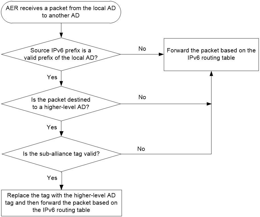

For outgoing packets from the local AD to another AD
An AER processes an outgoing packet as follows:
1. Examine whether the source IPv6 prefix is a valid prefix of the local AD.
¡ If yes, the AER adds a tag to the packet and then forwards the packet based on the IPv6 routing table.
¡ If no, the AER proceeds to the next step.
2. Examine whether the packet is destined to a higher-level AD of the local AD.
3. Examine the validity of the sub-alliance tag.
¡ If yes, the AER replaces the tag with the higher-level AD tag and then forwards the packet based on the IPv6 routing table.
Figure 3 Outgoing packet processing workflow

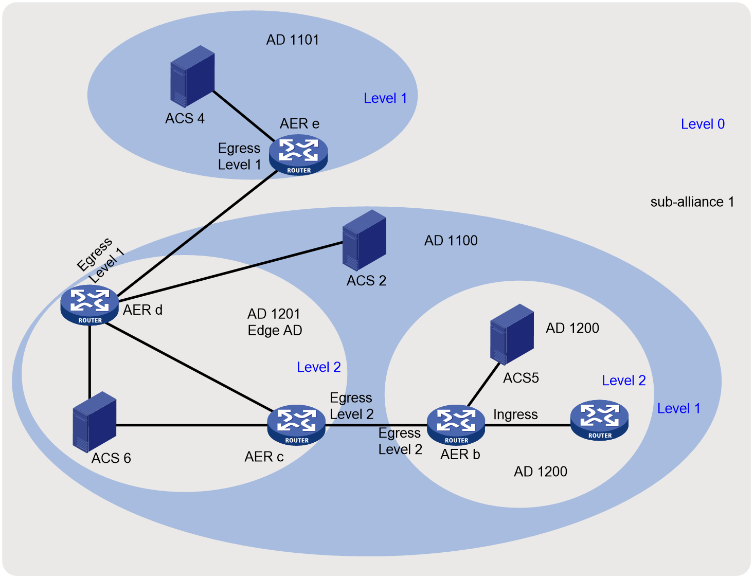

Network requirements
As shown in Figure 4, configure ACSs and AERs to use SMA with SSL links to prevent IPv6 source address spoofing.

Synchronize clocks for all devices in the alliance.
1. Configure ACSs. (Details not shown.)
2. Configure AER b.
# Configure an IPv6 address for AER b. (Details not shown.)
# Create SSL client policy sma on AER b.
<AERb> system-view
[AERb] ssl client-policy sma
# Disable the SSL client from authenticating SSL servers through digital certificates if SSL server authentication is not required. Server authentication is enabled by default.
[AERb-ssl-client-policy-sma] undo server-verify enable
[AERb-ssl-client-policy-sma] quit
# Enable SMA on AER b and configure an SSL link between AER b and ACS 5.
[AERb] sma-anti-spoof ipv6 enable
[AERb] sma-anti-spoof ipv6 server 1100:1200::1 client 1100:1200::2 ssl-client-policy sma address-domain-level 2
# Specify AD 1200 for AER b.
[AERb] sma-anti-spoof ipv6 address-domain 1200
# Specify sub-alliance 1 for AER b.
[AERb] sma-anti-spoof ipv6 sub-alliance 1
# Configure SMA interfaces for AER b.
[AERb] interface ten-gigabitethernet 3/1/2
[AERb-Ten-GigabitEthernet3/1/2] sma-anti-spoof ipv6 port-type ingress
[AERb-Ten-GigabitEthernet3/1/2] quit
[AERb] interface Ten-GigabitEthernet 3/1/3
[AERb-Ten-GigabitEthernet3/1/3] sma-anti-spoof ipv6 port-type egress level 2
[AERb-Ten-GigabitEthernet3/1/3] quit
3. Configure AER c.
# Configure an IPv6 address for AER c. (Details not shown.)
# Create SSL client policy sma on AER c.
<AERc> system-view
[AERc] ssl client-policy sma
[AERc-ssl-client-policy-sma] undo server-verify enable
[AERc-ssl-client-policy-sma] quit
# Enable SMA on AER c and configure an SSL link between AER c and ACS 6.
[AERc] sma-anti-spoof ipv6 enable
[AERc] sma-anti-spoof ipv6 server 1100:1201::1 client 1100:1201::3 ssl-client-policy sma address-domain-level 2
# Specify AD 1201 for AER c.
[AERc] sma-anti-spoof ipv6 address-domain 1201
# Specify sub-alliance 1 for AER c.
[AERc] sma-anti-spoof ipv6 sub-alliance 1
# Configure the SMA interface for AER c.
[AERc] interface ten-gigabitethernet 3/1/2
[AERc-Ten-GigabitEthernet3/1/2] sma-anti-spoof ipv6 port-type egress level 2
[AERc-Ten-GigabitEthernet3/1/2] quit
4. Configure AER d.
# Configure IPv6 addresses for AER d. (Details not shown.)
# Create SSL client policy sma on AER d.
<AERd> system-view
[AERd] ssl client-policy sma
[AERd-ssl-client-policy-sma] undo server-verify enable
[AERd-ssl-client-policy-sma] quit
# Enable SMA on AER d and configure AER d to establish SSL links with ACS 6 and ACS 2.
[AERd] sma-anti-spoof ipv6 enable
[AERd] sma-anti-spoof ipv6 server 1100:1201::1 client 1100:1201::2 ssl-client-policy sma address-domain-level 2
[AERd] sma-anti-spoof ipv6 server 1100::1 client 1100::2 ssl-client-policy sma address-domain-level 1
# Specify AD 1201 for AER d.
[AERd] sma-anti-spoof ipv6 address-domain 1201
# Specify sub-alliance 1 for AER d.
[AERd] sma-anti-spoof ipv6 sub-alliance 1
# Configure the SMA interface for AER d.
[AERd] interface ten-gigabitethernet 3/1/3
[AERd-Ten-GigabitEthernet3/1/3] sma-anti-spoof ipv6 port-type egress level 1
[AERd-Ten-GigabitEthernet3/1/3] quit

Example: Configuring SMA using TCP links
As shown in Figure 5, configure ACSs and AERs to use SMA with TCP links to prevent IPv6 source address spoofing.
Device |
Interface |
IP address |
Device |
Interface |
IP address |
AER e |
XGE3/1/1 |
1101::2/4 |
AER c |
XGE3/1/1 |
1100:1201::3/4 |
AER d |
XGE3/1/1 |
1100::2/4 |
AER b |
XGE3/1/3 |
1100:1200::2/4 |
XGE3/1/2 |
1100:1201::2/4 |
2. Configure AER b.
# Enable SMA on AER b and configure an TCP link between AER b and ACS 5.
<AERc> system-view
[AERb] sma-anti-spoof ipv6 server 1100:1200::1 client 1100:1200::2 address-domain-level 2
3. Configure AER c.
# Enable SMA on AER c and configure an TCP link between AER c and ACS 6.
<AERc> system-view
[AERc] sma-anti-spoof ipv6 server 1100:1201::1 client 1100:1201::3 address-domain-level 2
4. Configure AER d.
# Enable SMA on AER d and configure AER d to establish TCP links with ACS 6 and ACS 2.
<AERc> system-view
[AERd] sma-anti-spoof ipv6 server 1100:1201::1 client 1100:1201::2 address-domain-level 2
[AERd] sma-anti-spoof ipv6 server 1100::1 client 1100::2 address-domain-level 1
5. Configure AER e.
# Configure an IPv6 address for AER e. (Details not shown.)
# Enable SMA on AER d and configure a TCP link between AER e and ACS 4.
<AERc> system-view
[AERe] sma-anti-spoof ipv6 enable
[AERe] sma-anti-spoof ipv6 server 1101::1 client 1101::2 address-domain-level 2
# Specify AD 1101 for AER e.
[AERe] sma-anti-spoof ipv6 address-domain 1101
# Specify sub-alliance 1 for AER e.
[AERe] sma-anti-spoof ipv6 sub-alliance 1
# Configure the SMA interface for AER e.
[AERe] interface ten-gigabitethernet 3/1/2
[AERe-Ten-GigabitEthernet3/1/2] sma-anti-spoof ipv6 port-type egress level 1
[AERe-Ten-GigabitEthernet3/1/2] quit
