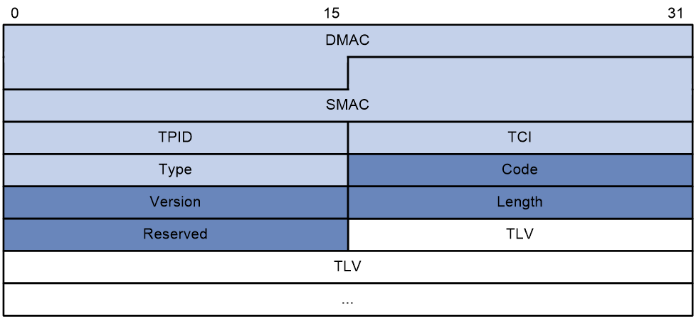

Loop detection frame format
As shown in Figure 1, a loop detection frame contains the Ethernet header, loop detection header, and loop detection TLVs.
Figure 1 Loop detection frame format
The Ethernet frame header of a loop detection frame contains the following fields:
·     DMAC—Destination MAC address of the frame, which is the multicast MAC address 010f-e200-0007. When a loop detection-enabled device receives a frame with this destination MAC address, it performs the following operations:
¡     Sends the frame to the CPU.
¡     Floods the frame in the VLAN from which the frame was originally received.
·     SMAC—Source MAC address of the frame, which is the bridge MAC address of the sending device.
·     TPID—Type of the VLAN tag, with the default value of 0x8100.
·     TCI—Tag control information, including the priority and VLAN ID.
·     Type—Protocol type, with the value of 0x8918.
The loop detection header of a loop detection frame contains the following fields:
·     Code—Protocol sub-type, which is 0x0001, indicating the loop detection type.
·     Version—Protocol version, which is reserved. This field is fixed at 0x0000.
·     Length—Length of the frame. The value includes the loop detection header, but excludes the Ethernet header.
·     Reserved—This field is reserved.
Payload of a loop detection frame is encapsulated as TLV triplets.

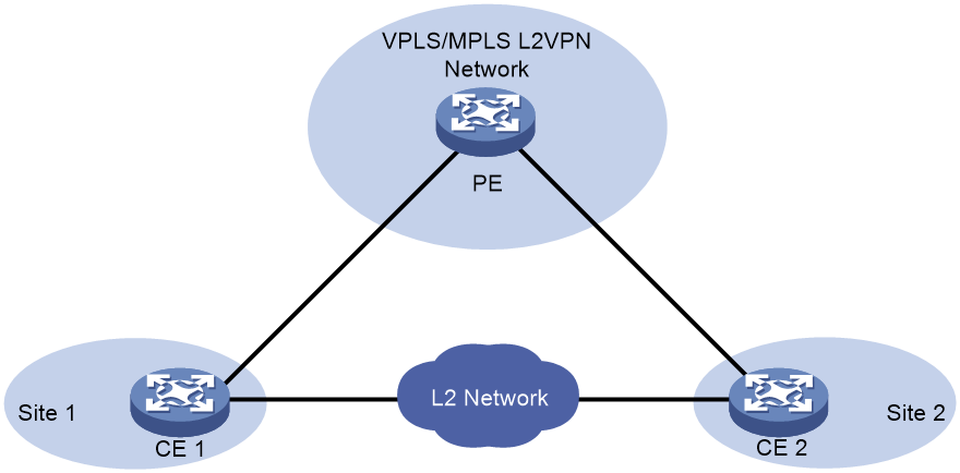

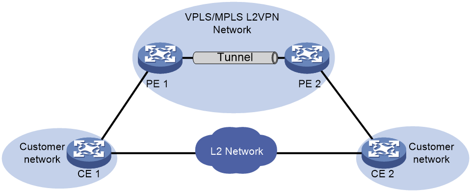

Remote site loop detection
As shown in Figure 2, two PEs provide data transmission services for the CEs attached to the customer network sites. Because the CEs have Layer 2 connectivity, broadcast storms can spread across the customer network sites.
To remove loops from the VPLS or MPLS L2VPN network, configure loop detection on the PE interfaces that are attached to CEs. When a PE detects a loop on a CE-facing interface, it blocks the interface to remove the loop.

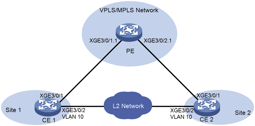

As shown in Figure 3, a PE is attached to two CEs at the local sites, and the CEs have Layer 2 connectivity. To remove loops from the local sites, configure loop detection on the PE interfaces that are attached to CEs. When a PE detects a loop on a CE-facing interface, it blocks the interface to remove the loop.

As shown in Figure 4, the PE provides user traffic transmission service for the CEs of the local sites, and the CEs have Layer 2 connectivity in VLAN 10. Configure loop detection on the CE-facing interfaces of the PE so that the PE can block the interfaces if loops exist.
Figure 4 Network diagram
