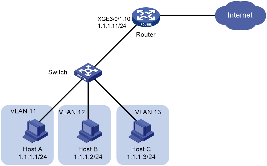

As shown in Figure 1, Host A and Host B are in different VLANs. For the two hosts to communicate with each other, perform the following tasks:
1.     Specify 1.1.1.1/24 and 1.1.2.1/24 as the gateway IP address for Host A and Host B, respectively.
2.     On the device, configure Dot1q termination on Layer 3 Ethernet subinterfaces Subinterface A.2 and Subinterface A.3.
Figure 1 Inter-VLAN communication through Layer 3 subinterfaces

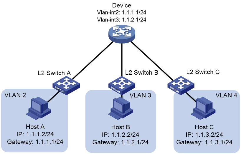

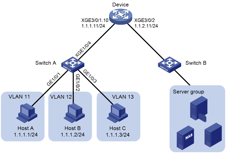

As shown in Figure 2, Host A is in VLAN 2, Host B is in VLAN 3, and Host C is in VLAN 4. For Host A and Host B to communicate with each other, perform the following tasks:
2.     On the device, create VLAN-interface 2 and configure the IP address as 1.1.1.1/24, which is the same as the gateway address of Host A. Create VLAN-interface 3 and configure the IP address as 1.1.2.1/24, which is the same as the gateway address of Host B.
VLAN termination by the outermost VLAN ID of packets is automatically performed on VLAN interfaces. For example, when Host A sends a packet to Host B, VLAN-interface 2 removes the VLAN tag from the packet and forwards it to VLAN-interface 3. Then, VLAN-interface 3 tags the packet with VLAN 3 and Host B can receive the packet.
Because the device does not have a VLAN interface to terminate packets from VLAN 4, Host C cannot communicate with Host A or Host B.
Figure 2 Inter-VLAN communication through VLAN interfaces

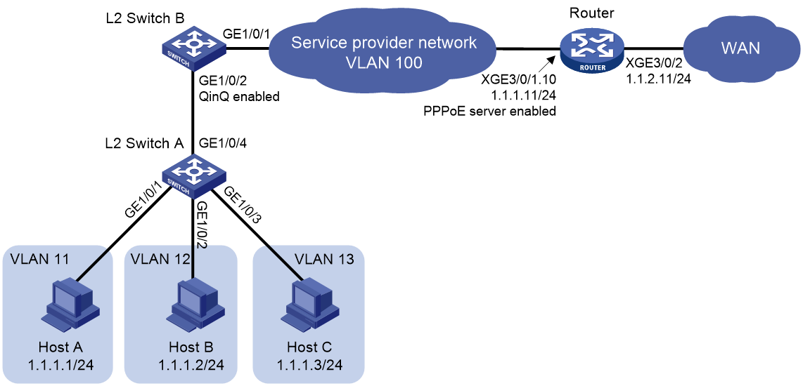

LAN-WAN communication

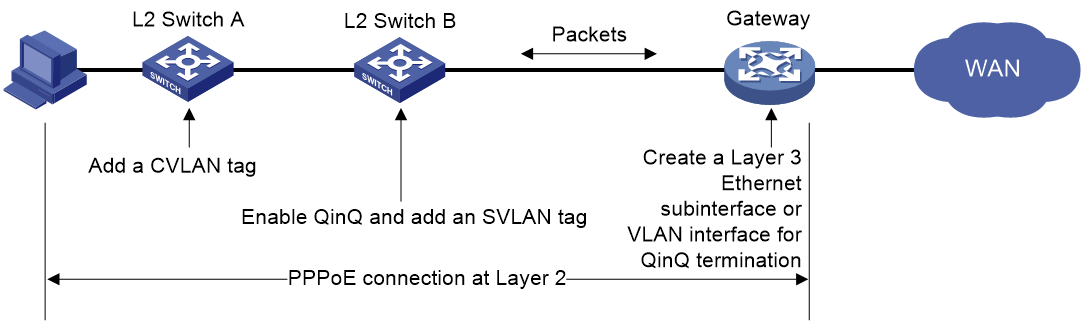

Typically, WAN protocols such as PPP do not recognize VLAN-tagged packets from LANs. Before packets are sent to a WAN, the sending port must locally record the VLAN information and remove VLAN tags from the packets.
As shown in Figure 3, a host is located on a customer network and wants to access the WAN network through a PPPoE connection. CVLAN and SVLAN represent the VLAN on the customer network and service provider network, respectively.
To access the WAN network, a packet originating from the host is processed as follows:
1.     Layer 2 Switch A adds a CVLAN tag to the packet and sends the packet.
2.     Layer 2 Switch B adds an SVLAN tag to the packet on the QinQ-enabled port.
3.     The packet is forwarded on the service provider network based on the SVLAN tag.
4.     The gateway removes the two layers of VLAN tags from the packet and adds new VLAN tags on the QinQ termination-enabled port.
5.     The gateway sends the packet to the WAN.
Figure 3 VLAN termination enables LAN-WAN communication

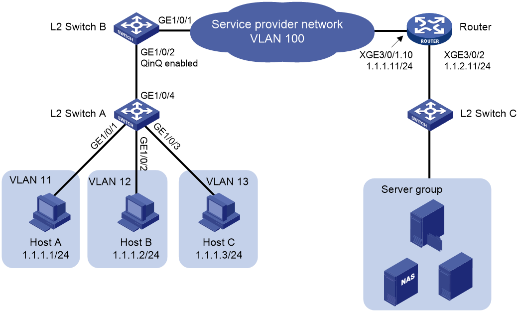

Example: Configuring ambiguous Dot1q termination
As shown in Figure 4, configure ambiguous Dot1q termination so that hosts in different VLANs can communicate with the server group.
Figure 4 Network diagram
In this example, L2 Switch B uses the factory configuration.
1.     Configure Host A, Host B, and Host C:
# Assign 1.1.1.1/24, 1.1.1.2/24, and 1.1.1.3/24 to Host A, Host B, and Host C, respectively. (Details not shown.)
# Specify 1.1.1.11/24 as the gateway IP address for the hosts. (Details not shown.)
2.     Configure Layer 2 Switch A:
# Create VLAN 11.
<L2_SwitchA> system-view
[L2_SwitchA] vlan 11
# Assign GigabitEthernet 1/0/1 to VLAN 11.
[L2_SwitchA-vlan11] port gigabitethernet 1/0/1
[L2_SwitchA-vlan11] quit
# Create VLAN 12.
[L2_SwitchA] vlan 12
# Assign GigabitEthernet 1/0/2 to VLAN 12.
[L2_SwitchA-vlan12] port gigabitethernet 1/0/2
[L2_SwitchA-vlan12] quit
# Create VLAN 13.
[L2_SwitchA] vlan 13
# Assign GigabitEthernet 1/0/3 to VLAN 13.
[L2_SwitchA-vlan13] port gigabitethernet 1/0/3
[L2_SwitchA-vlan13] quit
# Configure Ten-GigabitEthernet 1/0/4 as a trunk port and assign the port to VLANs 11 through 13.
[L2_SwitchA] interface ten-gigabitethernet 1/0/4
[L2_SwitchA-Ten-GigabitEthernet1/0/4] port link-type trunk
[L2_SwitchA-Ten-GigabitEthernet1/0/4] port trunk permit vlan 11 to 13
3.     Configure the device:
# Create Ethernet subinterface Ten-GigabitEthernet 3/0/1.10 and assign an IP address to the subinterface.
<Device> system-view
[Device] interface ten-gigabitethernet 3/0/1.10
[Device-Ten-GigabitEthernet3/0/1.10] ip address 1.1.1.11 255.255.255.0
# Enable Dot1q termination on Ten-GigabitEthernet 3/0/1.10 to terminate VLAN-tagged packets whose Layer 1 VLAN IDs are 11, 12, or 13.
[Device-Ten-GigabitEthernet3/0/1.10] vlan-type dot1q vid 11 to 13
# Enable Ten-GigabitEthernet 3/0/1.10 to transmit broadcasts and multicasts.
[Device-Ten-GigabitEthernet3/0/1.10] vlan-termination broadcast enable
[Device-Ten-GigabitEthernet3/0/1.10] quit
# Configure an IP address for Ten-GigabitEthernet 3/0/2.
[Device] interface ten-gigabitethernet 3/0/2
[Device-Ten-GigabitEthernet3/0/2] ip address 1.1.2.11 255.255.255.0
4.     Configure the server group:
# Assign each device in the server group an IP address on network segment 1.1.2.0/24. (Details not shown.)

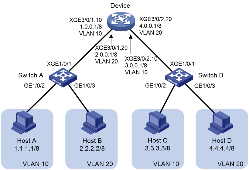

Example: Configuring unambiguous Dot1q termination
As shown in Figure 5, configure unambiguous Dot1q termination on subinterfaces of the device to implement intra-VLAN and inter-VLAN communications between hosts.
Figure 5 Network diagram
1.     Configure Host A, Host B, Host C, and Host D:
# On Host A, specify 1.1.1.1/8 and 1.0.0.1/8 as its IP address and gateway IP address, respectively. (Details not shown.)
# On Host B, specify 2.2.2.2/8 and 2.0.0.1/8 as its IP address and gateway IP address, respectively. (Details not shown.)
# On Host C, specify 3.3.3.3/8 and 3.0.0.1/8 as its IP address and gateway IP address, respectively. (Details not shown.)
# On Host D, specify 4.4.4.4/8 and 4.0.0.1/8 as its IP address and gateway IP address, respectively. (Details not shown.)
# Create VLAN 10.
[L2_SwitchA] vlan 10
# Assign GigabitEthernet 1/0/2 to VLAN 10.
[L2_SwitchA-vlan10] port gigabitethernet 1/0/2
[L2_SwitchA-vlan10] quit
# Create VLAN 20.
[L2_SwitchA] vlan 20
# Assign GigabitEthernet 1/0/3 to VLAN 20.
[L2_SwitchA-vlan20] port gigabitethernet 1/0/3
[L2_SwitchA-vlan20] quit
# Configure Ten-GigabitEthernet 1/0/1 as a trunk port, and assign the port to VLANs 10 and 20.
[L2_SwitchA] interface ten-gigabitethernet 1/0/1
[L2_SwitchA-Ten-GigabitEthernet1/0/1] port link-type trunk
[L2_SwitchA-Ten-igabitEthernet1/0/1] port trunk permit vlan 10 20
3.     Configure Layer 2 Switch B in the same way you configure Layer 2 Switch A. (Details not shown.)
4.     Configure the device:
# Create Ten-GigabitEthernet 3/0/1.10 and assign an IP address to this interface.
[Device-Ten-GigabitEthernet3/0/1.10] ip address 1.0.0.1 255.0.0.0
# Configure Ten-GigabitEthernet 3/0/1.10 to terminate packets tagged with VLAN 10.
[Device-Ten-GigabitEthernet3/0/1.10] vlan-type dot1q vid 10
# Create Ten-GigabitEthernet 3/0/1.20 and assign an IP address to this interface.
[Device] interface ten-gigabitethernet 3/0/1.20
[Device-Ten-GigabitEthernet3/0/1.20] ip address 2.0.0.1 255.0.0.0
# Configure Ten-GigabitEthernet 3/0/1.20 to terminate packets tagged with VLAN 20.
[Device-Ten-GigabitEthernet3/0/1.20] vlan-type dot1q vid 20
[Device-Ten-GigabitEthernet3/0/1.20] quit
# Configure Ten-GigabitEthernet 3/0/2.10 and assign an IP address to this interface.
[Device] interface ten-gigabitethernet 3/0/2.10
[Device-Ten-GigabitEthernet3/0/2.10] ip address 3.0.0.1 255.0.0.0
# Configure Ten-GigabitEthernet 3/0/2.10 to terminate packets tagged with VLAN 10.
[Device-Ten-GigabitEthernet3/0/2.10] vlan-type dot1q vid 10
[Device-Ten-GigabitEthernet3/0/2.10] quit
# Configure Ten-GigabitEthernet 3/0/2.20 and assign an IP address to this interface.
[Device] interface ten-gigabitethernet 3/0/2.20
[Device-Ten-GigabitEthernet3/0/2.20] ip address 4.0.0.1 255.0.0.0
# Configure Ten-GigabitEthernet 3/0/2.20 to terminate packets tagged with VLAN 20.
[Device-Ten-GigabitEthernet3/0/2.20] vlan-type dot1q vid 20
# Verify that Host A, Host B, Host C, and Host D can ping each other. (Details not shown.)
Example: Configuring Dot1q termination for PPPoE server
As shown in Figure 6, the router acts as a PPPoE server. Hosts in different VLANs access the Internet through the PPPoE server.
Configure Dot1q termination so that hosts in different VLANs can access the Internet.
Figure 6 Network diagram
# Configure VLANs and Dot1q termination. For the configuration procedure, see "Example: Configuring ambiguous Dot1q termination." (Details not shown.)
# Configure the router as the PPPoE server. Configure PPPoE settings on Ten-GigabitEthernet 3/0/1.10 on the router. For more information about the PPPoE configuration, see BRAS Services Configuration Guide. (Details not shown.)
Example: Configuring ambiguous QinQ termination
As shown in Figure 7, QinQ is enabled on GigabitEthernet 1/0/2 of Layer 2 Switch B.
Configure ambiguous QinQ termination, so that hosts can communicate with the server group.
Figure 7 Network diagram
In this example, Layer 2 Switch C uses the factory configuration.
# Assign the IP addresses 1.1.1.1/24, 1.1.1.2/24, and 1.1.1.3/24 to Host A, Host B, and Host C, respectively. (Details not shown.)
# Specify 1.1.1.11/24 as the gateway address for the hosts. (Details not shown.)
# Create VLAN 11.
# Create VLAN 12.
# Create VLAN 13.
# Configure GigabitEthernet 1/0/4 as a trunk port, and assign the port to VLANs 11 through 13.
[L2_SwitchA] interface gigabitethernet 1/0/4
[L2_SwitchA-GigabitEthernet1/0/4] port link-type trunk
[L2_SwitchA-GigabitEthernet1/0/4] port trunk permit vlan 11 to 13
3.     Configure Layer 2 Switch B:
# Configure GigabitEthernet 1/0/2 as a trunk port, and assign the port to VLANs 11 through 13 and VLAN 100.
<L2_SwitchB> system-view
[L2_SwitchB] interface gigabitethernet 1/0/2
[L2_SwitchB-GigabitEthernet1/0/2] port link-type trunk
[L2_SwitchB-GigabitEthernet1/0/2] port trunk permit vlan 11 to 13 100
# Set the PVID of GigabitEthernet 1/0/2 to VLAN 100.
[L2_SwitchB-GigabitEthernet1/0/2] port trunk pvid vlan 100
# Enable QinQ on GigabitEthernet 1/0/2.
[L2_SwitchB-GigabitEthernet1/0/2] qinq enable
[L2_SwitchB-GigabitEthernet1/0/2] quit
# Configure GigabitEthernet 1/0/1 as a trunk port and assign the port to VLAN 100.
[L2_SwitchB] interface gigabitethernet 1/0/1
[L2_SwitchB-GigabitEthernet1/0/1] port link-type trunk
[L2_SwitchB-GigabitEthernet1/0/1] port trunk permit vlan 100
4.     Configure the router:
<Router> system-view
[Router] interface ten-gigabitethernet 3/0/1.10
[Router-Ten-GigabitEthernet3/0/1.10] ip address 1.1.1.11 255.255.255.0
# Configure Ten-GigabitEthernet 3/0/1.10 to terminate VLAN-tagged packets whose Layer 1 VLAN ID is 100 and Layer 2 VLAN ID is 11, 12, or 13.
[Router-Ten-GigabitEthernet3/0/1.10] vlan-type dot1q vid 100 second-dot1q 11 to 13
[Router-Ten-GigabitEthernet3/0/1.10] vlan-termination broadcast enable
[Router-Ten-GigabitEthernet3/0/1.10] quit
# Assign an IP address to Ten-GigabitEthernet 3/0/2.
[Router] interface ten-gigabitethernet 3/0/2
[Router-Ten-GigabitEthernet3/0/2] ip address 1.1.2.11 255.255.255.0
5.     Configure the server group:
# Specify 1.1.2.11/24 as the gateway IP address for the server group. (Details not shown.)
# Verify that Host A, Host B, and Host C can ping the server group. (Details not shown.)

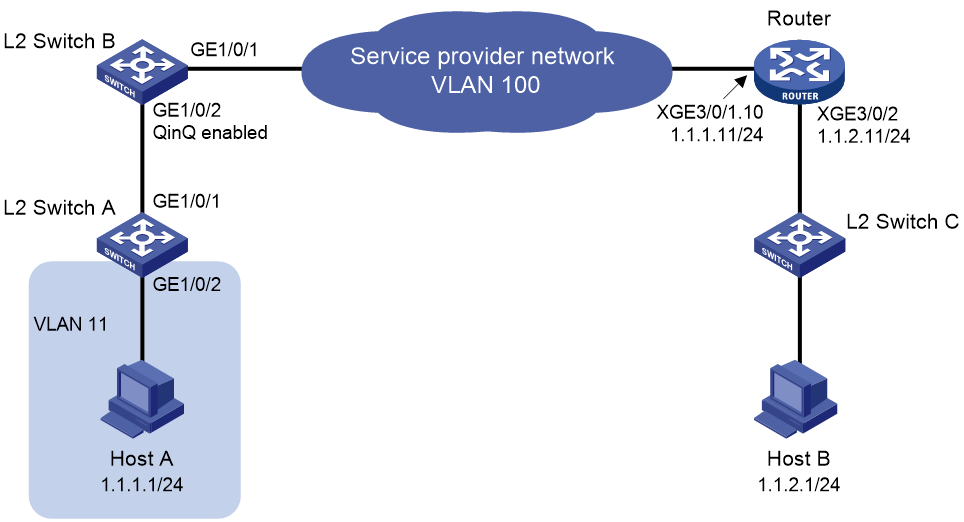

Example: Configuring unambiguous QinQ termination
As shown in Figure 8:
·     Layer 2 Switch C supports only single VLAN-tagged packets.
·     On Layer 2 Switch B, GigabitEthernet 1/0/2 is enabled with QinQ to add an SVLAN tag 100 to the packets with CVLAN ID 11.
Configure unambiguous QinQ termination so that Host A can communicate with Host B.
Figure 8 Network diagram
1.     Configure Host A and Host B:
# On Host A, specify 1.1.1.1/24 and 1.1.1.11/24 as its IP address and gateway IP address, respectively. (Details not shown.)
# On Host B, specify 1.1.2.1/24 and 1.1.2.11/24 as its IP address and gateway IP address, respectively. (Details not shown.)
# Create VLAN 11.
# Assign GigabitEthernet 1/0/2 to VLAN 11.
[L2_SwitchA-vlan11] port gigabitethernet 1/0/2
# Configure GigabitEthernet 1/0/1 as a trunk port and assign the port to VLAN 11.
[L2_SwitchA] interface gigabitethernet 1/0/1
[L2_SwitchA-GigabitEthernet1/0/1] port link-type trunk
[L2_SwitchA-GigabitEthernet1/0/1] port trunk permit vlan 11
# Configure GigabitEthernet 1/0/2 as a trunk port and assign the port to VLAN 11 and VLAN 100.
[L2_SwitchB-GigabitEthernet1/0/2] port trunk permit vlan 11 100
# Enable QinQ termination on Ten-GigabitEthernet 3/0/1.10 to terminate the VLAN-tagged packets with the Layer 1 VLAN ID 100 and the Layer 2 VLAN ID 11.
# Verify that Host A and Host B can ping each other. (Details not shown.)
Example: Configuring QinQ termination for PPPoE server (common VLAN termination)
As shown in Figure 9:
·     QinQ is enabled on GigabitEthernet 1/0/2 of Layer 2 Switch B.
·     The router acts as a PPPoE server. Hosts in different VLANs access the Internet through the PPPoE server.
Configure QinQ termination, so that the hosts can access the Internet.
Figure 9 Network diagram
# Configure VLANs and QinQ termination. For the configuration procedure, see "Example: Configuring ambiguous QinQ termination." (Details not shown.)

Example: Configuring QinQ termination for PPPoE server (user VLAN termination)
As shown in Figure 10:
Configure user VLAN QinQ termination to dynamically create QinQ termination entries to save system resources.
Figure 10 Network diagram
# Create VLAN 11.
# Create VLAN 12.
# Create VLAN 13.
# Create Layer 3 Ethernet subinterface Ten-GigabitEthernet 3/0/1.10.
# Configure PPPoE parameters on Layer 3 Ethernet subinterface Ten-GigabitEthernet 3/0/1.10.For more information, see PPPoE configuration in BRAS Services Configuration Guide. (Details not shown.)
# Enable PPPoE server on Layer 3 Ethernet subinterface Ten-GigabitEthernet 3/0/1.10, and bind to an existing VT interface. (This example use Virtual-Template 1).
[Router-Ten-GigabitEthernet3/0/1.10] pppoe-server bind virtual-template 1
# Configure user VLAN QinQ termination on Ten-GigabitEthernet 3/0/1.10 to terminate VLAN-tagged packets whose Layer 1 VLAN ID is 100 and Layer 2 VLAN ID is 11, 12, or 13.
[Router-Ten-GigabitEthernet3/0/1.10] user-vlan dot1q vid 100 second-dot1q 11 to 13
# Assign an IP address to Layer 3 interface Ten-GigabitEthernet 3/0/2.

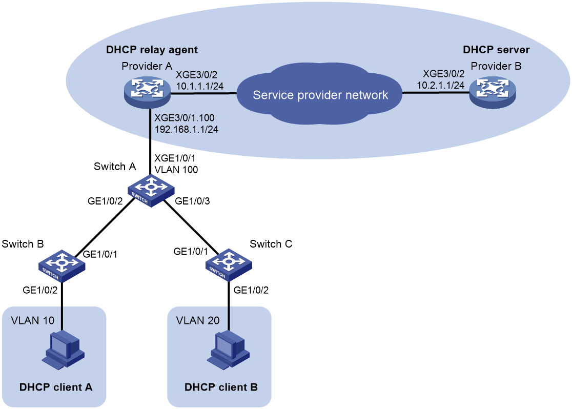

Example: Configuring QinQ termination for DHCP relay
As shown in Figure 11:
·     Provider A and Provider B are edge devices on the service provider network.
·     DHCP client A and DHCP client B are devices on the customer networks.
·     Provider A is the DHCP relay agent. Provider B is the DHCP server.
·     Provider A and Provider B communicate with each other through Layer 3 interfaces.
Configure QinQ termination on Provider A so that DHCP client A and DHCP client B can obtain IP settings from Provider B.
Figure 11 Network diagram
1.     Configure the DHCP relay agent Provider A:
# Enable DHCP service.
<ProviderA> system-view
[ProviderA] dhcp enable
# Create a Layer 3 Ethernet subinterface Ten-GigabitEthernet 3/0/1.100.
[ProviderA] interface ten-gigabitethernet 3/0/1.100
# Configure Ten-GigabitEthernet 3/0/1.100 to terminate packets whose Layer 1 ID is 100 and Layer 2 VLAN ID is 10 or 20.
[ProviderA-Ten-GigabitEthernet3/0/1.100] vlan-type dot1q vid 100 second-dot1q 10 20
# Enable Ten-GigabitEthernet 3/0/1.100 to transmit broadcast and multicast packets.
[ProviderA-Ten-GigabitEthernet3/0/1.100] vlan-termination broadcast enable
# Enable DHCP relay on Ten-GigabitEthernet 3/0/1.100 and specify 10.2.1.1 as the DHCP server address.
[ProviderA-Ten-GigabitEthernet3/0/1.100] dhcp select relay
[ProviderA-Ten-GigabitEthernet3/0/1.100] dhcp relay server-address 10.2.1.1
# Assign an IP address to Ten-GigabitEthernet 3/0/1.100.
[ProviderA-Ten-GigabitEthernet3/0/1.100] ip address 192.168.1.1 24
[ProviderA-Ten-GigabitEthernet3/0/1.100] quit
# Enable recording of relay entries on the relay agent.
[ProviderA] dhcp relay client-information record
[ProviderA] interface ten-gigabitethernet 3/0/2
[ProviderA-Ten-GigabitEthernet3/0/2] ip address 10.1.1.1 24
[ProviderA-Ten-GigabitEthernet3/0/2] quit
# Configure a static route to the DHCP server.
[ProviderA] ip route-static 10.2.1.1 24 10.1.1.1
2.     Configure the DHCP server Provider B:
# Assign an IP address to the DHCP server.
<ProviderB> system-view
[ProviderB] interface ten-gigabitethernet 3/0/2
[ProviderB-Ten-GigabitEthernet3/0/2] ip address 10.2.1.1 24
[ProviderB-Ten-GigabitEthernet3/0/2] quit
# Enable DHCP.
[ProviderB] dhcp enable
# Configure an IP address pool on the DHCP server.
[ProviderB] ip pool 1
[ProviderB-ip-pool-1] network 192.168.1.0 24
[ProviderB-ip-pool-1] gateway-list 192.168.1.1
[ProviderB-ip-pool-1] quit
# Configure a static route to Ten-GigabitEthernet 3/0/1.100.
[ProviderB] ip route-static 192.168.1.1 24 10.1.1.1
3.     Configure Switch A:
# Configure the uplink port (Ten-GigabitEthernet 1/0/1) as a trunk port and assign the port to VLAN 100.
<SwitchA> system-view
[SwitchA] interface ten-gigabitethernet 1/0/1
[SwitchA-Ten-GigabitEthernet1/0/1] port link-type trunk
[SwitchA-Ten-GigabitEthernet1/0/1] port trunk permit vlan 100
[SwitchA-Ten-GigabitEthernet1/0/1] quit
# Configure downlink port GigabitEthernet 1/0/2 as a trunk port, and assign the port to VLANs 10 and 100.
[SwitchA] interface gigabitethernet 1/0/2
[SwitchA-GigabitEthernet1/0/2] port link-type trunk
[SwitchA-GigabitEthernet1/0/2] port trunk permit vlan 10 100
[SwitchA-GigabitEthernet1/0/2] port trunk pvid vlan 100
[SwitchA-GigabitEthernet1/0/2] qinq enable
[SwitchA-GigabitEthernet1/0/2] quit
# Configure downlink port GigabitEthernet 1/0/3 as a trunk port, and assign the port to VLANs 20 and 100.
[SwitchA] interface gigabitethernet 1/0/3
[SwitchA-GigabitEthernet1/0/3] port link-type trunk
[SwitchA-GigabitEthernet1/0/3] port trunk permit vlan 20 100
# Set the PVID of GigabitEthernet 1/0/3 to VLAN 100.
[SwitchA-GigabitEthernet1/0/3] port trunk pvid vlan 100
# Enable QinQ on GigabitEthernet 1/0/3.
[SwitchA-GigabitEthernet1/0/3] qinq enable
4.     Configure Switch B:
# Create VLAN 10.
<SwitchB> system-view
[SwitchB] vlan 10
[SwitchB-vlan10] port gigabitethernet 1/0/2
[SwitchB-vlan10] quit
# Configure GigabitEthernet 1/0/1 as a trunk port and assign the port to VLAN 10.
[SwitchB] interface gigabitethernet 1/0/1
[SwitchB-GigabitEthernet1/0/1] port link-type trunk
[SwitchB-GigabitEthernet1/0/1] port trunk permit vlan 10
5.     Configure Switch C:
# Create VLAN 20.
<SwitchC> system-view
[SwitchC] vlan 20
# Assign GigabitEthernet 1/0/2 to VLAN 20.
[SwitchC-vlan20] port gigabitethernet 1/0/2
[SwitchC-vlan20] quit
# Configure GigabitEthernet 1/0/1 as a trunk port and assign the port to VLAN 20.
[SwitchC] interface gigabitethernet 1/0/1
[SwitchC-GigabitEthernet1/0/1] port link-type trunk
[SwitchC-GigabitEthernet1/0/1] port trunk permit vlan 20
# Verify that DHCP client A and DHCP client B can obtain IP settings from Provider B. (Details not shown.)
