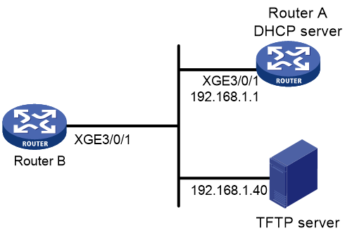

As shown in Figure 1, server-based automatic configuration requires the following servers:
·     DHCP server—A DHCP server assigns IP addresses to devices that need to be automatically configured and informs the devices of the configuration or script file paths.
·     File server (TFTP or HTTP server)—A file server stores the configuration files or scripts for automatic configuration.
·     DNS server—A DNS server obtains the configuration file names or the IP address of the file server for devices.
Figure 1 Server-based automatic configuration network diagram

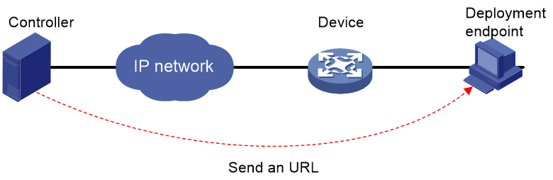

URL-based automatic configuration workflow
Figure 2 Network diagram for URL-based automatic configuration
As shown in Figure 2, URL-based automatic configuration works as follows:
1.     The administrator imports a device to the controller, completes basic configuration for the device, and generates a URL based on the basic configuration.
2.     The administrator sends the URL to the deployment engineer.
3.     The deployment engineer establishes a connection between the deployment endpoint (PC or mobile phone) and the device, and executes the obtained URL in the address bar of the Web page on the deployment endpoint.
4.     For an encrypted URL, the deployment engineer must enter the URL encryption password on the Web page to decrypt the URL.
5.     The deployment engineer enters the username and password for logging in to the Web interface of the device.
6.     The device receives the URL request, parses the URL, and displays the obtained configuration on the Web interface for the deployment engineer to confirm.
7.     The deployment engineer confirms and deploys the configuration in the URL.
8.     After the configuration is successfully deployed, the basic configuration for the device is completed.

Example: Using a TFTP server for automatic configuration
As shown in Figure 3, Router B does not have a configuration file.
Configure the servers so Router B can obtain a configuration file to complete the following configuration tasks:
·     Enable the administrator to Telnet to Router B to manage Router B.
·     Require the administrator to enter the correct username and password at login.
Figure 3 Network diagram
1.     Configure the DHCP server:
# Enable DHCP.
<RouterA> system-view
[RouterA] dhcp enable
# Configure IP pool 1 to assign IP addresses on the 192.168.1.0/24 subnet to clients. Specify the TFTP server and configuration file name for the clients.
[RouterA] ip pool 1
[RouterA-ip-pool-1] network 192.168.1.0 24
[RouterA-ip-pool-1] tftp-server ip-address 192.168.1.40
[RouterA-ip-pool-1] bootfile-name device.cfg
[RouterA-ip-pool-1] quit
2.     Configure the TFTP server:
# On the TFTP server, create a configuration file named device.cfg.
telnet server enable
local-user user
password simple abcabc
service-type telnet
user-interface vty 0 63
authentication-mode scheme
user-role network-admin
interface ten-gigabitethernet 3/0/1
port link-mode route
ip address dhcp-alloc
return
# Start TFTP service software. (Details not shown.)
1.     Power on Router B.
2.     After Router B starts up, display assigned IP addresses on Router A.
<RouterA> display dhcp server ip-in-use
IP address       Client identifier/    Lease expiration      Type
                 Hardware address
192.168.1.2      0030-3030-632e-3239-  Dec 12 17:41:15 2013  Auto(C)
                 3035-2e36-3736-622d-
                 4574-6830-2f30-2f32
3.     Telnet to 192.168.1.2 from Router A.
<RouterA> telnet 192.168.1.2
4.     Enter username user and password abcabc as prompted. (Details not shown.)
You are logged in to Router B.
