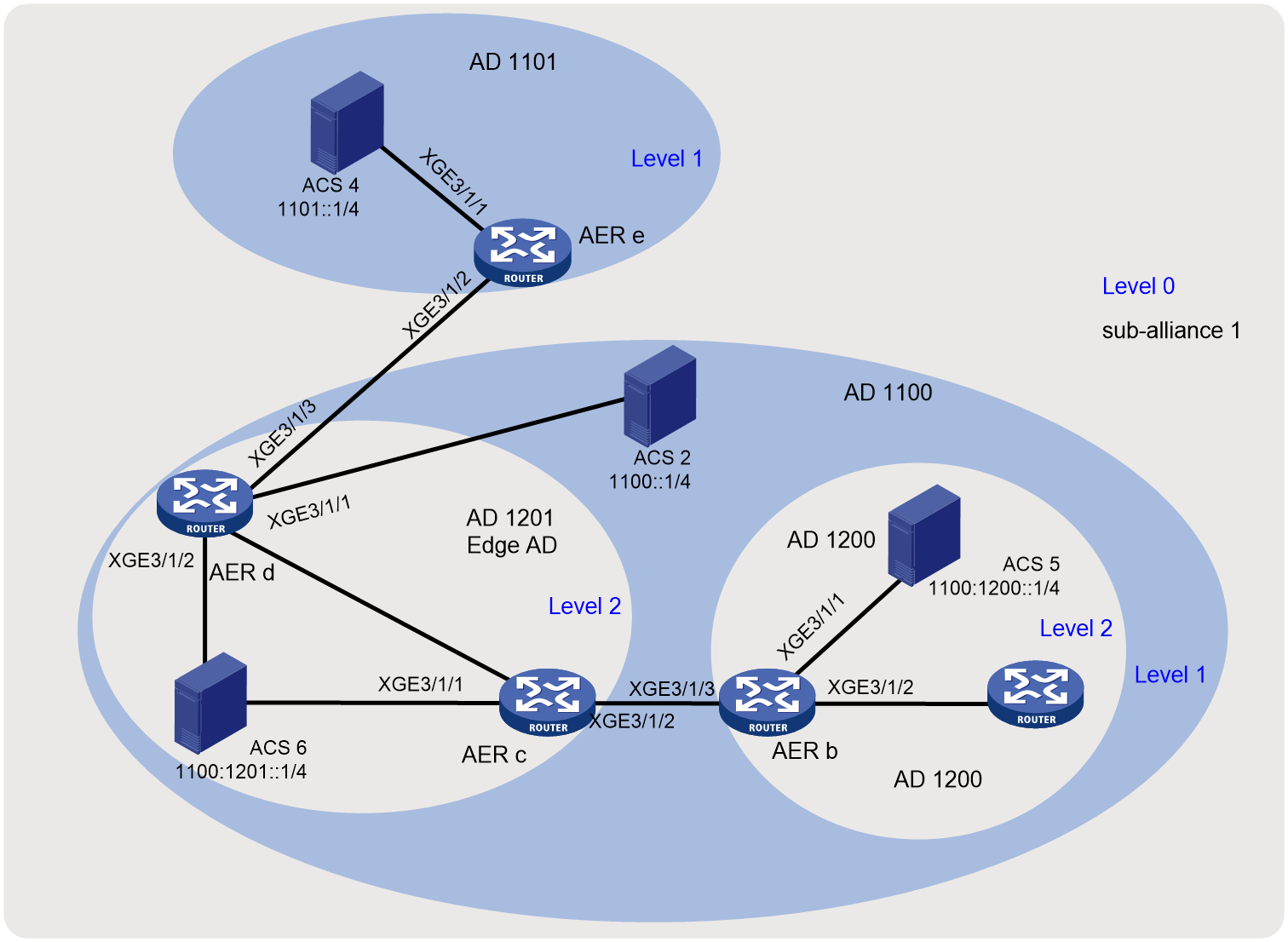

As shown in Figure 1, an SMA network mainly contains the following components: AS Control Server (ACS) and AS Edge Router (AER).
Figure 1 SMA network diagram
·     Sub-trust alliance (hereinafter referred to as sub-alliance)—A group of ADs that trust each other. It is identified by a sub-alliance ID.
·     Trust alliance (hereinafter referred to as alliance)—Collection of all ADs in the SMA system.
·     Address domain (AD)—A group of IP address ranges managed by the same organization. It is the management object of a sub-alliance and is identified by an AD ID (AD 11.1, AD 1200, and AD 1201 for example). You can divide ADs in the same sub-alliance into a maximum of four levels to form a hierarchy structure. Smaller the level number, higher the level. For example, create level 0 for a city, create level 1 for an institution in the city, and create level 2 for a building or department of the institution. ADs contain the following types:
¡     Edge AD—An AD that connects the local level to another level, for example, AD 1201 in the figure.
¡     Non-edge AD.
If you create ADs of a lower level in an AD, for example, a level-1 AD in the level-0 AD, all devices (except for ACSs) in the original AD must be added to an AD of the lower level. As shown in Figure 1, all devices in the level-0 AD are in a level-1 AD.
·     AS Control Server (ACS)—Required in each AD at every level. An ACS performs the following tasks:
¡     Exchanges IPv6 prefix and state machine information with ACSs of other sub-alliances in the same alliance.
¡     Sends alliance mapping, IPv6 prefix, and tag information to AERs of the local AD.
·     AS Edge Router (AER)—Receives IPv6 prefix and tag information notified by ACSs and forwards packets between ADs. An AER can provide services for multiple ACSs at different levels. An AER has the following types of interfaces:
¡     Ingress interface—Connected to an SMA-disabled router in the local AD.
¡     Egress interface—Connected to an AER in another AD.

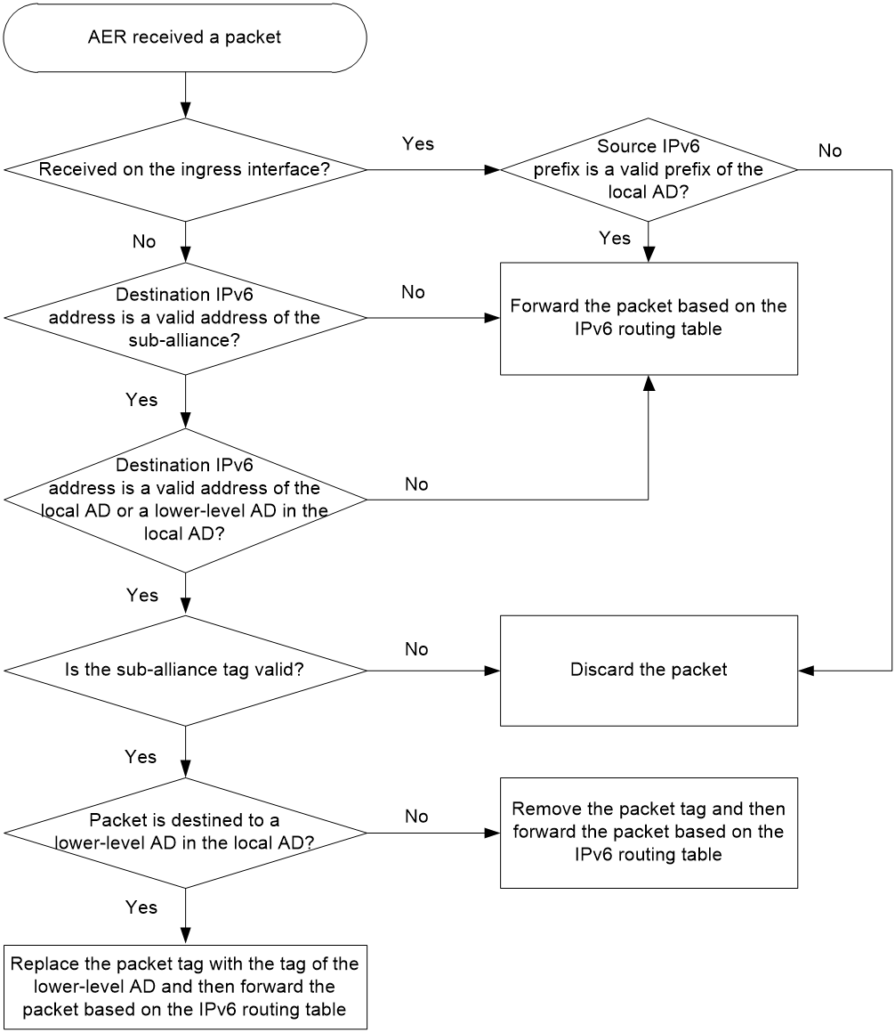

For incoming packets from other ADs to the local AD
An AER processes a received packet as follows:
1.     Examine the interface type.
¡     If the interface is the ingress interface, the AER proceeds to step 2.
¡     If the interface is the egress interface, the AER proceeds to step 3.
2.     Examine whether the source IPv6 prefix is a valid IPv6 prefix of the local AD.
¡     If yes, the AER forwards the packet based on the IPv6 routing table.
¡     If no, the AER discards the packet.
3.     Examine whether the destination IPv6 prefix is a valid IPv6 prefix of the sub-alliance.
¡     If yes, the AER proceeds to the next step.
¡     If no, the AER forwards the packet based on the IPv6 routing table.
4.     Examine whether the destination IPv6 address is a valid address of the local AD or an AD at a lower level in the local AD.
5.     Examine the validity of the sub-alliance tag.
¡     If the tag is valid, the AER proceeds to the next step.
¡     If the tag is invalid, the AER discards the packet.
6.     Examine whether the packet is destined to an AD at a lower level in the local AD.
¡     If yes, the AER replaces the packet tag with the tag of the lower-level AD, and then forwards the packet based on the IPv6 routing table.
The lower-level AER processes the packet in the same way.
¡     If no, the AER removes the packet tag, and then forwards the packet based on the IPv6 routing table.

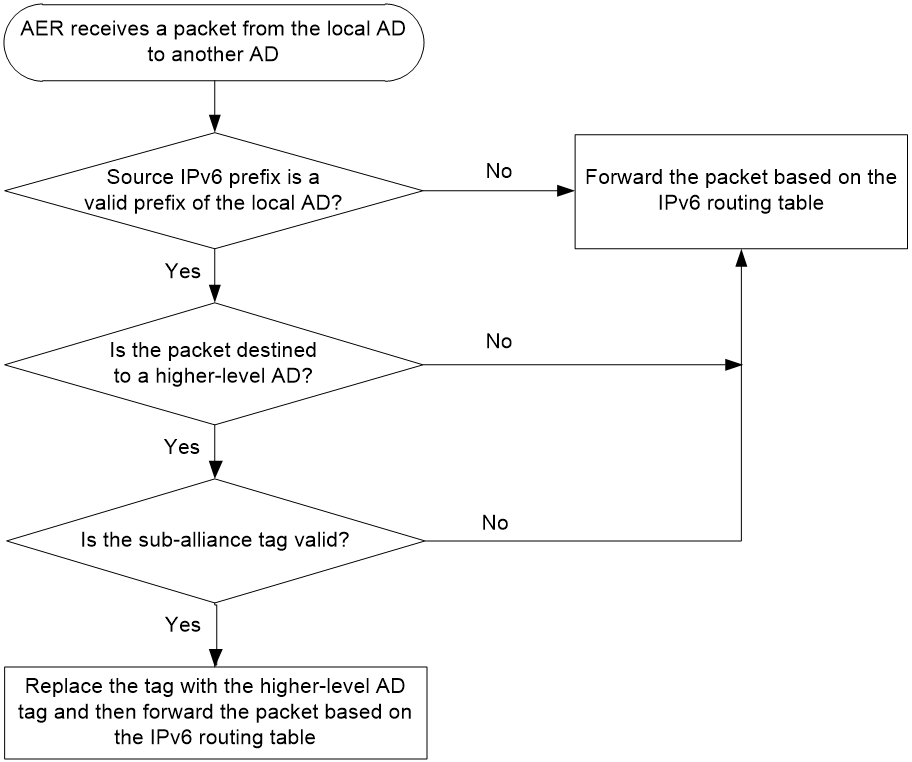

For outgoing packets from the local AD to another AD
An AER processes an outgoing packet as follows:
1.     Examine whether the source IPv6 prefix is a valid prefix of the local AD.
¡     If yes, the AER adds a tag to the packet and then forwards the packet based on the IPv6 routing table.
¡     If no, the AER proceeds to the next step.
2.     Examine whether the packet is destined to a higher-level AD of the local AD.
3.     Examine the validity of the sub-alliance tag.
¡     If yes, the AER replaces the tag with the higher-level AD tag and then forwards the packet based on the IPv6 routing table.

As shown in Figure 4, configure ACSs and AERs to use SMA with SSL links to prevent IPv6 source address spoofing.
Figure 4 Network diagram

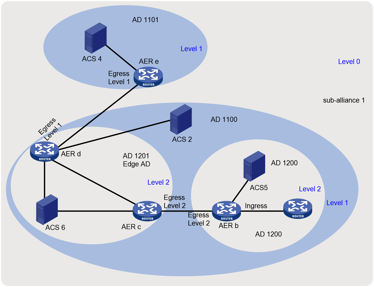

# Configure SMA interfaces for AER b.
[AERb] interface ten-gigabitethernet 3/1/2
[AERb-Ten-GigabitEthernet3/1/2] sma-anti-spoof ipv6 port-type ingress
[AERb-Ten-GigabitEthernet3/1/2] quit
[AERb] interface Ten-GigabitEthernet 3/1/3
[AERb-Ten-GigabitEthernet3/1/3] sma-anti-spoof ipv6 port-type egress level 2
[AERb-Ten-GigabitEthernet3/1/3] quit

# Configure the SMA interface for AER c.
[AERc] interface ten-gigabitethernet 3/1/2
[AERc-Ten-GigabitEthernet3/1/2] sma-anti-spoof ipv6 port-type egress level 2

# Configure the SMA interface for AER d.
[AERd] interface ten-gigabitethernet 3/1/3
[AERd-Ten-GigabitEthernet3/1/3] sma-anti-spoof ipv6 port-type egress level 1

Example: Configuring SMA using TCP links
Network requirements
As shown in Figure 5, configure ACSs and AERs to use SMA with TCP links to prevent IPv6 source address spoofing.
Figure 5 Network diagram
Device
Interface
IP address
Device
Interface
IP address
AER e
XGE3/1/1
1101::2/4
AER c
XGE3/1/1
1100:1201::3/4
AER d
XGE3/1/1
1100::2/4
AER b
XGE3/1/3
1100:1200::2/4
XGE3/1/2
1100:1201::2/4
Synchronize clocks for all devices in the alliance.
1.     Configure ACSs. (Details not shown.)
2.     Configure AER b.
# Configure an IPv6 address for AER b. (Details not shown.)
# Enable SMA on AER b and configure an TCP link between AER b and ACS 5.
<AERc> system-view
[AERb] sma-anti-spoof ipv6 enable
[AERb] sma-anti-spoof ipv6 server 1100:1200::1 client 1100:1200::2 address-domain-level 2
# Specify AD 1200 for AER b.
[AERb] sma-anti-spoof ipv6 address-domain 1200
# Specify sub-alliance 1 for AER b.
[AERb] sma-anti-spoof ipv6 sub-alliance 1
3.     Configure AER c.
# Configure an IPv6 address for AER c. (Details not shown.)
# Enable SMA on AER c and configure an TCP link between AER c and ACS 6.
<AERc> system-view
[AERc] sma-anti-spoof ipv6 enable
[AERc] sma-anti-spoof ipv6 server 1100:1201::1 client 1100:1201::3 address-domain-level 2
# Specify AD 1201 for AER c.
[AERc] sma-anti-spoof ipv6 address-domain 1201
# Specify sub-alliance 1 for AER c.
[AERc] sma-anti-spoof ipv6 sub-alliance 1
[AERc-Ten-GigabitEthernet3/1/2] quit
4.     Configure AER d.
# Configure IPv6 addresses for AER d. (Details not shown.)
# Enable SMA on AER d and configure AER d to establish TCP links with ACS 6 and ACS 2.
<AERc> system-view
[AERd] sma-anti-spoof ipv6 enable
[AERd] sma-anti-spoof ipv6 server 1100:1201::1 client 1100:1201::2 address-domain-level 2
[AERd] sma-anti-spoof ipv6 server 1100::1 client 1100::2 address-domain-level 1
# Specify AD 1201 for AER d.
[AERd] sma-anti-spoof ipv6 address-domain 1201
# Specify sub-alliance 1 for AER d.
[AERd] sma-anti-spoof ipv6 sub-alliance 1
[AERd-Ten-GigabitEthernet3/1/3] quit
5.     Configure AER e.
# Configure an IPv6 address for AER e. (Details not shown.)
# Enable SMA on AER d and configure a TCP link between AER e and ACS 4.
<AERc> system-view
[AERe] sma-anti-spoof ipv6 enable
[AERe] sma-anti-spoof ipv6 server 1101::1 client 1101::2 address-domain-level 2
# Specify AD 1101 for AER e.
[AERe] sma-anti-spoof ipv6 address-domain 1101
# Specify sub-alliance 1 for AER e.
[AERe] sma-anti-spoof ipv6 sub-alliance 1
# Configure the SMA interface for AER e.
[AERe] interface ten-gigabitethernet 3/1/2
[AERe-Ten-GigabitEthernet3/1/2] sma-anti-spoof ipv6 port-type egress level 1
[AERe-Ten-GigabitEthernet3/1/2] quit
# Verify that the AERs can obtain IPv6 prefixes and SMA tags from the corresponding ACS.
[AERe] display sma-anti-spoof ipv6 address-prefix
Alliance number: 1
  ACS address-domain level: 1
    Address-domain ID: 1100
     IPv6 prefix: 1100::/16
     Effective at: Oct 1 00:00:00 2020
     Address-domain level: 1
     Common level: 0
     Address-domain cnt: 2
     Address-domain list: 1 1100
     IPv6 prefix: 11A0:1000::/32
     Common level: 0
[AERe] display sma-anti-spoof ipv6 packet-tag
Alliance number: 1
   Source address-domain ID: 1100
   Destination address-domain ID: 1101
   Tag: 0xBB66D753D858E1ED
   Transition interval: 10s
   Source address-domain ID: 1101
   Destination address-domain ID: 1100
   Tag: 0x1D447D157A3EC032
   Destination address-domain ID: 2147483649
   Tag: 0x58420DA937580F19
   Source address-domain ID: 2147483649
   Tag: 0x3DBB48D95D463C1B
