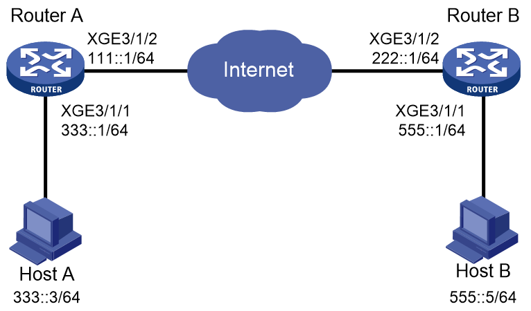

Encapsulation modes
IPsec supports the following encapsulation modes: transport mode and tunnel mode.
Transport mode
The security protocols protect the upper layer data of an IP packet. Only the transport layer data is used to calculate the security protocol headers. The calculated security protocol headers and the encrypted data (only for ESP encapsulation) are placed after the original IP header. You can use the transport mode when end-to-end security protection is required (the secured transmission start and end points are the actual start and end points of the data). The transport mode is typically used for protecting host-to-host communications, as shown in Figure 1.
NAT traversal is not available for IPsec in transport mode.
Figure 1 IPsec protection in transport mode
Tunnel mode
The security protocols protect the entire IP packet. The entire IP packet is used to calculate the security protocol headers. The calculated security protocol headers and the encrypted data (only for ESP encapsulation) are encapsulated in a new IP packet. In this mode, the encapsulated packet has two IP headers. The inner IP header is the original IP header. The outer IP header is added by the network device that provides the IPsec service. You must use the tunnel mode when the secured transmission start and end points are not the actual start and end points of the data packets (for example, when two gateways provide IPsec but the data start and end points are two hosts behind the gateways). The tunnel mode is typically used for protecting gateway-to-gateway communications, as shown in Figure 2.
Figure 2 IPsec protection in tunnel mode

Tunnel interface-based IPsec
To implement tunnel interface-based IPsec, configure an IPsec profile and apply the IPsec profile to a tunnel interface. All traffic routed to the tunnel interface is protected by IPsec. Tunnel interface-based IPsec supports only the tunnel encapsulation mode.
For tunnel interface-based IPsec, packet encapsulation and decapsulation are performed on the tunnel interfaces.
Figure 4 Tunnel interface encapsulation
As shown in Figure 4, a tunnel interface encapsulates an IP packet as follows:
1.     Upon receiving a clear text packet, the inbound interface sends the packet to the forwarding module for routing.
2.     If the packet requires IPsec protection, the forwarding module sends the packet to the tunnel interface.
3.     The tunnel interface encapsulates the packet into a new IP packet. The source and destination IP addresses in the new IP header are the source and destination IP addresses of the tunnel interface. Then, the tunnel interface sends the packet back to the forwarding module.
4.     The forwarding module looks up the routing table again and sends the packet out of the physical output interface of the tunnel interface.

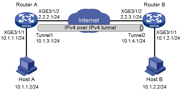

Figure 5 Tunnel interface de-encapsulation
As shown in Figure 5, a tunnel interface de-encapsulates an IP packet as follows:
1.     Upon receiving an encrypted packet, the inbound interface sends the packet to the forwarding module for routing.
2.     Because the packet is destined for the tunnel interface' source address and the payload protocol is AH or ESP, the forwarding module sends the packet to the tunnel interface.
3.     The tunnel interface de-encapsulates the packet (removes the outer IP header) and sends the de-encapsulated packet back to the forwarding module.

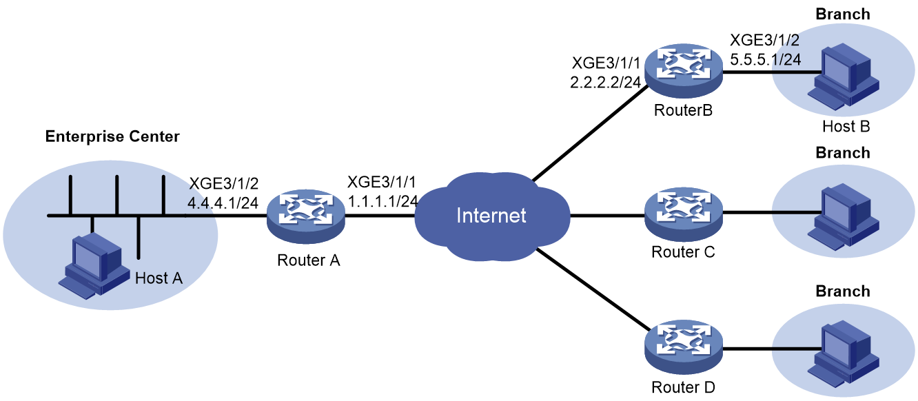

IPsec Reverse Route Injection (RRI) enables an IPsec tunnel gateway to automatically add and delete static routes destined for the protected private networks. It automatically adds the static routes when the IPsec SAs are established and deletes the static routes when the IPsec SAs are deleted. This greatly reduces the static route configuration work load on the gateway and increases the scalability of the IPsec VPN.
IPsec RRI is applicable to gateways that must provide many IPsec tunnels (for example, a headquarters gateway).
As shown in Figure 6, the traffic between the enterprise center and the branches are protected by IPsec. The gateway at the enterprise center is configured with static routes to route traffic to the IPsec-protected interfaces. It is difficult to add or modify static routes on the gateway at the enterprise center if the IPsec VPN has a large number of branches or if the network structure changes.
Figure 6 IPsec VPN
After you can enable IPsec RRI on the gateway, the gateway automatically adds a static route to the routing table each time an IPsec tunnel is established. The destination IP address is the protected private network, and the next hop is the remote IP address of the IPsec tunnel. Traffic destined for the peer end is routed to the IPsec tunnel interface and thereby protected by IPsec.
You can advertise the static routes created by IPsec RRI in the internal network, and the internal network device can use them to forward traffic in the IPsec VPN.
You can set preferences for the static routes created by IPsec RRI to implement flexible route management. For example, you can set the same preference for multiple routes to the same destination to implement load sharing, or you can set different preferences to implement route backup.
You can also set tags for the static routes created by IPsec RRI to implement flexible route control through routing policies.

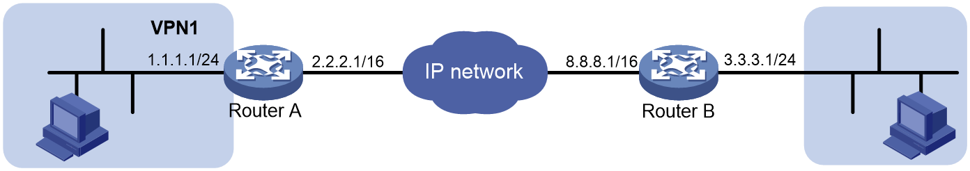

ACL for MPLS L3VPN IPsec protection
To use IPsec to protect the data of an MPLS L3VPN, you must specify the VPN instance for the protected data in the ACL.
As shown in Figure 9, to protect traffic of VPN1 by using IPsec, you must configure the ACL on Router A as follows:
acl advanced 3400
 rule 0 permit ip vpn-instance vpn1 source 1.1.1.0 0.0.0.255 destination 3.3.3.0 0.0.0.255
In addition, you must specify VPN1 as the inside VPN instance in the IKE profile.
ike profile vpn1
 keychain vpn1
 match remote identity address 8.8.8.1 255.255.255.255
 inside-vpn vpn-instance vpn1
Figure 9 IPsec for MPLS L3VPN

Configuring IPsec RRI
Enabling IPsec RRI for an IPsec policy deletes all existing IPsec SAs created by this IPsec policy. IPsec RRI creates static routes according to new IPsec SAs.
Disabling IPsec RRI for an IPsec policy deletes all existing IPsec SAs created by this IPsec policy and the associated static routes.
IPsec RRI is supported in both tunnel mode and transport mode.
If you change the preference value or tag value for an IPsec policy, the device deletes all IPsec SAs created by this IPsec policy, and the associated static routes. The change takes effect for future IPsec RRI-created static routes.
IPsec RRI does not generate a static route to a destination address to be protected if the destination address is not defined in the ACL used by an IPsec policy or an IPsec policy template. You must manually configure a static route to the destination address.
In an MPLS L3VPN network, IPsec RRI can add static routes to VPN instances' routing tables.
2.     Enter IPsec policy view or IPsec policy template view.
¡     Enter IPsec policy view.
ipsec { policy | ipv6-policy } policy-name seq-number  isakmp
¡     Enter IPsec policy template view.
ipsec { policy-template | ipv6-policy-template } template-name seq-number
3.     Enable IPsec RRI.
reverse-route dynamic
By default, IPsec RRI is disabled.
4.     (Optional.) Set the preference value for the static routes created by IPsec RRI.
reverse-route preference number
The default value is 60.
5.     (Optional.) Set the tag value for the static routes created by IPsec RRI.
reverse-route tag tag-value
The default value is 0.

# Create a tunnel interface in IPsec/IPv4 tunnel mode. Specify the slot installed with a IM-SFMX card as the primary slot to process traffic for the interface.
<RouterA> system-view
[RouterA] interface tunnel 1 mode ipsec
[RouterA-Tunnel1] service slot 1
[RouterA-Tunnel1] source ten-gigabitethernet 3/1/2
[RouterA-Tunnel1] destination 2.2.3.1
[RouterA-Tunnel1] ip address 10.1.3.1 24
# Apply IPsec profile 1 to the tunnel interface.
[RouterA-Tunnel1] tunnel protection ipsec profile 1
[RouterA-Tunnel1] quit
# Create an IPsec transform set named tran1.
[RouterA] ipsec transform-set tran1
# Set the packet encapsulation mode to tunnel mode.
[RouterA-ipsec-transform-set-tran1] encapsulation-mode tunnel
# Use ESP as the security protocol.
[RouterA-ipsec-transform-set-tran1] protocol esp
# Configure ESP to use the 128-bit AES and HMAC-SHA1 algorithms for encryption and authentication, respectively.
[RouterA-ipsec-transform-set-tran1] esp encryption-algorithm aes-cbc-128
[RouterA-ipsec-transform-set-tran1] esp authentication-algorithm sha1
[RouterA-ipsec-transform-set-tran1] quit
# Create and configure an IKE keychain named keychain1.
[RouterA] ike keychain keychain1
# Set the pre-shared key for IKE negotiation with the peer at 2.2.3.1 to 123456TESTplat&! in plain text.
[RouterA-ike-keychain-keychain1] pre-shared-key address 2.2.3.1 255.255.255.0 key simple 123456TESTplat&!
[RouterA-ike-keychain-keychain1] quit
# Create an IKE profile named profile1.
[RouterA] ike profile profile1
[RouterA-ike-profile-profile1] keychain keychain1
[RouterA-ike-profile-profile1] match remote identity address 2.2.3.1 255.255.255.0
[RouterA-ike-profile-profile1] quit
# Create an IKE-based IPsec profile.
[RouterA] ipsec profile 1 isakmp
# Specify IPsec transform set tran1 for protection of data flows.
[RouterA-ipsec-profile-isakmp-1] transform-set tran1
# Specify IKE profile profile1 for IKE negotiation.
[RouterA-ipsec-profile-isakmp-1] ike-profile profile1
[RouterA-ipsec-profile-isakmp-1] quit
# Configure a static route from Router A to Router B.
[RouterA] ip route-static 10.1.2.0 24 Tunnel 1
2.     Configure Router B:
# Assign an IP address to each interface. (Details not shown.)
<RouterB> system-view
[RouterB] interface tunnel 1 mode ipsec
[RouterB-Tunnel1] service slot 1
[RouterB-Tunnel1] source ten-gigabitethernet 3/1/2
[RouterB-Tunnel1] destination 2.2.2.1
[RouterB-Tunnel1] ip address 10.1.4.1 24
[RouterB-Tunnel1] tunnel protection ipsec profile 1
[RouterB-Tunnel1] quit
[RouterB] ipsec transform-set tran1
[RouterB-ipsec-transform-set-tran1] encapsulation-mode tunnel
[RouterB-ipsec-transform-set-tran1] protocol esp
[RouterB-ipsec-transform-set-tran1] esp encryption-algorithm aes-cbc-128
[RouterB-ipsec-transform-set-tran1] esp authentication-algorithm sha1
[RouterB-ipsec-transform-set-tran1] quit
[RouterB] ike keychain keychain1
[RouterB-ike-keychain-keychain1] pre-shared-key address 2.2.2.1 255.255.255.0 key simple 123456TESTplat&!
[RouterB-ike-keychain-keychain1] quit
[RouterB] ike profile profile1
[RouterB-ike-profile-profile1] keychain keychain1
[RouterB-ike-profile-profile1] match remote identity address 2.2.2.1 255.255.255.0
[RouterB-ike-profile-profile1] quit
[RouterB] ipsec profile 1 isakmp
[RouterB-ipsec-profile-isakmp-1] transform-set tran1
[RouterB-ipsec-profile-isakmp-1] ike-profile profile1
[RouterB-ipsec-profile-isakmp-1] quit
# Configure a static route from Router B to Router A.
[RouterA] ip route-static 10.1.1.0 24 Tunnel 1
# Send packets between subnet 10.1.1.0/24 and subnet 10.1.2.0/24 to trigger IKE negotiation. After IPsec SAs are successfully negotiated by IKE, the traffic between the two subnets is IPsec-protected.
# Execute the following command to verify that IPsec SAs have been successfully established.
[RouterA] display ipsec sa
Interface: Tunnel1
  IPsec profile: 1
  Mode: ISAKMP
    Tunnel id: 0
    Encapsulation mode: tunnel
    Perfect Forward Secrecy:
    Inside VPN:
    Extended Sequence Numbers enable: N
    Traffic Flow Confidentiality enable: N
    Path MTU: 1443
    Transmitting entity: Initiator
    Tunnel:
        local  address: 2.2.2.1
        remote address: 2.2.3.1
    Flow:
        sour addr: 0.0.0.0/0.0.0.0  port: 0  protocol: ip
        dest addr: 0.0.0.0/0.0.0.0  port: 0  protocol: ip
    [Inbound ESP SAs]
      SPI: 3769702703 (0xe0b1192f)
      Connection ID: 90194313219
      Transform set: ESP-ENCRYPT-AES-CBC-128 ESP-AUTH-SHA1
      SA duration (kilobytes/sec): 3000/28800
      SA remaining duration (kilobytes/sec): 2300/797
      Max received sequence-number: 1
      Anti-replay check enable: N
      Anti-replay window size:
      UDP encapsulation used for NAT traversal: N
      Status: Active
    [Outbound ESP SAs]
      SPI: 3840956402 (0xe4f057f2)
      Connection ID: 64424509441
      SA remaining duration (kilobytes/sec): 2312/797
      Max sent sequence-number: 1
      Status: Active
# Repeat the previous steps on Router B to verify that it has established IPsec SAs successfully to protect the IPv4 packets of interest. (Details not shown.)
Example: Configuring IPsec RRI
As shown in Figure 15, branches access the enterprise center through an IPsec VPN.
Configure the IPsec VPN as follows:
·     Configure an IPsec tunnel between Router A and each branch gateway (Router B, Router C, and Router D) to protect traffic between subnets 4.4.4.0/24 and 5.5.5.0/24.
·     Configure the tunnels to use security protocol ESP, encryption algorithm DES, and authentication algorithm SHA1-HMAC-96. Use IKE for IPsec SA negotiation.
·     On each router, configure an IKE proposal to use the pre-shared key authentication method, encryption algorithm 3DES, and authentication algorithm HMAC-SHA1.
·     Configure IPsec RRI on Router A to automatically create static routes to the branches based on the established IPsec SAs.
·     Specify the slot installed with an IM-SFMX card as the primary slot for IPsec traffic processing.
Figure 15 Network diagram
1.     Assign IPv4 addresses to the interfaces on the routers according to Figure 15. (Details not shown.)
2.     Configure Router A:
# Create an IPsec transform set named tran1, and specify ESP as the security protocol, DES as the encryption algorithm, and HMAC-SHA-1-96 as the authentication algorithm.
[RouterA-ipsec-transform-set-tran1] esp encryption-algorithm des
# Create and configure the IPsec profile named profile1.
[RouterA-ike-profile-profile1] keychain key1
[RouterA-ike-profile-profile1] match remote identity address 2.2.2.2 255.255.255.0
# Create an IKE-based IPsec policy entry named map1. Specify IPsec transform set tran1 and IKE profile profile1 for the IPsec policy.
[RouterA] ipsec policy map1 10 isakmp
[RouterA-ipsec-policy-isakmp-map1-10] transform-set tran1
[RouterA-ipsec-policy-isakmp-map1-10] ike-profile profile1
# Specify the slot installed with an IM-SFMX card as the primary slot for IPsec traffic processing.
[RouterA-ipsec-policy-isakmp-map1-10] service slot 1
# Enable IPsec RRI, and set the preference to 100 and the tag to 1000 for the static routes created by IPsec RRI.
[RouterA-ipsec-policy-isakmp-map1-10] reverse-route dynamic
[RouterA-ipsec-policy-isakmp-map1-10] reverse-route preference 100
[RouterA-ipsec-policy-isakmp-map1-10] reverse-route tag 1000
[RouterA-ipsec-policy-isakmp-map1-10] quit
# Create an IKE proposal named 1, and specify 3DES as the encryption algorithm, HMAC-SHA1 as the authentication algorithm, and pre-share as the authentication method.
[RouterA] ike proposal 1
[RouterA-ike-proposal-1] encryption-algorithm 3des-cbc
[RouterA-ike-proposal-1] authentication-algorithm sha
[RouterA-ike-proposal-1] authentication-method pre-share
[RouterA-ike-proposal-1] quit
# Create an IKE keychain named key1 and specify 123 in plain text as the pre-shared key to be used with the remote peer at 2.2.2.2.
[RouterA] ike keychain key1
[RouterA-ike-keychain-key1] pre-shared-key address 2.2.2.2 key simple 123
[RouterA-ike-keychain-key1] quit
# Apply IPsec policy map1 to Ten-GigabitEthernet 3/1/1.
[RouterA] interface ten-gigabitethernet 3/1/1
[RouterA-Ten-GigabitEthernet3/1/1] ipsec apply policy map1
[RouterA-Ten-GigabitEthernet3/1/1] quit
3.     Configure Router B:
[RouterB-ipsec-transform-set-tran1] esp encryption-algorithm des
# Configure IPv4 advanced ACL 3000 to identify traffic from subnet 5.5.5.0/24 to subnet 4.4.4.0/24.
[RouterB] acl advanced 3000
[RouterB-acl-ipv4-adv-3000] rule permit ip source 5.5.5.0 0.0.0.255 destination 4.4.4.0 0.0.0.255
[RouterB-acl-ipv4-adv-3000] quit
# Create and configure an IKE profile named profile1.
[RouterB-ike-profile-profile1] keychain key1
[RouterB-ike-profile-profile1] match remote identity address 1.1.1.1 255.255.255.0
# Create an IKE-based IPsec policy entry named map1, with its sequence number set to 10. In the policy entry, specify transform set tran1 and ACL 3000, specify the remote IP address for the tunnel as 1.1.1.1, and specify IKE profile profile1.
[RouterB] ipsec policy map1 10 isakmp
[RouterB-ipsec-policy-isakmp-map1-10] transform-set tran1
[RouterB-ipsec-policy-isakmp-map1-10] security acl 3000
[RouterB-ipsec-policy-isakmp-map1-10] remote-address 1.1.1.1
[RouterB-ipsec-policy-isakmp-map1-10] ike-profile profile1
# In the IPsec policy entry, specify the slot installed with an IM-SFMX card as the primary slot for IPsec traffic processing.
[RouterB-ipsec-policy-isakmp-map1-10] service slot 1
[RouterB-ipsec-policy-isakmp-map1-10] quit
[RouterB] ike proposal 1
[RouterB-ike-proposal-1] encryption-algorithm 3des-cbc
[RouterB-ike-proposal-1] authentication-algorithm sha
[RouterB-ike-proposal-1] authentication-method pre-share
[RouterB-ike-proposal-1] quit
# Create an IKE keychain named key1 and specify 123 in plain text as the pre-shared key to be used with the remote peer at 1.1.1.1.
[RouterB] ike keychain key1
[RouterB-ike-keychain-key1] pre-shared-key address 1.1.1.1 key simple 123
[RouterB-ike-keychain-key1] quit
[RouterB] interface ten-gigabitethernet 3/1/1
[RouterB-Ten-GigabitEthernet3/1/1] ipsec apply policy map1
[RouterB-Ten-GigabitEthernet3/1/1] quit
Make sure Router B has a route to the peer private network, with the outgoing interface as Ten-GigabitEthernet 3/1/1.
4.     Configure Router C and Router D in the same way Router B is configured.
1.     Verify that IPsec RRI can automatically create a static route from Router A to Router B:
# Initiate a connection from subnet 5.5.5.0/24 to subnet 4.4.4.0/24. IKE negotiation is triggered to establish IPsec SAs between Router A and Router B. (Details not shown.)
# Verify that IPsec SAs are established on Router A.
Interface: Ten-GigabitEthernet3/1/1
  IPsec policy: map1
  Sequence number: 10
  Mode: ISAKMP
    Tunnel id: 0
    Inside VPN:
    Path MTU: 1463
    Tunnel:
        local  address: 1.1.1.1
        remote address: 2.2.2.2
    Flow:
        sour addr: 4.4.4.0/255.255.255.0  port: 0  protocol: ip
        dest addr: 5.5.5.0/255.255.255.0  port: 0  protocol: ip
    [Inbound ESP SAs]
      SPI: 1014286405 (0x3c74c845)
      Transform set: ESP-ENCRYPT-DES-CBC ESP-AUTH-SHA1
      SA duration (kilobytes/sec): 1843200/3600
      SA remaining duration (kilobytes/sec): 1843199/3590
      Max received sequence-number: 4
      Anti-replay check enable: Y
      Anti-replay window size: 64
      Status: Active
    [Outbound ESP SAs]
      SPI: 4011716027 (0xef1dedbb)
      Max sent sequence-number: 4
      Status: Active
# Verify that IPsec RRI has created a static route to reach Router B.
[RouterA] display ip routing-table verbose
2.     Verify that Router A can automatically create static routes to Router C and Router D in the same way that you verify the IPsec RRI feature by using Router A and Router B. (Details not shown.)

Example: Aggressive mode with RSA signature authentication configuration example
As shown in Figure 20, configure an IKE-based IPsec tunnel between Device A and Device B to secure the communication between subnet 10.1.1.0/24 and subnet 10.1.2.0/24.
Configure Device A and Device B to use aggressive mode for IKE negotiation phase 1 and to use RSA signature authentication. Device A acts as the initiator, and the subnet where Device A resides uses IP addresses dynamically allocated.
Figure 20 Network diagram

Example: IKEv2 with RSA signature authentication configuration example
As shown in Figure 23, configure an IKE-based IPsec tunnel between Device A and Device B to secure the communication between subnet 10.1.1.0/24 and subnet 10.1.2.0/24.
Configure Device A and Device B to use IKEv2 negotiation and RSA signature authentication. Device A acts as the initiator, and the subnet where Device A resides uses IP addresses dynamically allocated.
Figure 23 Network diagram
1.     Configure Device A:
