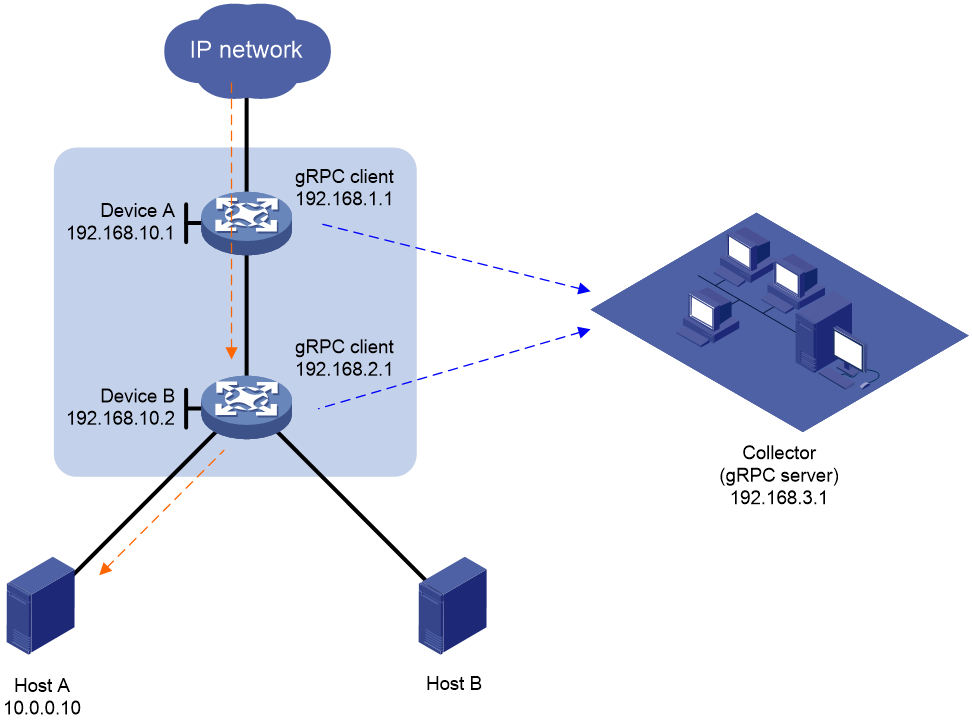

As shown in Figure 2, Host A and Host B access the external network through Device A and Device B. Some packets from the external network are missing on Host A. Configure MOD on the access device and aggregation device to identify whether packets are dropped during the forwarding process on the two devices.
Figure 2 Network diagram
Configure IP addresses for devices, and make sure they can reach each other at Layer 3.

1.     Configure Device A:
a.     Configure a flow group:
# Create advanced IPv4 ACL 3000, and configure a rule to match packets with destination IP address 10.0.0.10 for the ACL.
<DeviceA> system-view
[DeviceA] acl advanced 3000
[DeviceA-acl-ipv4-adv-3000] rule permit ip destination 10.0.0.10 0
[DeviceA-acl-ipv4-adv-3000] quit
# Create flow group 1 and configure it to reference ACL 3000.
[DeviceA] telemetry flow-group 1 mode simple-mod
[DeviceA-telemetry-flow-group-1] if-match acl 3000
# Configure the flow group to generate flow entries based on the destination IP address.
[DeviceA-telemetry-flow-group-1] template destination-ip
[DeviceA-telemetry-flow-group-1] quit
# Set the flow entry aging time to 50 minutes.
[DeviceA] telemetry flow-group aging-time 50
# Apply flow group 1.
[DeviceA] telemetry apply flow-group 1
b.     Configure MOD:
# Configure the device ID for MOD as 192.168.10.1.
[DeviceA] telemetry mod
[DeviceA-telemetry-mod] device-id 192.168.10.1
# Configure MOD to use gRPC to send packets to the collector.
[DeviceA-telemetry-mod] transport-protocol grpc
# Configure MOD to monitor all packet drop reasons.
[DeviceA-telemetry-mod] reason-list all
[DeviceA-telemetry-mod] quit
c.     Configure gRPC:
# Enable the gRPC service.
[DeviceA] grpc enable
# Create a sensor group named test, and add sensor path telemetryftrace/Genevent.
[DeviceA] telemetry
[DeviceA-telemetry] sensor-group test
[DeviceA-telemetry-sensor-group-test] sensor path telemetryftrace/Genevent
[DeviceA-telemetry-sensor-group-test] quit
# Create a destination group named collector1. Specify a collector that uses IPv4 address 192.168.3.1 and port number 50050.
[DeviceA-telemetry] destination-group collector1
[DeviceA-telemetry-destination-group-collector1] ipv4-address 192.168.3.1 port 50050
[DeviceA-telemetry-destination-group-collector1] quit
# Configure a subscription named A to bind sensor group test with destination group collector1.
[DeviceA-telemetry] subscription A
[DeviceA-telemetry-subscription-A] sensor-group test
[DeviceA-telemetry-subscription-A] destination-group collector1
[DeviceA-telemetry-subscription-A] quit
[DeviceA-telemetry] quit
2.     Configure Device B.
Configure Device B in the same way Device A is configured except the device ID for MOD.
