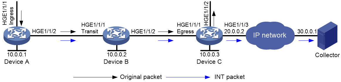

As shown in Figure 1, an INT network contains the following INT-enabled devices: one entry node, one transit node, and one exit node.

INT packet formats

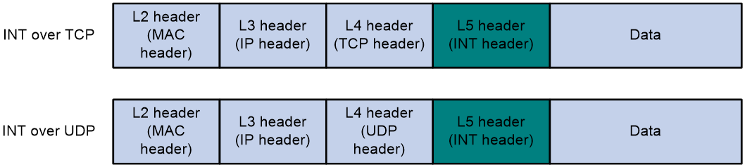

INT generates INT packets by mirroring original packets, inserting INT headers, and collecting data. The INT header and collected data are in the original IP header. Therefore, an INT packet and its original packet have the same IP header and forwarding path.
The device supports generating INT packets from TCP packets and UDP packets. Figure 2 shows the INT packet formats. The 64 most significant bits of the INT header are fixed at 0xaaaaaaaabbbbbbbb, which are the INT mark.

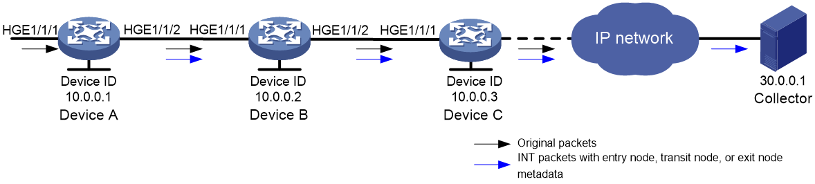

As shown in Figure 3, the nodes in common INT perform the following functions:
1.     On the entry node, the ingress port uses a QoS policy to sample matching packets, and mirrors sampled packets to the INT processor. Then, the INT processor adds an INT header to the INT packet and loops it back to the ingress port. The ingress port identifies the looped-back INT packet according to the INT mark, adds collected data to it, and forwards it to the egress port. The egress port adds collected data to the INT packet and sends it to the transit node.
2.     On the transit node, the ingress port identifies the INT packet according to the INT mark, adds collected data to it, and forwards it to the egress port. The egress port adds collected data to the INT packet, and sends it to the exit node.
3.     On the exit node, the ingress port identifies the INT packet according to the INT mark, adds collected data to the INT packet, encapsulates the INT packet with the configured parameters, and sends it to the collector.

As shown in Figure 3, the nodes in flexible INT perform the following functions:
1.     On the entry node, the ingress port uses an ACL to sample matching packets, and mirrors sampled packets to the INT processor. Then, the INT processor adds an INT header to the INT packet and loops it back to the ingress port. The ingress port identifies the looped-back INT packet according to an ACL and adds collected data to it, and forwards it. The egress port adds collected data to the INT packet and sends it to the transit node.
2.     On the transit node, the ingress port uses an ACL to identify INT packets, adds collected data to INT packets, and forwards them to the egress port. The egress port adds collected data to INT packets and sends them to the exit node.
3.     On the exit node, the ingress port uses an ACL to identify INT packets  and mirrors them to the INT processor. The INT processor encapsulates the INT packets and sends them to the collector.

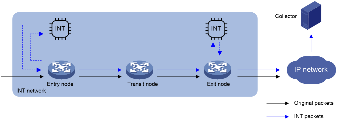

Example: Configuring common INT
As shown in Figure 4, configure common INT to test the link delay.
Figure 4 Network diagram
1.     Assign IP addresses to interfaces and configure routes. Make sure the network connections are available. (Details not shown.)
2.     Configure Device B:
# Specify 10.0.0.2 as the device ID of the transit node.
<DeviceB> system-view
[DeviceB] telemetry ifa device-id 10.0.0.2
# Specify HundredGigE 1/1/1 as the transit interface.
[DeviceB] interface hundredgige 1/1/1
[DeviceB-HundredGigE1/1/1] telemetry ifa role transit
[DeviceB-HundredGigE1/1/1] quit
# Enable INT globally.
[DeviceB] telemetry ifa global enable
