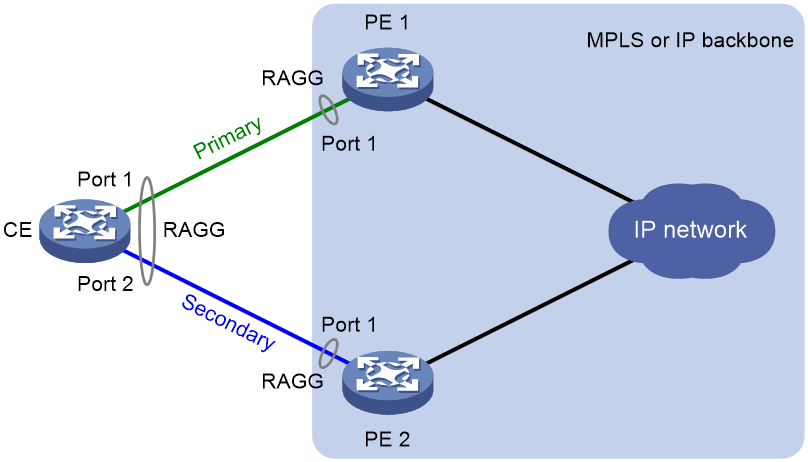

Configuring a 1+1 backup aggregation group
About 1+1 backup link aggregation
As shown in Figure 5, a 1+1 backup aggregation group is used on a CE that is dualhomed to PEs for high availability of services. A 1+1 backup aggregation group is a static Layer 3 aggregation group that contains one primary member port and one secondary member port. The primary member port is placed in Selected state to forward all traffic, and the secondary member port is placed in Unselected state as a standby.
Figure 5 Application scenarios for 1+1 backup link aggregation
1+1 backup link aggregation tasks at a glance
To configure a 1+1 backup aggregation group, perform the following tasks:
1.     Configuring a static 1+1 backup aggregation group
2.     (Optional.) Specifying a primary member port
3.     (Optional.) Setting the reversion delay
4.     (Optional.) Configuring a 1+1 backup aggregation group to place its secondary member port in down state
5.     (Optional.) Performing a primary/secondary member port switchover
A 1+1 backup aggregation group can contain a maximum of two member ports.

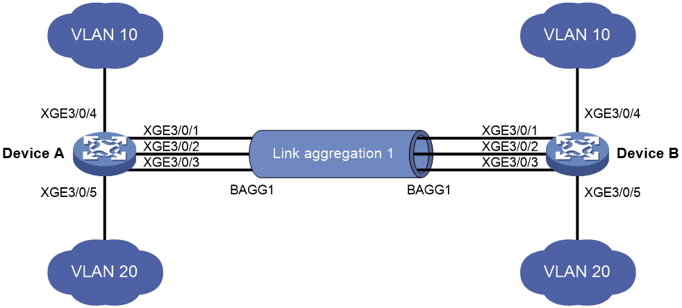

On the network shown in Figure 6, perform the following tasks:
·     Configure a Layer 2 static aggregation group on both Device A and Device B.
·     Enable VLAN 10 at one end of the aggregate link to communicate with VLAN 10 at the other end.
·     Enable VLAN 20 at one end of the aggregate link to communicate with VLAN 20 at the other end.
Figure 6 Network diagram
1.     Configure Device A:
# Create VLAN 10, and assign port Ten-GigabitEthernet 3/0/4 to VLAN 10.

Example: Configuring a Layer 2 dynamic aggregation group
On the network shown in Figure 7, perform the following tasks:
·     Configure a Layer 2 dynamic aggregation group on both Device A and Device B.
Figure 7 Network diagram

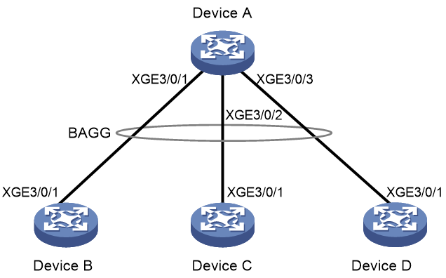

Example: Configuring S-MLAG
Device B, Device C, and Device D are standalone devices. As shown in Figure 11, configure Device B, Device C, and Device D as S-MLAG devices to establish a multichassis aggregate link with Device A.
Figure 11 Network diagram
