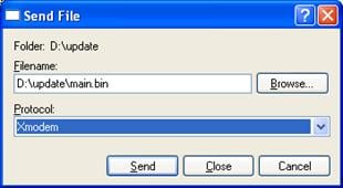

Download baudrate is 9600 bps
Please change the terminal's baudrate to 9600 bps and select XMODEM protocol
Press enter key when ready
Now please start transfer file with XMODEM protocol
If you want to exit, Press <Ctrl+X>
Loading ...CCCCCCCCCCC...Done.
Loading ...CCCCCCCCCCCCCC  ...Done.

6.     Select Transfer > Send File in the HyperTerminal window. In the dialog box that appears, click Browse to select the source file, and select Xmodem from the Protocol list. In this example, the file D:\update\main.bin is selected.
Figure 1 File transmission dialog box
7.     Click Send.
