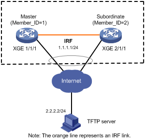

Examples of using issu commands for ISSU on a dual-member IRF fabric· 10
Feature upgrade to a compatible version· 10

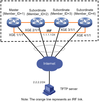

Examples of using issu commands for ISSU on a four-member IRF fabric· 15
Feature upgrade to a compatible version· 15

As shown in Figure 1, the IRF fabric has two members.
Upgrade the feature1 feature from R0201 to R0202. The two versions are compatible.
Figure 1 Network diagram
Upgrade requirements
As shown in Figure 3, the IRF fabric has four members.
Upgrade a feature from soft-version1 to soft-version2 on the IRF fabric. The two versions are compatible.
Figure 3 Network diagram

Feature upgrade to an incompatible version (upgrading one subordinate member first)
As shown in Figure 4, the IRF fabric has four members.
Upgrade a feature from soft-version1 to soft-version2 on the IRF fabric. The two versions are incompatible.
Figure 4 Network diagram
