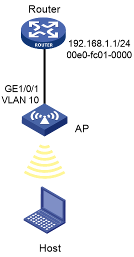

As shown in Figure 3, the host is connected to the AP. The AP is connected to the router through GigabitEthernet 1/0/1 in VLAN 10.
To ensure secure communications between the AP and the router, configure a static ARP entry for the router on the AP.
Figure 3 Network diagram
# Configure the wireless service on the AP. For more information, see WLAN access configuration in WLAN Access Configuration Guide.
# Create VLAN 10.
<AP> system-view
[AP] vlan 10
[AP-vlan10] quit
# Add GigabitEthernet 1/0/1 to VLAN 10.
[AP] interface gigabitethernet 1/0/1
[AP-GigabitEthernet1/0/1] port access vlan 10
[AP-GigabitEthernet1/0/1] quit
# Create VLAN-interface 10 and configure its IP address.
[AP] interface vlan-interface 10
[AP-vlan-interface10] ip address 192.168.1.2 8
[AP-vlan-interface10] quit
# Configure a static ARP entry that has IP address 192.168.1.1, MAC address 00e0-fc01-0000, and output interface GigabitEthernet 1/0/1 in VLAN 10.
[AP] arp static 192.168.1.1 00e0-fc01-0000 10 gigabitethernet 1/0/1
# Verify that the AP has a static ARP entry for the router.
[AP] display arp static
  Type: S-Static   D-Dynamic   O-Openflow   R-Rule          I-Invalid
IP address      MAC address    VLAN/VSI name Interface/Link ID        Aging Type
192.168.1.1     00e0-fc01-0000 10            GE1/0/1                   --   S

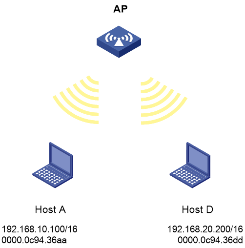

As shown in Figure 4, Host A and Host D have the same IP prefix and mask, but they are located on different subnets separated by the AP. Host A belongs to VLAN 1, and Host D belongs to VLAN 2. No default gateway is configured on Host A and Host D.
Configure common proxy ARP on the AP to enable communication between the two hosts.
Figure 4 Network diagram
# Create VLAN 2.
<AP> system-view
[AP] vlan 2
[AP-vlan2] quit
# Configure the IP address of VLAN-interface 1.
[AP-Vlan-interface1] ip address 192.168.10.99 255.255.255.0
# Enable common proxy ARP on VLAN-interface 1.
[AP-Vlan-interface1] proxy-arp enable
[AP-Vlan-interface1] quit
# Configure the IP address of VLAN-interface 2.
[AP] interface vlan-interface 2
[AP-Vlan-interface2] ip address 192.168.20.99 255.255.255.0
# Enable common proxy ARP on VLAN-interface 2.
[AP-Vlan-interface2] proxy-arp enable
# Verify that Host A and Host D can ping each other.
