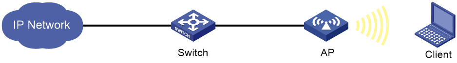

As shown in Figure 2, enable WMM on the AP so that the AP and the client can prioritize the traffic.
Figure 2 Network diagram
# Create a service template named market, set the SSID to market, and enable the service template.
<AP> system-view
[AP] wlan service-template market
[AP-wlan-st-market] ssid market
[AP-wlan-st-market] service-template enable
[AP-wlan-st-market] quit
# Bind service template market to WLAN-Radio 1/0/1.
[AP] interface wlan-radio 1/0/1
[AP-WLAN-Radio1/0/1] undo shutdown
[AP-WLAN-Radio1/0/1] service-template market
# Enable WMM.
[AP-WLAN-Radio1/0/1] wmm enable
[AP-WLAN-Radio1/0/1] quit
# Display WMM statistics for radios.

Example: Configuring bandwidth guaranteeing
As shown in Figure 6, Clients 1, 2, and 3 access the network through SSIDs research, office, and entertain, respectively.
For the network to operate correctly, guarantee 20% of the bandwidth for SSID office, 80% for research, and none for entertain.
Figure 6 Network diagram
# Create a service template named office, set the SSID to office, and enable the service template.
<AP> system-view
[AP] wlan service-template office
[AP-wlan-st-office] ssid office
[AP-wlan-st-office] service-template enable
[AP-wlan-st-office] quit
# Create a service template named research, set the SSID to research, and enable the service template.
[AP] wlan service-template research
[AP-wlan-st-research] ssid research
[AP-wlan-st-research] service-template enable
[AP-wlan-st-research] quit
# Create a service template named entertain, set the SSID to entertain, and enable the service template.
[AP] wlan service-template entertain
[AP-wlan-st-entertain] ssid entertain
[AP-wlan-st-entertain] service-template enable
[AP-wlan-st-entertain] quit
# Set the maximum bandwidth to 10000 Kbps for the 802.11ac radio.
[AP] wlan max-bandwidth dot11ac 10000
# Bind service templates office, research, and entertain to WLAN-Radio1/0/1.
[AP-WLAN-Radio1/0/1] service-template office
[AP-WLAN-Radio1/0/1] service-template research
[AP-WLAN-Radio1/0/1] service-template entertain
# Enable bandwidth guaranteeing.
[AP-WLAN-Radio1/0/1] bandwidth-guarantee enable
# Set the guaranteed bandwidth percentage to 20% for service template office and 80% for service template research.
[AP-WLAN-Radio1/0/1] bandwidth-guarantee service-template office percent 20
[AP-WLAN-Radio1/0/1] bandwidth-guarantee service-template research percent 80
[AP-WLAN-Radio1/0/1] return
# Verify that the rate of traffic from the AP to any client is not limited when the total traffic rate is lower than 10000 Kbps.
# Send traffic from the AP to Client 1 and Client 2 at a rate of over 2000 Kbps and over 8000 Kbps, respectively, to verify the following items:
·     The AP sends traffic to Client 1 at 2000 Kbps.
·     The AP sends traffic to Client 2 at 8000 Kbps.
·     The rate of traffic from the AP to Client 3 is limited.
