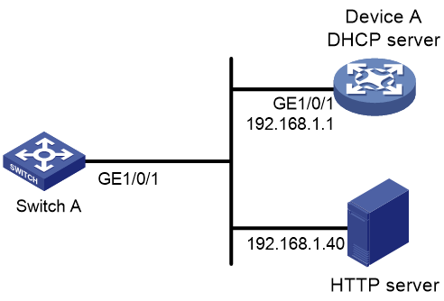

Typical server-based automatic configuration network
As shown in Figure 1, a typical server-based automatic configuration network consists of the following servers:
·     DHCP server—Allocates an IP address to the device that performs server-based automatic configuration and notifies the device of the method to obtain the configuration file or script file for automatic configuration.
·     File server—TFTP, HTTP, SFTP, or FTP server. The file server stores the configuration file or script file for automatic configuration.
·     (Optional.) DNS server—Obtains the configuration file name or the IP address of the file server for the device.
Figure 1 Server-based automatic configuration network diagram

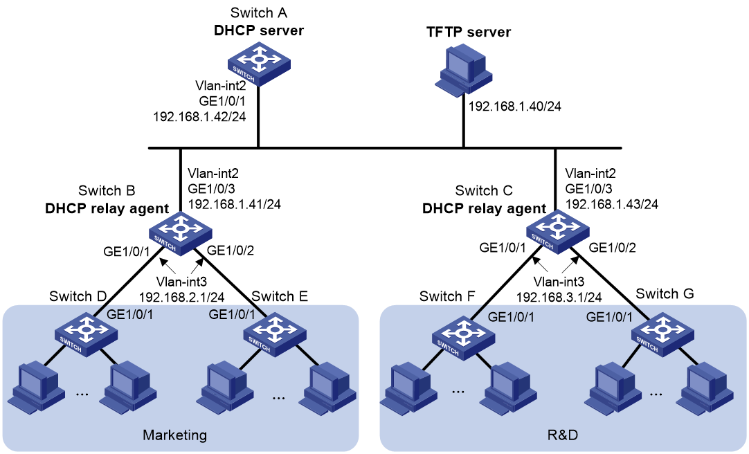

Example: Using a TFTP server for automatic configuration
As shown in Figure 2, two departments of a company are connected to the network through gateways (Switch B and Switch C). Access devices Switch D, Switch E, Switch F, and Switch G do not have a configuration file.
Configure the servers and gateways so the access devices can obtain a configuration file to complete the following configuration tasks:
·     Enable administrators of access devices to Telnet to and manage their respective access devices.
·     Require administrators to enter their respective usernames and passwords at login.
Figure 2 Network diagram

Example: Using an SFTP server for automatic configuration
As shown in Figure 5, Switch A automatically obtains and executes a configuration file from the SFTP server after it starts up in order to meet the following requirements:
·     The network administrator can log in to and control the switch through Telnet.
·     Authentication is required for switch login to enhance security.
Figure 5 Network diagram

<DeviceA> system-view
[DeviceA] dhcp enable
[DeviceA] dhcp server ip-pool 1
[DeviceA-dhcp-pool-1] network 192.168.1.0 24
# Specify the URL of the configuration file. The username and password must be the same as those on the FTP server.
[DeviceA-dhcp-pool-1] bootfile-name ftp://user:pass@192.168.1.40:22/device.cfg
2.     Configure the FTP server to ensure that Switch A can successfully download configuration file device.cfg from the FTP server:
# Create configuration file device.cfg on the FTP server. The file contents are as follows:
telnet server enable
local-user user
password simple hello12345
service-type telnet
user-interface vty 0 63
authentication-mode scheme
user-role network-admin
interface gigabitethernet 1/0/1
port link-mode route
ip address dhcp-alloc
return
# Start the FTP management software and enable the FTP service. (Details not shown.)
# Start up Switch A without a startup configuration file. After the switch starts up successfully, display binding information about assigned IP addresses on Device A.
<DeviceA> display dhcp server ip-in-use
IP address       Client identifier/    Lease expiration      Type
                 Hardware address
192.168.1.2      0030-3030-632e-3239-  Dec 12 17:41:15 2013  Auto(C)
                 3035-2e36-3736-622d-
                 4574-6830-2f30-2f32
# On Device A, Telnet to Switch A.
<SwitchA> telnet 192.168.1.2
# Enter username user and password hello12345. Verify that you can Telnet to Switch A from Device A.
Example: Setting up an IRF fabric
As shown in Figure 7, Switch A and Switch B do not have a configuration file.
Configure the servers so the switches can obtain a Python script to complete their respective configurations and form an IRF fabric.
Figure 7 Network diagram
1.     Assign IP addresses to the interfaces. Make sure the devices can reach each other. (Details not shown.)
2.     Configure the following files on the HTTP server:
File
Content
Remarks
.cfg configuration file
Commands required for IRF setup.
You can create a configuration file by copying and modifying the configuration file of an existing IRF fabric.
sn.txt
Serial numbers of the member switches.
Each SN uniquely identifies a switch.
These SNs will be used for assigning a unique IRF member ID to each member switch.
(Optional.) .ipe or .bin software image file
Software images.
If the member switches are running different software versions, you must prepare the software image file used for software upgrade.
.py Python script file
Python commands that complete the following tasks:
a     (Optional.) Verify that the flash memory has sufficient space for the files to be downloaded.
b     Download the configuration file and sn.txt.
c     (Optional.) Download the software image file and specify it as the main startup image file.
d     Resolve sn.txt and assign a unique IRF member ID to each SN.
e     Specify the configuration file as the main next-startup configuration file.
f     Reboot the member switches.
For more information about Python script configuration, see "Using Python."
The specific content of the Python script is as follows (there are simple comments in the Python script, delete the comments when you use the script):
