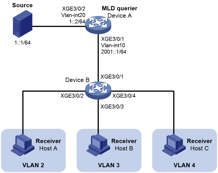

As shown in Figure 1, Host A, Host B, and Host C are in different VLANs and the same IPv6 multicast group. When Device A (Layer 3 device) receives IPv6 multicast data for that group, it forwards three copies of the data to Device B (Layer 2 device). This occupies a large amount of bandwidth and increases the burden on the Layer 3 device.
Figure 1 Multicast transmission without the IPv6 multicast VLAN feature
After an IPv6 multicast VLAN is configured on Device B, Device A sends one copy of the IPv6 multicast data to the IPv6 multicast VLAN on Device B. This saves network bandwidth and lessens the burden on the Layer 3 device.

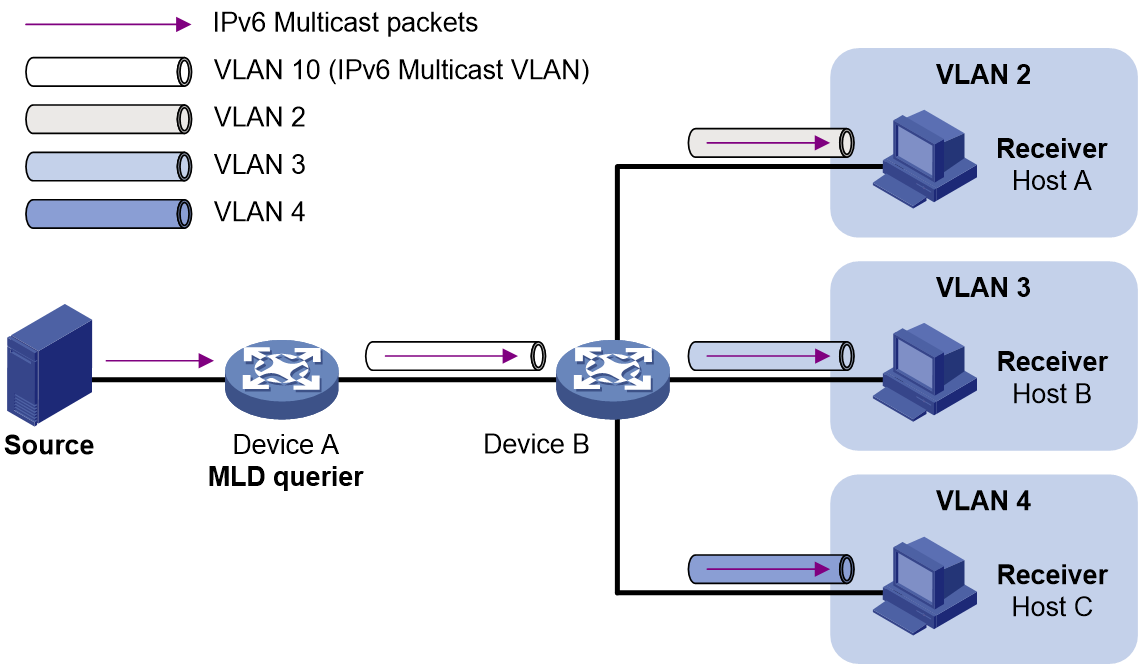

As shown in Figure 2:
·     Host A, Host B, and Host C are in VLAN 2 through VLAN 4, respectively.
·     On Device B, VLAN 10 is an IPv6 multicast VLAN. VLAN 2 through VLAN 4 are sub-VLANs of VLAN 10.
·     MLD snooping is enabled for the multicast VLAN and its sub-VLANs.
Figure 2 Sub-VLAN-based multicast VLAN
MLD snooping manages router ports in the IPv6 multicast VLAN and member ports in each sub-VLAN. When Device A receives IPv6 multicast data from the IPv6 multicast source, it sends only one copy of the IPv6 multicast data to the IPv6 multicast VLAN on Device B. Then, Device B sends a separate copy to each sub-VLAN of the IPv6 multicast VLAN.

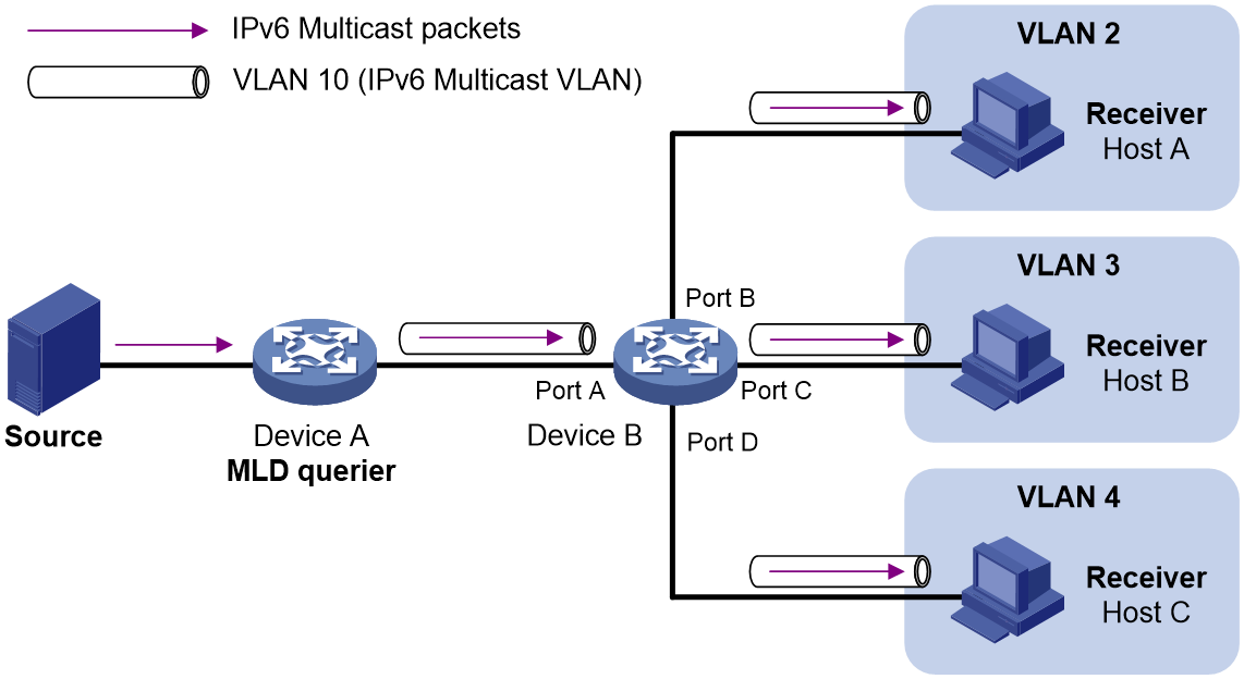

As shown in Figure 3:
·     Host A, Host B, and Host C are in VLAN 2 through VLAN 4, respectively. All the user ports (ports with attached hosts) on Device B are hybrid ports.
·     On Device B, VLAN 10 is an IPv6 multicast VLAN. All the user ports are assigned to VLAN 10.
·     MLD snooping is enabled for the IPv6 multicast VLAN and its sub-VLANs.
Figure 3 Port-based IPv6 multicast VLAN
MLD snooping manages the router ports and member ports in the IPv6 multicast VLAN. When Device A receives IPv6 multicast data from the IPv6 multicast source, it sends only one copy of the IPv6 multicast data to the IPv6 multicast VLAN on Device B. Then, Device B sends a separate copy to each user port in the IPv6 multicast VLAN.
