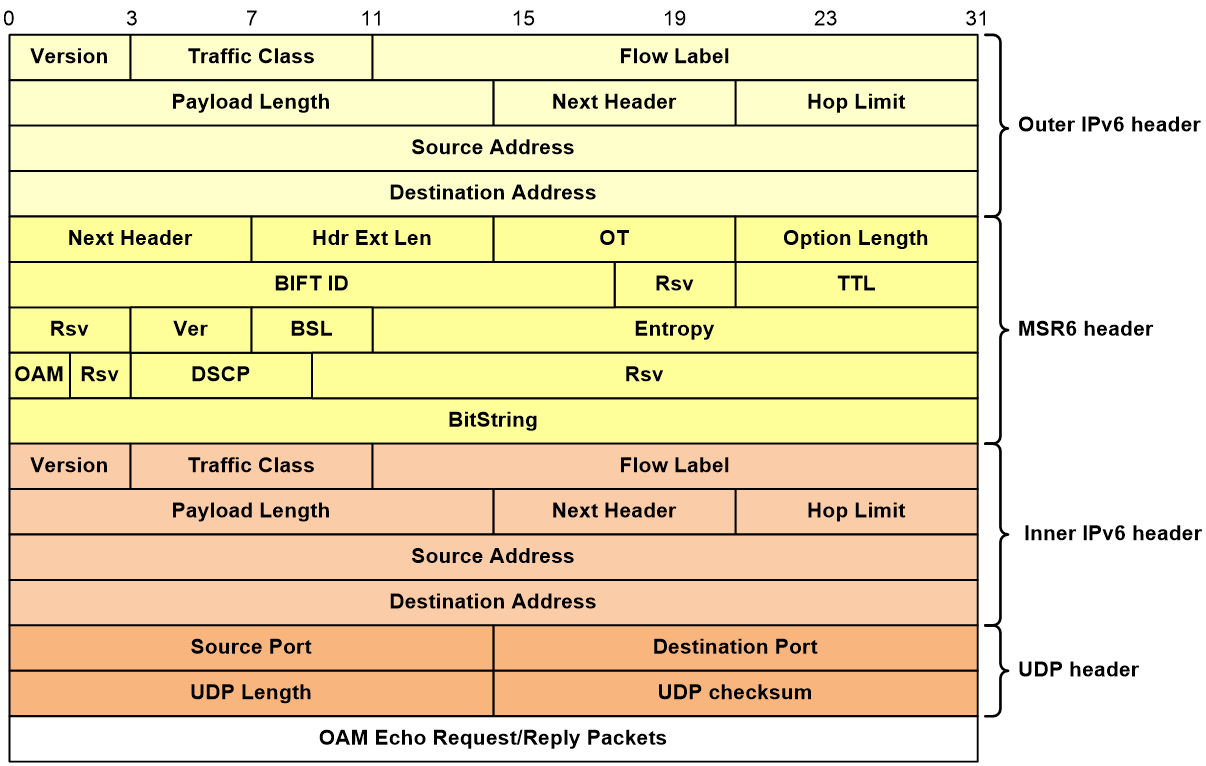

G-BIER echo packet format
Figure 1 shows the format of a G-BIER echo request or reply packet.
Figure 1 BIER OAM echo request/reply packet format

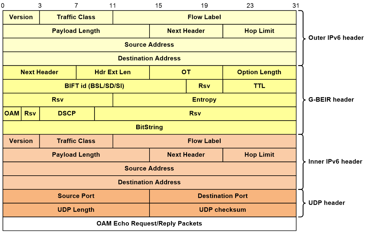

BIERv6 echo packet format
Figure 2 shows the format of a BIERv6 echo request or reply packet.
Figure 2 BIERv6 OAM echo request/reply packet format

BIER OAM packet fields
The following describes the meanings of BIER OAM packet fields:
· G-BIER/BIERv6/MSR6 header: For detailed information about the fields in the G-BIER, BIERv6, and MSR6 headers, see BIER Configuration Guide.
· IPv6 header:
¡ Source Address—IPv6 source address, 32 bits in length. In a request packet, the value of this field is consistent with that in the BIER header. In a reply packet, the value of this field is the prefix of the destination BFR.
¡ Destination Address—IPv6 destination address, 32 bits in length. In a request packet, the value of this field is fixed at 0:0:0:0:0:FFFF:7F00:1. In a reply packet, the value of this field is the source IPv6 address of the request.
· UDP header:
¡ Source Port—UDP source port number, 16 bits in length.
¡ Destination Port—UDP destination port number, 16 bits in length.
¡ UDP Length—UDP datagram length, 16 bits in length.
¡ UDP Checksum—UDP checksum, 16 bits in length. It is used to verify the integrity of the transmitted data.

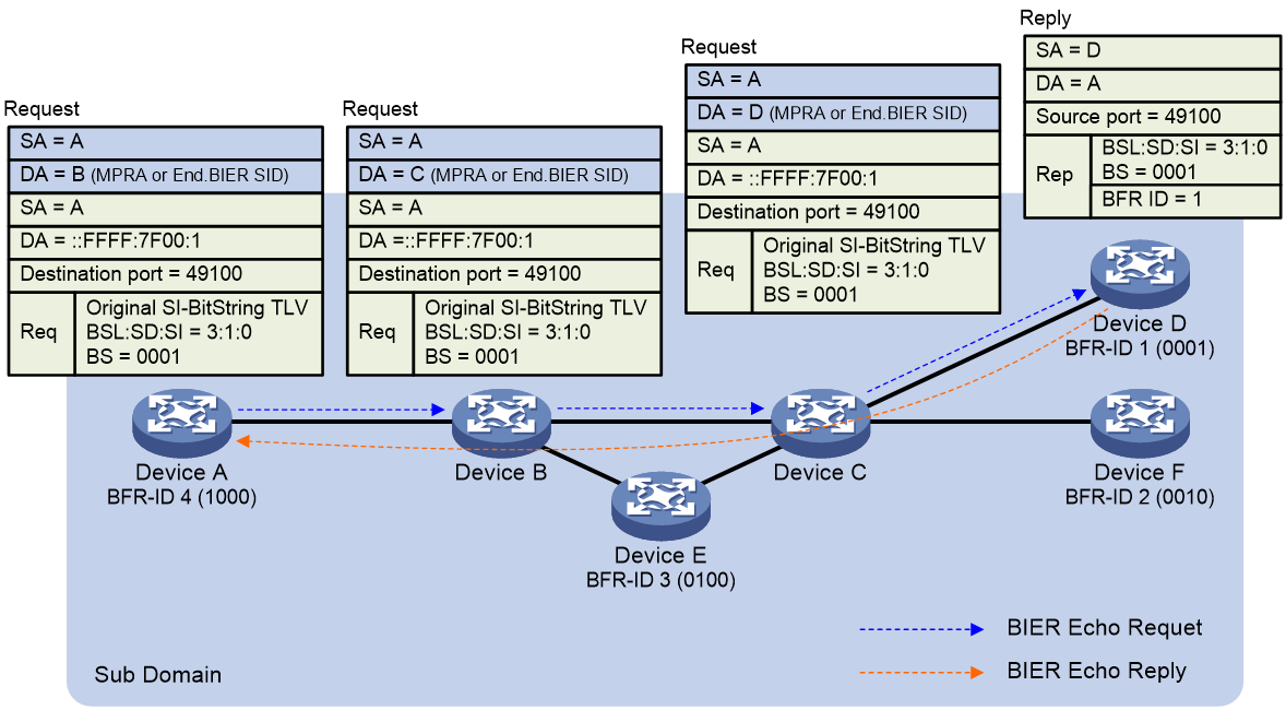

BIER ping
BIER ping tests routing underlay connectivity and can be performed only if the BIER routing underlay is established. It does not rely on any BIER-based multicast service configuration or the IPv6 source address that represents the MSID, Src.DT4, or Src.DT6.
A node in a BIER domain transmits a BIER echo request packet to the destination BFER to initiate a ping test. After receiving the request packet, the destination BFER responds with a BIER echo reply packet. If the initiating node does not receive a response from the destination BFER node within the specified time, a timeout message is generated.
Figure 4 shows a BIER ping procedure. In this example, the packet is transmitted over the Device A→Device B→Device C→Device D path. For simplified illustration, the BSL used is 4 bits.
Figure 4 BIER ping
1. Device A determines the BIER triplet information (BSL, sub-domain, and SI) based on the ping command and identifies the BIFT ID, 0x30100 in this example.
2. Device A looks up the local BIER forwarding table based on the BIFT ID.
3. Device A transmits the BIER echo request to Device B. Within the BIER header, the destination IPv6 address depends on the encapsulation type:
¡ For G-BIER, the destination IPv6 address is Device B's MPRA.
¡ For BIERv6, the destination IPv6 address is the End.BIER SID.
¡ For MSR6, the destination IPv6 address is the End.RGB SID.
4. Device B looks up the local BIER forwarding table and then forwards the packet to Device C.
5. Device C looks up the local BIER forwarding table and then forwards the packet to Device D.
6. Upon receipt of the echo request, Device D which is the destination node returns an echo reply packet to Device A.
7. Upon receiving the echo reply, Device A compares the key fields of the reply packet with those of the request packet it sent. If the fields match, Device A outputs the length, sequence number of response time of the reply packet. If the fields do not match, Device A ignores the packet.
8. If Device A does not receive a response from the specified destination node within the specified waiting time, it outputs a timeout message.

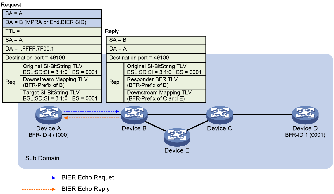

First tracert round trip
The TTL is 1 for the first tracert round trip, as shown in Figure 5.
Figure 5 First tracert round trip
1. Device A determines the BIER triplet information (BSL, sub-domain, and SI) based on the tracert command and identifies the BIFT ID.
The BFR prefix of Device B is carried in the Downstream Mapping TLV field.
4. After the request arrives at Device B, its TTL is decremented to 0, and Device B returns an echo reply packet to Device A. Because Device B is a transit node, the echo reply packet carries its own BFR prefix in the Responder BFR TLV and the BFR prefixes of downstream Device C and Device E in the Downstream Mapping TLV.
5. Upon receipt of the echo reply, Device A compares key fields in the reply with those in the request it sent. If the fields do not match, Device A ignores the reply. If the fields match, Device A displays reply information.

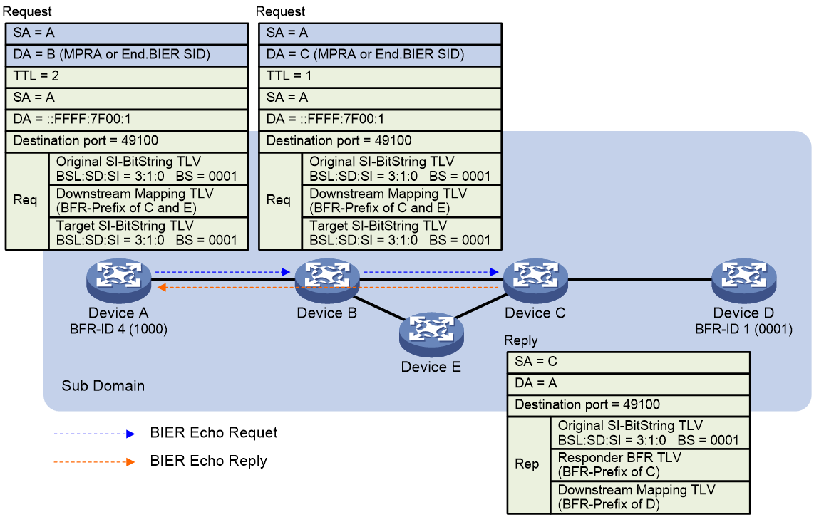

Second tracert round trip
The TTL is 2 for the second tracert round trip, as shown in Figure 6.
Figure 6 Second tracert round trip
1. Device A looks up the local BIER forwarding table based on the BIFT ID.
2. Device A transmits the BIER echo request to Device B. Within the BIER header, the destination IPv6 address depends on the encapsulation type:
The BFR prefixes (copied from the received echo reply) of Device C and Device E are carried in the Downstream Mapping TLV field.
3. After the request arrives at Device B, its TTL is decremented to 1.
4. Device B looks up the local BIFT and forwards the packet to Device C.
5. After the request arrives at Device C, its TTL is decremented to 0, and Device C returns an echo reply packet to Device A. Because Device C is a transit node, the echo reply packet carries its own BFR prefix in the Responder BFR TLV and the BFR prefix of downstream Device D in the Downstream Mapping TLV.
6. Upon receipt of the echo reply, Device A compares key fields in the reply with those in the sent request. If the fields do not match, Device A ignores the reply. If the fields match, Device A displays reply information.

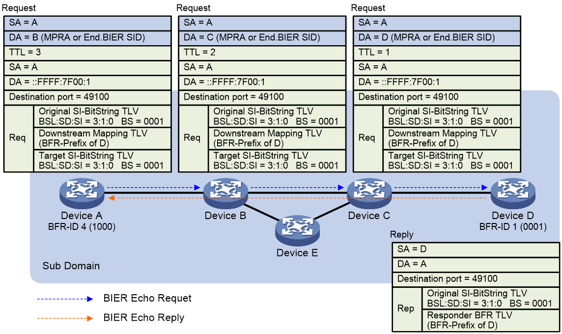

Last tracert round trip
The TTL is 3 for the last tracert round trip, as shown in Figure 6.
Figure 7 Second tracert round trip
3. After the request arrives at Device B, its TTL is decremented to 2, and Device B looks up the local BIFT and forwards the packet to Device C.
4. After the request arrives at Device C, its TTL is decremented to 1, and Device C looks up the local BIFT and forwards the packet to Device D.
5. After the request arrives at Device D, its TTL is decremented to 0, and Device D returns an echo reply packet to Device A. Because Device D is a destination node, the echo reply packet carries its own BFR prefix in the Responder BFR TLV and does not carry the Responder BFR TLV.
