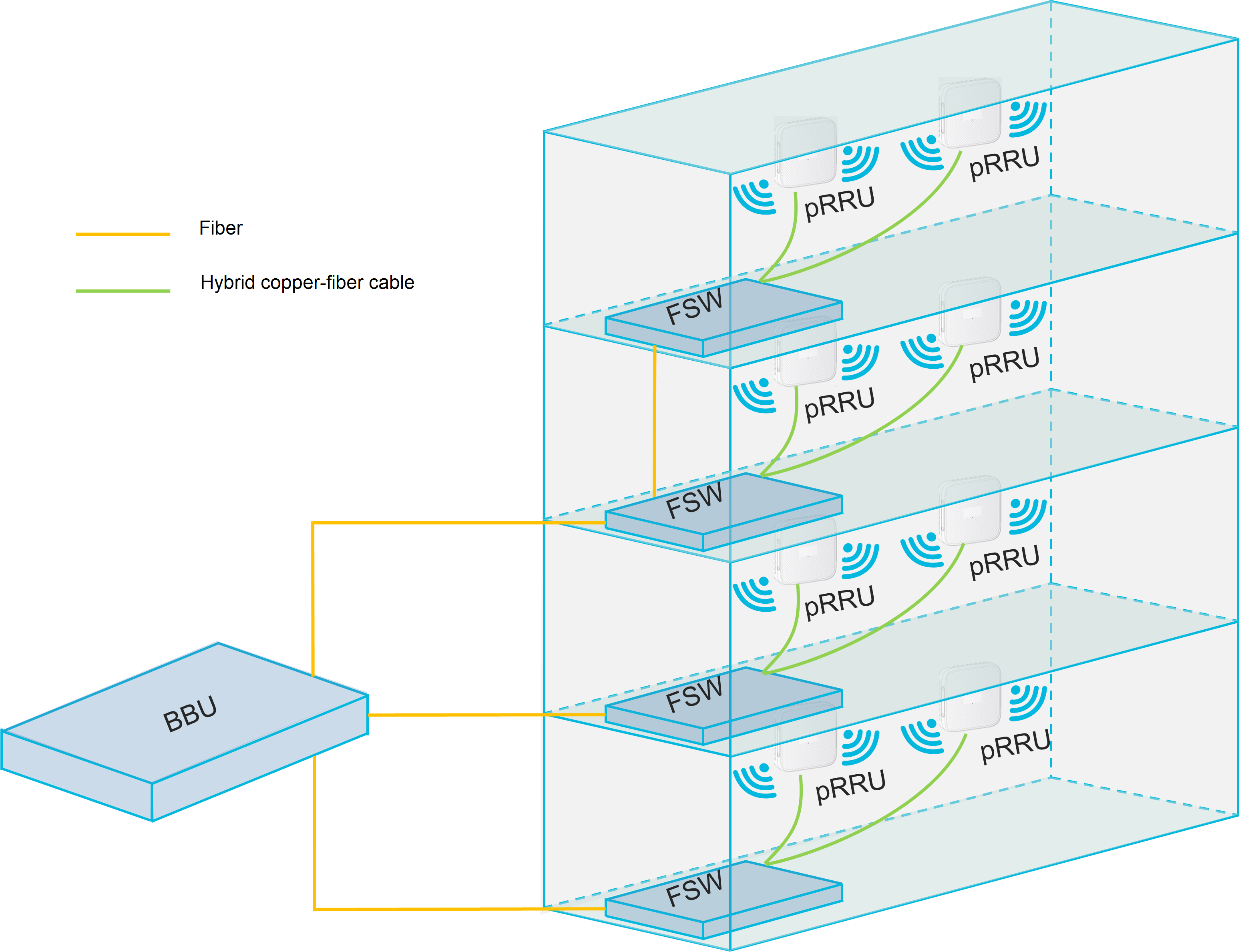

About the H3C 5G extended pico station
In the H3C 5G extended pico station solution, configure BBUs, FSWs, and pRRUs in the ratio of 1:4:32. A BBU5200 unit can be connected to up to 32 pRRUs through 4 FSW5100 units.
An H3C 5G extended pico station is an indoor distributed wireless access system, featuring simple architecture, ease of deployment, low maintenance, and deep multi-standard coverage. As shown in Figure 1, an H3C extended pico station contains three parts:
·     BBUBaseband processing unit for the 5G extended pico station, providing device management, configuration management, performance monitoring, clock management, signaling processing, baseband resource management, and wireless resource management.
·     FSWExtension unit of the 5G extended pico station. It connects to the BBU or subordinate FSW through fiber and accesses the pRRU through a hybrid copper-fiber cable to provide power.
·     pRRURadio frequency remote unit for the 5G extended pico station, providing the following features:
¡     The transmit channel receives digital signals from the BBU enhanced Common Public Radio Interface (eCPRI) port, performs digital-to-analog conversion, frequency modulation, and amplification filtering, and ultimately transmits the RF signal through the antenna.
¡     The receive channel captures the RF signal from the antenna, amplifies and filters it, performs frequency modulation, converts it to a digital signal, and sends it back to the BBU through the eCPRI port.
The pRRU can be directly connected to the BBU or extended through the FSW to expand the cell scale.
Figure 1 H3C 5G extended pico station

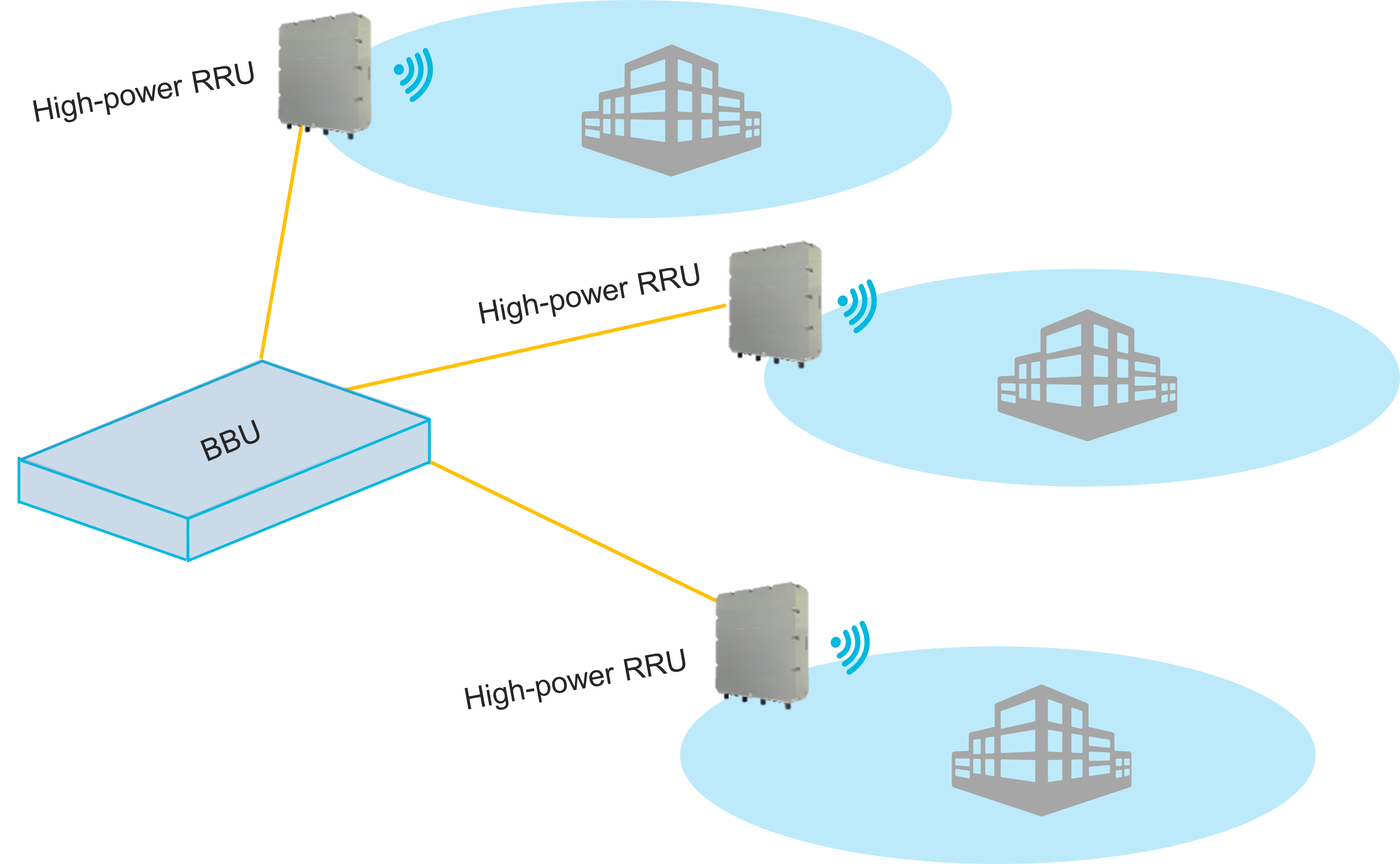

H3C 5G outdoor high-power base stations
A BBU5200 unit can be connected to up to four 4TR RRUs.
An H3C 5G high-power outdoor base station contains a BBU and multiple high-power RRUs. The deployment of high-power RRUs implements wide-area 4G/5G signal coverage, meeting the coverage needs of various outdoor scenarios.
Figure 2 H3C 5G outdoor high-power base station

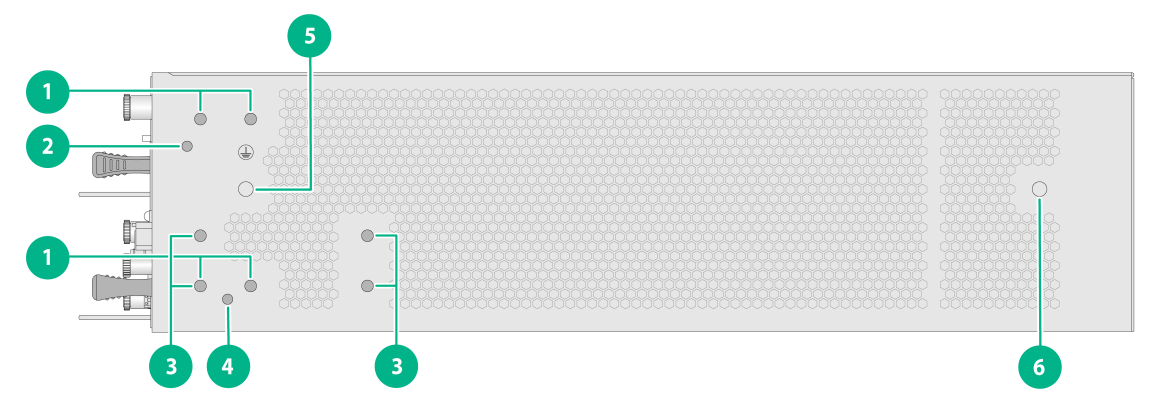

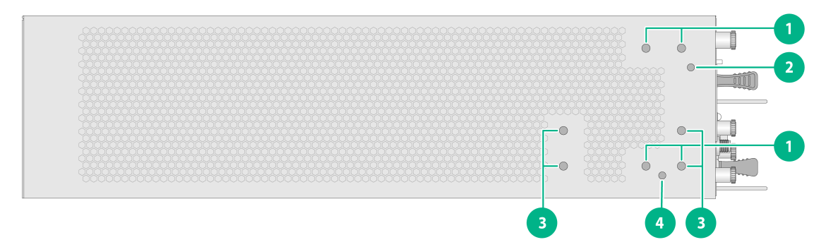

Figure 4 Side panel
(1): Ear mounting position (used when mounting to a rack)
(2): Ear alignment pin hole position (used when mounting to a rack)
(3): Ear mounting position (used when mounting to a wall)
(4): Ear alignment pin hole position (used when mounting to a wall)
(5): Main grounding point of the device (near the power side)
(6): Auxiliary grounding point of the device (near the power side)

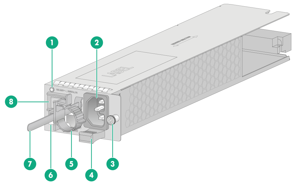

Figure 5 shows the PSR780-12A AC power module appearance.
Figure 5 PSR780-12A AC power module
1: Status LED
2: Power input socket
3: Screw
4: Cable tie holder
5: Cable clamp
6: Environment monitoring port (MON)
7: Mounting strap
8: Power switch

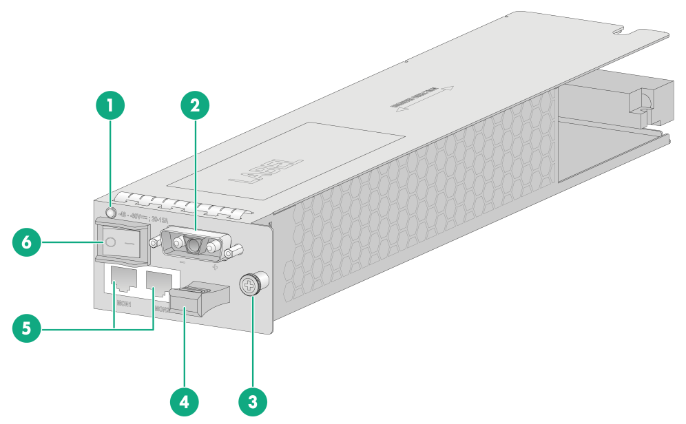

PSR780-12D DC power module
Figure 6 shows the PSR780-12D DC power module appearance.
Figure 6 PSR780-12D DC power module
1: status LED
3: Screw
4: Cable tie holder
5: Environment monitoring port (MON)
6: Power switch
Table 3 PSR780-12D DC power module specifications
Model
Item
Specifications
Description
PSR780-12D
Input rated voltage range
-48 to -60 VDC
For more information about the power module, see H3C PSR780-12D Power Module User Manual.
BBU5200 does not support sending environmental information of the device to the environment monitor through the MON port of the power module.
Input maximum voltage range
-36 to -72 VDC
Power fuse blow current
30A
Maximum power supply capacity
780W
Number and type of interfaces
Two MON ports
Cable types supported by the interface
MON port supports cables listed in Table 4.

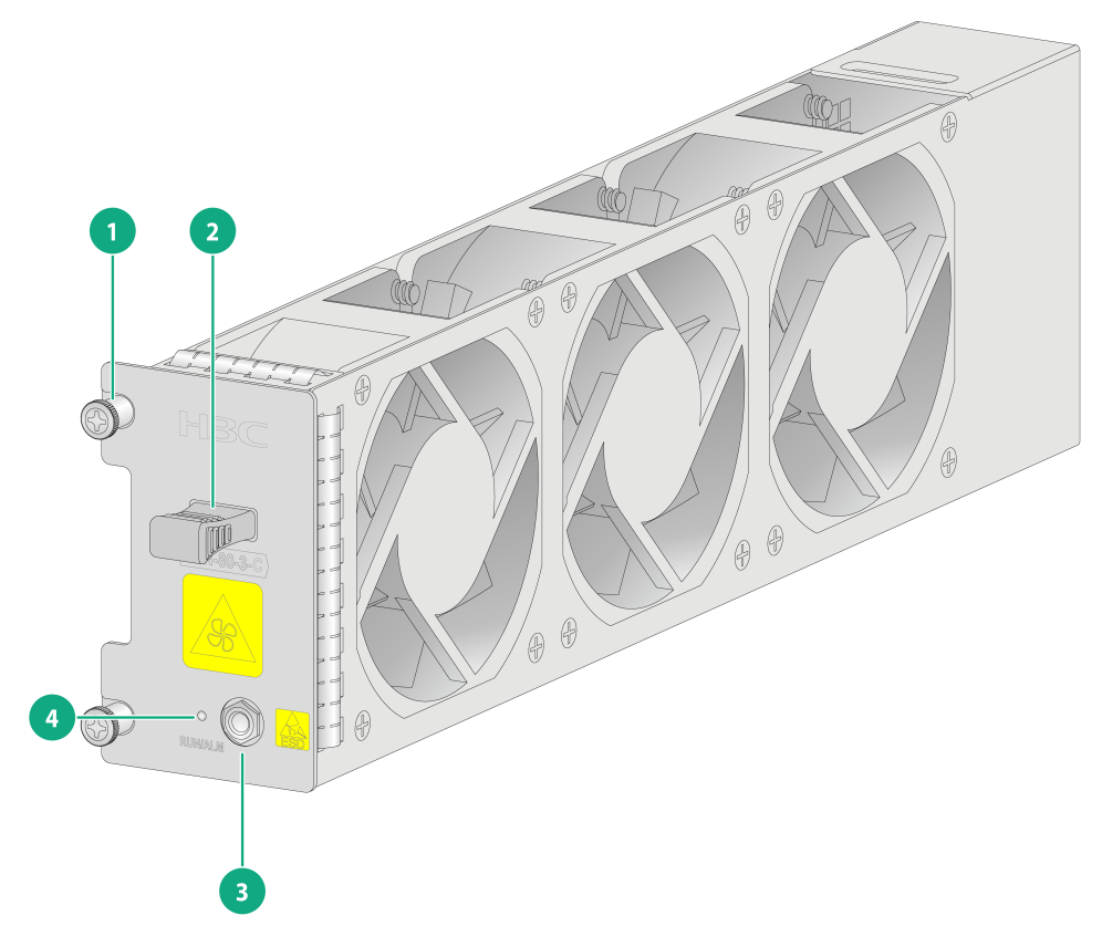

Figure 7 shows the fan tray appearance.
Figure 7 Fan tray
1: Screw
2: Cable tie holder
3: ESD jack
4: Fan status LED

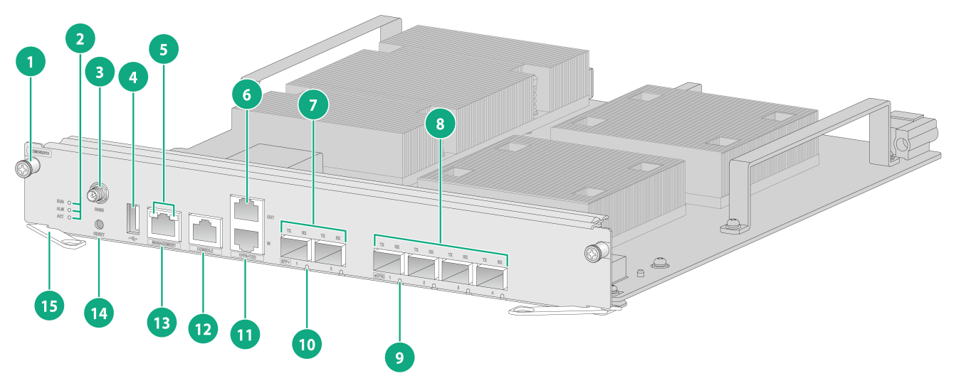

NR main control and baseband module
About the NR main control and baseband module
MCBM1NBBPD1 is the NR baseband module for a 5G base station BBU, providing device management, configuration management, performance monitoring, clock management, signaling processing, baseband resource management, and wireless resource management.
Figure 8 NR baseband module
(1) Screw
(2) NR baseband module system status LEDs (RUN, ALM, and ACT)
(3) GNSS port
(4) USB port
(5) MANAGEMENT port status LED (left ACT, right LINK)
(6) 1PPS+TOD port (OUT)
(7) SFP+ uplink port
(8) eCPRI downlink port
(9) eCPRI downlink port status LED
(10) SFP+ uplink port status LED
(11) 1PPS+TOD port (IN)
(12) CONSOLE port
(13) MANAGEMENT port
(14) RESET button
(15) Wrench
Table 8 NR baseband module specifications
Item
Specifications
Applicable models
MC-BBU5200, MC-BBU5200-GL
Operating frequency band
·     2515 MHz to 2675 MHz
·     3300 MHz to 3600 MHz
·     4800 MHz to 4900 MHz
Duplex mode
TDD
Weight
2.36 kg
Ports
1 GNSS port
1 USB port
1 MANAGEMENT port
1 CONSOLE port
2 1PPS+TOD ports
2 SFP+ uplink ports
4 eCRPI downlink ports
Reset button
1 RESET button. You can press and hold this button for one second to reboot the NR baseband module.

LEDs
The NR baseband module is equipped with multiple LEDs to indicate the operational status of the baseband module and interfaces.
Table 22 NR baseband module LED state
LED
LED mark
LED state
Description
RUN
Off
NR baseband module fails
Flashing green (4 Hz)
NR baseband module is loading software
Flashing green (0.5 Hz)
NR baseband module runs correctly
Steady green
The system is starting BootWare
ALM
Off
NR baseband module runs correctly without any alarms generated
Flashing red (0.5 Hz)
NR baseband module has non-critical alarms
Flashing orange (0.5 Hz)
NR baseband module has clock errors, including but not limited to system clock out of lock
Steady red
NR baseband module has critical alarms or fails
ACT
Off
NR baseband module has not entered normal state
Steady green
NR baseband module has entered normal state
MANAGEMENT port ACT status LED (left)
Off
Off
MANAGEMENT port LINK status LED (right)
Off
The link of the port is not up
Steady green
The link of the port is up
Flashing green
The port is sending or receiving data
Off
SFP+ uplink port  is not installed with a transceiver module or its link is not up
Steady green
SFP+ uplink port  is installed with a transceiver module and its link is up
Flashing green
SFP+ uplink port is sending or receiving data
Steady yellow
SFP+ uplink port is installed with a transceiver module but fails to send or receive data
eCRPI downlink port status LED
Off
eCPRI downlink port  is not installed with a transceiver module or its link is not up
Steady green
eCPRI downlink port  is installed with a transceiver module and its link is up
Flashing green
eCPRI downlink port is sending or receiving data
Steady yellow
eCPRI downlink port is installed with a transceiver module but fails to send or receive data

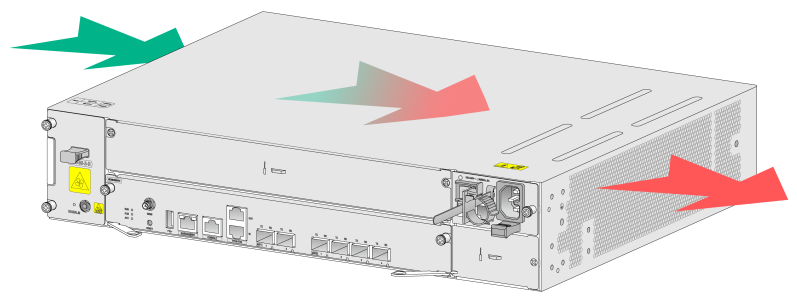

Cooling system
CAUTION
CAUTION:
·     Make sure a minimum clearance of 60 mm (2.36 in) is reserved around the inlet and outlet air vents.
·     Make sure the installation site has a good cooling system.
To dissipate heat timely and ensure system stability, the device uses ventilation holes and pluggable fan trays. Consider the site ventilation design when you plan the installation site for the device.
Figure 9 Airflow direction
