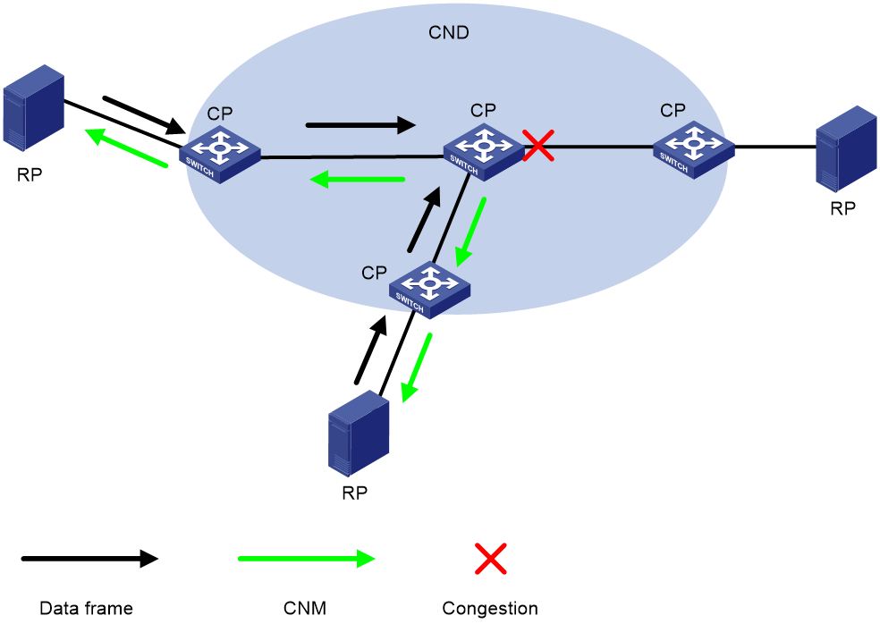

As shown in Figure 1, in a QCN network, all reaction points (RPs) and congestion points (CPs) must support QCN. RPs and CPs configured with a congestion notification priority value (CNPV) form a congestion notification domain (CND).
Figure 1 shows how QCN works.
·     Ethernet frames sent by an RP contain different congestion controlled flows (CCFs). The 802.1p value in an Ethernet frame uniquely identifies a CCF. The CP maps different CCFs to different queues according to the dot1p-lp mapping table.
·     The CP enables QCN for a queue according to the 802.1p priority ((CNPV) in Ethernet frames and samples frames from the QCN-enabled queue. The CP sends congestion notification messages (CNMs) to the RP when congestion occurs.
·     The RP reduces the transmission rate for packets with the 802.1p value when receiving CNMs. The RP also periodically probes the bandwidth and increases the transmission rate if it fails to receive CNMs for a specific period of time.
Figure 1 How QCN works

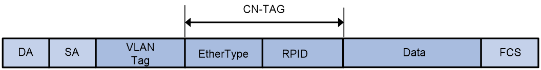

Data flow format
An RP can add CN tags to outgoing Ethernet frames to distinguish between CCFs. A CN tag defines a CCF.
As shown in Figure 2, the CN tag contains the following fields:
·     EtherType—Indicates the Ethernet type of the data packet, 2 bytes in length and assigned a value of 0x22E9.
·     RPID—Locally assigned and 2 bytes in length. When receiving a CNM, the RP uses this field to identify the CCF that causes congestion and then rate limits that CCF.
When only one CCF exists, the RP may not add a CN tag to packets. In this case, the triggered CNM carries a CN tag with the RPID as 0.
A CN tag is confined within its CND. When a packet leaves a CND, the CN tag is stripped off.
Figure 2 Data flow format

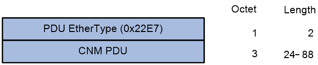

CNM format
When a CP detects the congestion state by sampling frames, it sends CNMs to the RPs.
The CP constructs a CNM as follows:
·     Uses the source MAC address of the sampled frame as the destination MAC address.
·     Uses the MAC address of the CP as the source MAC address.
·     Copies the VLAN tag and CN tag of the sampled frame.
·     Places the data as shown in Figure 3.
¡     PDU EtherType—2 bytes in length. It indicates the Ethernet type of the PDU and has a value of 0x22E7.
¡     CNM PDU—24 to 88 bytes of payload of the PDU.
Figure 3 CNM PDU format

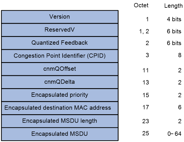

As shown in Figure 4, a payload contains the following fields:
Field
Length
Description
Version
4 bits
Its value is fixed at 0.
ReserverV
6 bits
Quantized Feedback
6 bits
Quantized value indicating the extent of congestion.
CPID
8 bytes
Identifies the CP where congestion occurs.
cnmQoffset
2 bytes
Indicates the difference between instantaneous queue size at the sampling point and desired queue length.
cnmQdelta
2 bytes
Indicates the difference between instantaneous queue sizes at the current sampling point and at the previous sampling point.
Encapsulated priority
2 bytes
Priority of the sampled frame that triggered the CNM.
Encapsulated destination MAC address
6 bytes
Destination MAC address of the sampled frame that triggered the CNM.
Encapsulated MSDU length
2 bytes
Number of bytes in the Encapsulated MSDU field of the sampled frame that triggered the CNM.
Encapsulated MSDU
0 to 64 bytes
Initial bytes of the Encapsulated MSDU field of the sampled frame that triggered the CNM.

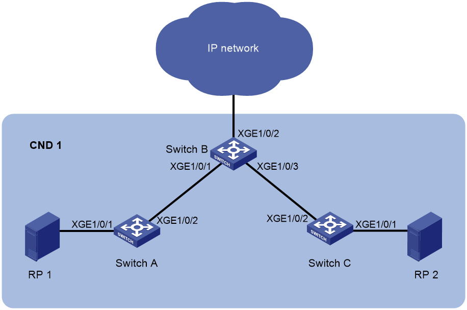

Example: Configuring basic QCN
As shown in Figure 6, RP 1 and RP 2 are in the same VLAN and both support QCN.
Configure QCN for CNPV 1 to meet the following requirements:
·     Switch A, Switch B, and Switch C detect congestion for traffic with 802.1p priority 1.
·     Switch A, Switch B, and Switch C do not detect congestion for all other traffic.
Figure 6 Network diagram
1.     Configure Switch A:

[SwitchB] interface ten-gigabitethernet 1/0/2
[SwitchB-Ten-GigabitEthernet1/0/2] port link-type trunk
[SwitchB-Ten-GigabitEthernet1/0/2] port trunk permit vlan 100
[SwitchB-Ten-GigabitEthernet1/0/2] quit
[SwitchB] interface ten-gigabitethernet 1/0/3
[SwitchB-Ten-GigabitEthernet1/0/3] port link-type trunk
[SwitchB-Ten-GigabitEthernet1/0/3] port trunk permit vlan 100
[SwitchB-Ten-GigabitEthernet1/0/3] quit
# Enable LLDP globally.
[SwitchB] lldp global enable
# Enable CN TLV advertising on Ten-GigabitEthernet 1/0/1 and Ten-GigabitEthernet 1/0/3.
[SwitchB] interface ten-gigabitethernet 1/0/1
[SwitchB-Ten-GigabitEthernet1/0/1] lldp tlv-enable dot1-tlv congestion-notification
[SwitchB-Ten-GigabitEthernet1/0/1] quit
[SwitchB-Ten-GigabitEthernet1/0/3] lldp tlv-enable dot1-tlv congestion-notification
# Enable QCN.
[SwitchB] qcn enable
# Assign the switch to the CND with CNPV 1.
[SwitchB] qcn priority 1 auto
# Configure the CND defense mode edge and alternate value 0 for interface Ten-GigabitEthernet 1/0/2.
[SwitchB-Ten-GigabitEthernet1/0/2] qcn port priority 1 admin defense-mode edge alternate 0
# Assign the switch to the CND with CNPV 1, and configure all interfaces to negotiate the defense mode and alternate priority by using LLDP.
3.     Configure Switch C in the same way Switch A is configured. (Details not shown.)
# Display the CND settings for interfaces on Switch A.
[SwitchA] display qcn interface
Interface: XGE1/0/1
 CNPV  Mode   Defense-mode     Alternate
 1     comp   interior-ready   0
Interface: XGE1/0/2
# Display the CND settings for interfaces on Switch B.
[SwitchB] display qcn interface
Interface: XGE1/0/1
Interface: XGE1/0/2
 1     admin  edge             0
Interface: XGE1/0/3
# Display the CND settings for interfaces on Switch C.
[SwitchC] display qcn interface
Interface: XGE1/0/1
Interface: XGE1/0/2

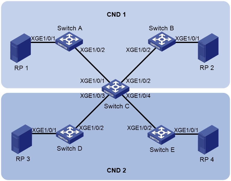

Example: Configuring MultiCND QCN
As shown in Figure 7:
·     RP 1 and RP 2 are in the same VLAN.
·     RP 3 and RP 4 are in the same VLAN.
·     RP 1, RP 2, Switch A, Switch B, and Switch C form a CND with CNPV 1.
·     RP 3, RP 4, Switch C, Switch D, and Switch E form a CND with CNPV 5.
·     Switch A and Switch B do not detect congestion for traffic with 802.1p priority 5.
Configure QCN for CNPV 5 to meet the following requirements:
·     Switch C, Switch D, and Switch E detect congestion for traffic with 802.1p priority 5.
·     Switch D and Switch E do not detect congestion for traffic with 802.1p priority 1.
Figure 7 Network diagram
# Create VLAN 100, and assign Ten-GigabitEthernet 1/0/1 to the VLAN.
<SwitchA> system-view
[SwitchA] vlan 100
[SwitchA-vlan100] port ten-gigabitethernet 1/0/1
[SwitchA-vlan100] quit
# Configure Ten-GigabitEthernet 1/0/2 as a trunk port, and assign it to VLAN 100.
[SwitchA] interface ten-gigabitethernet 1/0/2
[SwitchA-Ten-GigabitEthernet1/0/2] port link-type trunk
[SwitchA-Ten-GigabitEthernet1/0/2] port trunk permit vlan 100
[SwitchA-Ten-GigabitEthernet1/0/2] quit
[SwitchA] lldp global enable
# Enable CN TLV advertising on Ten-GigabitEthernet 1/0/1.
[SwitchA] interface ten-gigabitethernet 1/0/1
[SwitchA-Ten-GigabitEthernet1/0/1] lldp tlv-enable dot1-tlv congestion-notification
[SwitchA-Ten-GigabitEthernet1/0/1] quit
# Enable CN TLV advertising on Ten-GigabitEthernet 1/0/2.
[SwitchA-Ten-GigabitEthernet1/0/2] lldp tlv-enable dot1-tlv congestion-notification
# Enable QCN.
[SwitchA] qcn enable
[SwitchA] qcn priority 1 auto
2.     Configure Switch B in the same way Switch A is configured. (Details not shown.)
3.     Configure Switch C:
# Create VLAN 100 and VLAN 200.
<SwitchC> system-view
[SwitchC] vlan 100
[SwitchC-vlan100] quit
[SwitchC] vlan 200
[SwitchC-vlan200] quit
# Configure the following interfaces as trunk ports, and assign all of them to VLAN 100 and VLAN 200:
¡     Ten-GigabitEthernet 1/0/1.
¡     Ten-GigabitEthernet 1/0/2.
¡     Ten-GigabitEthernet 1/0/3.
¡     Ten-GigabitEthernet 1/0/4.
[SwitchC] interface ten-gigabitethernet 1/0/1
[SwitchC-Ten-GigabitEthernet1/0/1] port link-type trunk
[SwitchC-Ten-GigabitEthernet1/0/1] port trunk permit vlan 100 200
[SwitchC-Ten-GigabitEthernet1/0/1] quit
[SwitchC] interface ten-gigabitethernet 1/0/2
[SwitchC-Ten-GigabitEthernet1/0/2] port link-type trunk
[SwitchC-Ten-GigabitEthernet1/0/2] port trunk permit vlan 100 200
[SwitchC-Ten-GigabitEthernet1/0/2] quit
[SwitchC] interface ten-gigabitethernet 1/0/3
[SwitchC-Ten-GigabitEthernet1/0/3] port link-type trunk
[SwitchC-Ten-GigabitEthernet1/0/3] port trunk permit vlan 100 200
[SwitchC-Ten-GigabitEthernet1/0/3] quit
[SwitchC] interface ten-gigabitethernet 1/0/4
[SwitchC-Ten-GigabitEthernet1/0/4] port link-type trunk
[SwitchC-Ten-GigabitEthernet1/0/4] port trunk permit vlan 100 200
[SwitchC-Ten-GigabitEthernet1/0/4] quit
[SwitchC] lldp global enable
# Enable CN TLV advertising on the following interfaces:
[SwitchC-Ten-GigabitEthernet1/0/1] lldp tlv-enable dot1-tlv congestion-notification
[SwitchC-Ten-GigabitEthernet1/0/2] lldp tlv-enable dot1-tlv congestion-notification
[SwitchC-Ten-GigabitEthernet1/0/3] lldp tlv-enable dot1-tlv congestion-notification
[SwitchC-Ten-GigabitEthernet1/0/4] lldp tlv-enable dot1-tlv congestion-notification
# Enable QCN.
[SwitchC] qcn enable
# Assign the switch to the CNDs with CNPV 1 and CNPV 5.
[SwitchC] qcn priority 1 auto
[SwitchC] qcn priority 5 admin defense-mode interior-ready alternate 4
# Configure the CND defense mode edge and alternate value 4 for Ten-GigabitEthernet 1/0/1 and Ten-GigabitEthernet 1/0/2.
[SwitchC-Ten-GigabitEthernet1/0/1] qcn port priority 5 admin defense-mode edge alternate 4
[SwitchC-Ten-GigabitEthernet1/0/2] qcn port priority 5 admin defense-mode edge alternate 4
4.     Configure Switch D:
# Create VLAN 200, and assign Ten-GigabitEthernet 1/0/1 to the VLAN.
<SwitchD> system-view
[SwitchD] vlan 200
[SwitchD-vlan200] port ten-gigabitethernet 1/0/1
[SwitchD-vlan200] quit
# Configure Ten-GigabitEthernet 1/0/2 as a trunk port, and assign it to VLAN 200.
[SwitchD] interface ten-gigabitethernet 1/0/2
[SwitchD-Ten-GigabitEthernet1/0/2] port link-type trunk
[SwitchD-Ten-GigabitEthernet1/0/2] port trunk permit vlan 200
[SwitchD-Ten-GigabitEthernet1/0/2] quit
# Enable QCN.
[SwitchD] qcn enable
# Assign the switch to the CND with CNPV 5.
[SwitchD] qcn priority 5 admin defense-mode interior-ready alternate 4
5.     Configure Switch E in the same way Switch D is configured. (Details not shown.)
Interface: XGE1/0/1
Interface: XGE1/0/2
Interface: XGE1/0/1
Interface: XGE1/0/2
Interface: XGE1/0/1
 5     admin  edge             4
Interface: XGE1/0/2
 5     admin  edge             4
Interface: XGE1/0/3
 1     comp   edge             0
 5     comp   interior-ready   4
Interface: XGE1/0/4
 1     comp   edge             0
# Display the CND settings for interfaces on Switch D.
[SwitchD] display qcn interface
Interface: XGE1/0/1
Interface: XGE1/0/2
# Display the CND settings for interfaces on Switch E.
[SwitchE] display qcn interface
Interface: XGE1/0/1
Interface: XGE1/0/2
