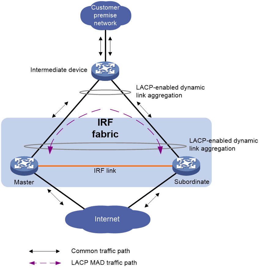

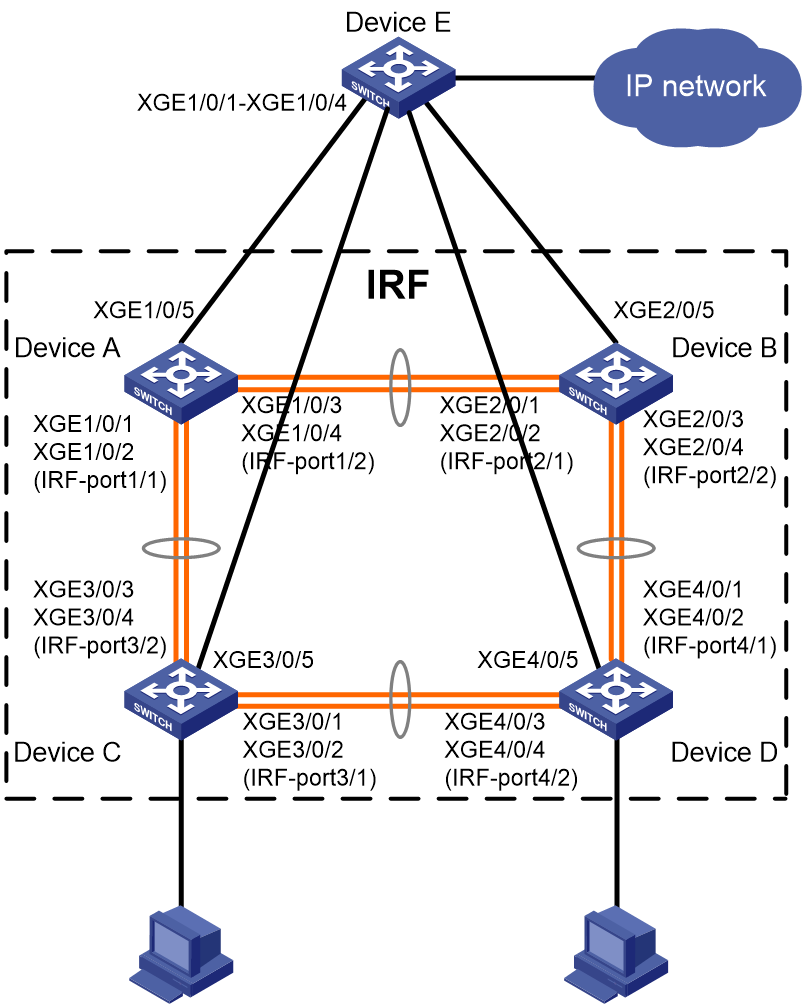

Figure 1 shows an IRF fabric that has two devices, which appear as a single node to the upper-layer and lower-layer devices.
Figure 1 IRF application scenario

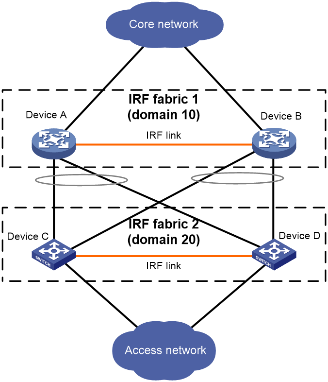

·     Simplified topology and easy management—An IRF fabric appears as one node and is accessible at a single IP address on the network. You can use this IP address to log in at any member device to manage all the members of the IRF fabric. In addition, you do not need to run the spanning tree feature among the IRF members.
·     1:N redundancy—In an IRF fabric, one member acts as the master to manage and control the entire IRF fabric. All the other members process services while backing up the master. When the master fails, all the other member devices elect a new master from among them to take over without interrupting services.
·     IRF link aggregation—You can assign several physical links between neighboring members to their IRF ports to create a load-balanced aggregate IRF connection with redundancy.
·     Multichassis link aggregation—You can use the Ethernet link aggregation feature to aggregate the physical links between the IRF fabric and its upstream or downstream devices across the IRF members.
·     Network scalability and resiliency—Processing capacity of an IRF fabric equals the total processing capacities of all the members. You can increase ports, network bandwidth, and processing capacity of an IRF fabric simply by adding member devices without changing the network topology.

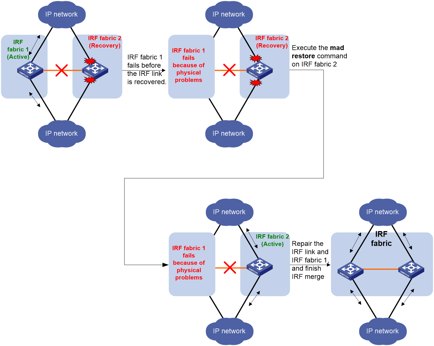

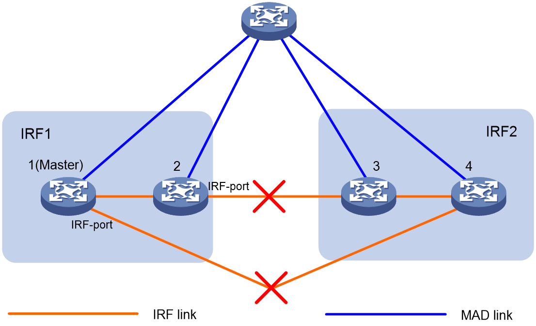

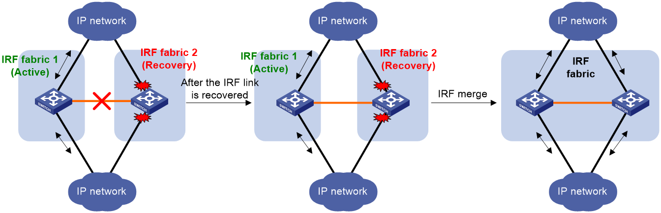

IRF split
IRF split occurs when an IRF fabric breaks up into multiple IRF fabrics because of IRF link failures, as shown in Figure 2. The split IRF fabrics operate with the same IP address. IRF split causes routing and forwarding problems on the network. To quickly detect a multi-active collision, configure a minimum of one MAD mechanism (see "Configuring MAD").
Figure 2 IRF split
IRF merge
IRF merge occurs when two split IRF fabrics reunite or when two independent IRF fabrics are united, as shown in Figure 3.
Figure 3 IRF merge

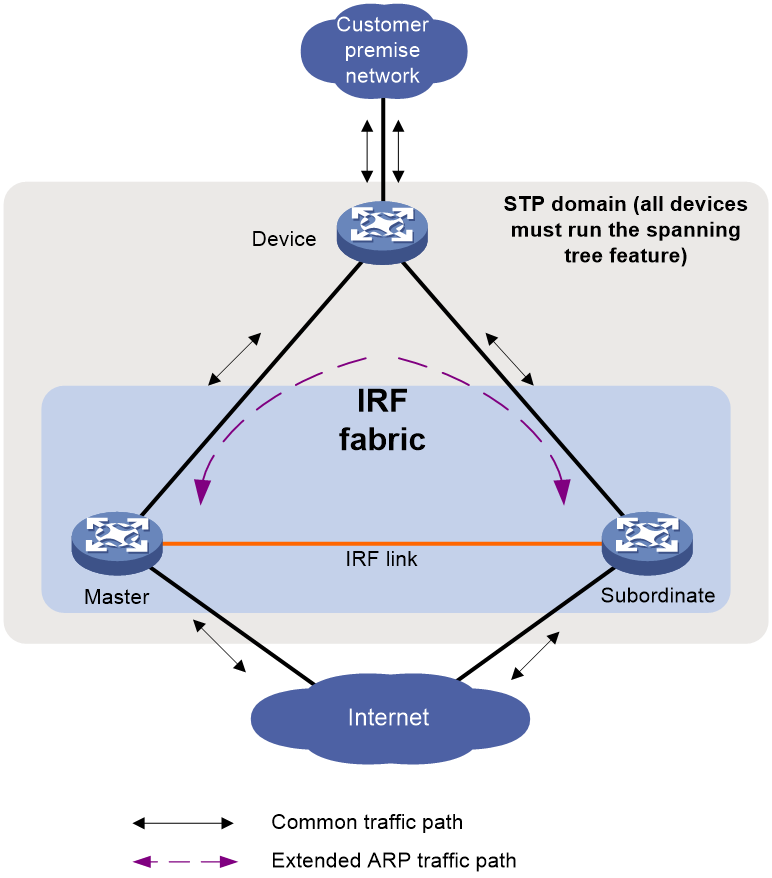

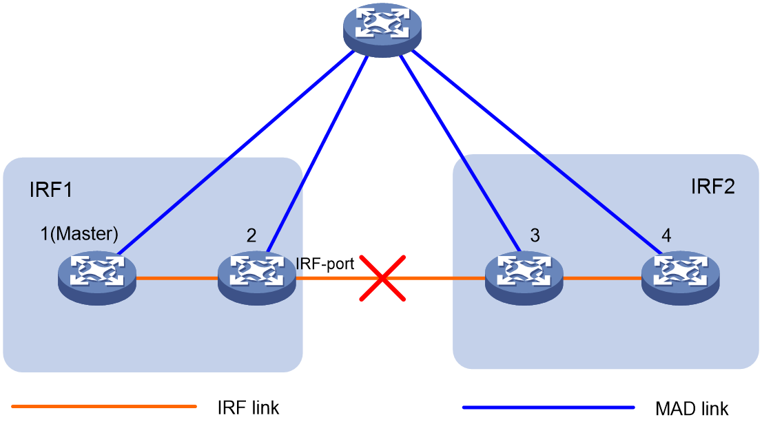

MAD
An IRF link failure causes an IRF fabric to split in two IRF fabrics operating with the same Layer 3 settings, including the same IP address. To avoid IP address collision and network problems, IRF uses multi-active detection (MAD) mechanisms to detect the presence of multiple identical IRF fabrics, handle collisions, and recover from faults.

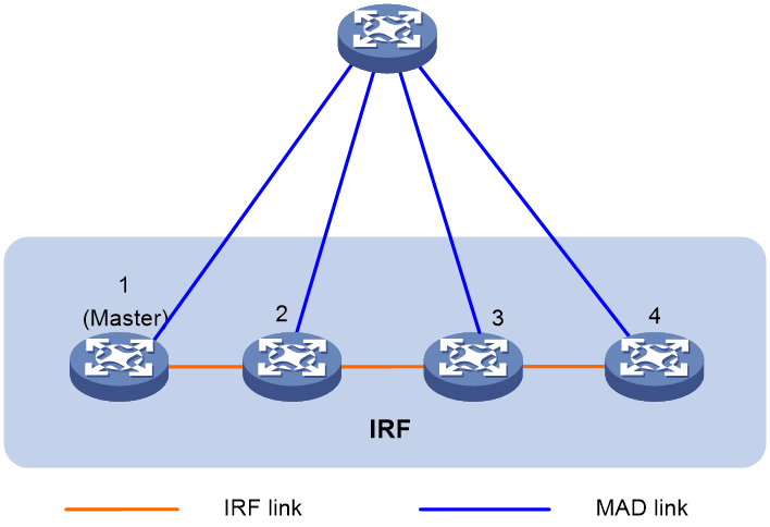

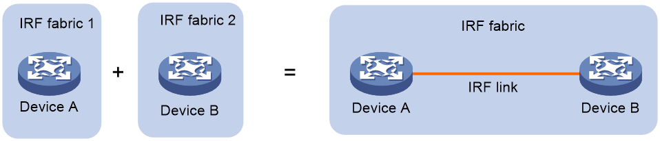

IRF domain ID
One IRF fabric forms one IRF domain. IRF uses IRF domain IDs to uniquely identify IRF fabrics and prevent IRF fabrics from interfering with one another.
As shown in Figure 4, IRF fabric 1 contains Device A and Device B, and IRF fabric 2 contains Device C and Device D. Both fabrics use the LACP aggregate links between them for MAD. When a member device receives an extended LACPDU for MAD, it checks the domain ID to determine whether the packet is from the local IRF fabric. Then, the member device can handle the packet correctly.
Figure 4 A network that contains two IRF domains

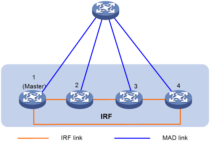

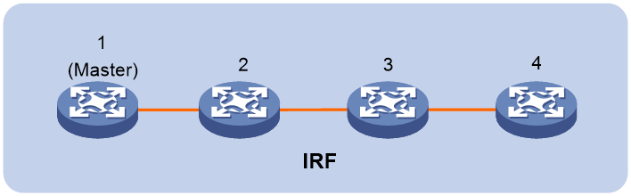

IRF network topology

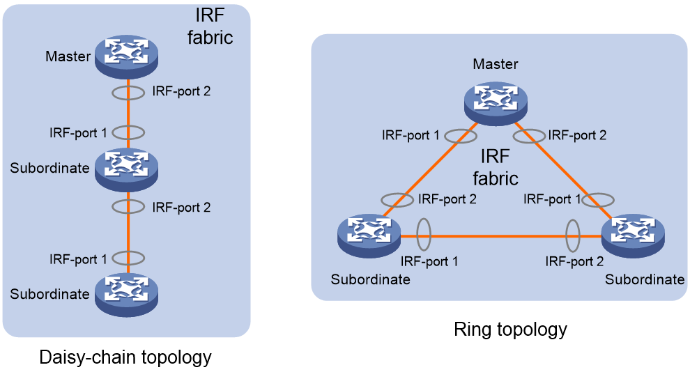

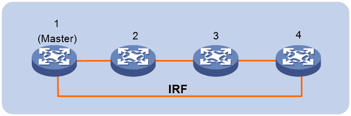

An IRF fabric can use a daisy-chain or ring topology. As shown in Figure 5, a ring topology is more reliable. In ring topology, the failure of one IRF link does not cause the IRF fabric to split as in daisy-chain topology. Rather, the IRF fabric changes to a daisy-chain topology without interrupting network services.
Figure 5 Daisy-chain topology vs. ring topology

Multi-active handling procedure
The multi-active handling procedure includes detection, collision handling, and failure recovery.
Detection
IRF provides MAD mechanisms by extending LACP, BFD, ARP, and IPv6 ND to detect multi-active collisions. As a best practice, configure a minimum of one MAD mechanism on an IRF fabric. For more information about the MAD mechanisms and their application scenarios, see "MAD mechanisms."
For information about LACP, see Ethernet link aggregation in Layer 2—LAN Switching Configuration Guide. For information about BFD, see High Availability Configuration Guide. For information about ARP, see Layer 3—IP Services Configuration Guide. For information about ND, see IPv6 basics in Layer 3—IP Services Configuration Guide.
Collision handling
When detecting a multi-active collision, MAD disables all IRF fabrics except one from forwarding data traffic by placing them in Recovery state. The IRF fabrics placed in Recovery state are called inactive IRF fabrics. The IRF fabric that continues to forward traffic is called the active IRF fabric.
BFD MAD and LACP MAD use the following process to handle a multi-active collision:
1.     Compare the health states of split fabrics.‍ To view their health states, use the display system health command. For more information about this command, see device management in Fundamentals Command Reference.
2.     Set all fabrics to the Recovery state except the healthiest one.
3.     Compare the number of members in each fabric if all IRF fabrics are in the same health state.
4.     Set all fabrics to the Recovery state except the one that has the most members.
5.     Compare the member IDs of their masters if all IRF fabrics have the same number of members.
6.     Set all fabrics to the Recovery state except the one that has the lowest numbered master.
7.     Shut down all common network interfaces in the Recovery-state fabrics except for the following interfaces:
¡     Interfaces automatically excluded from being shut down by the system.
¡     Interfaces specified by using the mad exclude interface command.
ARP MAD and ND MAD use the following process to handle a multi-active collision:
1.     Compare the health states of split fabrics. To view their health states, use the display system health command. For more information about this command, see device management in Fundamentals Command Reference.
3.     Compare the member IDs of the masters in the IRF fabrics if all IRF fabrics have the same health state.
4.     Set all fabrics to the Recovery state except the one that has the lowest numbered master.
5.     Shut down all common network interfaces in the Recovery-state fabrics except for the following interfaces:

Failure recovery
To merge two split IRF fabrics, first repair the failed IRF link and remove the IRF link failure.
When the failed IRF link between two split IRF fabrics is recovered, all member devices in the inactive IRF fabric automatically reboot to join the active IRF fabric as subordinate members. The network interfaces that have been shut down by MAD automatically restore their original state, as shown in Figure 6.
CAUTION
CAUTION:
If you inadvertently reboot the active IRF fabric after the failed IRF link recovers, its member devices will join the inactive IRF fabric with their network interfaces being shut down by MAD. To restore the original states of the network interfaces in the merged IRF fabric, use the mad restore command.
If the IRF auto-merge feature is enabled, the inactive IRF member devices will automatically reboot after the failed IRF link recovers and a manual reboot is typically not required.
Figure 6 Recovering the IRF fabric
If the active IRF fabric fails before the IRF link is recovered (see Figure 7), use the mad restore command on the inactive IRF fabric to recover the inactive IRF fabric. This command brings up all network interfaces that were shut down by MAD. After the IRF link is repaired, merge the two parts into a unified IRF fabric.
Figure 7 Active IRF fabric fails before the IRF link is recovered
MAD mechanisms
IRF provides MAD mechanisms by extending LACP, BFD, ARP, and IPv6 ND.
Table 1 compares the MAD mechanisms and their application scenarios.
Table 1 Comparison of MAD mechanisms
MAD mechanism
Advantages
Disadvantages
Application scenarios
LACP MAD
·     Detection speed is fast.
·     Runs on existing aggregate links without requiring MAD-dedicated physical links or Layer 3 interfaces.
Requires an intermediate device that supports extended LACP for MAD.
Link aggregation is used between the IRF fabric and its upstream or downstream device.
BFD MAD
·     Intermediate device, if used, can come from any vendor.
Requires MAD dedicated physical links and Layer 3 interfaces, which cannot be used for transmitting user traffic.
·     No special requirements for network scenarios.
·     If no intermediate device is used, this mechanism is only suitable for IRF fabrics that have only two members that are geographically close to one another.
ARP MAD
·     No intermediate device is required.
·     Does not require MAD dedicated ports.
·     Detection speed is slower than BFD MAD and LACP MAD.
·     The spanning tree feature must be enabled if common Ethernet ports are used for ARP MAD links.
Spanning tree-enabled non-link aggregation IPv4 network scenarios if common Ethernet ports are used.
ND MAD
·     The spanning tree feature must be enabled if common Ethernet ports are used for ND MAD links.
Spanning tree-enabled non-link aggregation IPv6 network scenarios if common Ethernet ports are used.

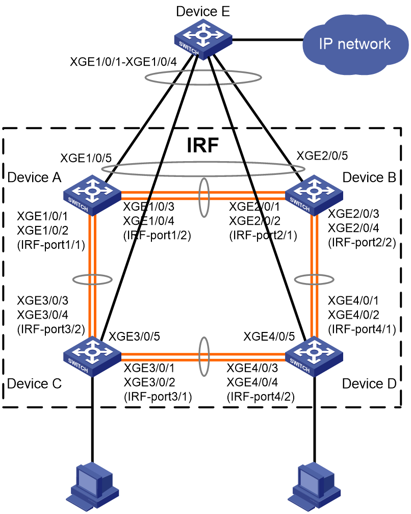

LACP MAD
As shown in Figure 8, LACP MAD has the following requirements:
·     Every IRF member must have a link with an intermediate device.
·     All the links form a dynamic link aggregation group.
·     The intermediate device must be a device that supports extended LACP for MAD.
The IRF member devices send extended LACPDUs that convey a domain ID and an active ID (the member ID of the master). The intermediate device transparently forwards the extended LACPDUs received from one member device to all the other member devices.
·     If the domain IDs and active IDs sent by all the member devices are the same, the IRF fabric is integrated.
·     If the extended LACPDUs convey the same domain ID but different active IDs, a split has occurred. LACP MAD handles this situation as described in "Collision handling."
Figure 8 LACP MAD scenario

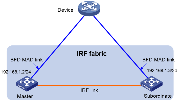

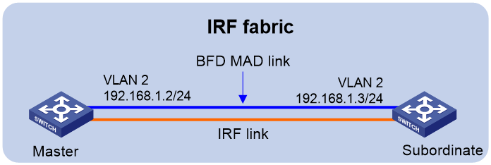

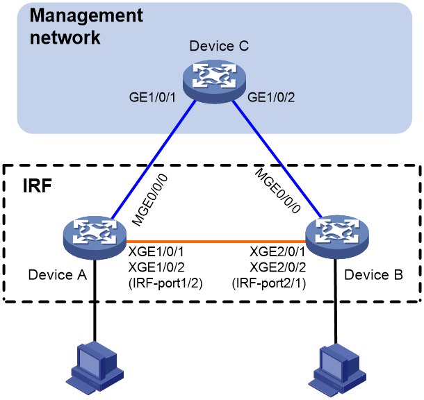

BFD MAD
BFD MAD detects multi-active collisions by using BFD.
You can use common or management Ethernet ports for BFD MAD.
If management Ethernet ports are used, BFD MAD has the following requirements:
·     Use an intermediate device and make sure each IRF member device has a BFD MAD link to the intermediate device.
·     Assign each member device a MAD IP address on the master's management Ethernet port.
If common Ethernet ports are used, BFD MAD has the following requirements:
·     If an intermediate device is used, each member device must have a BFD MAD link to the intermediate device. If no intermediate device is used, all member devices must have a BFD MAD link to each other.
·     Assign all ports on the BFD MAD links to the same VLAN or Layer 3 aggregate interface. Assign each member device a MAD IP address on the VLAN interface or Layer 3 aggregate interface.
When you use BFD MAD, follow these restrictions and guidelines:
·     As a best practice, use an intermediate device to connect IRF member devices if the IRF fabric has more than two member devices. A full mesh of IRF members might cause broadcast loops.
·     As a best practice, preferentially use management Ethernet ports for BFD MAD.
·     The BFD MAD links and BFD MAD VLAN (or Layer 3 aggregate interface) must be dedicated. Do not use the BFD MAD links or BFD MAD VLAN (or Layer 3 aggregate interface) for any other purposes.
·     When you use a Layer 3 aggregate interface for BFD MAD, make sure its member ports do not exceed the maximum number of Selected ports allowed for an aggregation group. If the number of member ports exceeds the maximum number of Selected ports, some member ports cannot become Selected. BFD MAD will be unable to work correctly and its state will change to Faulty. For more information about setting the maximum number of Selected ports for an aggregation group, see Ethernet link aggregation in Layer 2—LAN Switching Configuration Guide.
·     The MAD addresses identify the member devices and must belong to the same subnet.
·     Of all management Ethernet ports on an IRF fabric, only the master's management Ethernet port is accessible.
Figure 9 shows a typical BFD MAD scenario that uses an intermediate device. On the intermediate device, assign the ports on the BFD MAD links to the same VLAN.
Figure 10 shows a typical BFD MAD scenario that does not use an intermediate device.
With BFD MAD, the master attempts to establish BFD sessions with other member devices by using its MAD IP address as the source IP address.
·     If the IRF fabric is integrated, only the MAD IP address of the master takes effect. The master cannot establish a BFD session with any other member. If you execute the display bfd session command, the state of the BFD sessions is Down.
·     When the IRF fabric splits, the IP addresses of the masters in the split IRF fabrics take effect. The masters can establish a BFD session. If you execute the display bfd session command, the state of the BFD session between the two devices is Up.
Figure 9 BFD MAD scenario with an intermediate device
Figure 10 BFD MAD scenario without an intermediate device
ARP MAD
ARP MAD detects multi-active collisions by using extended ARP packets that convey the IRF domain ID and the active ID.
You can use common or management Ethernet ports for ARP MAD.
If management Ethernet ports are used, ARP MAD must work with an intermediate device. Make sure the following requirements are met:
·     Connect a management Ethernet port on each member device to the intermediate device.
·     On the intermediate device, you must assign the ports used for ARP MAD to the same VLAN.
If common Ethernet ports are used, ARP MAD can work with or without an intermediate device. Make sure the following requirements are met:
·     If an intermediate device is used, connect each IRF member device to the intermediate device, as shown in Figure 11. Run the spanning tree feature between the IRF fabric and the intermediate device. In this situation, data links can be used.
·     If no intermediate device is used, connect each IRF member device to all other member devices. In this situation, IRF links cannot be used for ARP MAD.
Each IRF member compares the domain ID and the active ID (the member ID of the master) in incoming extended ARP packets with its domain ID and active ID.
·     If the domain IDs are different, the extended ARP packet is from a different IRF fabric. The device does not continue to process the packet with the MAD mechanism.
·     If the domain IDs are the same, the device compares the active IDs.
¡     If the active IDs are different, the IRF fabric has split.
¡     If the active IDs are the same, the IRF fabric is integrated.
Figure 11 ARP MAD scenario

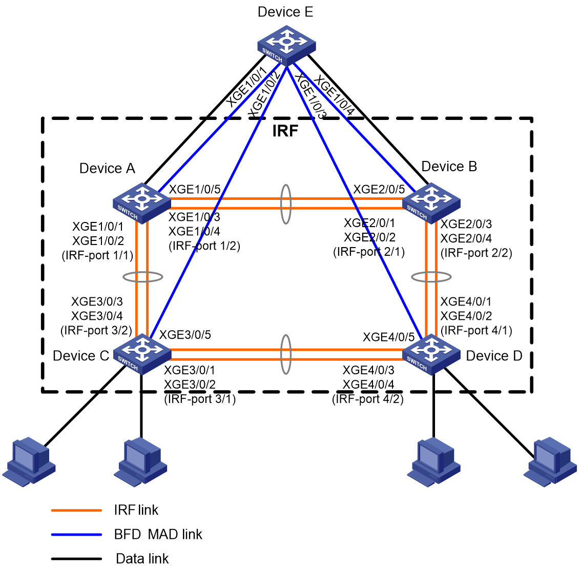

ND MAD
ND MAD detects multi-active collisions by using NS packets to transmit the IRF domain ID and the active ID.
You can use common or management Ethernet ports for ND MAD.
If management Ethernet ports are used, ND MAD must work with an intermediate device. Make sure the following requirements are met:
·     On the intermediate device, you must assign the ports used for ND MAD to the same VLAN.
If common Ethernet ports are used, ND MAD can work with or without an intermediate device. Make sure the following requirements are met:
·     If an intermediate device is used, connect each IRF member device to the intermediate device, as shown in Figure 12. Run the spanning tree feature between the IRF fabric and the intermediate device. In this situation, data links can be used.
·     If no intermediate device is used, connect each IRF member device to all other member devices. In this situation, IRF links cannot be used for ND MAD.
Each IRF member device compares the domain ID and the active ID (the member ID of the master) in incoming NS packets with its domain ID and active ID.
·     If the domain IDs are different, the NS packet is from a different IRF fabric. The device does not continue to process the packet with the MAD mechanism.
Figure 12 ND MAD scenario

IRF port connection
When you connect two neighboring IRF members, follow these restrictions and guidelines:
·     You must connect the physical interfaces of IRF-port 1 on one member to the physical interfaces of IRF-port 2 on the other.
·     For high availability, bind multiple physical interfaces to an IRF port. You can bind a maximum of eight physical interfaces to an IRF port.
Figure 13 Connecting IRF physical interfaces

Configuring BFD MAD
Restrictions and guidelines for configuring BFD MAD
As a best practice, use the following procedure to set up BFD MAD:
1.     Choose a BFD MAD link scheme as described in "BFD MAD."
2.     Configure BFD MAD.
3.     Connect the BFD MAD links.

Configuring BFD MAD on a VLAN interface
2.     (Optional.) Assign a domain ID to the IRF fabric.
irf domain domain-id
By default, the domain ID of an IRF fabric is 0.
CAUTION
CAUTION:
Changing the IRF domain ID of an IRF member device will remove that member device from the IRF fabric. This member device will be unable to exchange IRF protocol packets with the remaining member devices in the IRF fabric.
3.     Create a VLAN dedicated to BFD MAD.
vlan vlan-id
By default, only VLAN 1 exists.
Do not enable BFD MAD on VLAN-interface 1.
Perform this step also on the intermediate device (if any).
4.     Return to system view.
5.     Enter Ethernet interface view or interface range view.
¡     Enter Ethernet interface view.
¡     Enter interface range view. Choose one of the following commands:
interface range { interface-type interface-number [ to interface-type interface-number ] } &<1-24>
interface range name name [ interface { interface-type interface-number [ to interface-type interface-number ] } &<1-24> ]
To assign a range of ports to the BFD MAD VLAN, enter interface range view.
To assign one port to the BFD MAD VLAN, enter Ethernet interface view.
6.     Assign the port or the range of ports to the BFD MAD VLAN.
¡     Assign the ports to the VLAN as access ports.
port access vlan vlan-id
¡     Assign the ports to the VLAN as trunk ports.
port trunk permit vlan vlan-id
¡     Assign the ports to the VLAN as hybrid ports.
port hybrid vlan vlan-id { tagged | untagged }
The link type of BFD MAD ports can be access, trunk, or hybrid.
The default link type of a port is access.
7.     Return to system view.
8.     Enter VLAN interface view.
interface vlan-interface vlan-interface-id
9.     Enable BFD MAD.
mad bfd enable
By default, BFD MAD is disabled.
10.     Assign a MAD IP address to a member device on the VLAN interface.
mad ip address ip-address { mask | mask-length } member member-id

Configuring BFD MAD on a Layer 3 aggregate interface
CAUTION
CAUTION:
3.     Create a Layer 3 aggregate interface for BFD MAD.
interface route-aggregation interface-number
5.     Enter interface view or interface range view.
To assign a range of ports to the aggregation group for the aggregate interface, enter interface range view.
To assign one port to the aggregation group for the aggregate interface, enter Ethernet interface view.
6.     Assign the port or the range of ports to the aggregation group for the aggregate interface.
port link-aggregation group number
8.     Enter Layer 3 aggregate interface view.
9.     Enable BFD MAD.
mad bfd enable
10.     Assign a MAD IP address to a member device on the Layer 3 aggregate interface.
By default, no MAD IP addresses are configured on aggregate interfaces.
Repeat this step to assign a MAD IP address to each member device on the aggregate interface.

Configuring ARP MAD
Restrictions and guidelines for configuring ARP MAD
As a best practice, use the following procedure to set up ARP MAD:
1.     Choose an ARP MAD link scheme as described in "ARP MAD."
2.     Configure ARP MAD.
3.     Connect the ARP MAD links.
When you configure ARP MAD on a VLAN interface, follow these restrictions and guidelines:
Category
ARP MAD VLAN
·     Do not enable ARP MAD on VLAN-interface 1.
·     If you are using an intermediate device, perform the following tasks:
¡     On the IRF fabric and the intermediate device, create a VLAN for ARP MAD.
¡     On the IRF fabric and the intermediate device, assign the ports of ARP MAD links to the ARP MAD VLAN.
¡     On the IRF fabric, create a VLAN interface for the ARP MAD VLAN.
·     Do not use the ARP MAD VLAN for any other purposes.
ARP MAD and feature configuration
If an intermediate device is used, make sure the following requirements are met:
·     Run the spanning tree feature between the IRF fabric and the intermediate device to ensure that there is only one ARP MAD link in forwarding state. For more information about the spanning tree feature and its configuration, see Layer 2—LAN Switching Configuration Guide.
·     Enable the IRF fabric to change its bridge MAC address as soon as the address owner leaves.
·     If the intermediate device is also an IRF fabric, assign the two IRF fabrics different domain IDs for correct split detection.
When you configure ARP MAD on a management Ethernet port, follow these restrictions and guidelines:
Category
Management Ethernet ports for ARP MAD
Connect a management Ethernet port on each member device to the common Ethernet ports on the intermediate device.
ARP MAD VLAN
On the intermediate device, create a VLAN for ARP MAD, and assign the ports used for ARP MAD to the VLAN. On the IRF fabric, you do not need to assign the management Ethernet ports to the VLAN.
Configuring ARP MAD on a VLAN interface
2.     Assign a domain ID to the IRF fabric.
The default IRF domain ID is 0.
CAUTION
CAUTION:
3.     Configure the IRF bridge MAC address to change as soon as the address owner leaves.
undo irf mac-address persistent
By default, the IRF bridge MAC address does not change after the address owner leaves.
CAUTION
CAUTION:
IRF bridge MAC address change will cause transient traffic disruption.
4.     Create a VLAN dedicated to ARP MAD.
vlan vlan-id
Do not configure ARP MAD on VLAN-interface 1.
Perform this task also on the intermediate device (if any).
5.     Return to system view.
6.     Enter Ethernet interface view or interface range view.
To assign a range of ports to the ARP MAD VLAN, enter interface range view.
To assign one port to the ARP MAD VLAN, enter Ethernet interface view.
7.     Assign the port or the range of ports to the ARP MAD VLAN.
The link type of ARP MAD ports can be access, trunk, or hybrid.
8.     Return to system view.
9.     Enter VLAN interface view.
10.     Assign the interface an IP address.
By default, no IP addresses are assigned to any VLAN interfaces.
11.     Enable ARP MAD.
mad arp enable
By default, ARP MAD is disabled.
Configuring ARP MAD on a management Ethernet port
CAUTION
CAUTION:
CAUTION
CAUTION:
4.     Enter management Ethernet interface view.
interface m-gigabitethernet interface-number
5.     Assign an IP address to the management Ethernet port.
By default, no IP addresses are configured.
6.     Enable ARP MAD.
mad arp enable

Recovering an IRF fabric
If the active IRF fabric fails before the IRF link is recovered, perform this task on the inactive IRF fabric to recover the inactive IRF fabric for traffic forwarding. The manual recovery operation brings up all interfaces that were shut down by MAD on the inactive IRF fabric.
2.     Recover the inactive IRF fabric.
mad restore

Enabling IRF auto-merge
When two IRF fabrics merge, you must reboot the member devices in the IRF fabric that fails in the master election. The auto-merge feature enables the IRF fabric to automatically reboot all its member devices to complete the merge.
If this feature is disabled, you must manually reboot the devices that failed the master election to complete the merge.
2.     Enable IRF auto-merge.
irf auto-merge enable
By default, this feature is enabled.

Example: Configuring an IRF fabric with LACP MAD enabled on an aggregate interface
As shown in Figure 14, set up a four-chassis IRF fabric at the access layer of the enterprise network.
Configure LACP MAD on the multichassis aggregation to Device E, which supports extended LACP.
Figure 14 Network diagram
1.     Configure settings for IRF setup on Device A:
# Shut down the physical interfaces used for IRF links. In this example, the physical interfaces are shut down in batch. For more information, see Layer 2—LAN Switching Configuration Guide.
<Sysname> system-view
[Sysname] interface range ten-gigabitethernet 1/0/1 to ten-gigabitethernet 1/0/4
[Sysname-if-range] shutdown
[Sysname-if-range] quit
# Bind Ten-GigabitEthernet 1/0/1 and Ten-GigabitEthernet 1/0/2 to IRF-port 1/1.
[Sysname] irf-port 1/1
[Sysname-irf-port1/1] port group interface ten-gigabitethernet 1/0/1
[Sysname-irf-port1/1] port group interface ten-gigabitethernet 1/0/2
[Sysname-irf-port1/1] quit
# Bind Ten-GigabitEthernet 1/0/3 and Ten-GigabitEthernet 1/0/4 to IRF-port 1/2.
[Sysname] irf-port 1/2
[Sysname-irf-port1/2] port group interface ten-gigabitethernet 1/0/3
[Sysname-irf-port1/2] port group interface ten-gigabitethernet 1/0/4
[Sysname-irf-port1/2] quit
# Bring up the physical interfaces and save the configuration.
[Sysname-if-range] undo shutdown
[Sysname] save
# Activate the IRF port configuration.
[Sysname] irf-port-configuration active
2.     Configure settings for IRF setup on Device B:
# Change the member ID of Device B to 2 and reboot the device to have the change take effect.
[Sysname] irf member 1 renumber 2
Renumbering the member ID may result in configuration change or loss. Continue? [Y/N]:y
[Sysname] quit
<Sysname> reboot
# Connect Device B to Device A as shown in Figure 14, and log in to Device B. (Details not shown.)
# Shut down the physical interfaces for IRF links.
[Sysname] interface range ten-gigabitethernet 2/0/1 to ten-gigabitethernet 2/0/4
# Bind Ten-GigabitEthernet 2/0/1 and Ten-GigabitEthernet 2/0/2 to IRF-port 2/1.
[Sysname] irf-port 2/1
[Sysname-irf-port2/1] port group interface ten-gigabitethernet 2/0/1
[Sysname-irf-port2/1] port group interface ten-gigabitethernet 2/0/2
[Sysname-irf-port2/1] quit
# Bind Ten-GigabitEthernet 2/0/3 and Ten-GigabitEthernet 2/0/4 to IRF-port 2/2.
[Sysname] irf-port 2/2
[Sysname-irf-port2/2] port group interface ten-gigabitethernet 2/0/3
[Sysname-irf-port2/2] port group interface ten-gigabitethernet 2/0/4
[Sysname-irf-port2/2] quit
[Sysname] save
The two devices perform master election, and the one that has lost the election reboots to form an IRF fabric with the master.
3.     Configure settings for IRF setup on Device C:
# Change the member ID of Device C to 3 and reboot the device to have the change take effect.
[Sysname] irf member 1 renumber 3
[Sysname] quit
<Sysname> reboot
# Connect Device C to Device A as shown in Figure 14, and log in to Device C. (Details not shown.)
[Sysname] interface range ten-gigabitethernet 3/0/1 to ten-gigabitethernet 3/0/4
# Bind Ten-GigabitEthernet 3/0/1 and Ten-GigabitEthernet 3/0/2 to IRF-port 3/1.
[Sysname] irf-port 3/1
[Sysname-irf-port3/1] port group interface ten-gigabitethernet 3/0/1
[Sysname-irf-port3/1] port group interface ten-gigabitethernet 3/0/2
[Sysname-irf-port3/1] quit
# Bind Ten-GigabitEthernet 3/0/3 and Ten-GigabitEthernet 3/0/4 to IRF-port 3/2.
[Sysname] irf-port 3/2
[Sysname-irf-port3/2] port group interface ten-gigabitethernet 3/0/3
[Sysname-irf-port3/2] port group interface ten-gigabitethernet 3/0/4
[Sysname-irf-port3/2] quit
[Sysname] save
Device C reboots to join the IRF fabric.
4.     Configure settings for IRF setup on Device D:
# Change the member ID of Device D to 4 and reboot the device to have the change take effect.
[Sysname] irf member 1 renumber 4
[Sysname] quit
<Sysname> reboot
# Connect Device D to Device B and Device C as shown in Figure 14, and log in to Device D. (Details not shown.)
# Shut down the physical interfaces.
[Sysname] interface range ten-gigabitethernet 4/0/1 to ten-gigabitethernet 4/0/4
# Bind Ten-GigabitEthernet 4/0/1 and Ten-GigabitEthernet 4/0/2 to IRF-port 4/1.
[Sysname] irf-port 4/1
[Sysname-irf-port4/1] port group interface ten-gigabitethernet 4/0/1
[Sysname-irf-port4/1] port group interface ten-gigabitethernet 4/0/2
[Sysname-irf-port4/1] quit
# Bind Ten-GigabitEthernet 4/0/3 and Ten-GigabitEthernet 4/0/4 to IRF-port 4/2.
[Sysname] irf-port 4/2
[Sysname-irf-port4/2] port group interface ten-gigabitethernet 4/0/3
[Sysname-irf-port4/2] port group interface ten-gigabitethernet 4/0/4
[Sysname-irf-port4/2] quit
[Sysname] save
Device D reboots to join the IRF fabric. A four-chassis IRF fabric is formed.
5.     Configure LACP MAD on the IRF fabric:
# Set the domain ID of the IRF fabric to 1.
[Sysname] irf domain 1
# Create a dynamic aggregate interface and enable LACP MAD.
[Sysname] interface bridge-aggregation 2
[Sysname-Bridge-Aggregation2] link-aggregation mode dynamic
[Sysname-Bridge-Aggregation2] mad enable
You need to assign a domain ID (range: 0-4294967295)
[Current domain ID is: 1]:
The assigned domain ID is: 1
[Sysname-Bridge-Aggregation2] quit
# Assign Ten-GigabitEthernet 1/0/5, Ten-GigabitEthernet 2/0/5, Ten-GigabitEthernet 3/0/5, and Ten-GigabitEthernet 4/0/5 to the aggregate interface.
[Sysname] interface range ten-gigabitethernet 1/0/5 ten-gigabitethernet 2/0/5 ten-gigabitethernet 3/0/5 ten-gigabitethernet 4/0/5
[Sysname-if-range] port link-aggregation group 2
6.     Configure Device E as the intermediate device for LACP MAD:
CAUTION
CAUTION:
If the intermediate device is also an IRF fabric, assign the two IRF fabrics different domain IDs for correct split detection. False detection causes IRF split.
# Create a dynamic aggregate interface.
# Assign Ten-GigabitEthernet 1/0/1, Ten-GigabitEthernet 1/0/2, Ten-GigabitEthernet 1/0/3, and Ten-GigabitEthernet 1/0/4 to the aggregate interface.
Example: Configuring an IRF fabric with BFD MAD enabled on a VLAN interface
As shown in Figure 15, set up a four-chassis IRF fabric at the distribution layer of the enterprise network.
·     Configure BFD MAD on the IRF fabric and set up BFD MAD links between each member device and the intermediate device.
·     Disable the spanning tree feature on the ports used for BFD MAD, because the two features conflict with each other.
Figure 15 Network diagram

Example: Configuring an IRF fabric with ARP MAD enabled on a VLAN interface
As shown in Figure 16, set up a four-chassis IRF fabric in the enterprise network.
·     Configure ARP MAD on the IRF fabric and use the links connected to Device E for transmitting ARP MAD packets.
·     To prevent loops, run the spanning tree feature between Device E and the IRF fabric.
Figure 16 Network diagram

Example: Configuring an IRF fabric with ND MAD enabled on a VLAN interface
As shown in Figure 17, set up a four-chassis IRF fabric in the IPv6 enterprise network.
·     Configure ND MAD on the IRF fabric and use the links connected to Device E for transmitting ND MAD packets.
Figure 17 Network diagram
[Sysname] save
[Sysname] quit
<Sysname> reboot
# Connect Device B to Device A as shown in Figure 17, and log in to Device B. (Details not shown.)
[Sysname] save
[Sysname] quit
<Sysname> reboot
# Connect Device C to Device A as shown in Figure 17, and log in to Device C. (Details not shown.)
[Sysname] save
[Sysname] quit
<Sysname> reboot
# Connect Device D to Device B and Device C as shown in Figure 17, and log in to Device D. (Details not shown.)
[Sysname] save
5.     Configure ND MAD on the IRF fabric:
# Enable the spanning tree feature globally. Map the ND MAD VLAN to MSTI 1 in the MST region.
[Sysname] stp global enable
[Sysname] stp region-configuration
[Sysname-mst-region] region-name ndmad
[Sysname-mst-region] instance 1 vlan 3
[Sysname-mst-region] active region-configuration
[Sysname-mst-region] quit
# Configure the IRF fabric to change its bridge MAC address as soon as the address owner leaves.
[Sysname] undo irf mac-address persistent
# Create VLAN 3, and add Ten-GigabitEthernet 1/0/5, Ten-GigabitEthernet 2/0/5, Ten-GigabitEthernet 3/0/5, and Ten-GigabitEthernet 4/0/5 to VLAN 3.
[Sysname] vlan 3
[Sysname-vlan3] port ten-gigabitethernet 1/0/5 ten-gigabitethernet 2/0/5 ten-gigabitethernet 3/0/5 ten-gigabitethernet 4/0/5
[Sysname-vlan3] quit
# Create VLAN-interface 3, assign it an IPv6 address, and enable ND MAD on the interface.
[Sysname] interface vlan-interface 3
[Sysname-Vlan-interface3] ipv6 address 2001::1 64
[Sysname-Vlan-interface3] mad nd enable
6.     Configure Device E as the intermediate device for ND MAD:
CAUTION
CAUTION:
If the intermediate device is also in an IRF fabric, assign the two IRF fabrics different domain IDs for correct split detection. False detection causes IRF split.
<DeviceE> system-view
[DeviceE] stp global enable
[DeviceE] stp region-configuration
[DeviceE-mst-region] region-name ndmad
[DeviceE-mst-region] instance 1 vlan 3
[DeviceE-mst-region] active region-configuration
[DeviceE-mst-region] quit
# Create VLAN 3, and add Ten-GigabitEthernet 1/0/1, Ten-GigabitEthernet 1/0/2, Ten-GigabitEthernet 1/0/3, and Ten-GigabitEthernet 1/0/4 to VLAN 3 for forwarding ND MAD packets.
[DeviceE] vlan 3
[DeviceE-vlan3] port ten-gigabitethernet 1/0/1 to ten-gigabitethernet 1/0/4
[DeviceE-vlan3] quit
Example: Configuring an IRF fabric with ARP MAD and management IP configured on the same management Ethernet port
IMPORTANT
IMPORTANT:
This example is also applicable to a two-chassis IRF fabric running ND MAD, except that you must configure ND MAD rather than ARP MAD.
As shown in Figure 18, use Device A and Device B to set up a two-chassis IRF fabric.
Use management Ethernet port M-GigabitEthernet 0/0/0 to perform ARP MAD for IRF split detection and to provide device access for management purposes.
Configure management IP addresses for the IRF fabric and each member device on the management port to meet the following requirements:
·     The administrator can use the same management IP address to access the IRF fabric before and after an active/subordinate switchover.
·     The administrator can access each member device for failure recovery through their respective management IP addresses after the IRF fabric splits.
Figure 18 Network diagram
When you configure management IP addresses, follow these restrictions and guidelines:
·     To make sure you can access the IRF fabric at the same IP address after a master/subordinate switchover, use the ip address ip-address { mask-length | mask } command to configure a management IP address on the management port, in this example, on M-GigabitEthernet 0/0/0. You can use this address to access the IRF fabric as long as the fabric has not split. This address might be inaccesible for an IP conflict after the IRF fabric splits, because it exists on all member devices. In the context of IRF, this address is called a global management IP address.
·     To access each member device for failure recovery after the IRF fabric splits, use the ip address ip-address { mask-length | mask } irf-member member-id command to configure a management IP address for each member device on the management port, in this example, on M-GigabitEthernet 0/0/0. In the context of IRF, this address is called a member-specific management IP address.
·     Make sure the management IP addresses assigned to all IRF member devices on the same management Ethernet port belong to the same subnet. Make sure the management IP addresses assigned to an IRF member device on different management Ethernet ports belong to different subnets.
·     You must manually make sure the management IP addresses configured on the subordinate devices will not cause IP address conflicts on the network. When the IRF fabric is running correctly, only the IP addresses of the management Ethernet ports on the master device take effect. The management IP addresses of the management Ethernet ports on the subordinate devices do not take effect. If a management IP address on a subordinate device conflicts with an IP address in the network, the system cannot detect the IP conflict, causing network issues after an IRF split.
When the IRF fabric is integrated, you can access the IRF fabric by using either the global management IP address or the management IP address specific to the master device. As a best practice to prevent the management IP address from changing upon a master/subordinate switchover, use the global management IP address as long as the IRF fabric is integrated.
When you configure ARP MAD on a management Ethernet port, follow the restrictions and guidelines in "Configuring ARP MAD."

# Connect Device B to Device A, as shown in Figure 18.
Device A and Device B perform master election. The device that has failed master election automatically reboots to form an IRF fabric with the other device. A two-chassis IRF fabric is formed.

Configuring ARP MAD
1.     Configure the IRF fabric:
# Enable ARP MAD on management Ethernet port M-GigabitEthernet 0/0/0.
[Sysname] interface m-gigabitethernet 0/0/0
[Sysname-M-GigabitEthernet0/0/0] mad arp enable
[Sysname-M-GigabitEthernet0/0/0] quit
# Save the running configuration to the next-startup configuration file.
[Sysname] save
2.     Configure Device C (a switch that supports ARP) as the intermediate device for ARP MAD:
CAUTION
CAUTION:
# Create VLAN 100.
<DeviceC> system-view
[DeviceC] vlan 100
# Assign GigabitEthernet 1/0/1 and GigabitEthernet 1/0/2 to VLAN 100 for forwarding ARP MAD packets.
[DeviceC-vlan100] port gigabitethernet 1/0/1 to gigabitethernet 1/0/2
[DeviceC-vlan100] quit
# Disconnect the IRF links between Device A and Device B. Verify that you can use 192.168.1.101 and 192.168.1.102 to log in to Device A and Device B, respectively. (Details not shown.)
# Execute the display mad verbose command on Device A and Device B to verify that MAD is correctly functioning, as follows:
·     The Multi-active recovery state field displays Yes on one device and displays No on the other device.
·     On each device, the IRF physical interfaces and management Ethernet port M-GigabitEthernet 0/0/0 are excluded from being shut down by MAD.
#  Execute the display interface brief command on Device A and Device B to verify that the MAD shutdown action is performed correctly, as follows:
·     On the device in Recovery state, all network interfaces have been shut down by MAD except the IRF physical interfaces and management Ethernet port M-GigabitEthernet 0/0/0.
·     On the device not in Recovery state, no network interfaces are shut down by MAD.
Example: Removing member devices from an IRF fabric without MAD in place
As shown in Figure 19 or Figure 20, an IRF fabric is in daisy-chain or ring topology. The IRF fabric contains four member devices, in which member 1 is the master device. MAD is not configured on the IRF fabric.
Remove member devices 3 and 4 from the IRF fabric.
Figure 19 Network diagram (daisy-chain topology)
Figure 20 Network diagram (ring topology)
1.     Enable the IRF fabric to change its bridge MAC address as soon as the address owner leaves the fabric.
<System> system-view
[System] undo irf mac-address persistent
2.     Shut down the network interfaces that connect member devices 3 and 4 to the upstream and downstream devices. (Details not shown.)
3.     Use one of the following methods to split the IRF fabric into two IRF fabrics (IRF 1 and IRF 2):
¡     Disconnect the physical IRF links between IRF 1 and IRF 2, as shown in Figure 21 or Figure 22.
Figure 21 Disconnecting physical IRF links (daisy-chain topology)
Figure 22 Disconnecting physical IRF links (ring topology)
¡     Shut down the IRF physical interfaces that connect IRF 1 and IRF 2, as shown in Figure 21 or Figure 22. (Details not shown.)
The IRF fabric splits into IRF 1 and IRF 2. Because MAD is not configured, both IRF 1 and IRF 2 are active. The member devices in IRF 2 automatically elect a master on split.
4.     Handle IRF 2:
¡     To retain IRF 2 in the network, log in to IRF 2, modify the IP addresses that conflict with those on IRF 1 and change its domain ID. (Details not shown.)
¡     To remove IRF 2 from the network, disconnect all physical network connections from the IRF fabric and remove IRF configuration from all member devices in the IRF fabric. (Details not shown.)
5.     Bring up the network interfaces that have been shut down on the removed member devices. (Details not shown.)
6.     Remove IRF port bindings from unused IRF physical interfaces on IRF 1. (Details not shown.)
Example: Removing member devices from an IRF fabric with MAD in place
As shown in Figure 23 or Figure 24, an IRF fabric is in daisy-chain or ring topology. The IRF fabric contains four member devices, in which member 1 is the master device. MAD is configured on the IRF fabric.
Figure 23 Network diagram (daisy-chain topology)
Figure 24 Network diagram (ring topology)
¡     Disconnect the physical IRF links between IRF 1 and IRF 2, as shown in Figure 25 or Figure 26.
Figure 25 Disconnecting physical IRF links (daisy-chain topology)
Figure 26 Disconnecting physical IRF links (ring topology)
¡     Shut down the IRF physical interfaces that connect IRF 1 and IRF 2, as shown in Figure 25 or Figure 26. (Details not shown.)
The IRF fabric splits into IRF 1 and IRF 2. Because MAD is configured, IRF 1 remains active and IRF 2 is placed in Recovery state and becomes inactive.
4.     Handle IRF 2:
¡     To retain IRF 2 in the network, log in to IRF 2, modify the IP addresses that conflict with those on IRF 1, change its domain ID, and recover IRF 2.
[System] irf domain 2
[System] mad restore
