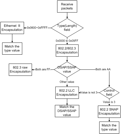

The switch identifies whether a packet is an Ethernet II packet or an 802.2/802.3 packet according to the ranges of the two fields.
The H3C S3600 series switches recognize packets with the value of the type field being in the range 0x05DD to 0x05FF as 802.2/802.3 encapsulated packets.

The switch differentiates between 802.2 LLC encapsulation and 802.2 SNAP encapsulation according to the values of the DSAP field and the SSAP field.
When the OUI is 00-00-00 in 802.2 SNAP encapsulation, the PID field has the same meaning as the type field in Ethernet II encapsulation, which both refer to globally unique protocol number. Such encapsulation is also known as SNAP RFC 1042 encapsulation, which is standard SNAP encapsulation. The SNAP encapsulation mentioned in this chapter refers to SNAP RFC 1042 encapsulation.
Procedure for the Switch to Judge Packet Protocol
Figure 1-9 Protocol identification procedure

When configuring a protocol template for a protocol-based VLAN, use the at, ip or ipx keyword to configure a standard template to match AppleTalk, IP, and IPX packets respectively, and use the mode keyword to configure a user-defined template.
l          Because the IP protocol is closely associated with the ARP protocol, you are recommended to configure the ARP protocol type when configuring the IP protocol type and associate the two protocol types with the same port to avoid that ARP packets and IP packets are not assigned to the same VLAN, which will cause IP address resolution failure.
l          If you specify some special values for both the dsap-id and ssap-id arguments when configuring the user-defined template for IIc encapsulation, the matching packets will take the same encapsulation format as some standard type of packets. For example, when both dsap-id and ssap-id have a value of 0xFF, the encapsulation format will be the same as that of ipx raw packets; if they both have a value of 0xE0, the packet encapsulation format will be the same as that of ipx llc packets; if they both have a value of 0xAA, the packet encapsulation format will be the same as that of snap packets. To prevent two commands from processing packets of the same protocol type in different ways, the system does not allow you to set both the dsap-id and ssap-id arguments to 0xFF, 0xE0, or 0xAA.
l          When you use the mode keyword to configure a user-defined protocol template, if you set the etype-id argument for ethernetii or snap packets to 0x0800, 0x8137, or 0x809B, the matching packets will take the same format as that of the IP, IPX, and AppleTalk packets respectively. To prevent two commands from processing packets of the same protocol type in different ways, the switch will prompt that you cannot set the etype-id argument for Ethernet II or snap packets to 0x0800, 0x8137, or 0x809B.
